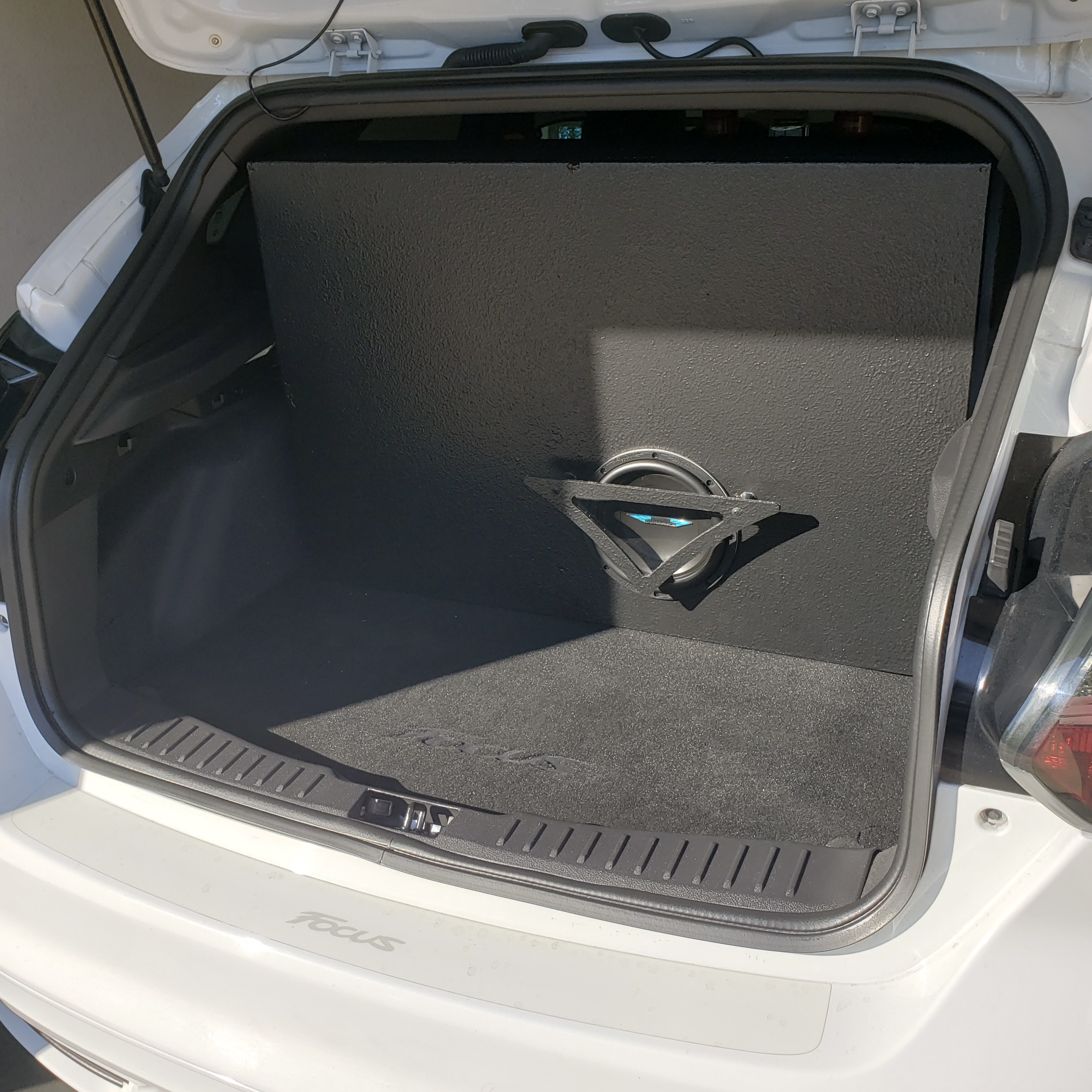

It is a step up from my t-line in terms of output and it blends into my front stage better too, that surprised me about it. I am currently using same sub from the t-line, Image Dynamics ID8 dual 2 ohm voice coil version. FS is lower than requirements so I don’t know how much of a compromise that is. I have it standing up against the back seat so still have access to spare tire. Horn to passenger side. Tuba has to side to side to fit the car.
It’s running off of the factory Ford Sony amp. I did replace the amp with a Ford/Sony “AA” version, and crossed over the tuba at 70hz with a shallow drop off. If I understand correctly horns increase the impedance? -so it is actually ‘only’ seeing 35 watts total. The amp has bass limiter at 25% volume, it does not reduce bass just stays the same level from 25-100% and can be taken to max volume with no audible problems, though will never really go that high for me, but nice to know it. I have a loud car and am building a SQ car, so I won’t be abusing the tuba at all.

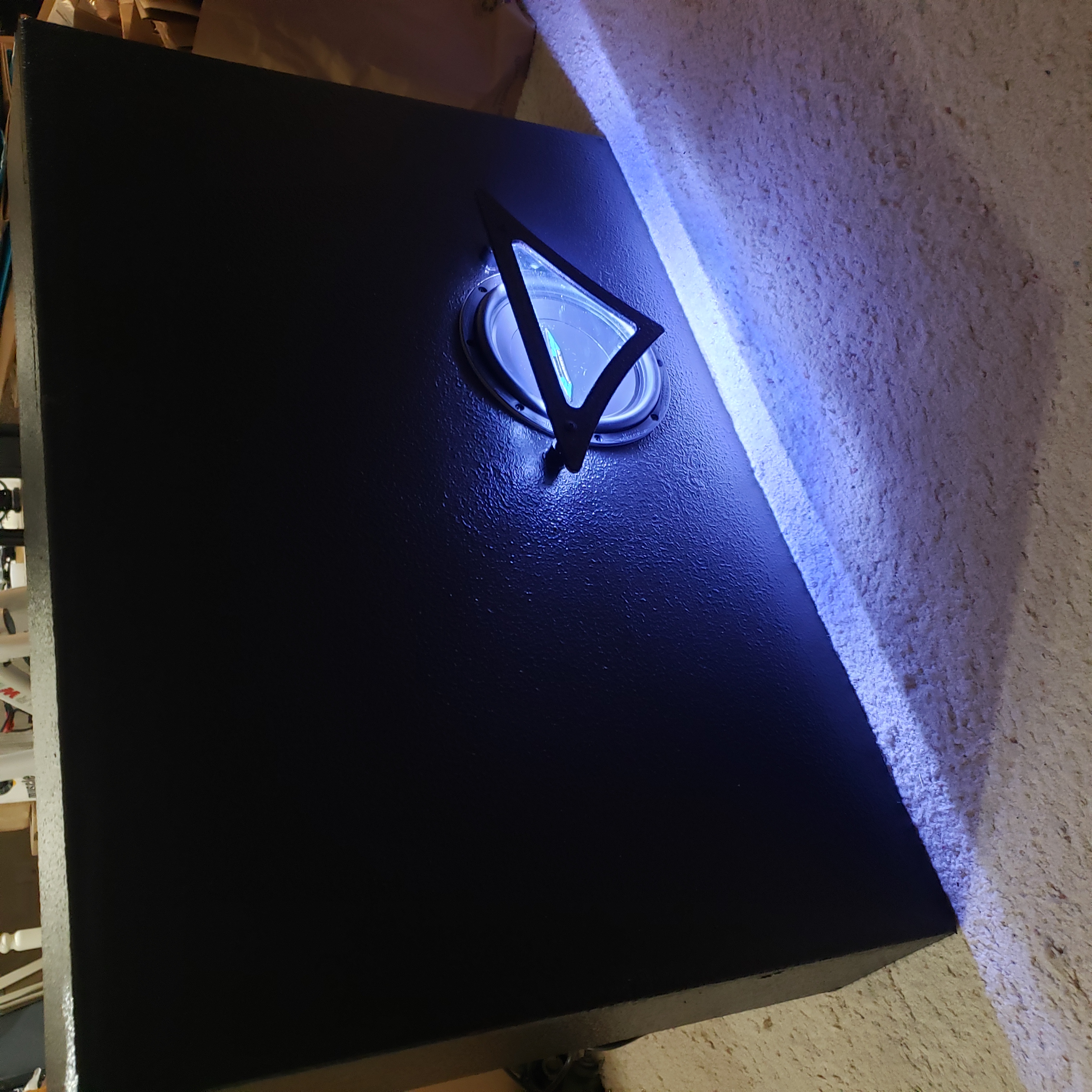

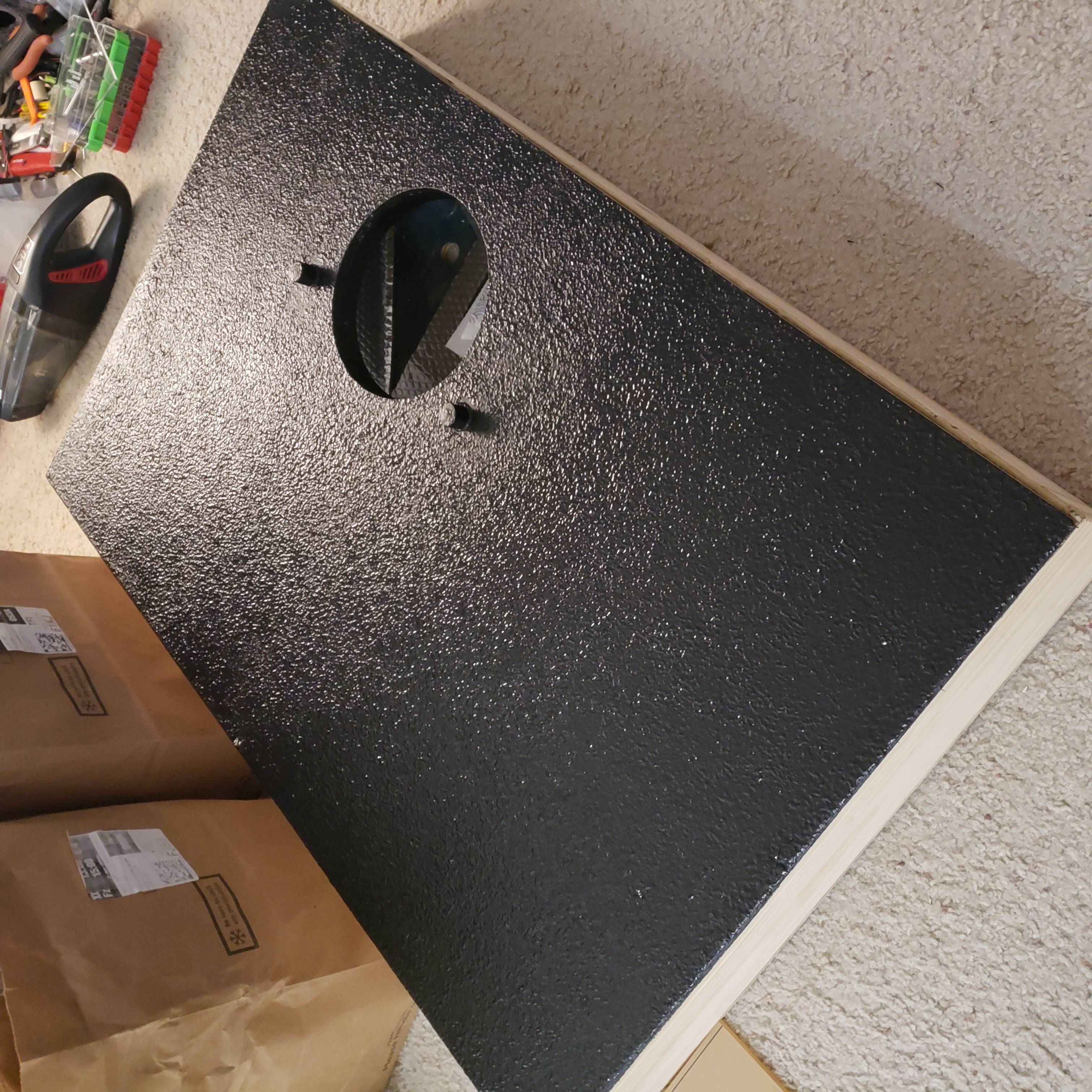

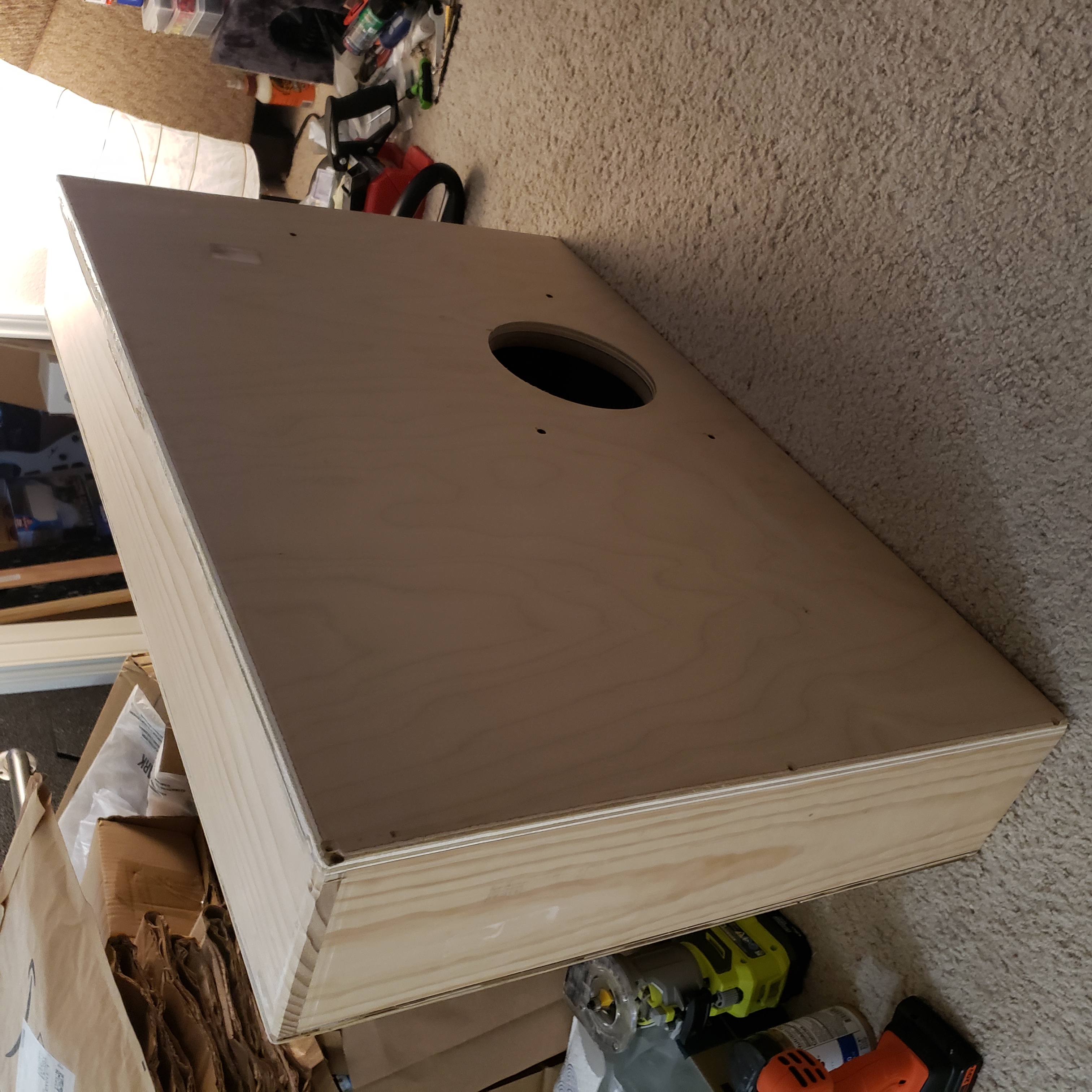

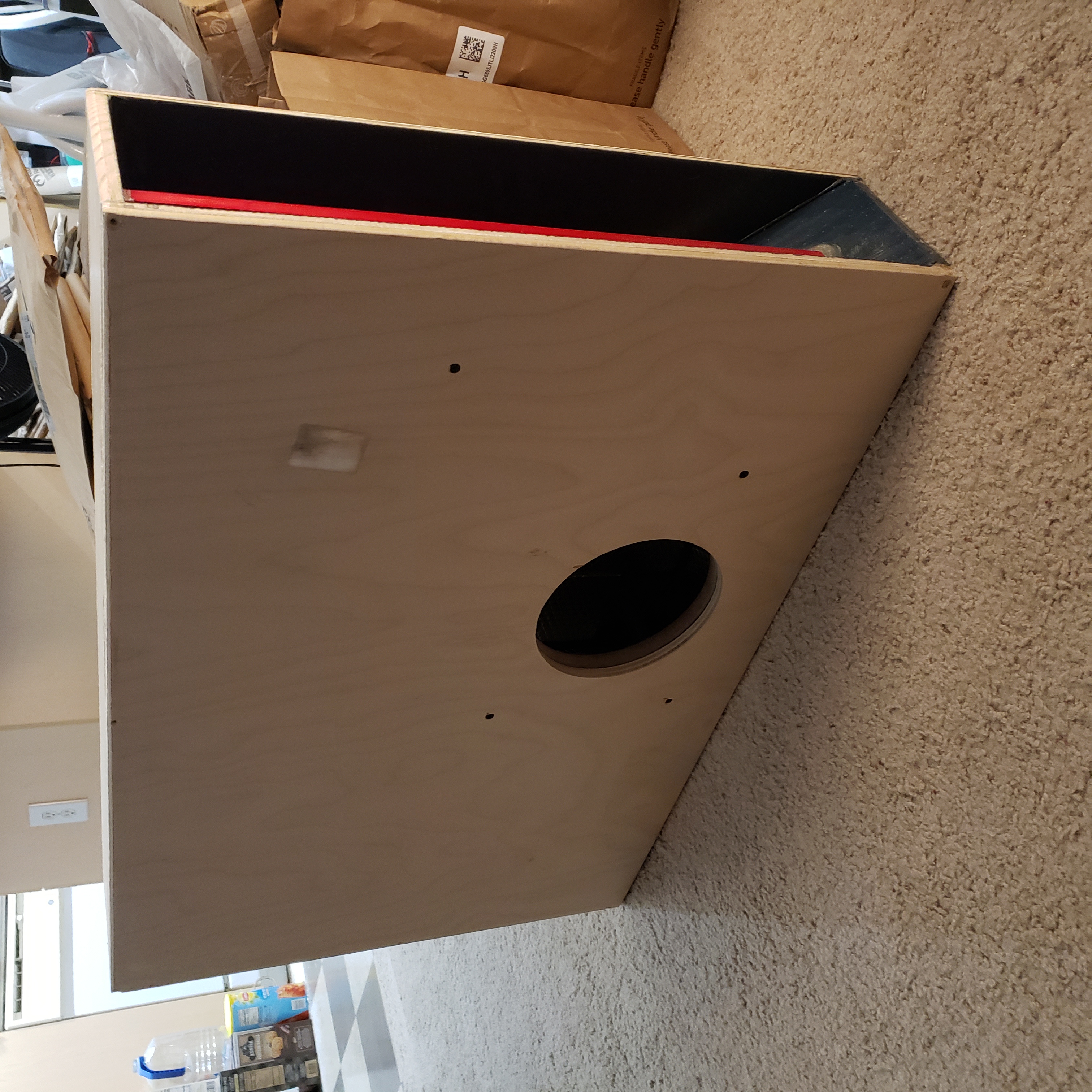

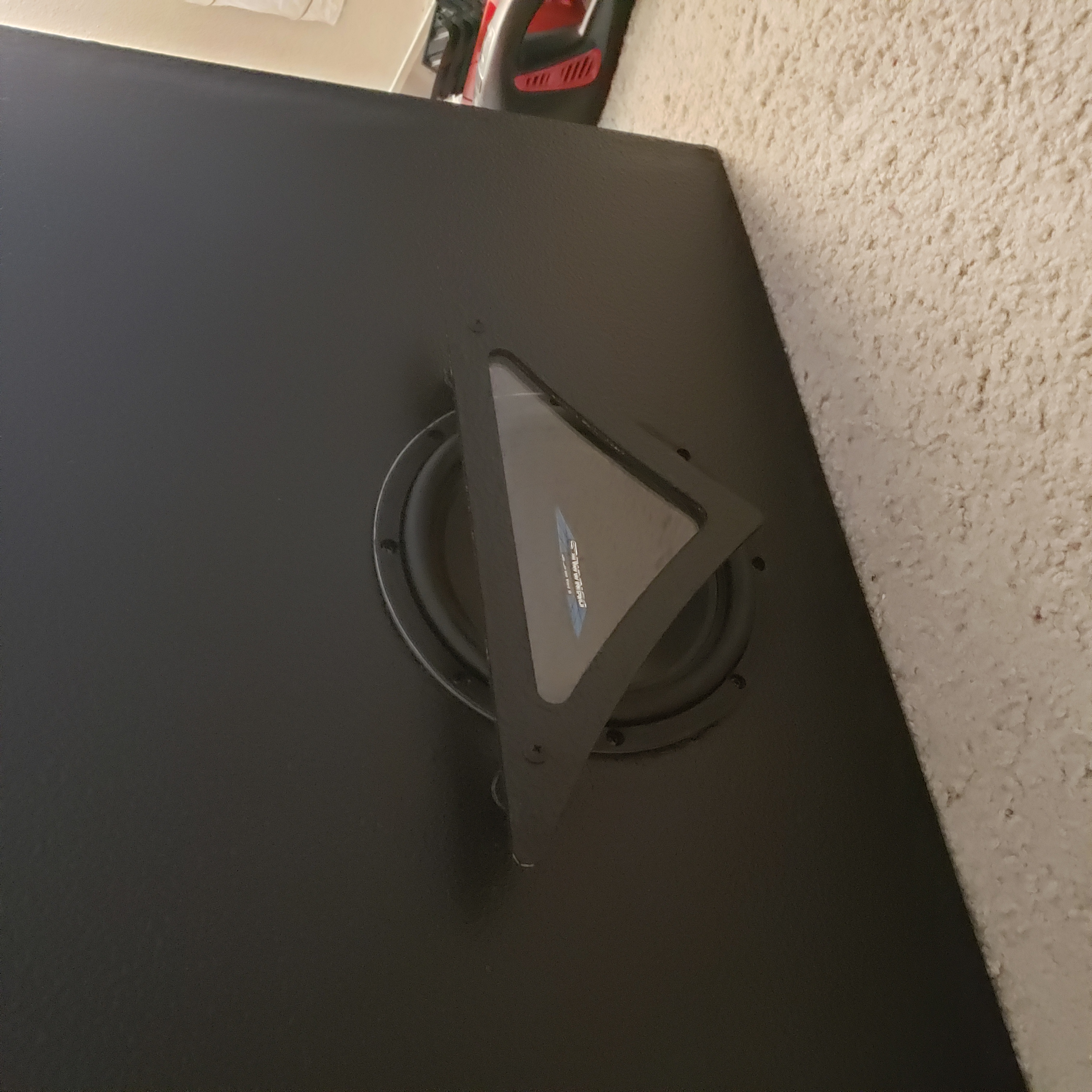

The only deviations from the plans are I did bracing in a 6” deep horn, and a sheet of sound deadener in the sub chamber. Neither are necessary but this is my first time working with 1/2” birch vs 3/4”. I did 2 layers of Granotone on the outside; Then a custom grille with LED lighting to protect the sub.

Glad it worked out for you. As for the sound deadener, if it needed it the plans would say so. Car doors need to have added mass to control vibrations because they can't be braced. Properly braced cabs don't need added mass, and they don't need to be made from 3/4" material. 1/2" with even minimal bracing is as vibration free as 1" without bracing. I don't settle for that. For the most part my bracing schemes make 1/2" work as well as 2" without bracing.

I had leftover deadener from doing the rest of the car. I have always braced my other enclosures, even though plans did not call for it, I figured it would not hurt.
