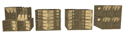

Is one of these better than the rest?
Posts: 28974
Re: Tuba Haystack Configuration
#8 Post by Bill Fitzmaurice »
All four operate as a single horn. You shouldn't use any of those with tops, but the wavelengths with subs are much too long for there to be any destructive interference. The middle two would benefit from inward splaying with a V-Plate. The one on the right wouldn't, the percentage of additional path length wouldn't be that much.
