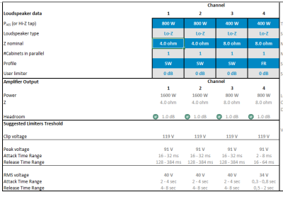

So, first things first. The plan is to now fully run our soundsystem on a single 1U amp. Using the PowerSoft Powersharing calculator I can see that I should be able to run it like this:
Channel 1 - 2xTitan 48 in parallel
Channel 2 - 2xTitan 48 in parallel
Channel 3 - Omnitop 12 L
Channel 4 - Omnitop 12 R
now we are in the process of building 2 more tops and we should be also able to run those with no issue on channels 3 and 4, but our endgoal is to have 6 Titans v-plated with 4 OTs and while I ran the simulation and it seems like it would hold, it kind of looks too good to be true. Do you think this would actually have enough power?

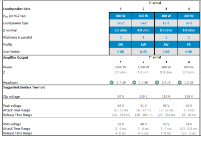

Logic here is having 2 pairs of parallel Titans hooked up in parallel which I assume would produce a 2ohm load of 800w (we run 12nlw9300)
But I'm pretty sure I'm just doing this wrong so please, let me know.

disregard the "SW" profile on channel 3, it's a remnant from another calculation
Posts: 7575
Re: Powersoft T604A
#3 Post by Tom Smit »
jmanso wrote: Wed May 24, 2023 7:48 pm disregard the "SW" profile on channel 3, it's a remnant from another calculation
Disregard the RMS voltage on channel 3 as well?
Re: Powersoft T604A
#4 Post by Grant Bunter »
Forget peak voltage and clip voltage if they are greater than the maximum allowable displacement voltage limit in the plans, ie 80V/driver. Don't use them, make them null.
You are after brick wall limiting, ie, once set, it doesn't matter what you do to mixer faders or whatever, the maximum voltage per cab is 80V. Find out from powersoft/armonia how to make that happen. Anything else is putting your drivers at risk.
Your amp doesn't have enough power for subs (i think). 3 x 8ohm cabs in parallel per channel is 2.66Ohms, or just over 2400W, which is greater than the specs of 1500W/2ohms.
You would be better served to add 4 more T48's, then run 1 parallel pair/channel on all 4 channels, and use another amp for your 4 x Otops, which would require 400W/channel for war volume, + some headroom...

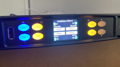

well. It's here!
Let the testing begin.
