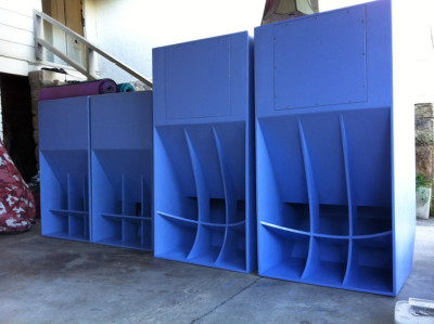

The T39 isn't a poor choice either. But, I'll share a little bit of my personal point of view on choosing the right BFM sub design... If it's going to be used outdoors at all, eliminate Tuba's from the list of choices. Which Titan to choose? If you're primarily going to play live music, choose the T39. If you're primarily going to play modern recorded music or you require more sensitivity than the T39 offers, choose T48. If you can't manage the size of the T48 (they're BIG), dial back and go T39.

T39 vs T48 (not mine)
