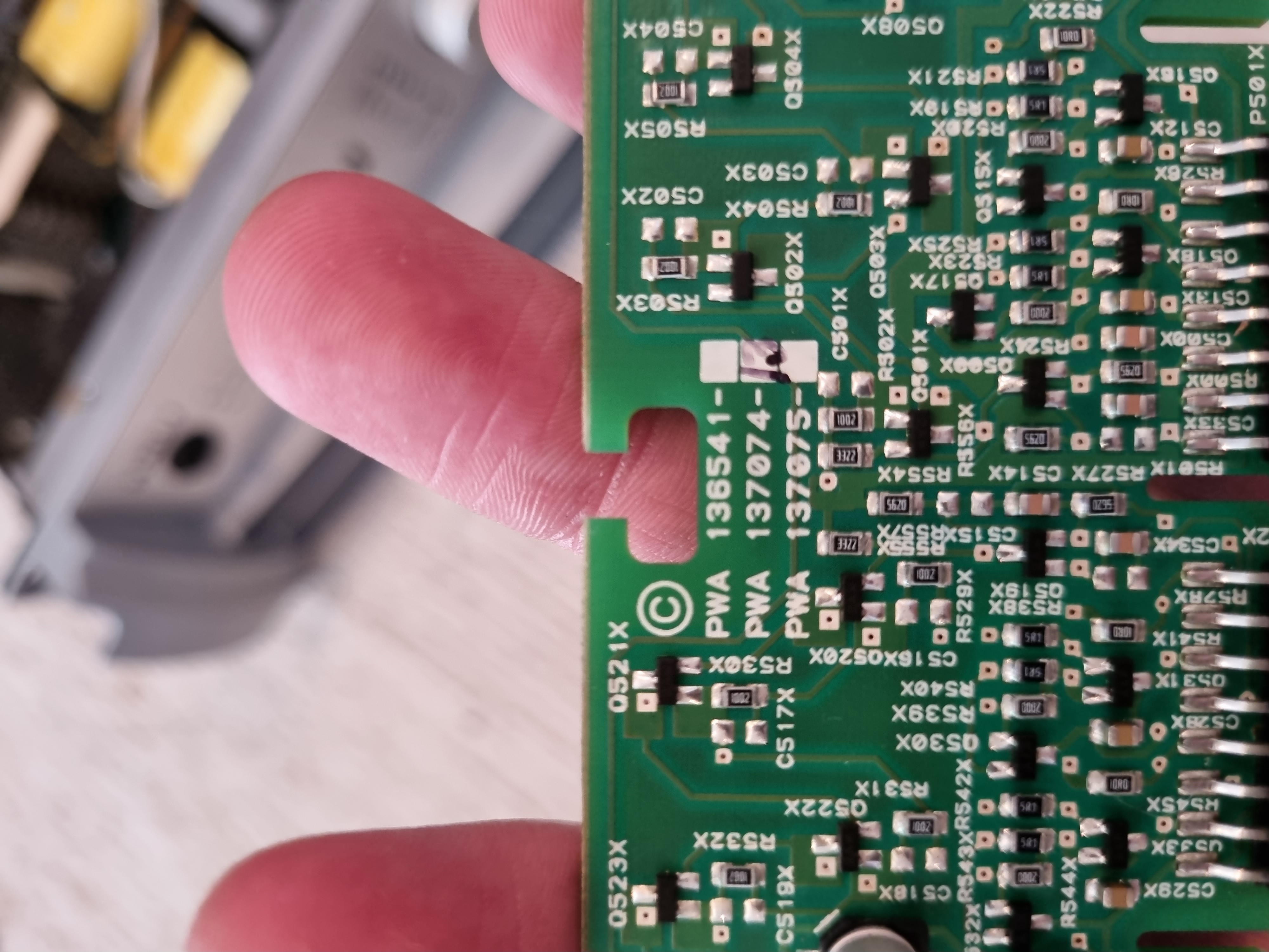

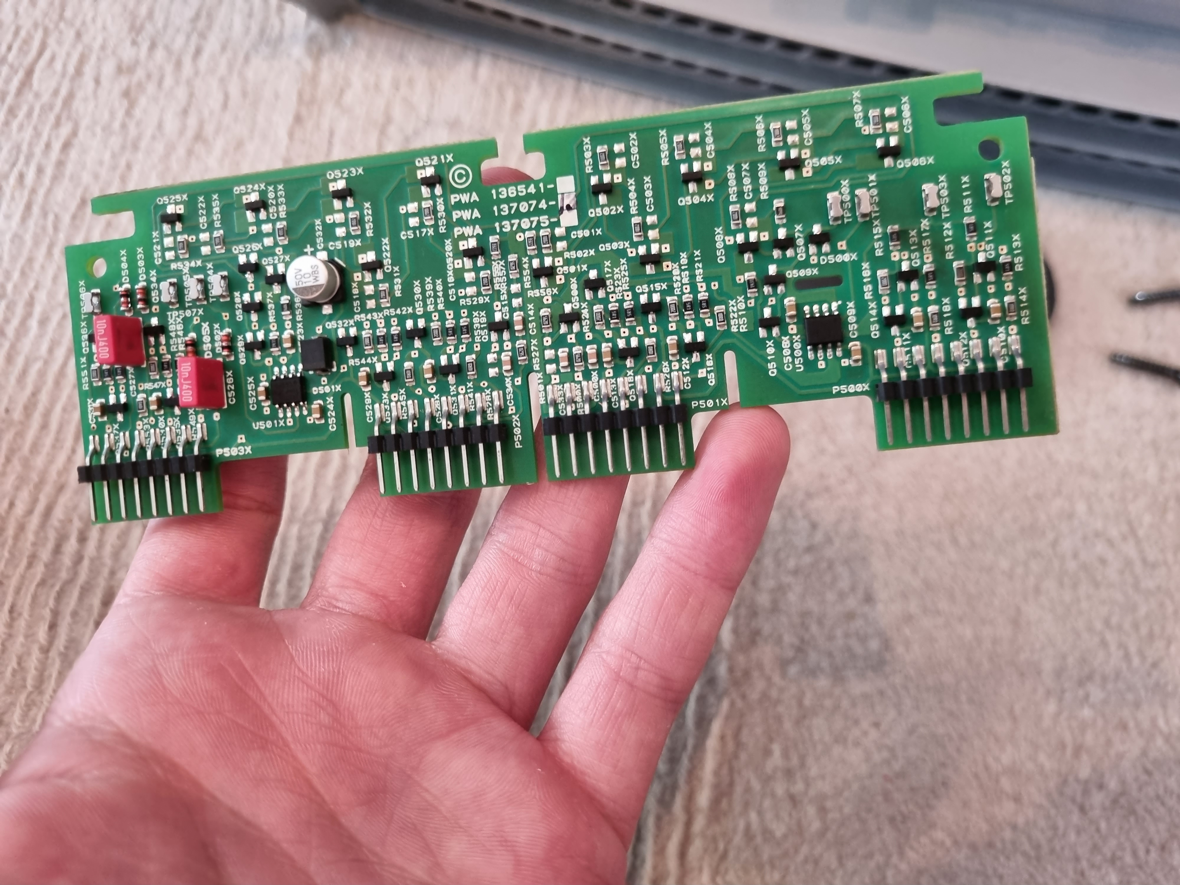

I have a crown IT 6000 amplifier, channel 2 works flawlessly hovered channel 1 has no audio output whatsoever and is plagued by a clip light which is constantly on. However when the channel is left untouched while it is muted or off, the clip light turns off, when u then try and turn up the volume, the light returns instantly. The "ready" and ‘signal’ light are also both on for both channels showing they are infact on and getting signal. The clip light also stays on when no signal is plugged in. I have had a look inside and reconnected/cleaned internals up a bit, I've noticed 2 daughterboards inside, one for channel 1 and one for channel 2, both have leds to indicate their operation, as soon as the led on that board lights up for channel 1, so does the clip light. I've tried swapping the board for channel 2's identical board with no luck, so the daughter board is not faulty? Any other suggestions I should test? Or what could be the cause of this light? I've heard it's a common issue. Thank you!!

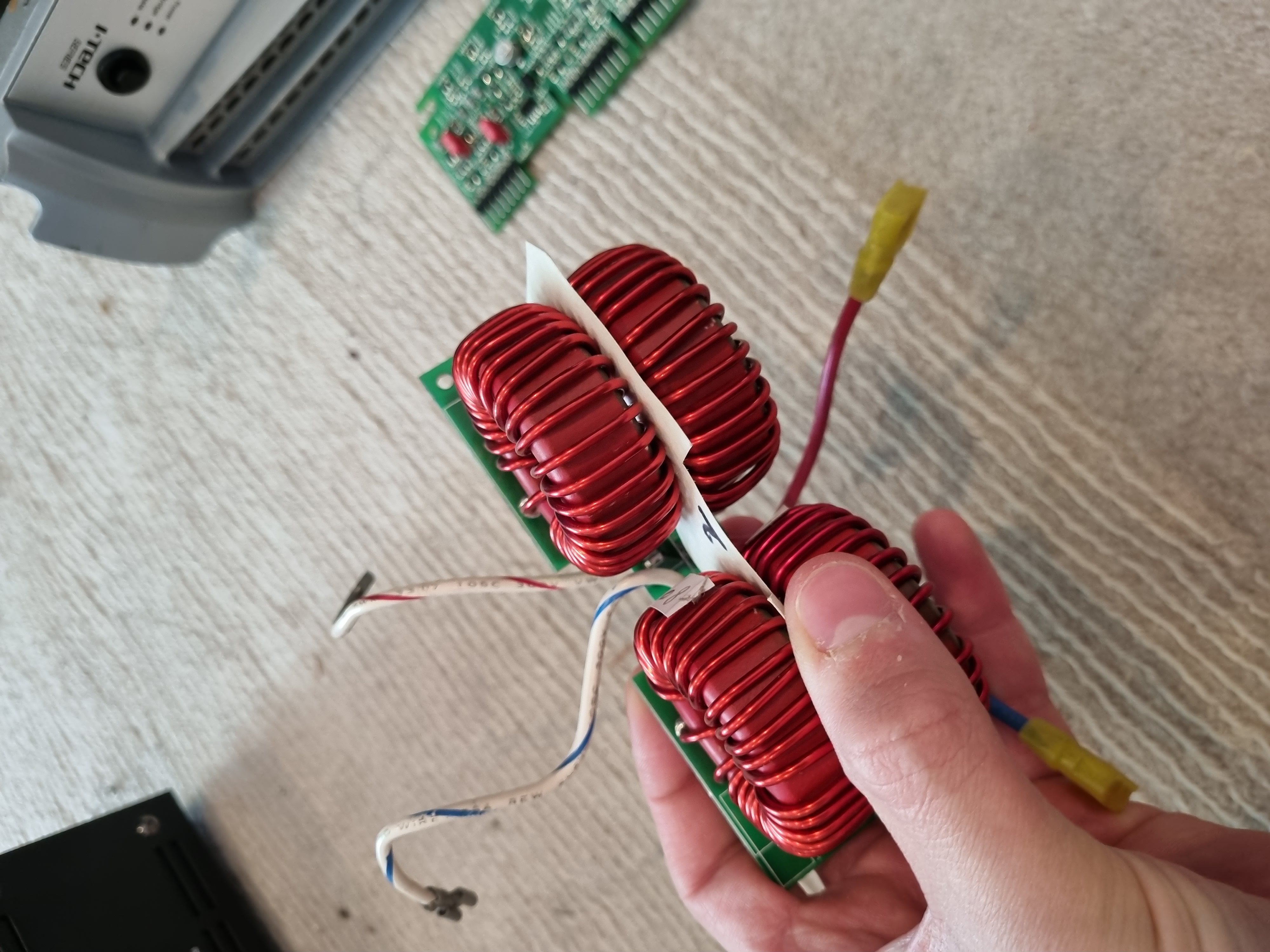

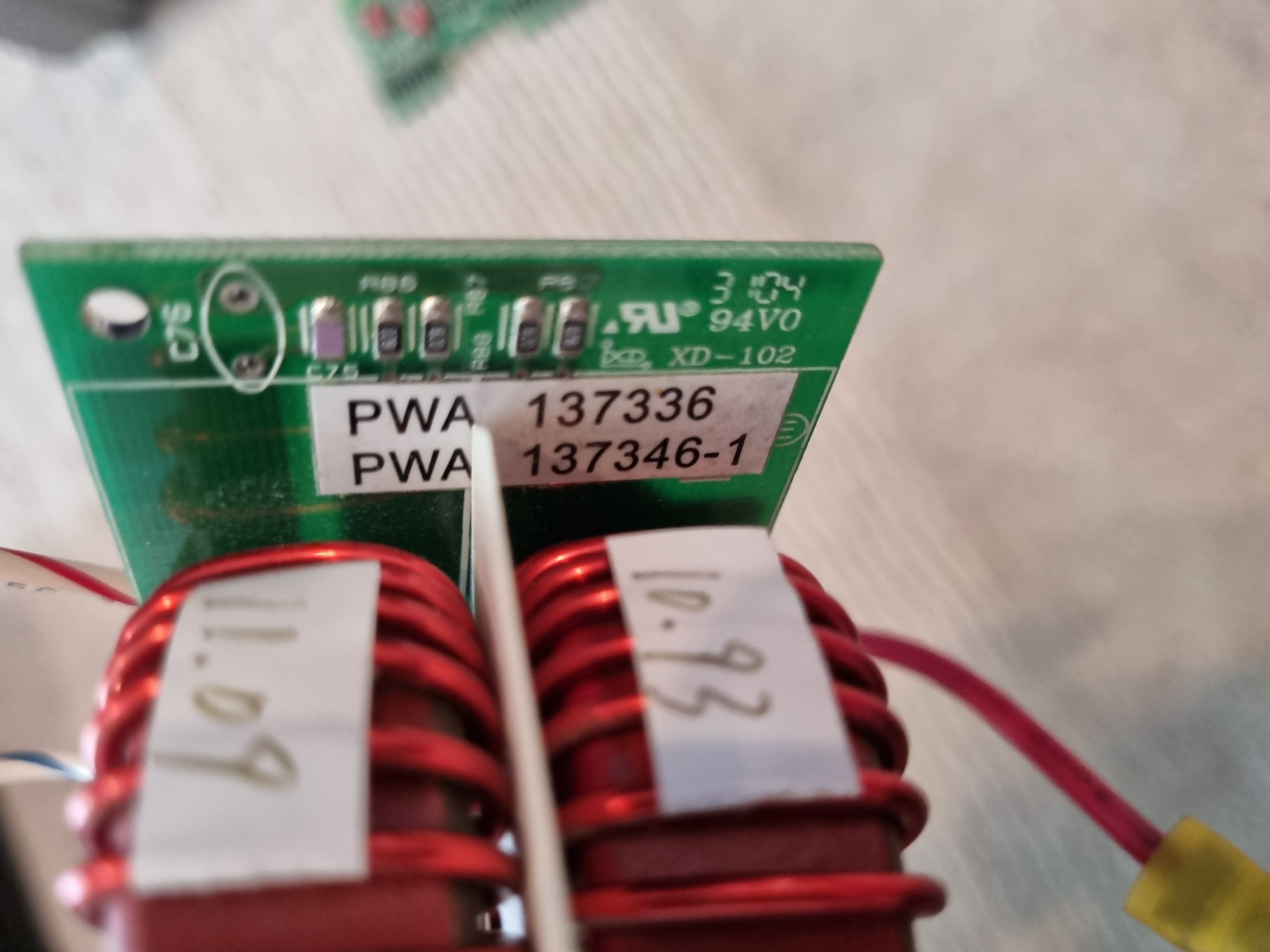

I have determined its due to 2 parts simply missing from the amplifier, I have attached pictures of these parts that I need. Any ideas on where I could find these or if someone has any spare it6000's lying around?

I bought the amp for dirt cheap knowing about the issue, it turns out it has some broken diodes on channel one that short out when connected, so to still be able to use the other half of the amp the previous owner has removed parts of channel one so that it doesn't short. I would love to fix it however, as I think it's a pretty sick amplifier. I've read into the service manual a bit but it's like 177 pages so that will take a while lol. I've also contacted crown who might be able to send me some parts. I was just hoping someone had a better idea of where I could obtain these parts. I've already checked ebay btw for other broken it6000's.
