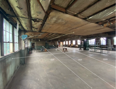

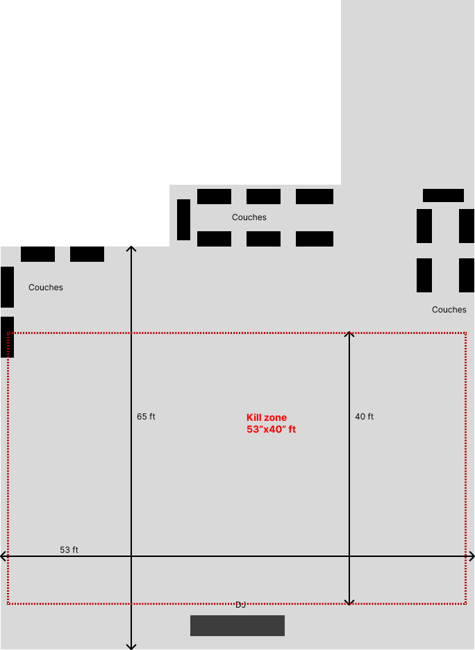

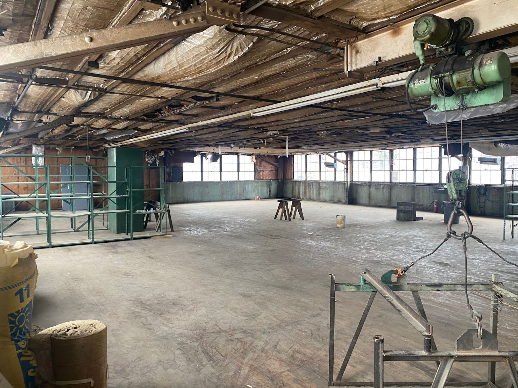

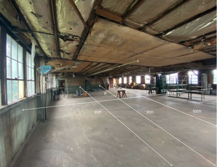

I am looking for guidance in selecting from Speaker hardware's precut kits. Or other similar options. I am building a system for a electronic music club. The audience is likely to be standing right up against the PA as is often the case. These are the room dimension and images of the room. Would expect to entertain up to 500 people, often 2-300. Guidance on treatment of the space itself welcome. Thanks!

Next up, despite you saying your audience will want to be at the Mains cabs, you need to specify X dB at Y location in your space (eg 100dB at the Bar) so we can help you determine how many cabs that may require, obviously keeping in mind any statutes about noise limitations in your space.

There's a lot of glass in that venue, are you 100% locked in already? If yes, you might wish to begin discussions with a noise control expert solution provider in your area.

Room acoustics: We have an opportunity to renovate with decisions that are driven by the room acoustics. We have no idea how to approach this. Perhaps just sheetrock the ceiling and then get the system built and test to decide what and how to sound treat the environment.

Regarding the acoustics, any hard surface is a problem, be it walls, floors, ceilings or windows. Some things you can't fix, like floors in a commercial setting. That makes it more critical that the rest be non-reflective. That can be accomplished with drapes on the walls and windows, flame proof of course. Various ceiling treatments can be found as well, even drapes if you're creative.

I know nothing at all about what you know about PA/ Sound, but the reason I said earlier you need to specify X dB at Y distance is because PA's and sound follow the laws of physics. Adding cabs increases response at a known value, as does distance decreasing response at a known value. Both are utilised to calculate response at a certain point or points in the room.
While that will be greater nearest the cabs, it may not be best for the entire room.
