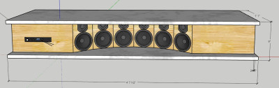

I am designing/making a floating center channel shelf. The center channel is a SLA design from Bill Fitzmaurice. I am also making a portion of the cabinet a 8" subwoofer.
I would like to make sure that i have selected the correct bass for the cabinet space.
I will be attaching 4 satellite speakers to this setup.
Most important is the amp setup.
1. For the center channel and sub -- Sure Electronics AA-AB32971 2x100W Class D
2. Satellite speakers -------------------- Dayton Audio KABD-430 4 x 30W All-in-one Amplifier Board with DSP not sure how to connect four RCA to this. so 2 Sure Electronics AA-AB32165 2x25W.
How to get the TV signal to these amps??
Would this work? ATNEDCVH 5.1 Surround Sound Decoder Separator Converter on amazon.
I was unable to find any boards with ARC HDMI or opitical input 5.1.
I have attached the cabinet design and here a list of the drivers for your info.
Center channel.
6 - Godwood GW-4028s
6 - HIVI T20 8
Sub
1 - Goldwood GW-408D
The SLA is enclosed to the dimensions via your layout. The sub area is closed "sealed" via the bass box dimensions. The other side for components will be enclosed to hide amps.
Center channel.
6 - HIVI T20 8
Sub

final look
Re: Ok, Bill you told me to post here. SLA center channel
belzarrath, first of all, welcome to the forum!
Now, I have to say that I am curious as to why you are preferring the amp boards over an AV receiver. Just curious, is all. I have that tinkering mind as well, but, by the time one adds up the cost of all the devices it seems to make more sense to go with a AV receiver.
Also, are you tied to that form of subwoofer cabinet? Looking at the photo shared, it seems that an TableTuba would fit wonderfully under the centre channel (could build a false back/side end so that it is 55 1/2" long.

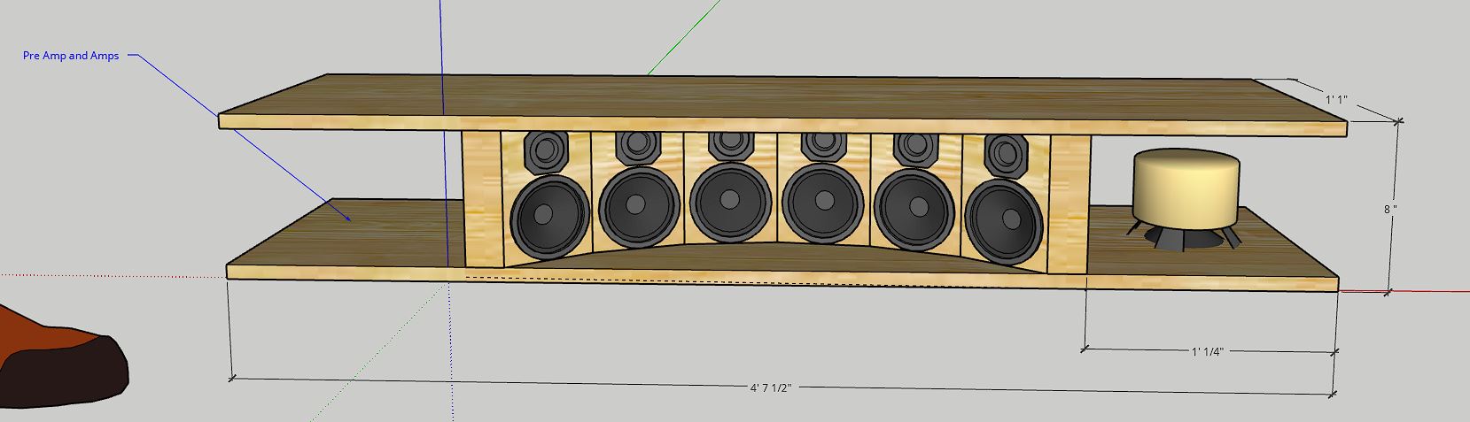

Well yes I like to tinker, and no it does not always work out.
I am in the process of build a cabin,,"4 yrs" and I am close to furniture, stage. I am very European Modern design, All cabinetry Kitchen and bathroom are a floating design, and I would like as well to have this shelf be the same. Wires and mechanic hidden. Only thing I could think of to get amps hidden, is for them to be small amp boards. I'm willing to take suggestions.
I will look into TableTuba and see if it fits, here is a new picture of finish look.
Most often when speakers and sound are concerned quality and performance would be my main concern, In this build its design then performance.
Look I am going for but in a shelf speaker.

It's not going to work. First off, to have enough output to keep up with the SLA using direct radiating woofers you'd need at least two eights. They would have to be subwoofer drivers. The Goldwood GW-408D is not a subwoofer. Then there's the matter of space loading. You're not going to get it having the subs that high off the floor. If it made any sense to do what you propose that option would be in the plans.
Absolutely.by the time one adds up the cost of all the devices it seems to make more sense to go with a AV receiver.

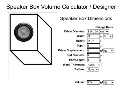

If it makes a difference the 8" is a sealed box design of .63 ft^3 not ported.
Is there a sub you would recommend size 6"-8" that would work in a cabinet of that size. I am just looking to get additional low end.

Put an 8” sub driver on both sides even if the amps are in one side. That will get you closer to enough.
I think your idea is great but I see what Bill is saying, if you want a correct balance of low frequency to match you high stage you will likely want a more robust/sophisticated subwoofer configuration. At first glance I agree that doing away with the floating aspect you can use the space and put a sub on the floor beneath the SLA. Table tuba long version using an 8” driver would get it done!!!

It/they would need to be horn loaded, but if you were prepared to lower the bottom of your sub cabinets to say 5cm from the floor, you would at least get some loading then.
Hang them off the wall with a french cleat. Look that up if you don't know what it is...

Greetings mate, hey your floating Curve array centre channel shelf is going to look slick, great idea.. I feel though that trying to cram everything else in there will be a pain. Just as the floating sink has its plumbing hidden in the wall, would you consider running wires in the wall cavity from a receiver (which can be anywhere in the room) that has all of your connectivity and power needs, and choosing a BFM HT sub design (which can be in the best placement for the room, and not take away from the floating look your aiming for) that can be run from a board amplifier? How much bottom end are you chasing?

Not really, unless the shelf was the same size as the floor.belzarrath wrote: ↑Tue Dec 06, 2022 7:21 pm Would putting a shelf under the shelf produce the same effect if it were 5cm under the speaker?
You see, it's the floor plane that's allowing loading.
Floor loading would add some (say 3) dB in some of the sub frequencies. That would be more important when you wanted to use low power subs. But if I read correctly and you're now thinking dual 8" loaded sub, then you probably need to be less concerned with loading.
Hope that makes sense...
