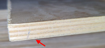

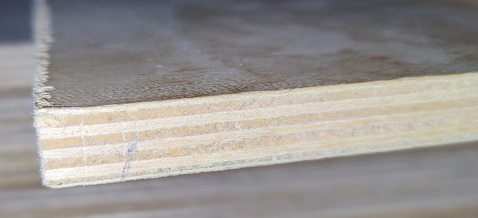

Post a photo of the edge of the piece in question, showing the laminations.

Seth wrote:Post a photo of the edge of the piece in question, showing the laminations.
Ok, posting as an object lesson "kids, be careful, there is a lot of crappy plywood out there."
I think I have enough good half inch plywood to do the job, but if not I'll glue together some of the 1/4" BB. Not worth the risk to use inferior materials.

Looks like standard 9 ply BB to my eye.

You can see it better on the bottom than the top. The veneer is almost the same color as the second to last ply so I also thought the "birch" plywood was BB. That is what is so pernicious about some of the cheap veneer plywoods. I didn't know I'd gotten the wrong material until I had it home and got it under sun light. The top side, which is the A side is so thin you almost don't see it in this pic.

I'd completely use it for your intended parts and just make it so that surface is toward the driver and the other side gets the glue, to be on the safe side.
