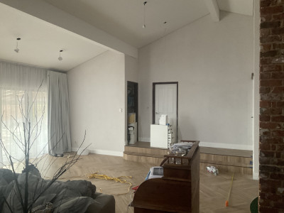

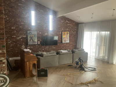

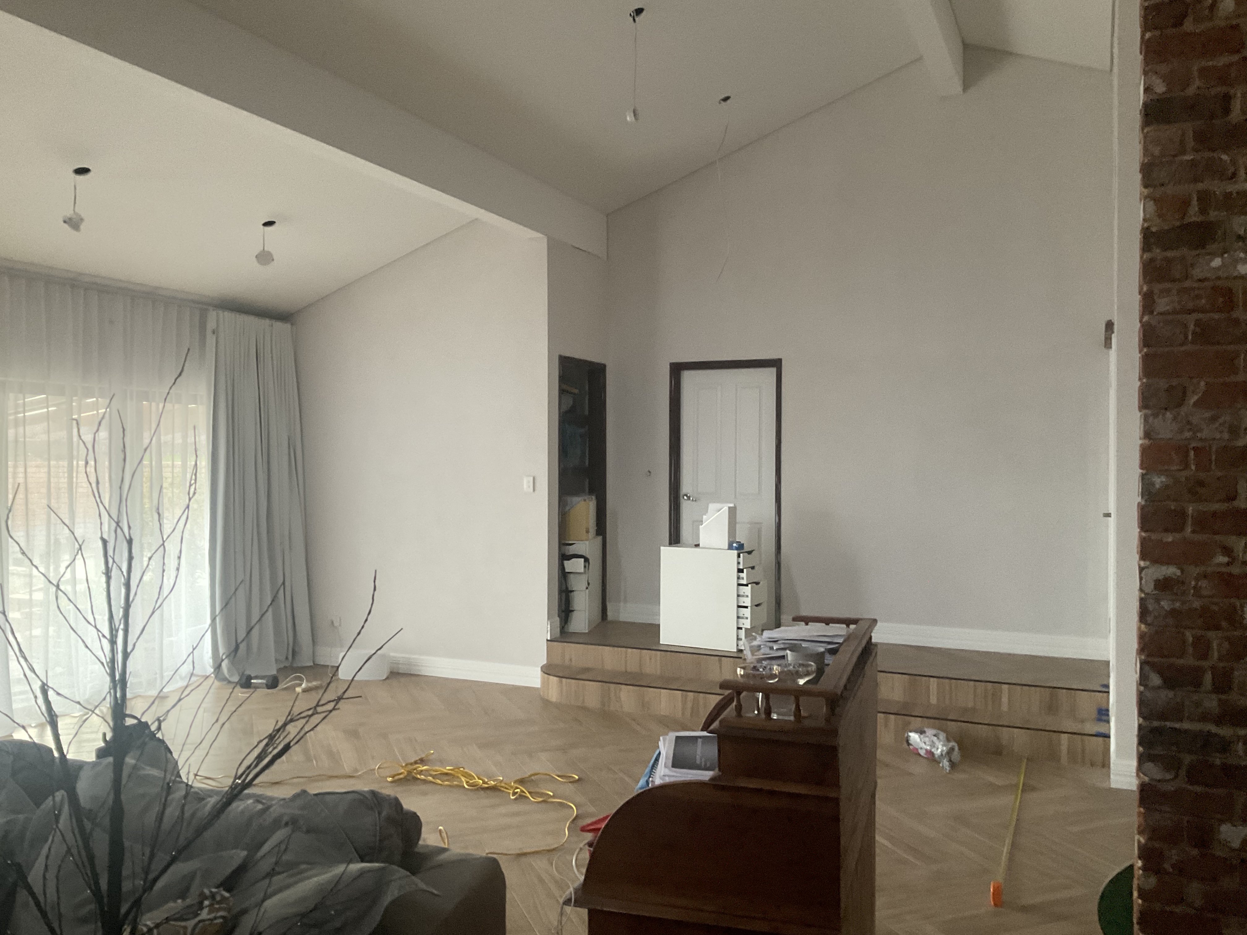

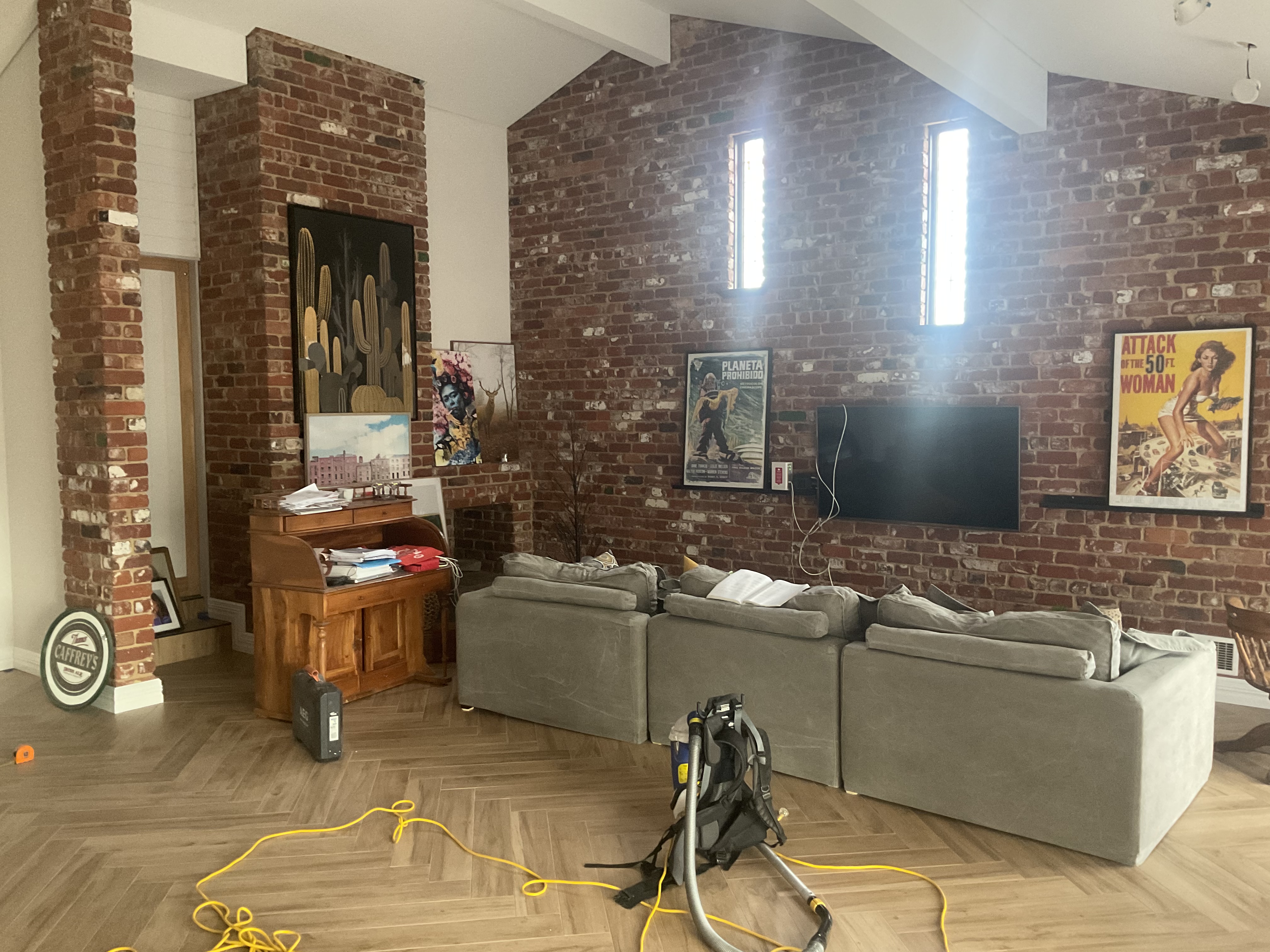

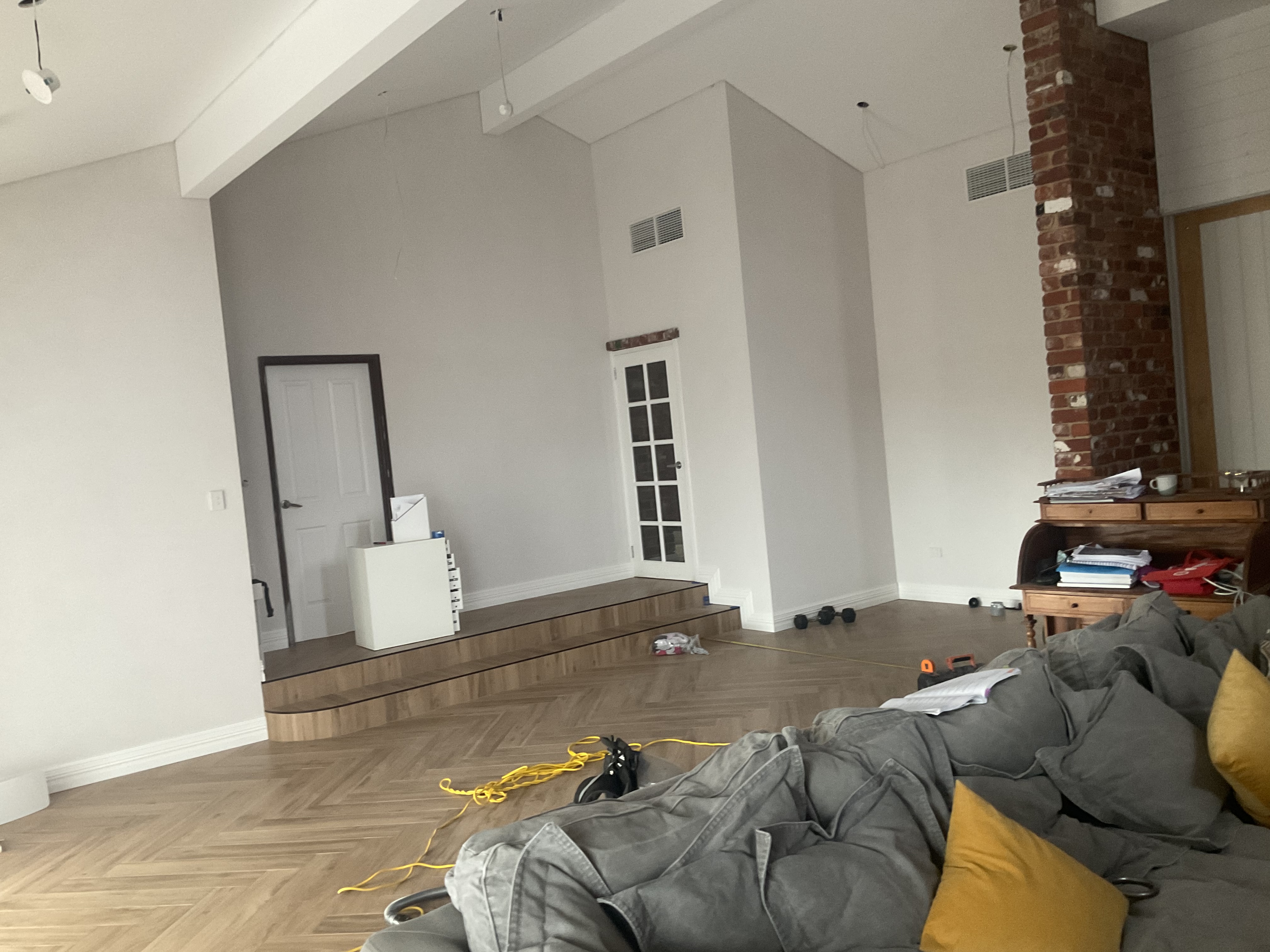

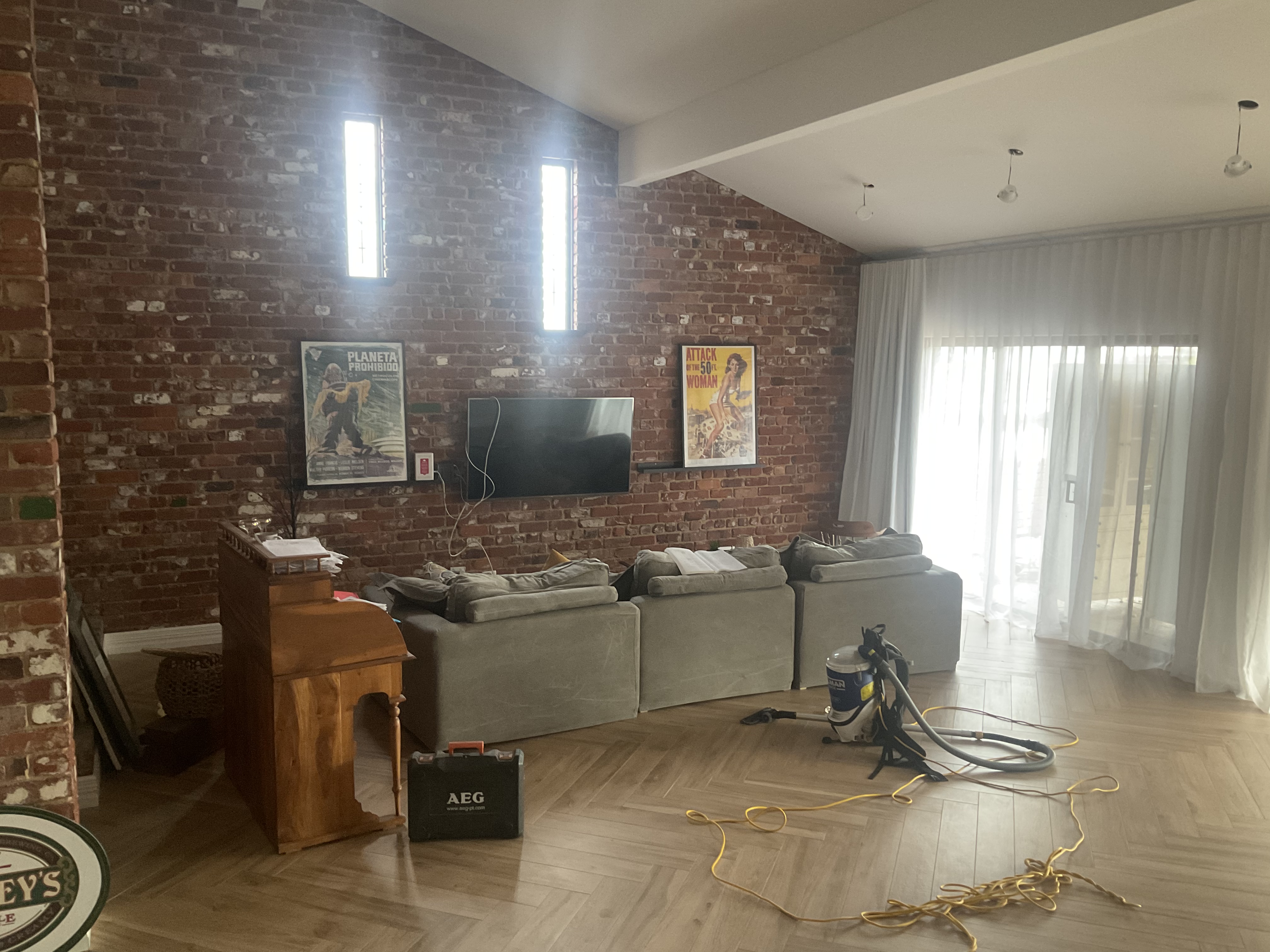

When I get chance I’ll upload some pictures of the room. It’s kinda oddly shaped. Quite challenging acoustics. I have a Trinnov st2 hifi room/speaker optimiser that works wonders. It has bass management for two subs. Going to be interesting hooking up 4 subs. Not sure how I’ll go about that yet.

Pictures taken from each corner of the room.

Interesting room. I see projections that will help break up standing waves. Sloped ceiling helps in offering control of bass frequencies as well.
Is that brick structure with the cacti on it, a storage on the other side, or is it a bell (for heat storage) for the fireplace?
Bill recommended the 16" width. The subs can either be the standard TT, or the TTLS, or a mix for whatever works/looks best in the room.

Yes that projection is a bell for the fireplace. I had to cut out the old fire box (old school heatilator type), wasn’t fun at all. There’ll be a wood burning heater put in its place.
Good to know that that the ceilings and projections will help the bass.
The echo in the room is terrible at the moment.
Hopefully rugs and furniture will calm it down.
Some room treatment will definitely be on the cards. Probably DIY.
