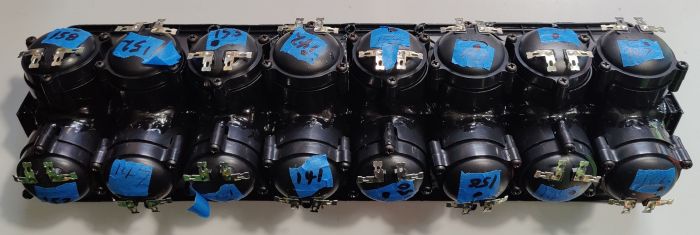

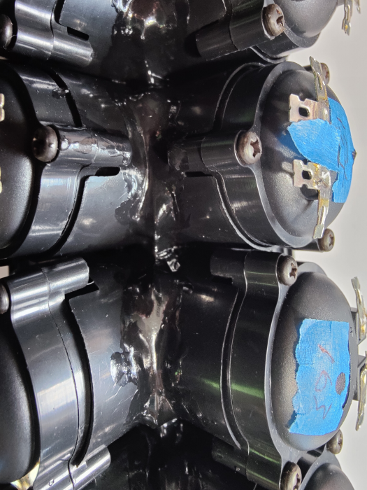

Just built my first two 16-element arrays, and wanted to report on my experience. I used a glue/slurry of about 50ml acetone plus 10g of ABS cut-off material from the tweeters. I was pretty impressed by how well this worked. I was afraid that acetone would harden too quickly, but it was actually just about right IMO. I did two at a time, and there was time to paint each of the sides to be glued. Once I had the tweeters positioned, they were pretty well stuck in a minute or two. After about 2-3 minutes I could pick the array up off the jig to paint the side getting the next pair. This seems to be about ideal for gluing parts without using any sort of clamping other than a few seconds of fingers.
The "glue" becomes more viscous as you use it. By the end of the glue up it is slurry-like enough to thicken joints. At the end of the build I was able to fill any remaining gaps and strengthen all the joints. It dries quickly, but I let it cure overnight just in case. By morning the arrays were really strong. I did a break test with a couple of pieces of cut-off I glued and reinforced together and the break was more around the seam than on it.
A couple more things worth mentioning. The color matches perfectly, although the acetone makes it shiny rather than matte. A quart of Acetone is roughly the price of the smallest can of ABS cement. And you already have more ABS than you need in cut-off material. It's rare for me to find something that appeals to me quality-wise, aesthetically, and to my inner cheapskate.

Forgot to mention that I "cured" the loose screw problem poking a toothpick up from the bottom of the screw lug, and then tightening down the screw. Once the screw was tightly in place, I packed the bottom of the lug with acetone-ABS slurry. What I hope is that this holds the screw and toothpick in place, but still allows me to remove the element if that ever becomes necessary.

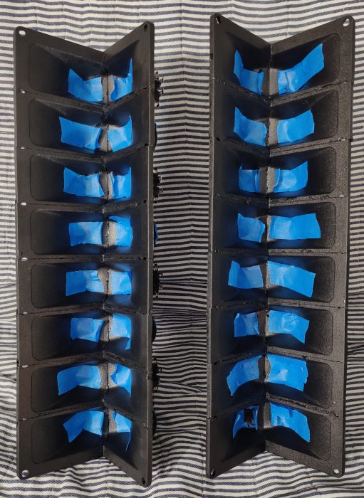

Indeed. Let's see how they came out... show me your tweeties!
Re: Of loose screws and piezo glues...
This is how they look as of today. Fresh off the jig with no sanding or painting.

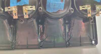

ok, ok see how the screw holes are out of round? I tried to use drill bits, but they would catch. A step drill bit works ok, but i found a cone shaped bit on the dremel opens them up real nice.
They are looking good!
