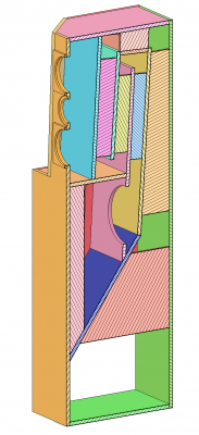

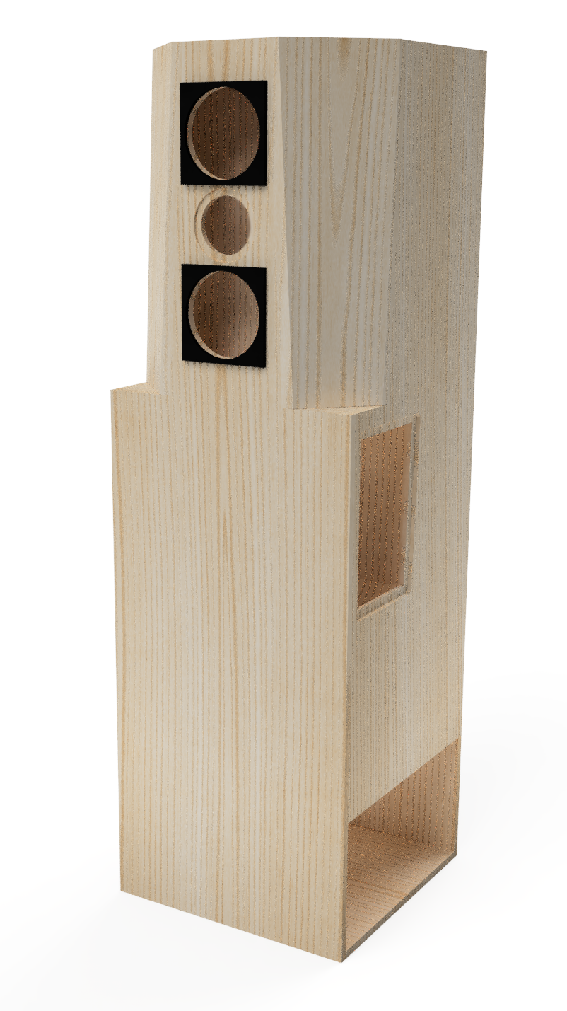

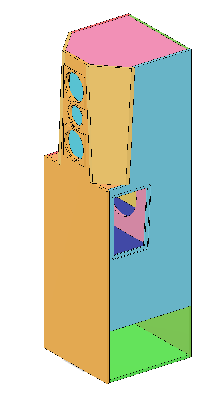

I use Fusion 360 to design and model my own fabrication projects and wanted to use it for this build as well. I started with the plans I purchased from Bill and build a new 3D model to generate fabrication drawings based on the actual thickness of the ply and other parameters I could change. I cut everything out in advance (with the exception of a few panels) and was very happy how it all went together.

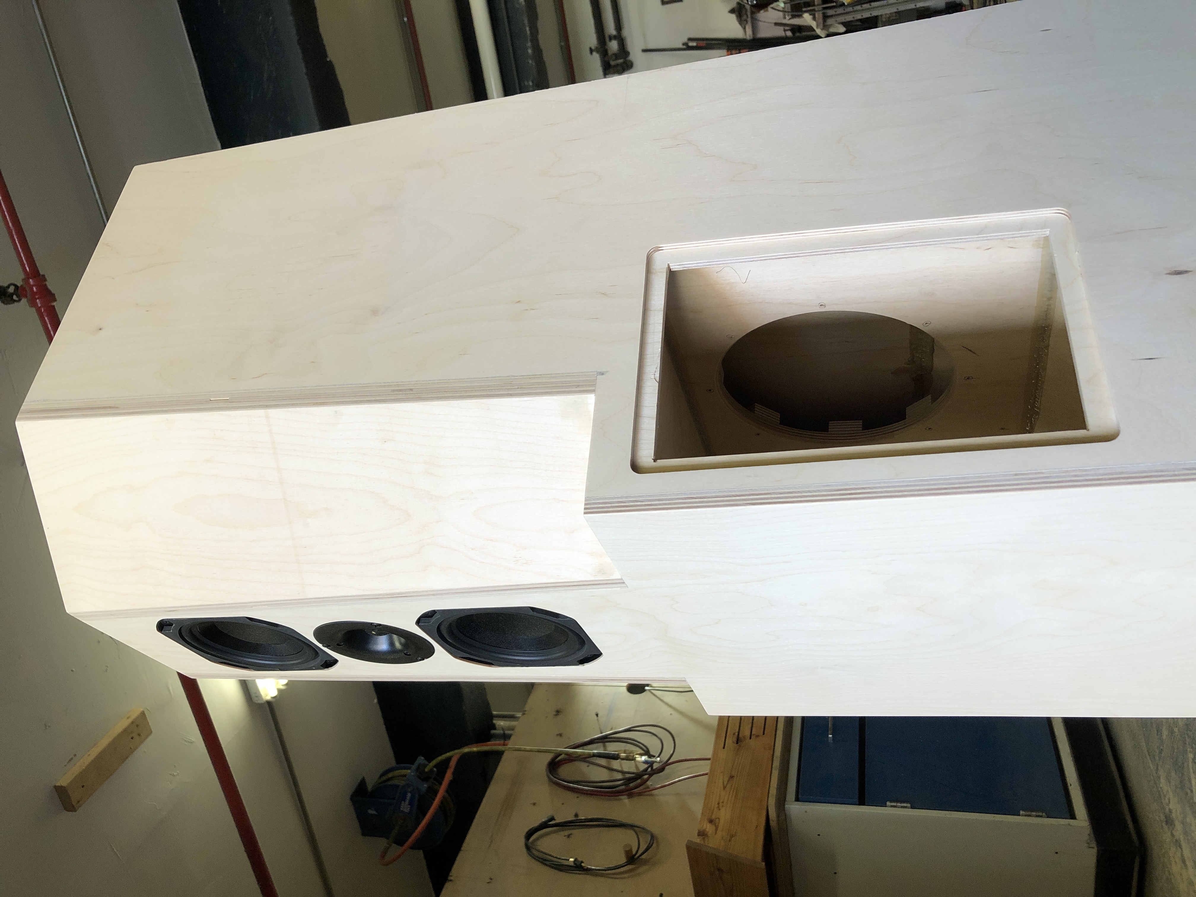

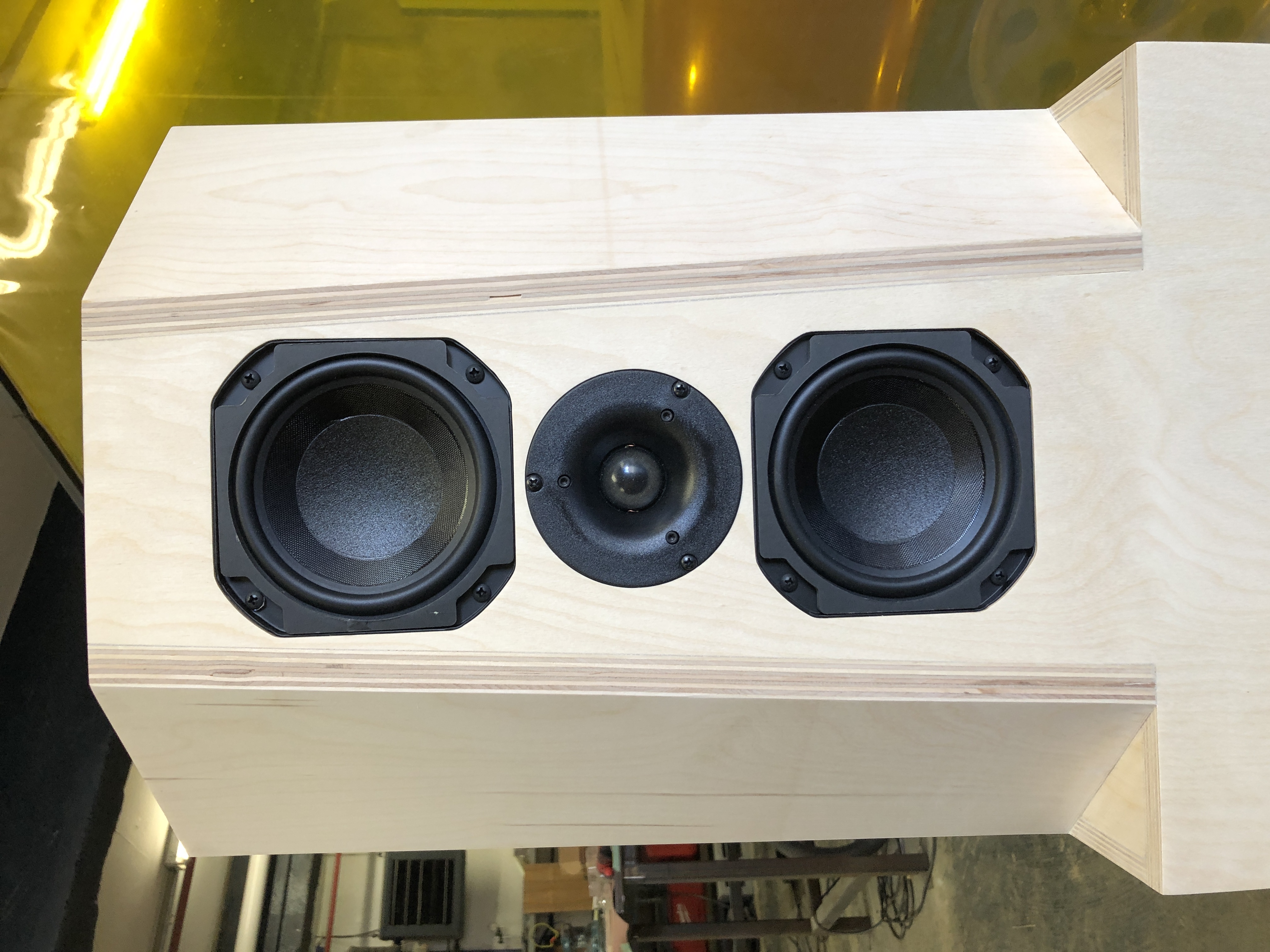

After cutting the recesses for the MTM drivers.

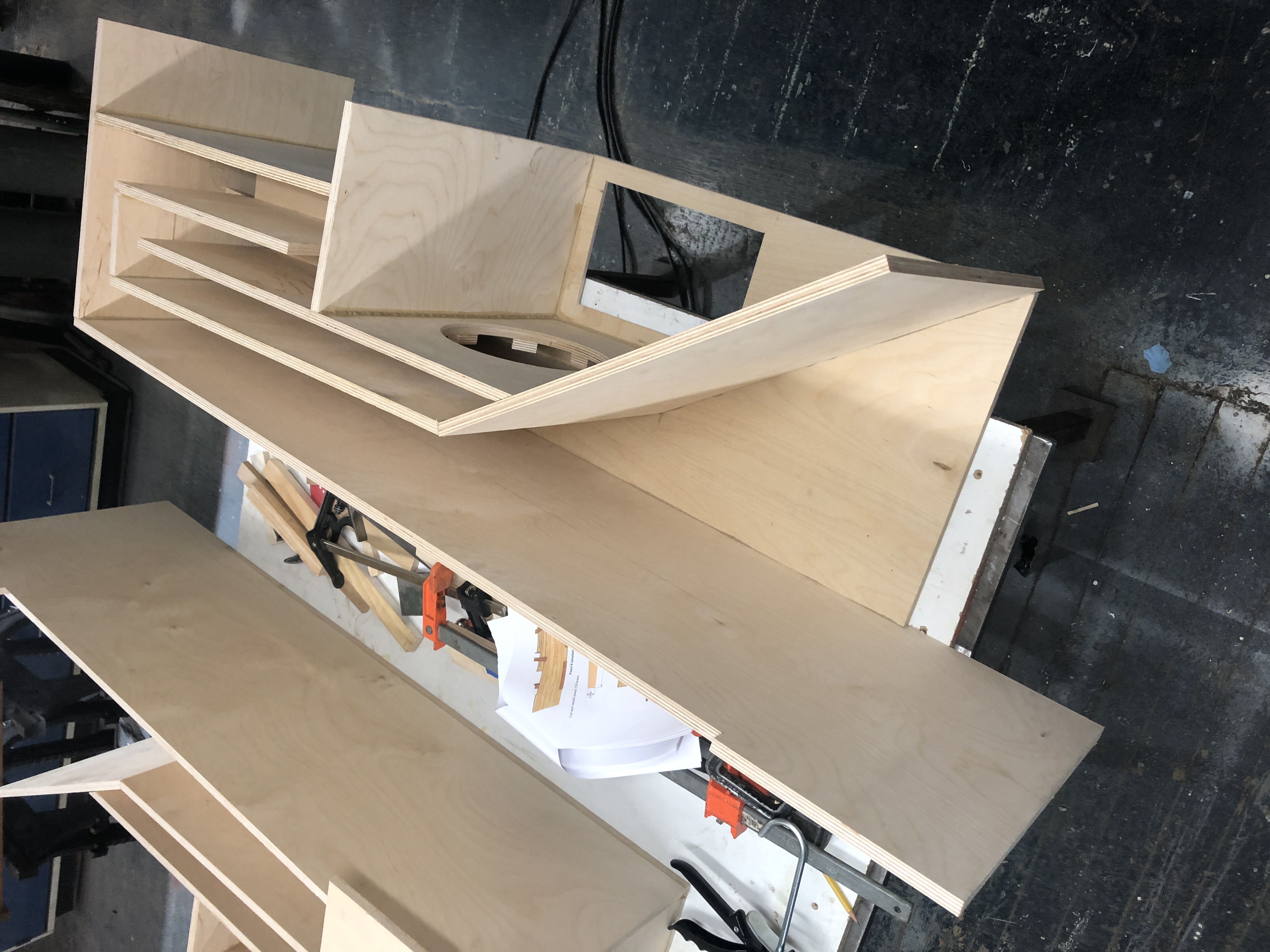

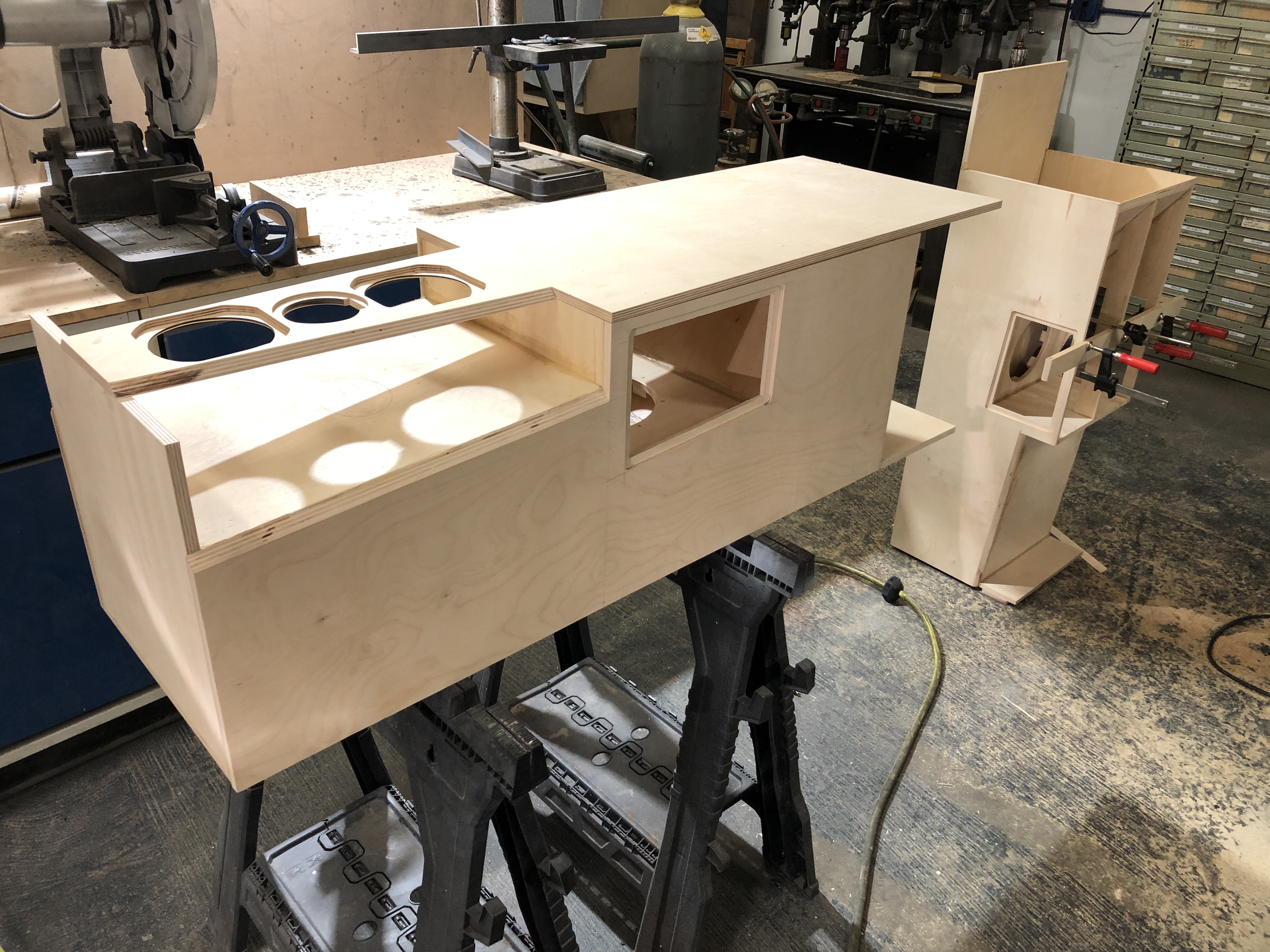

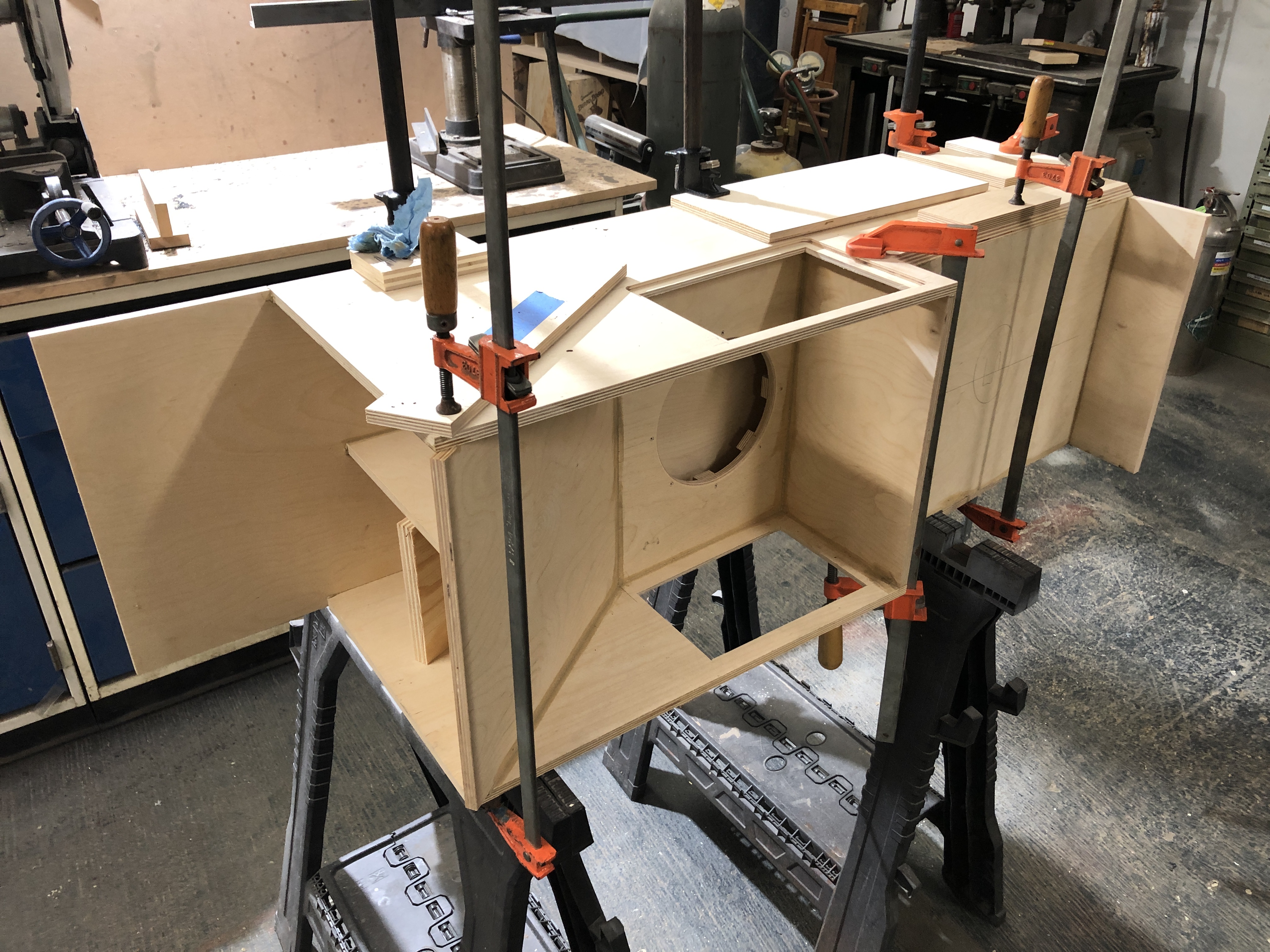

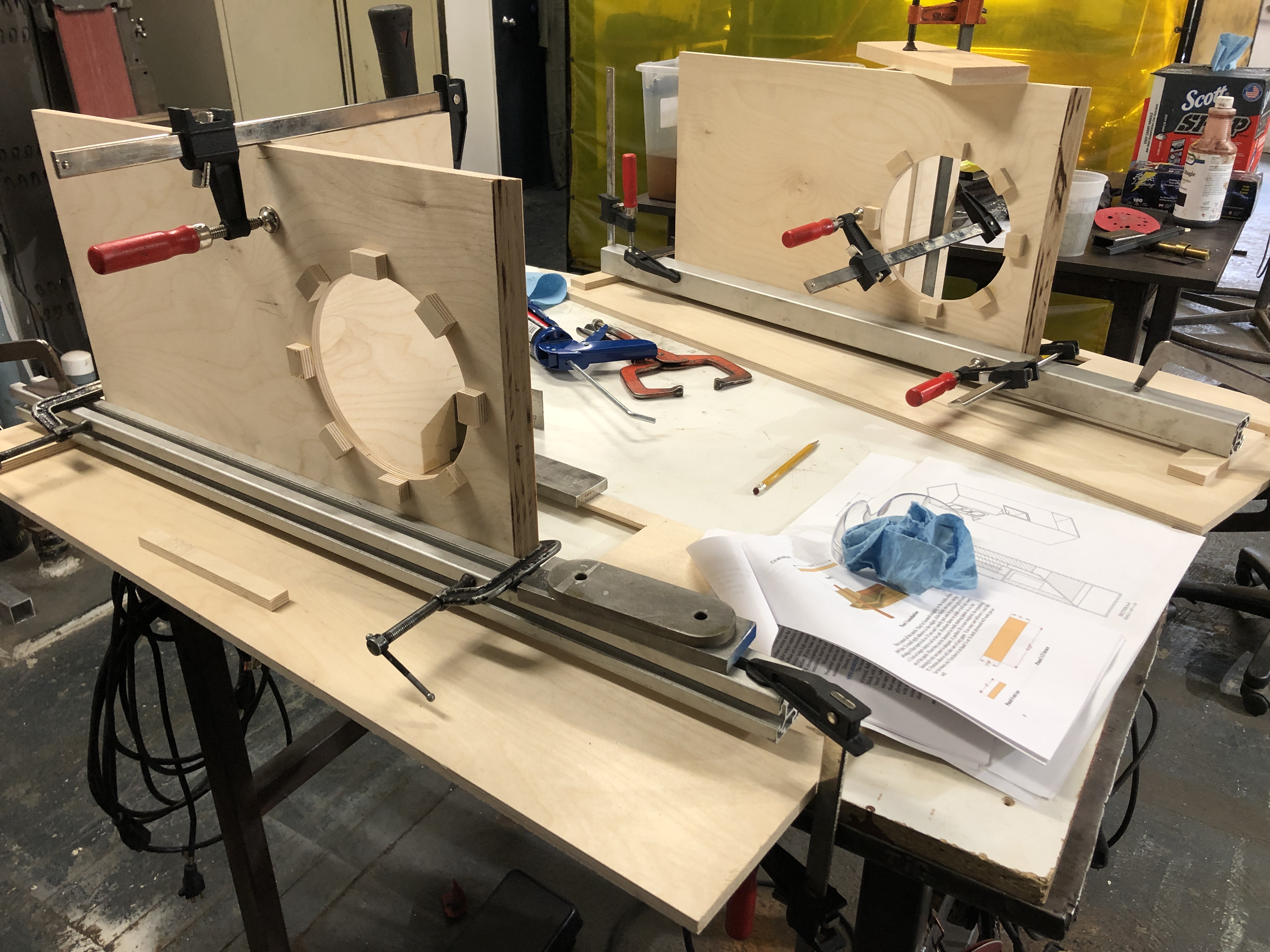

First parts getting glued together.

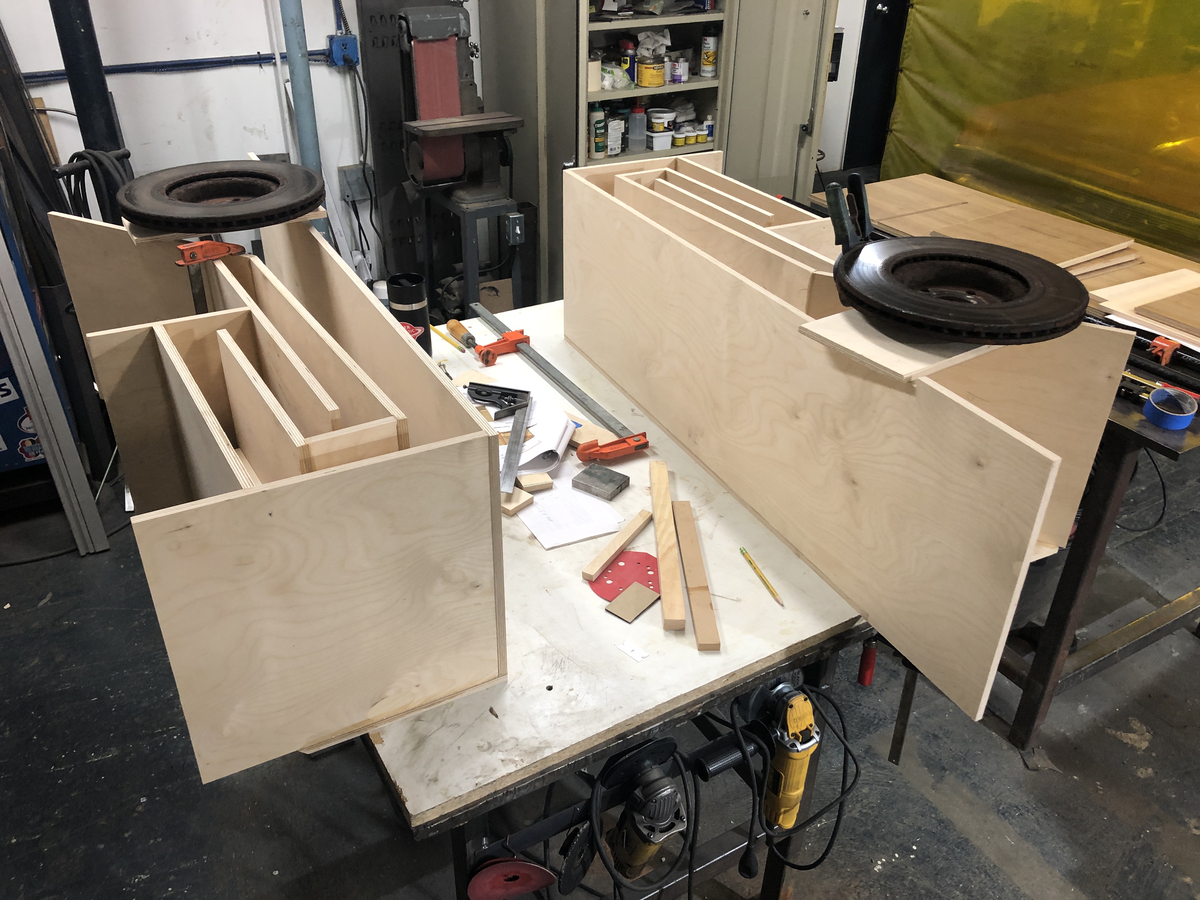

Interior panels glued-up with old brake rotors for extra 'clamping'.
Side panel getting glued and clamped.

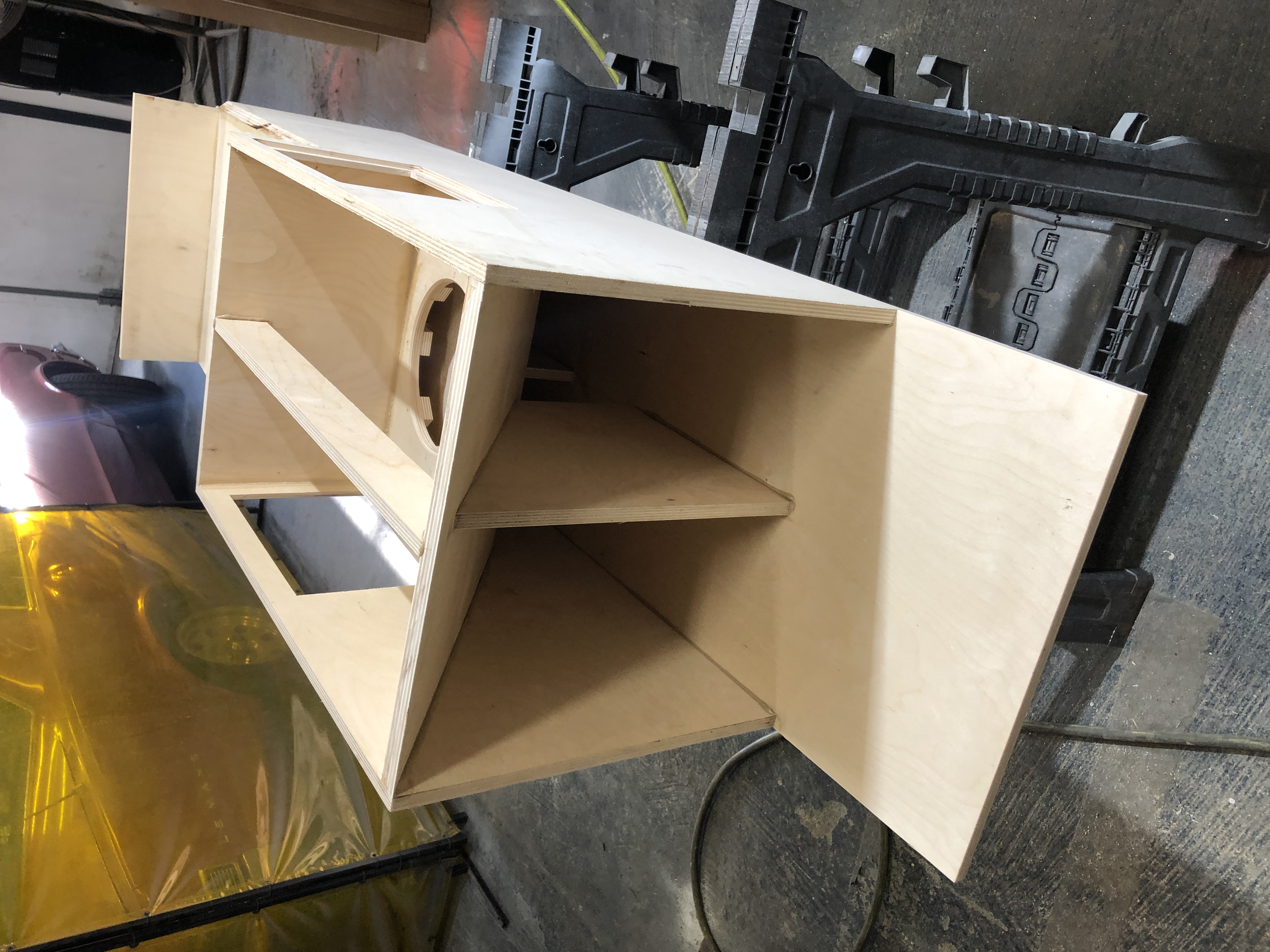

Bottom view showing bracing.

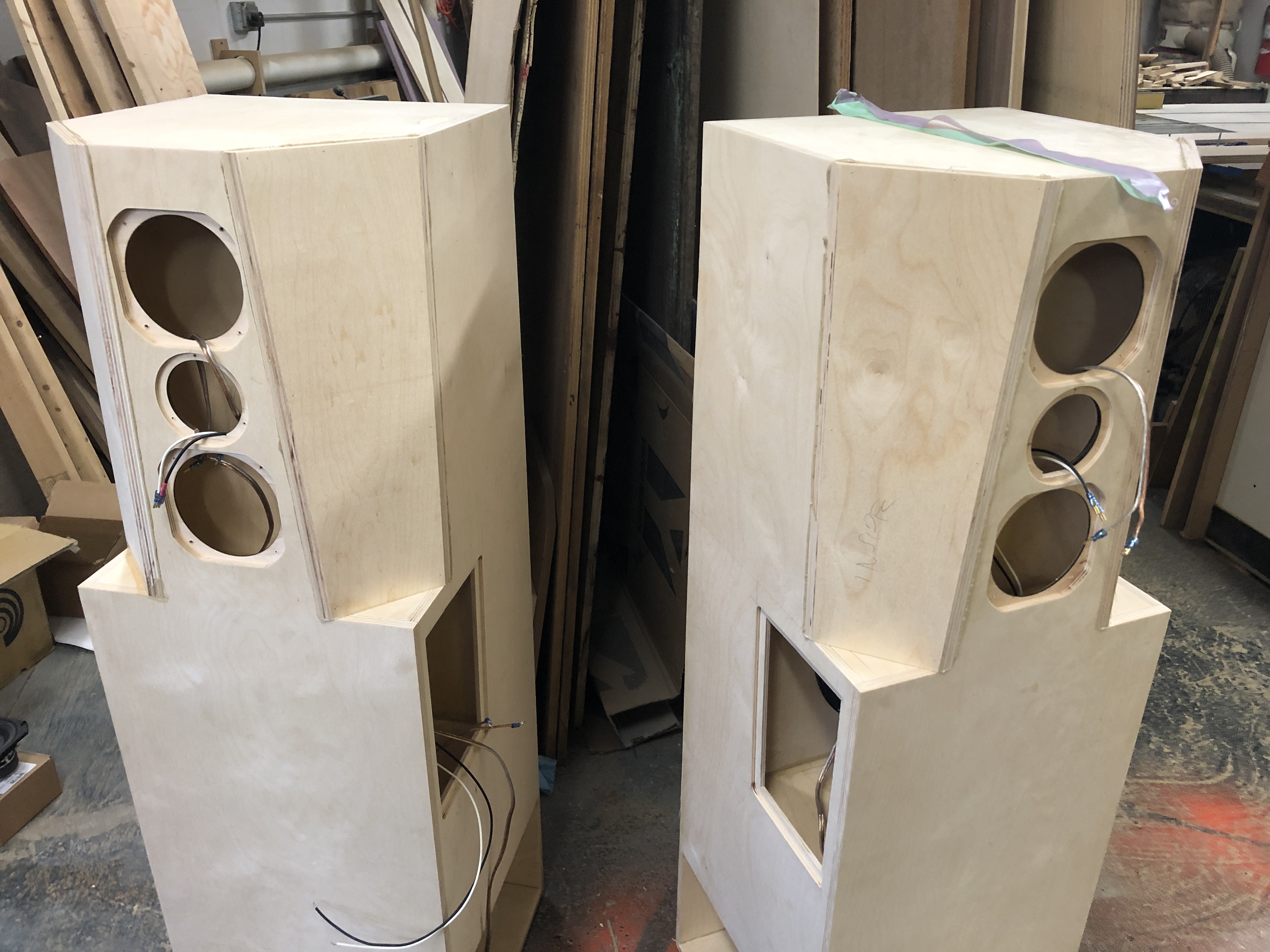

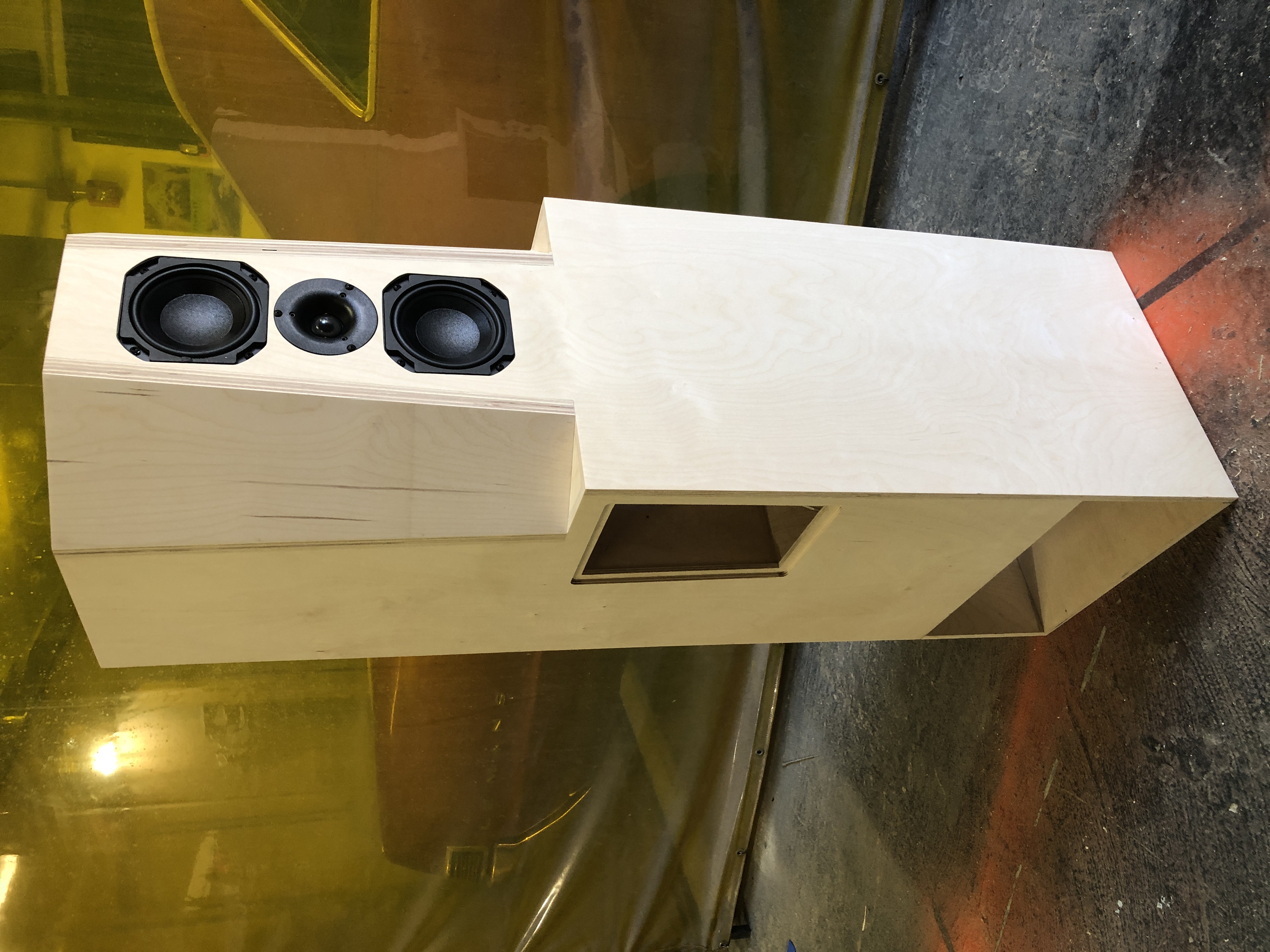

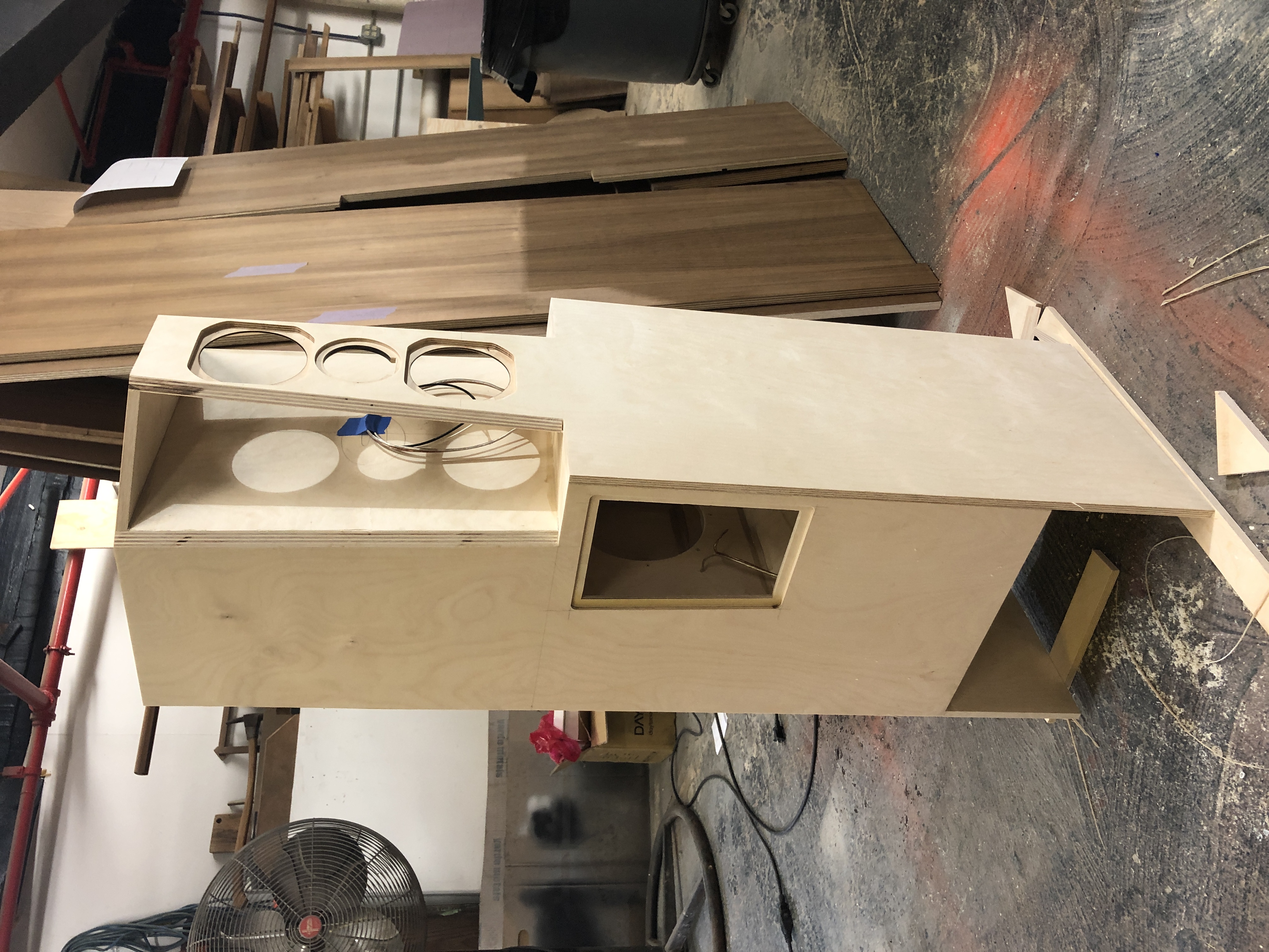

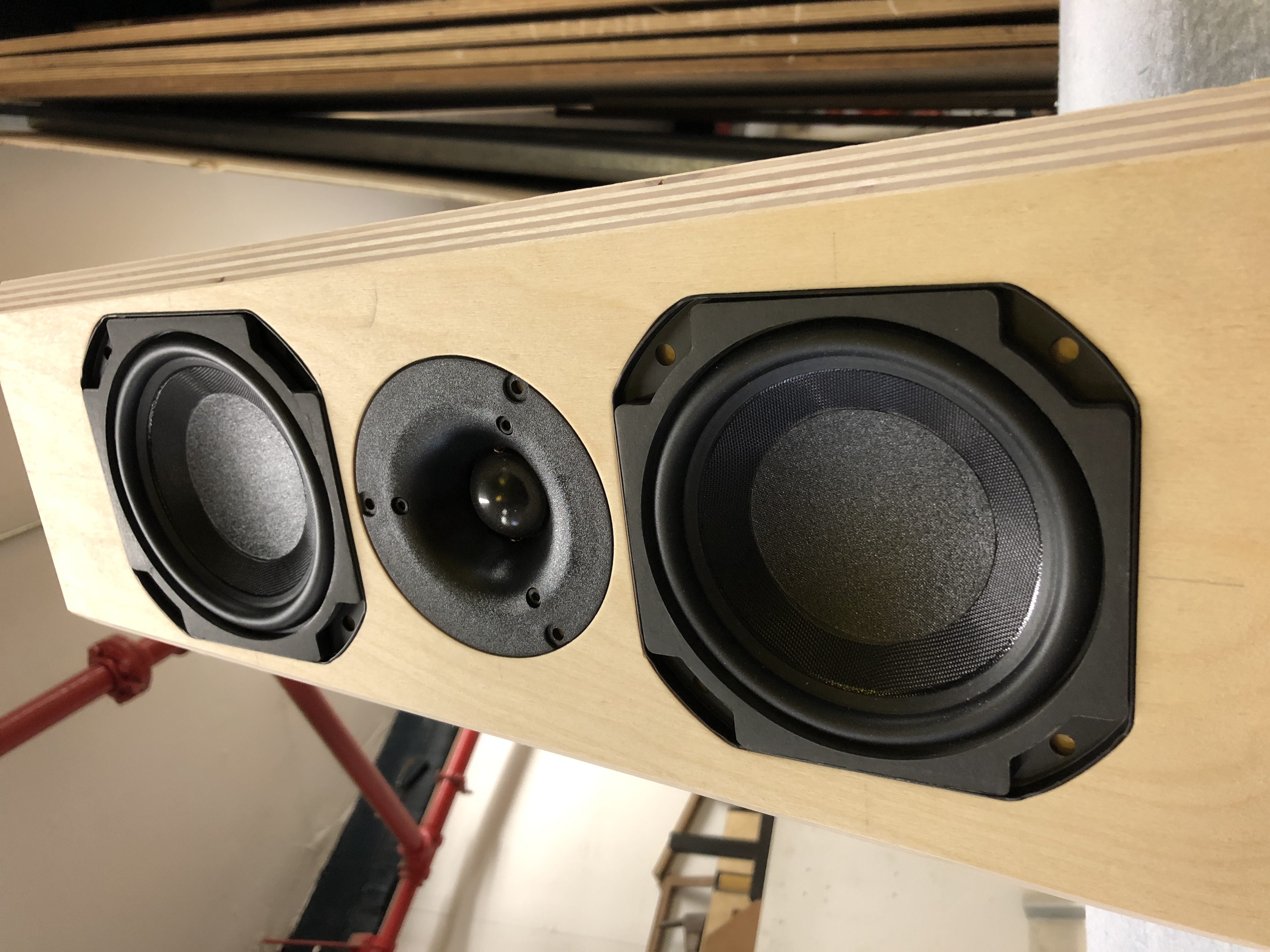

Front panel fitment prior to glue.

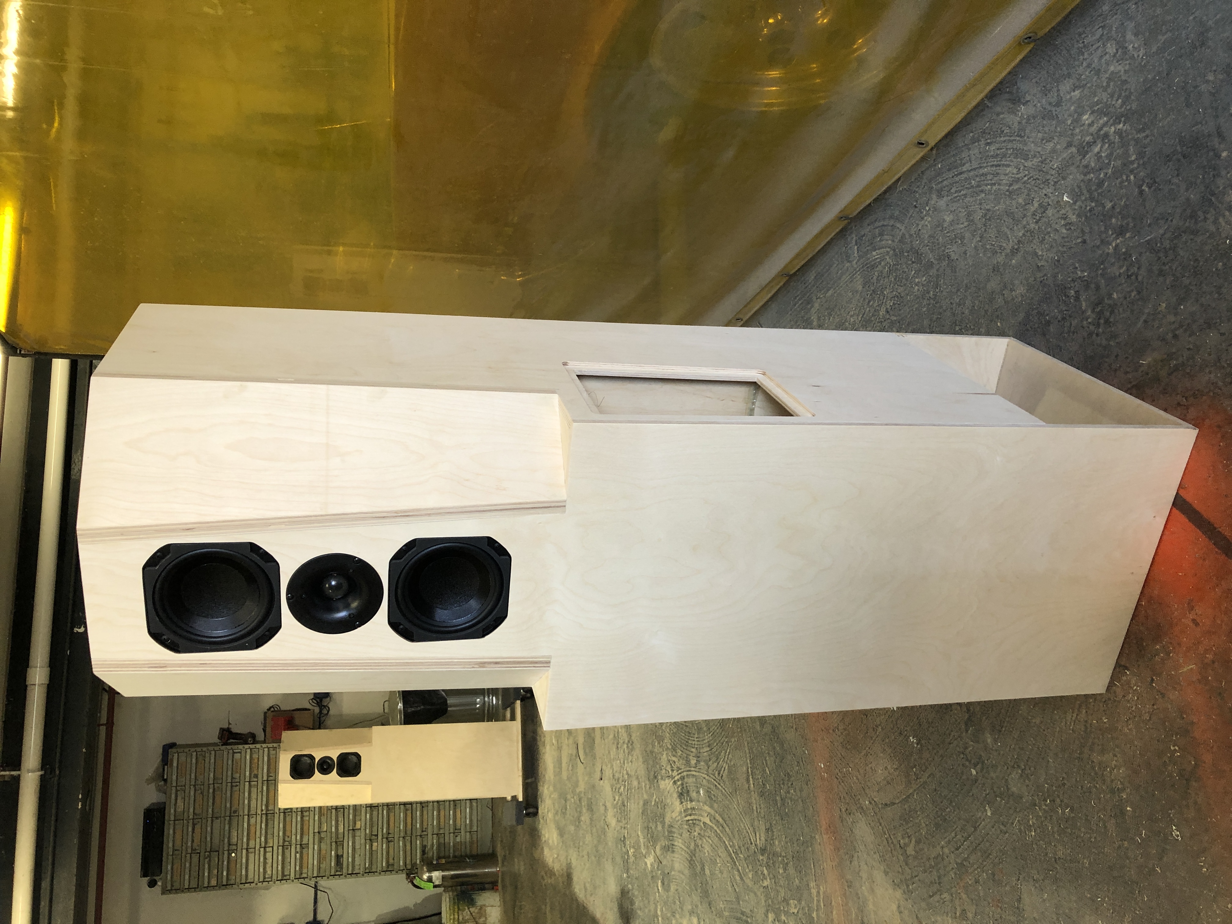

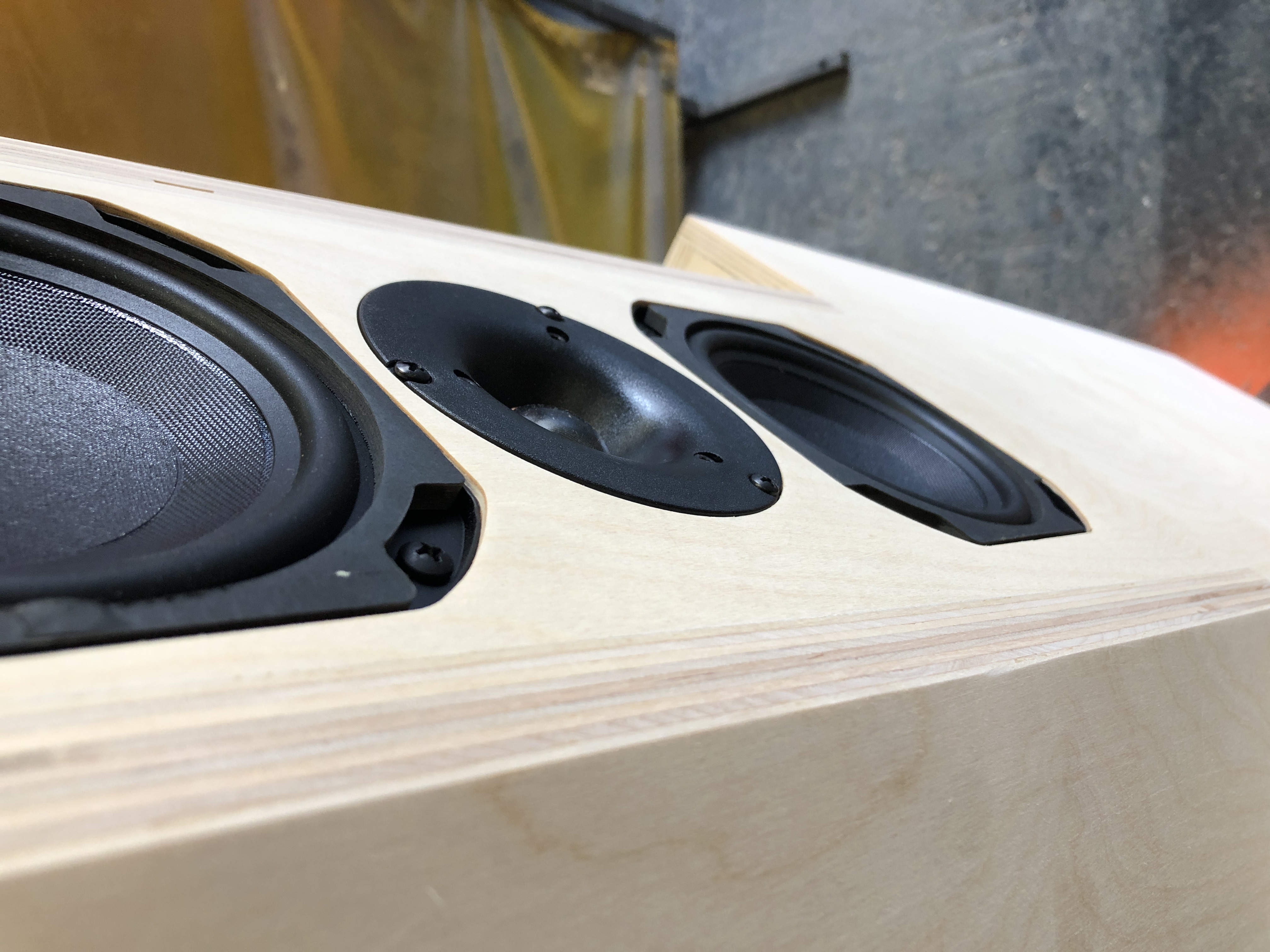

Fully assembled and getting trimmed/sanded.

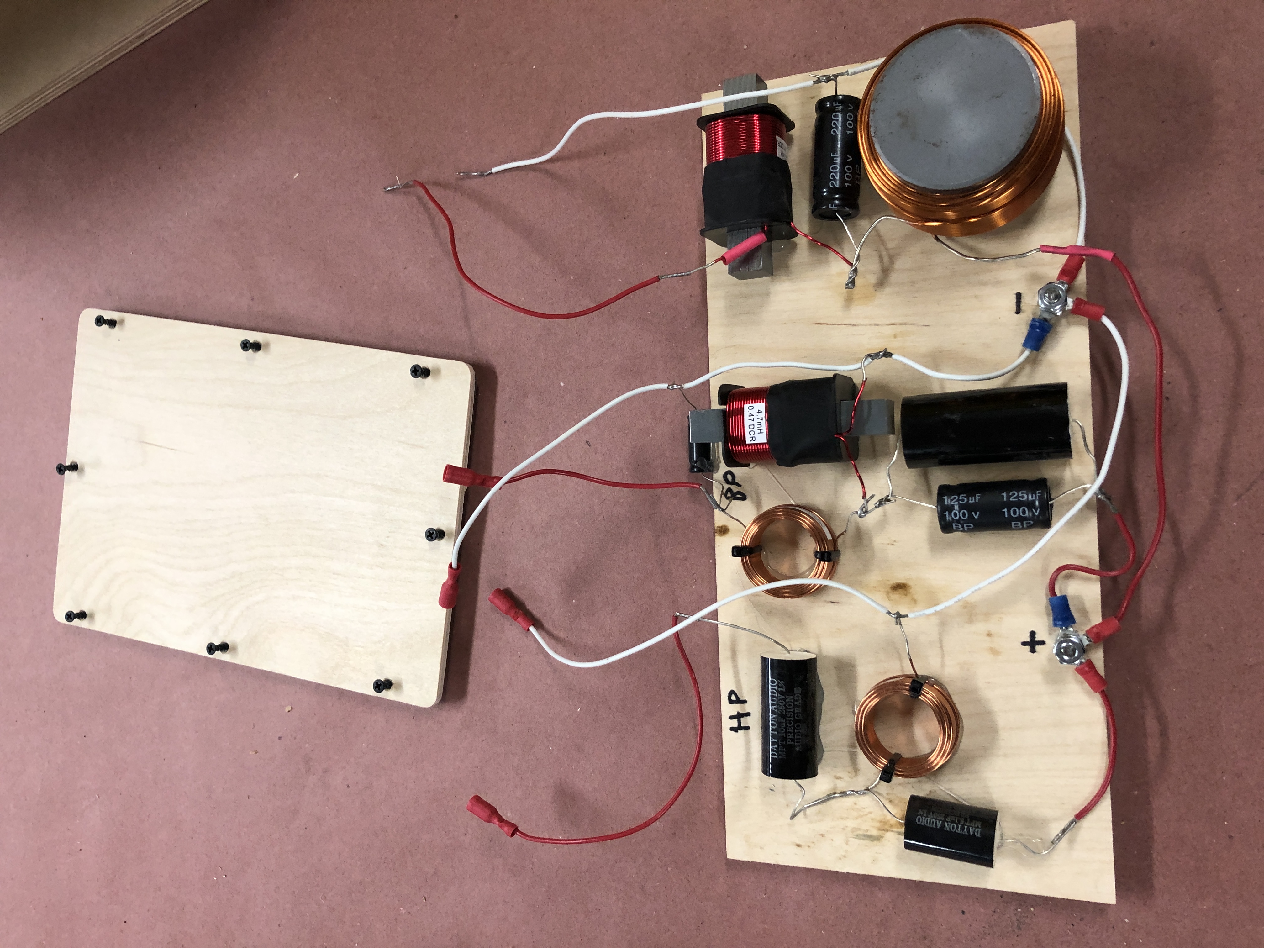

Crossover assembled and woofer cut-out.
Wired up for sound-test.

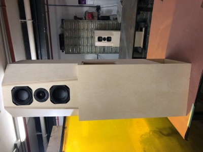

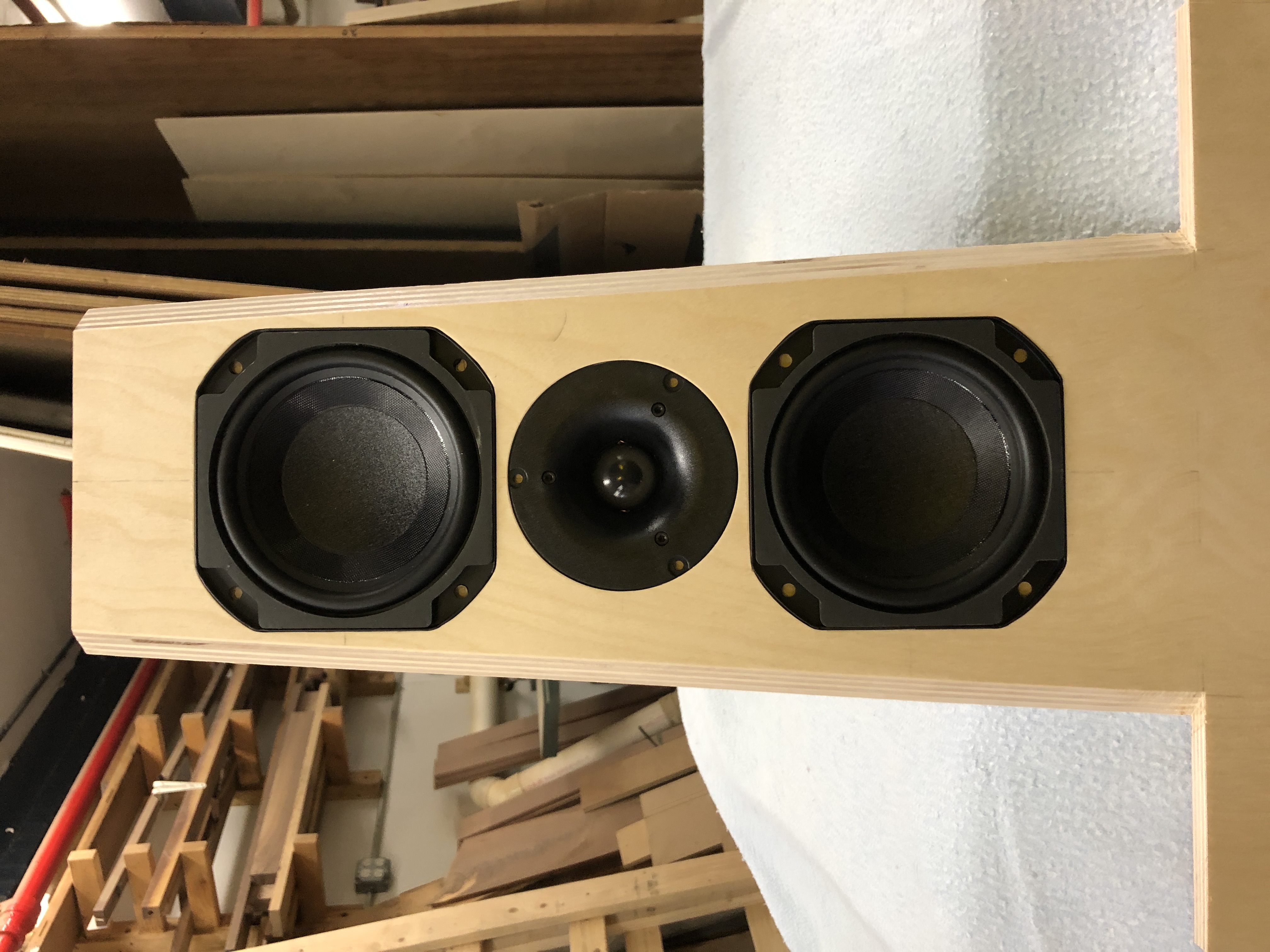

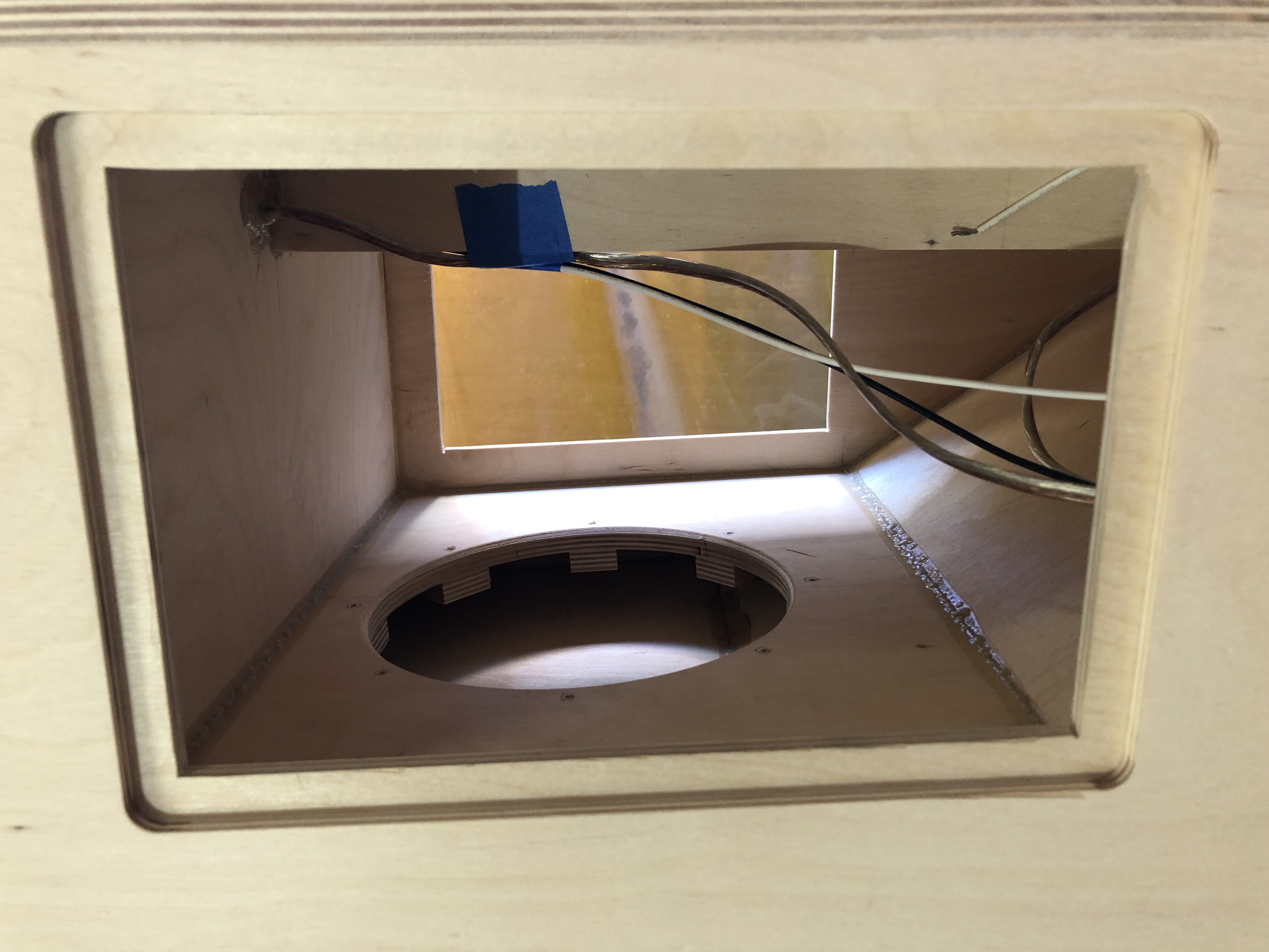

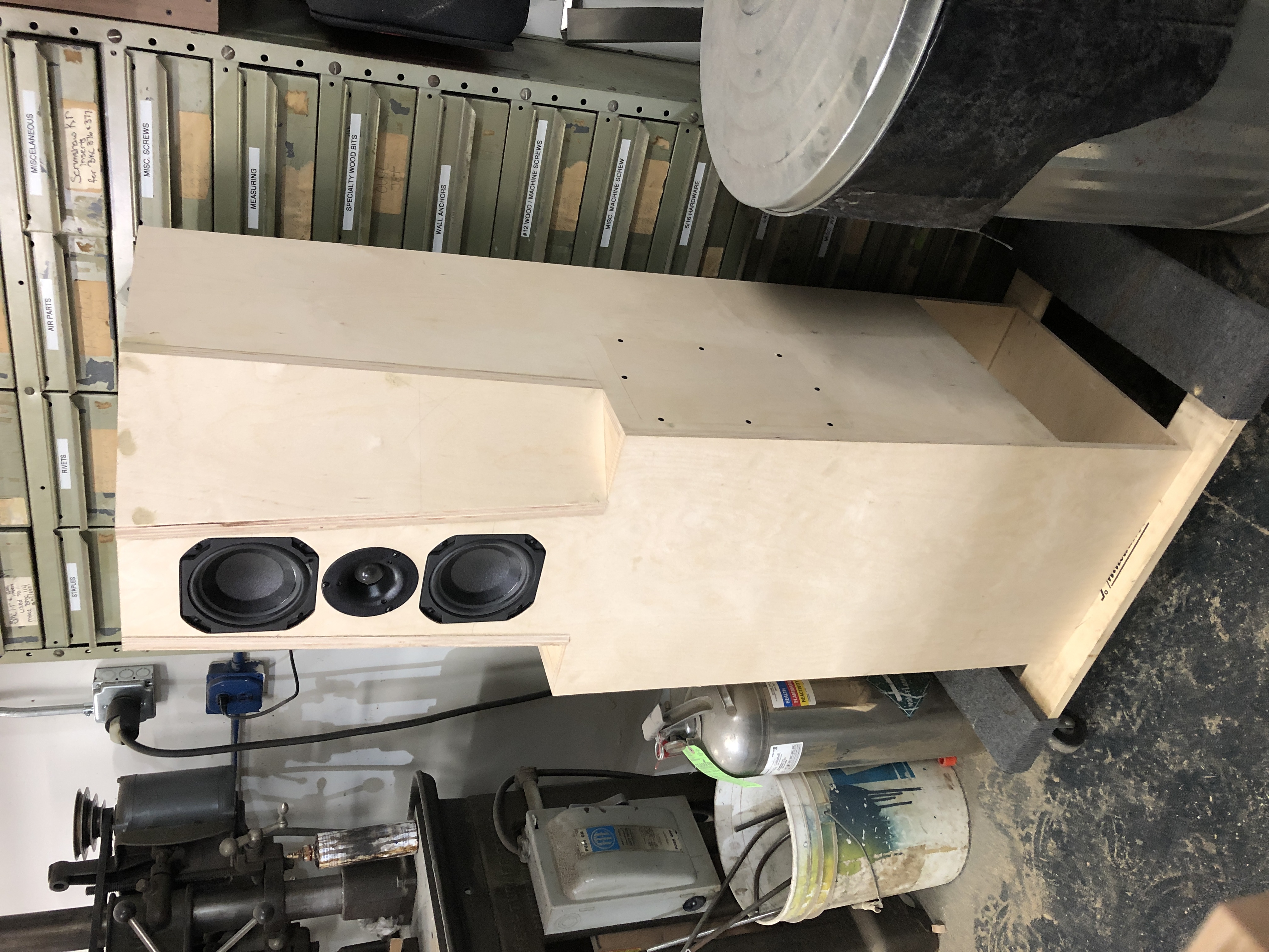

MTM installed with gaskets.

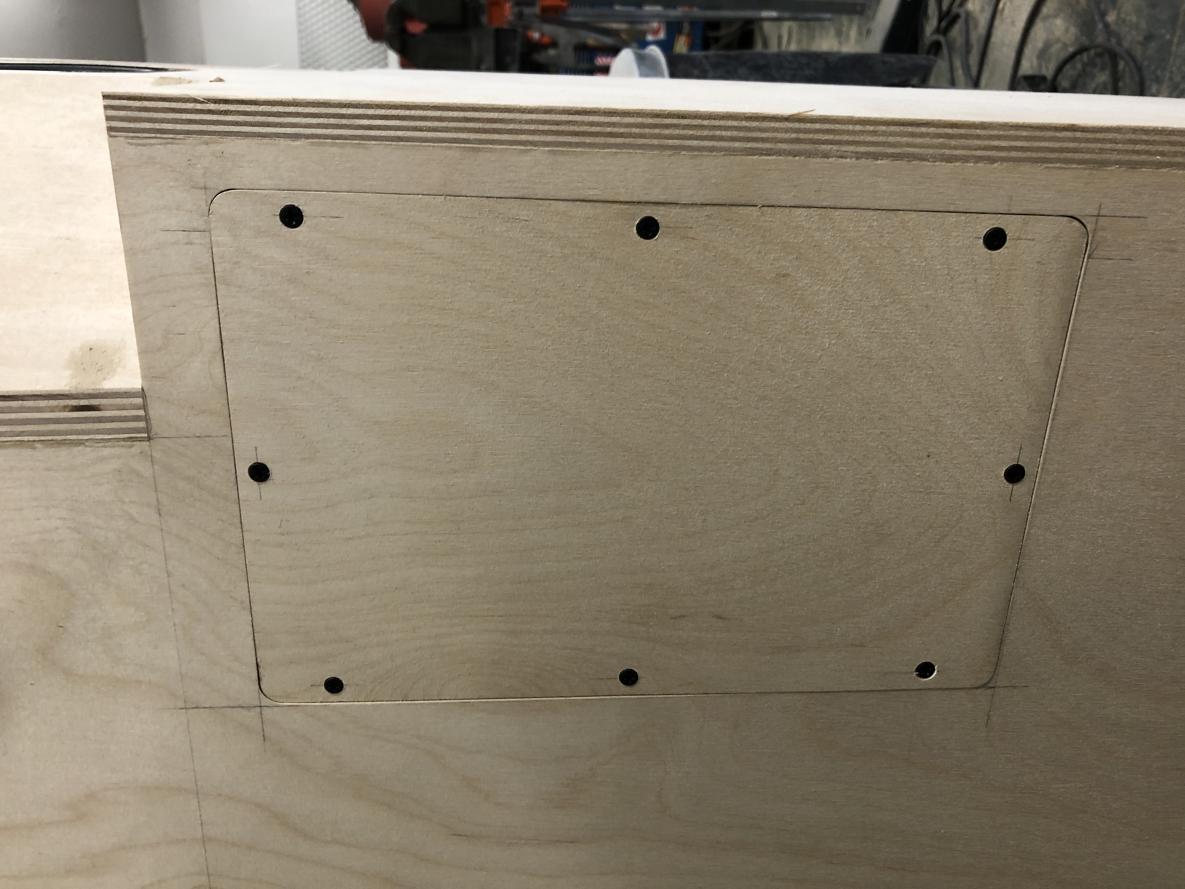

Woofer access panel.
Almost there...

You have lots of inductors on one board, all aligned in much the same orientation.
Look up inductor crosstalk, see if you can't change orientation of some of them.
Looking forward to your review as well...
Thanks for the feedback! The board is pretty large, about 12" across, and I thought I had them spaced far enough apart to avoid crosstalk (I thought 20mm was a rule of thumb), but I really have no experience with crossovers. I'll sketch out another orientation of some of the coils and see if it would be better.
