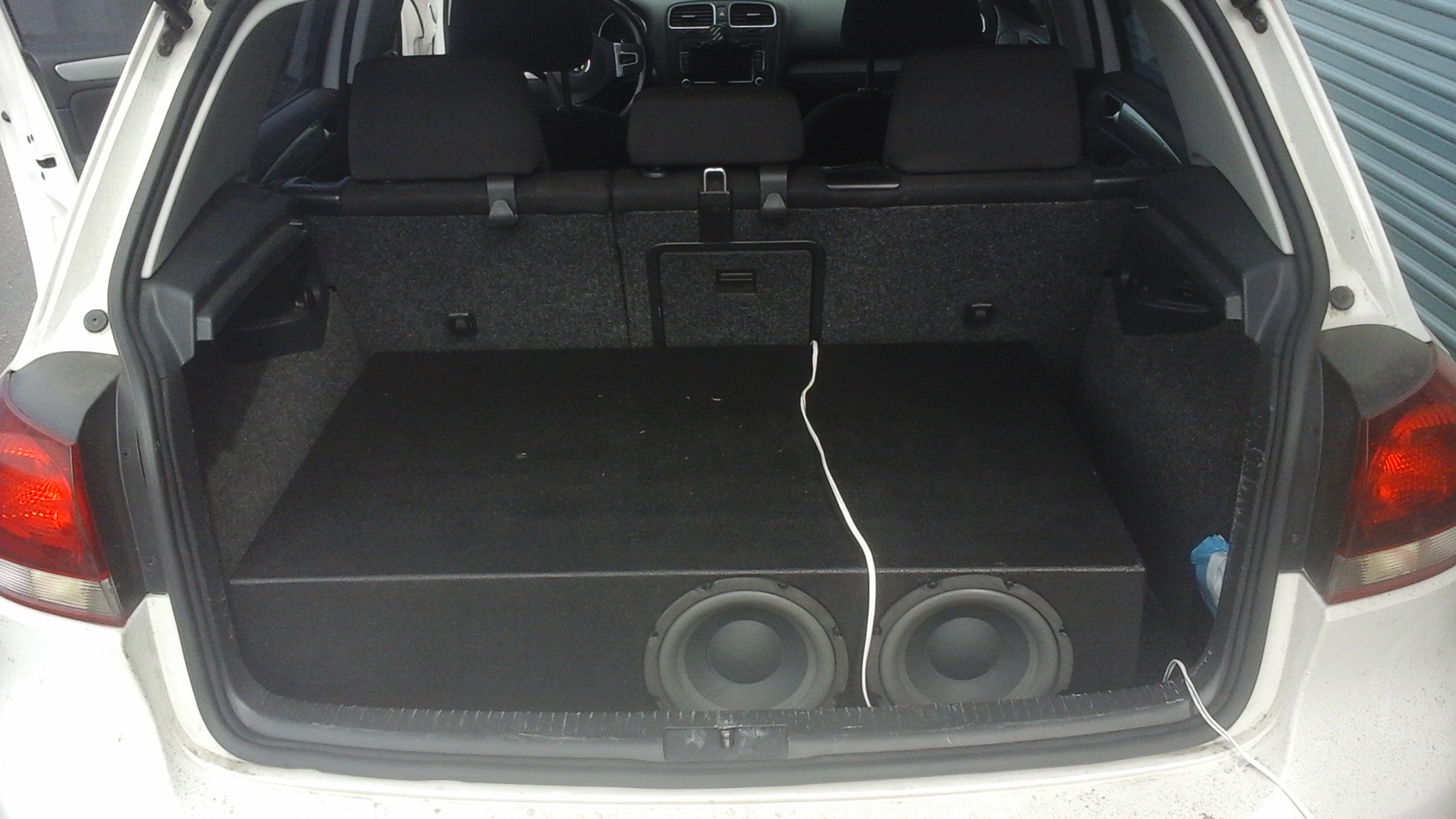

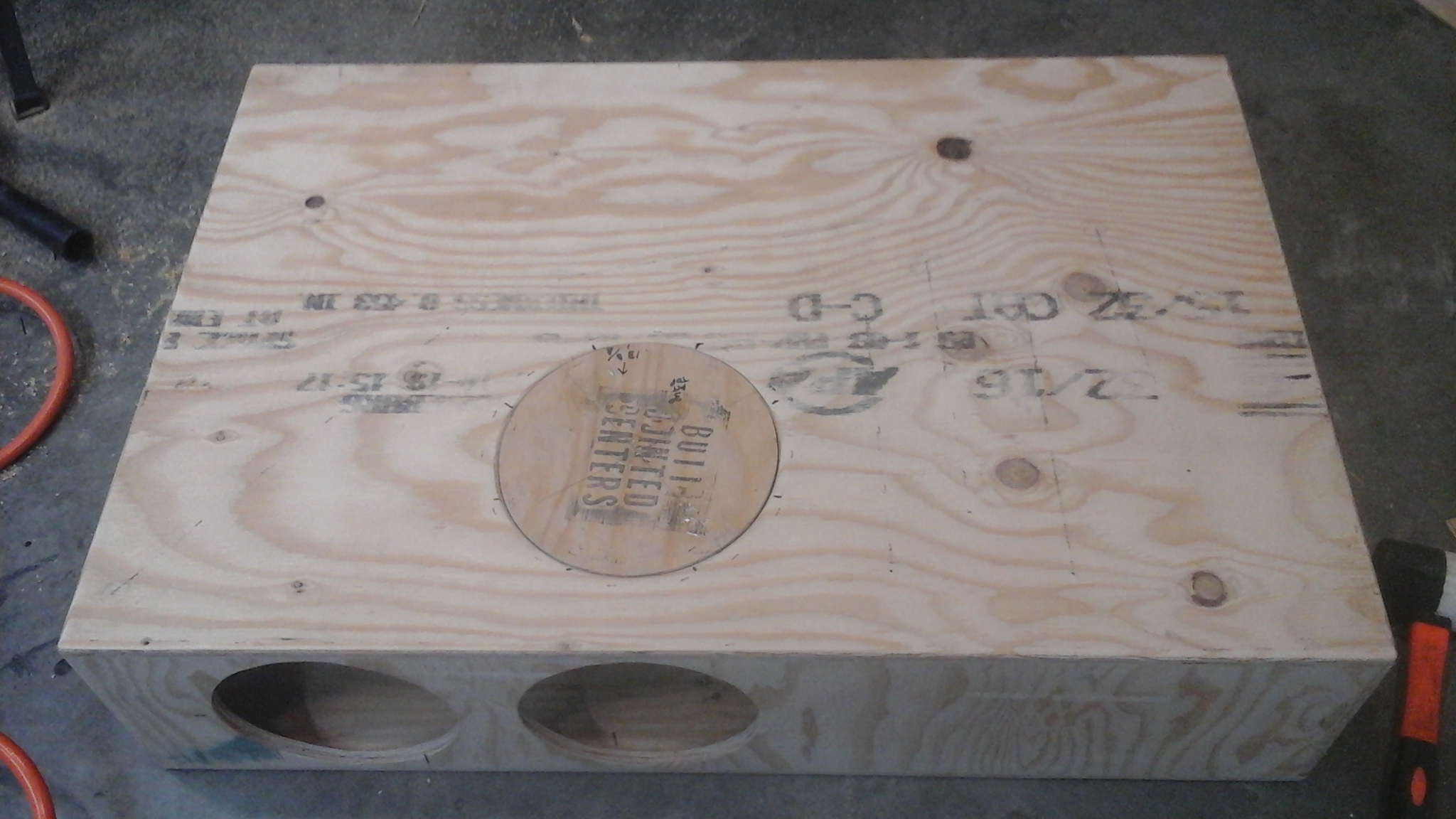

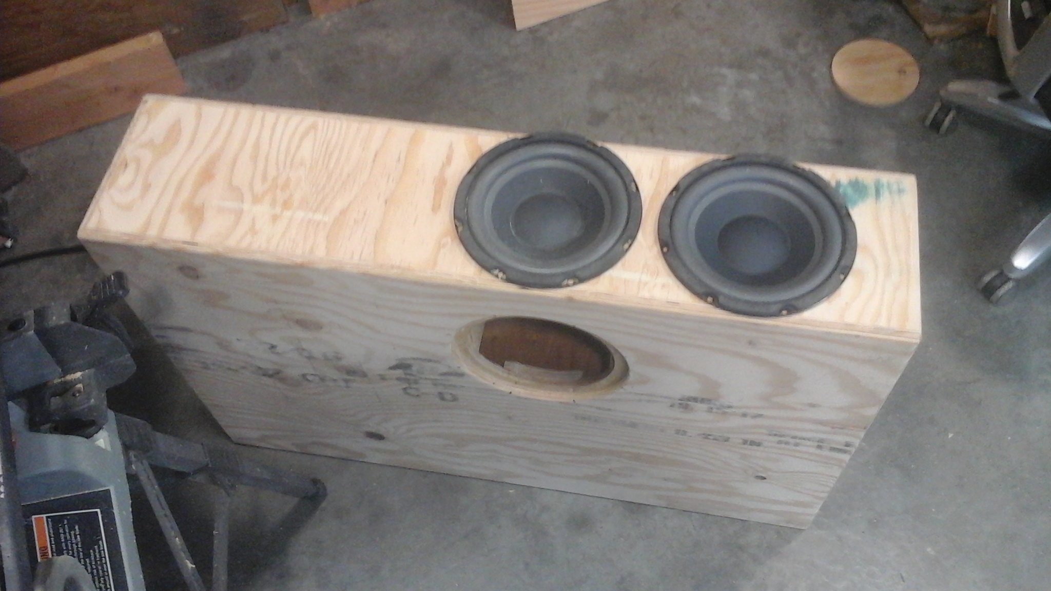

Don't forget the alternate driver mount on the edge like (I think Seth) and I did. at 7.5" wide a 8" driver is going to be tough to mount but you might be able to use a extra sliver of space to allow it.

I'm slightly bummed that solution struck me after I'd chosen a width and constructed based on elevating the cab for driver clearance underneath the cab. I could have made the cab a couple inches wider and still been within my maximum allowable dimensions for the space.

Use two 6.5s, but be aware of the specs.CarterKraft wrote: ↑Thu Aug 18, 2022 10:55 am Don't forget the alternate driver mount on the edge like (I think Seth) and I did. at 7.5" wide a 8" driver is going to be tough to mount but you might be able to use a extra sliver of space to allow it.
