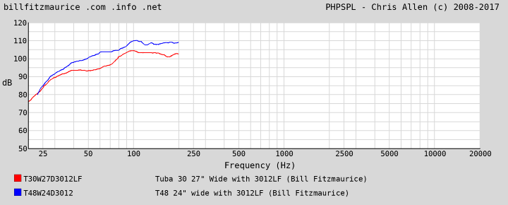

My first thought was the T30, but then Grant mentioned the T48. Here is a graph comparing the two. They are roughly the same width (T30 is 3" wider). They have the same driver in the fraph to keep the comparisons close.
I suggest building a minimum width of 24", but 27" will fit the door ways with wiggle room (my back door is 29" wide, for reference). Here is some more to and fro....3" difference more or less results in 1 or 2db difference (inside a model line).

Thanks Tom, yeah that graph lines up with what I had pieced together. Really seems like both the Tuba 30 and the Titan 48 are fairly similar in performance, so it maybe just comes down to form factor. I do like the idea of being able to wheel around the Titans without bending at 90 degrees, haha.
