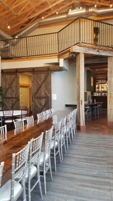

Optional DJ corner, and where bass node was killer.

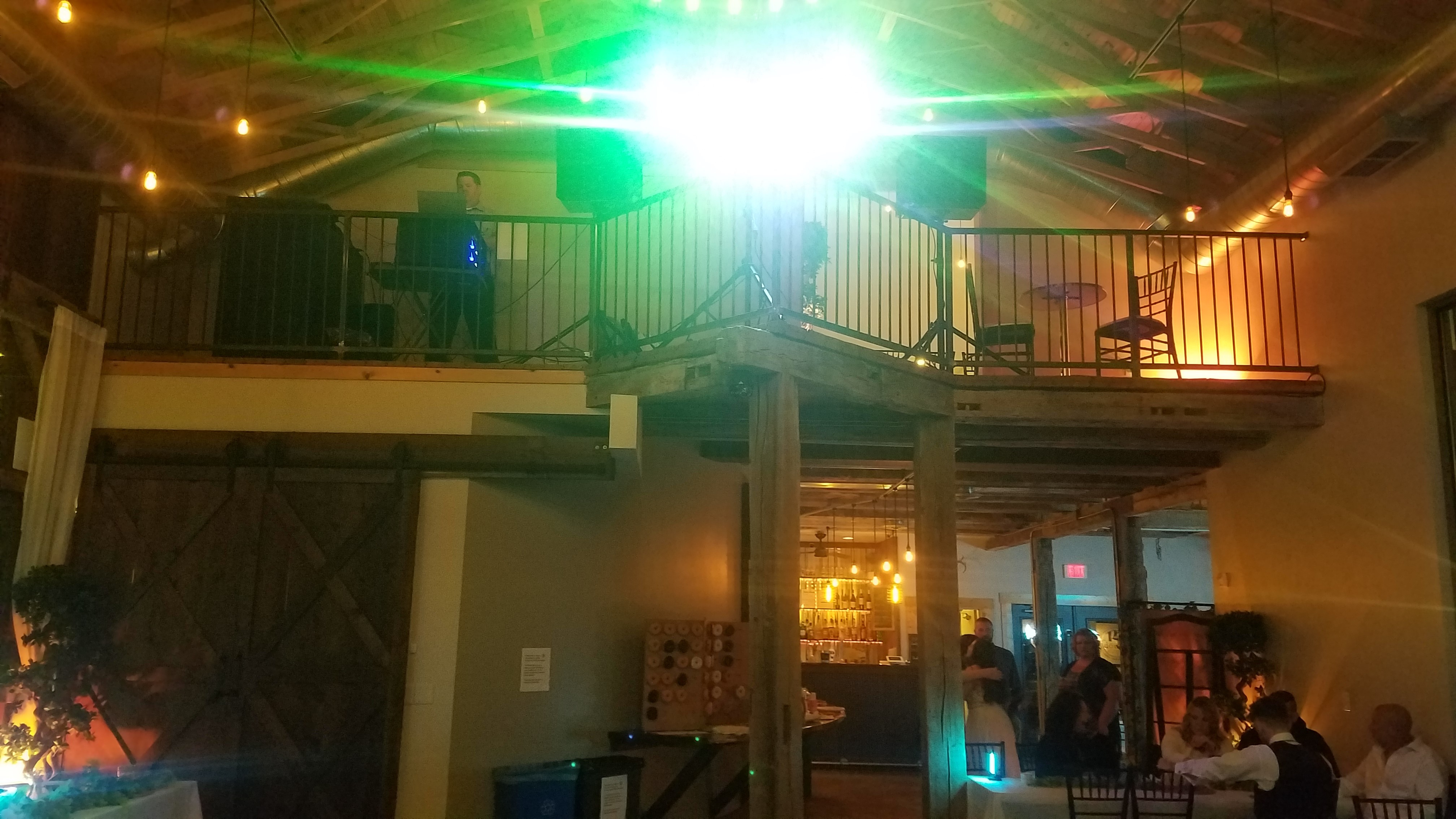

Balcony where we set up. Titans in corner on left, DR's flanking the lights on the triangle/point

My brother at the wheel, but you can make out T48's in corner and DR200's on tripods flanking the light tripod he borrowed.

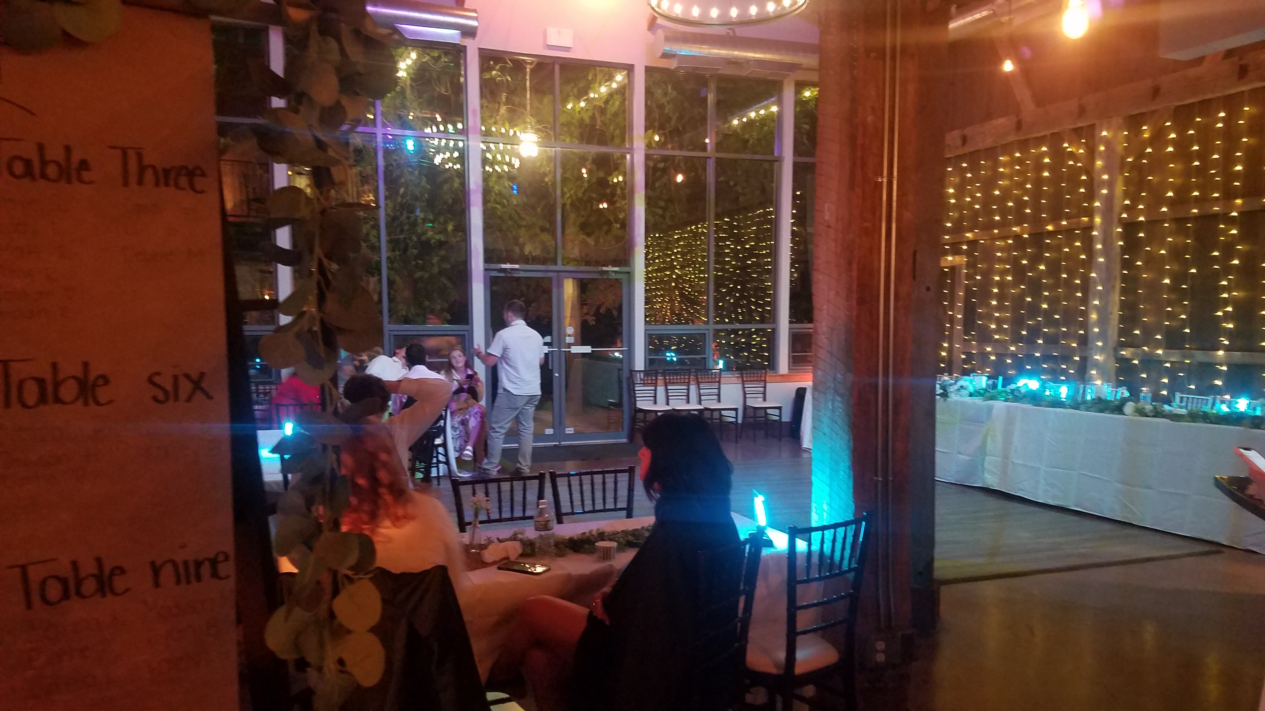

The view of the dance floor/room and glass wall from under the balcony back 10 or 15 feet into other room

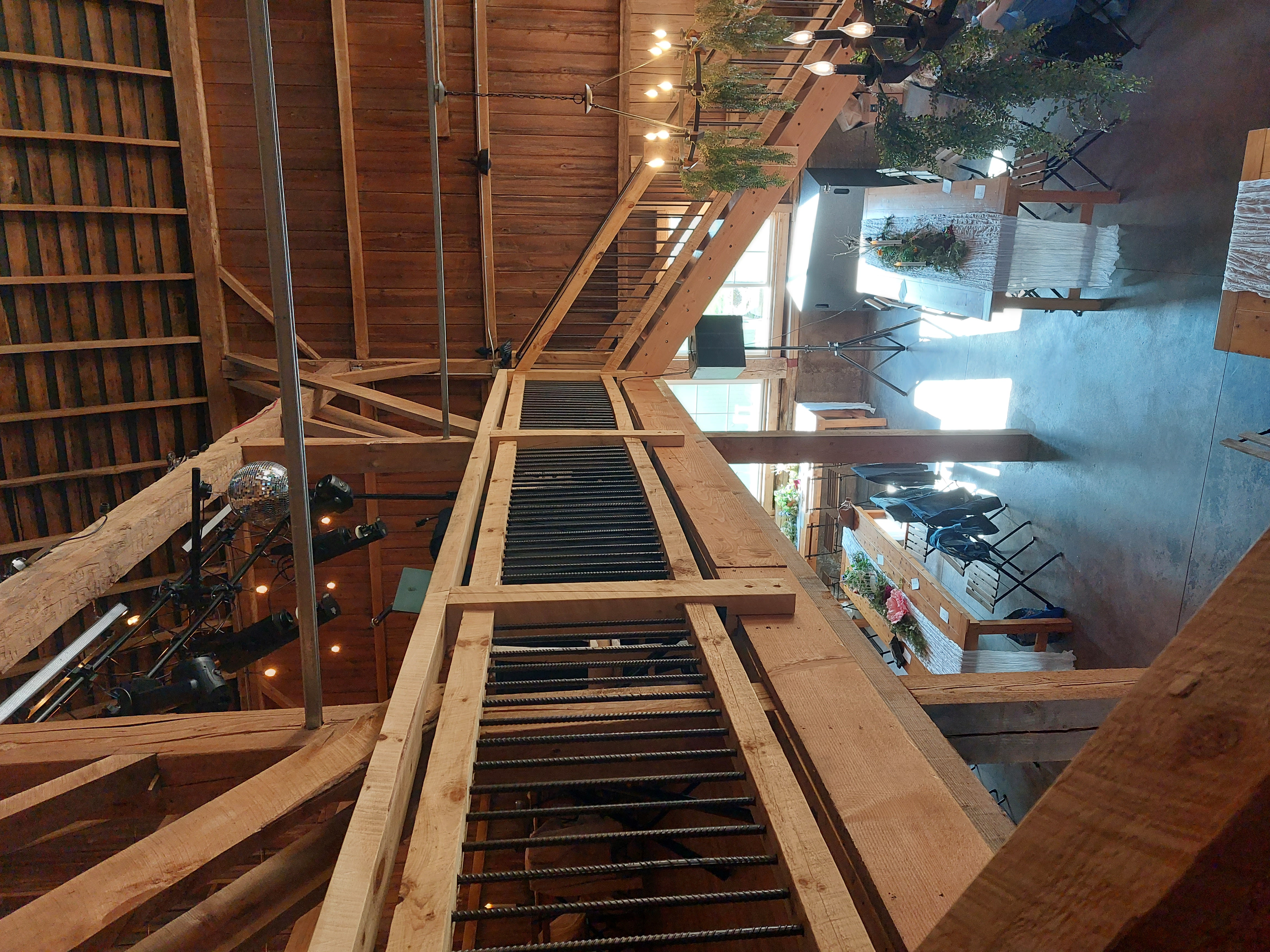

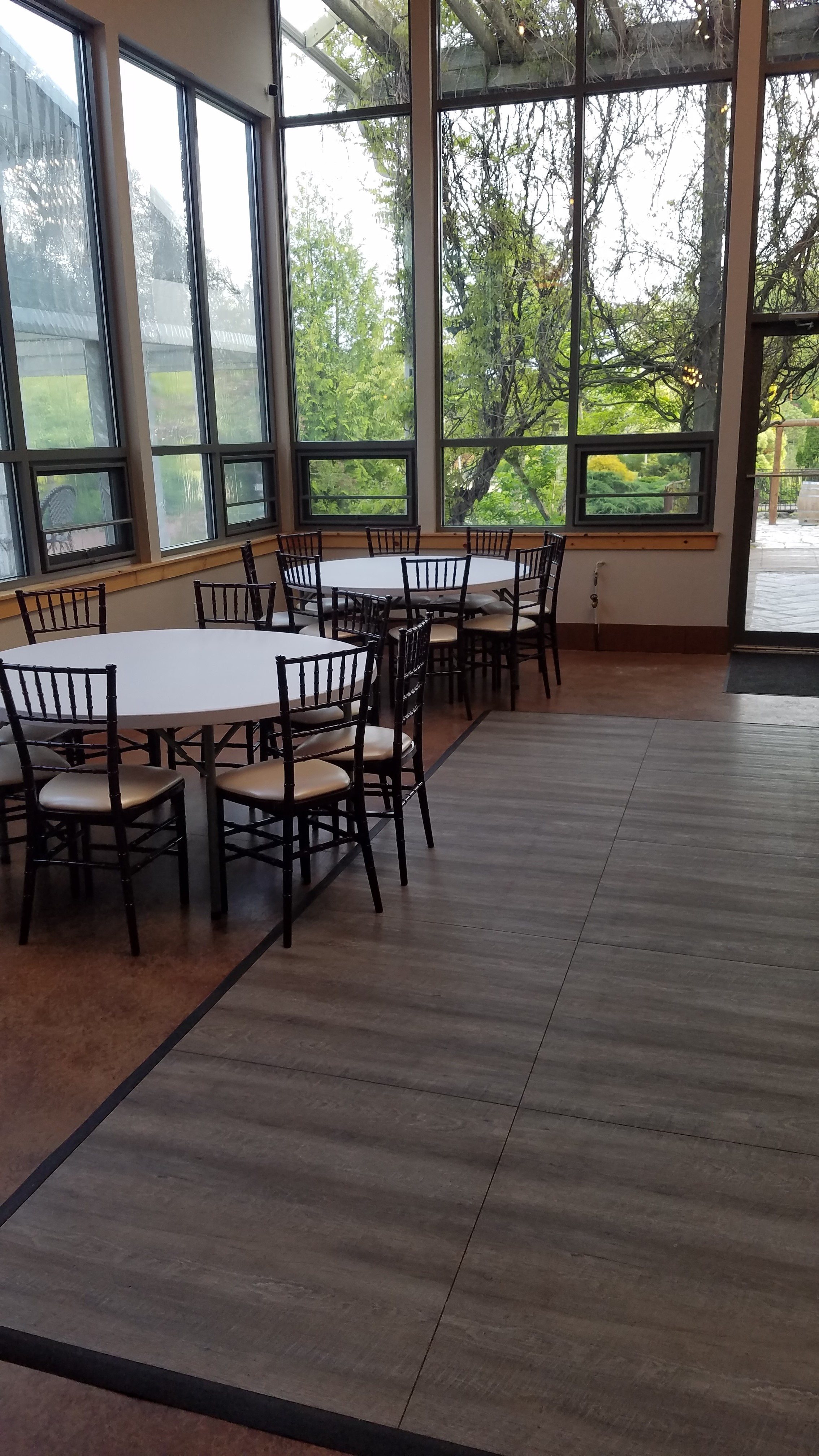

Nice! I did a prom for 250 from the balcony with a similar set-up. I was concerned about the tops being loud and clear if they were bouncing off the ceiling, so I put them downstairs and used gaff tape to keep the wires out of the way. The sub is a dual 15 T48.
