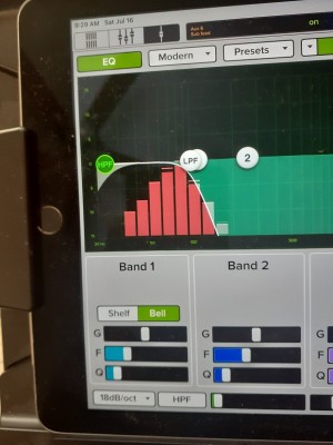

I have been intending to do this for a while. So hooked up my 2 16wide T24 to my new HT receiver with a small Yamaha PA amp. I was disappointed to see the only setting I could change for the sub was volume and distance. I can hear where my subs are coming from which makes me feel the Low pass to the sub is too high. I may have to introduce a filter to check this. My Mackie has independent Hi and Low pass filters on the output DL1608.

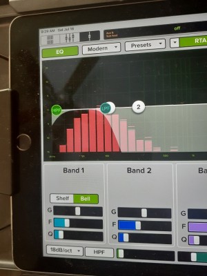

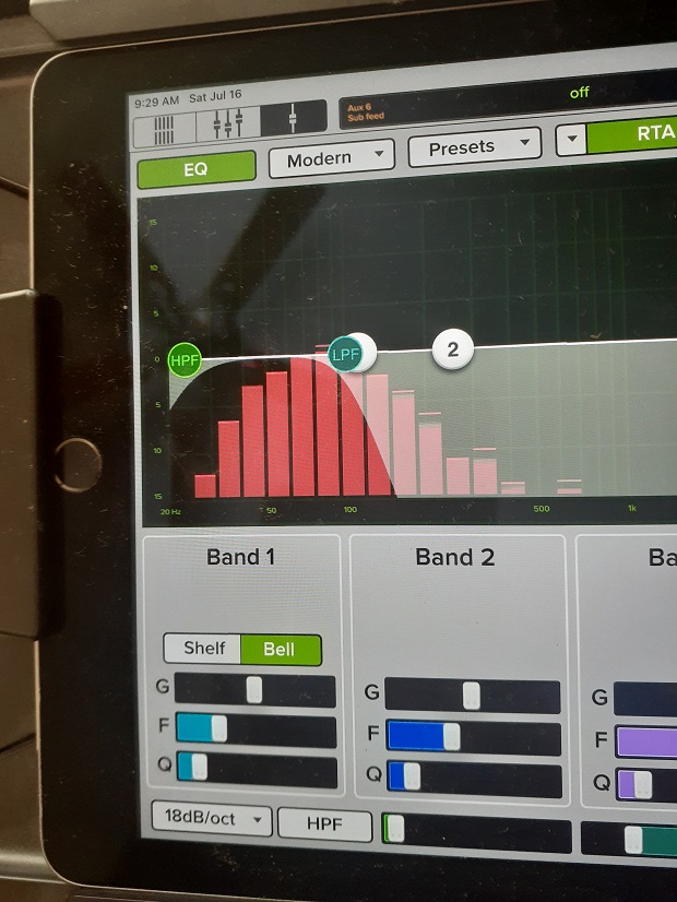

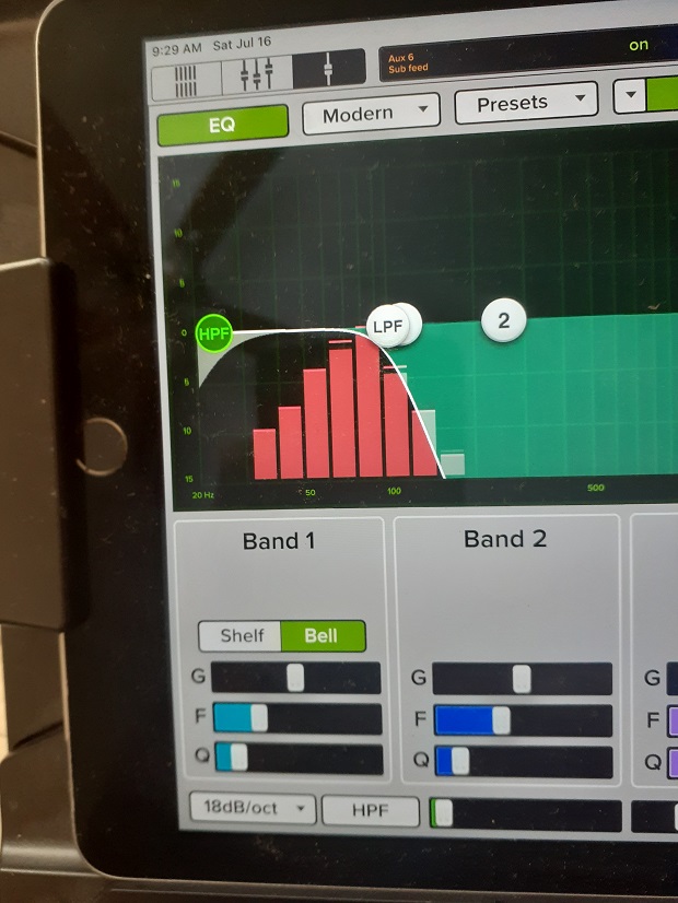

So there is no control of Low pass. I used my DL1608 with RTA to show what is happening. With not low pass there is content all the way up to 500, very minimal but its there. With the Low pass at 100 the you can see the result. The sound is complexly different. No to search out some solution to this.

When you crank it there is content all the way up the spectrum. Filter removes it all.

I'm pretty sure the other speakers are being hi passed. It just expects the sub to feeding an amp with all the processing avaliable.
The RTA of the Sub out is being filtered to a large degree just not to the degree I require. The pass band is just way too broad
