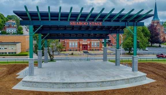

I have a concert tomorrow that has a concrete stage in a park. The face of the stage is approximately 5' high and the stage is quite wide (I'm guessing close to 65' across).
I am planning on V-plating the 6 Titan 39 subs I have for the first time at this event and have a few questions. Will the wall cause reflections and cancellations if I put the subs against it? Are there any recommendations (face the subs at the wall, or pull them a foot or two off the wall). Is there anything I'm not considering?

For the wall to have any effect it would have to be at least a half wavelength high, which is 14 feet at 40Hz, 5 1/2 feet high at 100Hz. Otherwise the low frequency waves will just go over it. At five feet high it's effect is negligible. Depending how wide the listening area is you may want to split the subs.

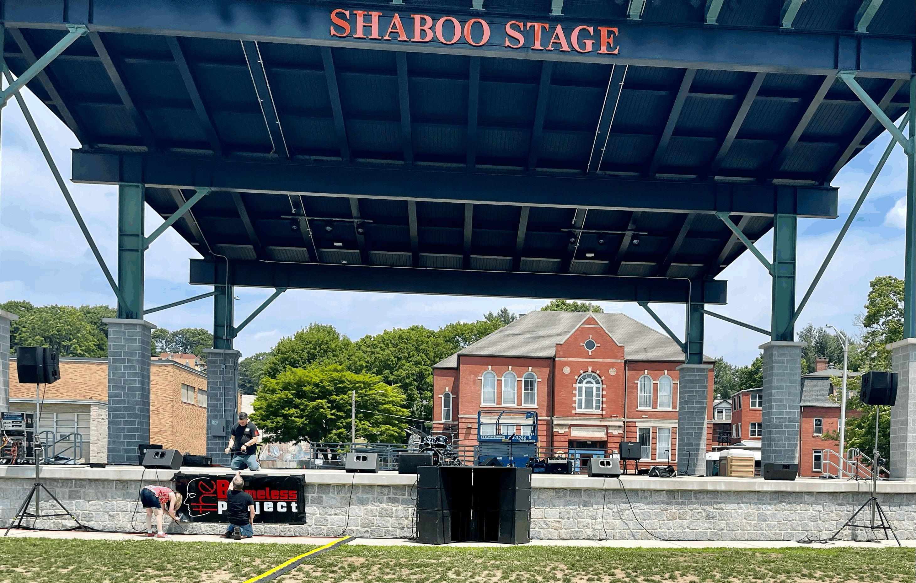

Event went perfect! There were a few rappers there so I was really concerned about getting the most out of my system without over-taxing it. Success on that account. Once I finally received the band riders... I figured out that I did not need to use even half the stage... I did end up V-plating the subs but pulled the mains way in. The best part was that there were a few teens in the audience who chose to experience sitting in the throat of the subs and enjoying a full body massage during one of the bands. The event was not well attended unfortunately, but part of the goal was to get the sound into the surrounding neighborhoods - that was a whopping success. On the big stage, I will note that my VRX look so tiny - LOL!
