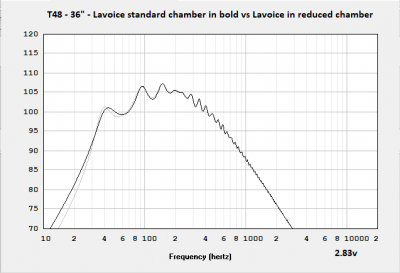

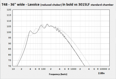

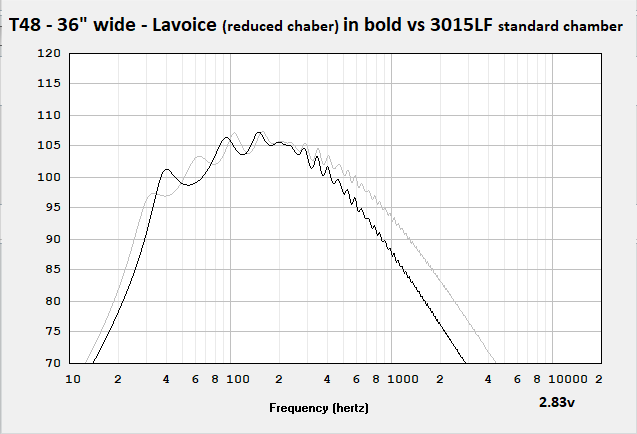

Here it is vs. a 3015LF. To my eye, it looks to have an advantage in sensitivity below 50Hz. The tradeoff seems to be the LaVoce's bottom end rolls off about 5Hz higher than the 3015LF.

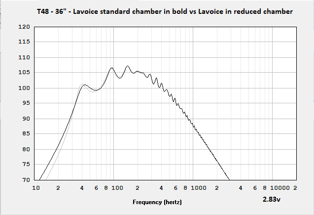

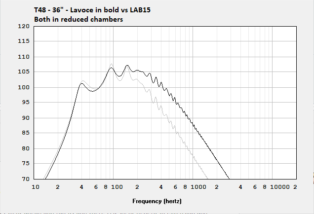

Here it as against the LAB15, both in reduced chambers. Looks to be pretty close in the target frequency range.
