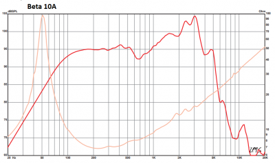

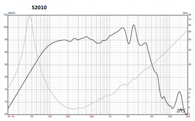

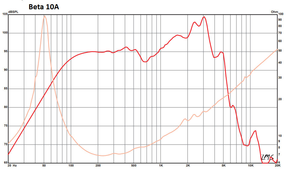

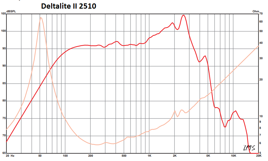

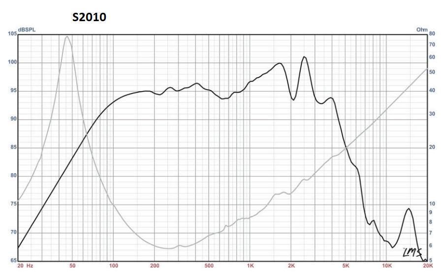

The drivers mentioned in the plans are the Beta 10, S2010, and 2510. The plans also state a rising response into the midrange is required.

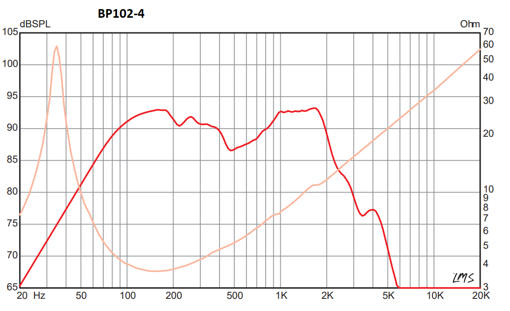

The BP102-4's Fs is slightly low, Vas is slightly high, and comparing the response charts, I'm not convinced the BP102-4 is a good choice.

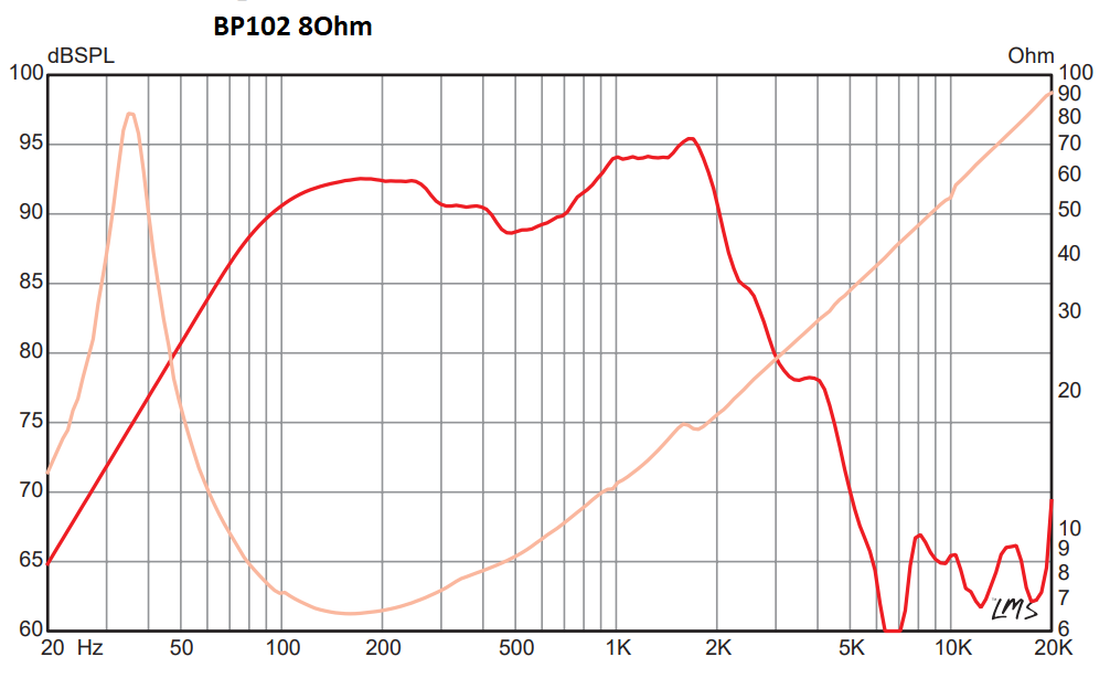

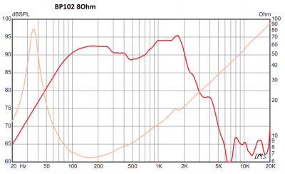

Here's the standard 8Ω BP102 too. Also not looking like a good choice for a Jack.

Re: J210 driver selection
Thanks for the input Seth, I already have the BP's and was looking to save $$$. Looks like the best price point/ performance would be the delta 2510's.

As always, thanks for the input Bill!
I went with the Deltalites II 2510's. Just so impressed with the 15" delta's performance in the J15, figured the 10's should be good too.
I'm on the fence on building a J210 or J210 lite?
