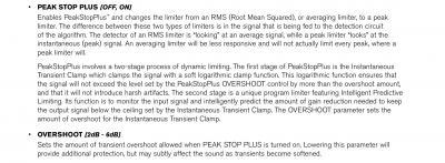

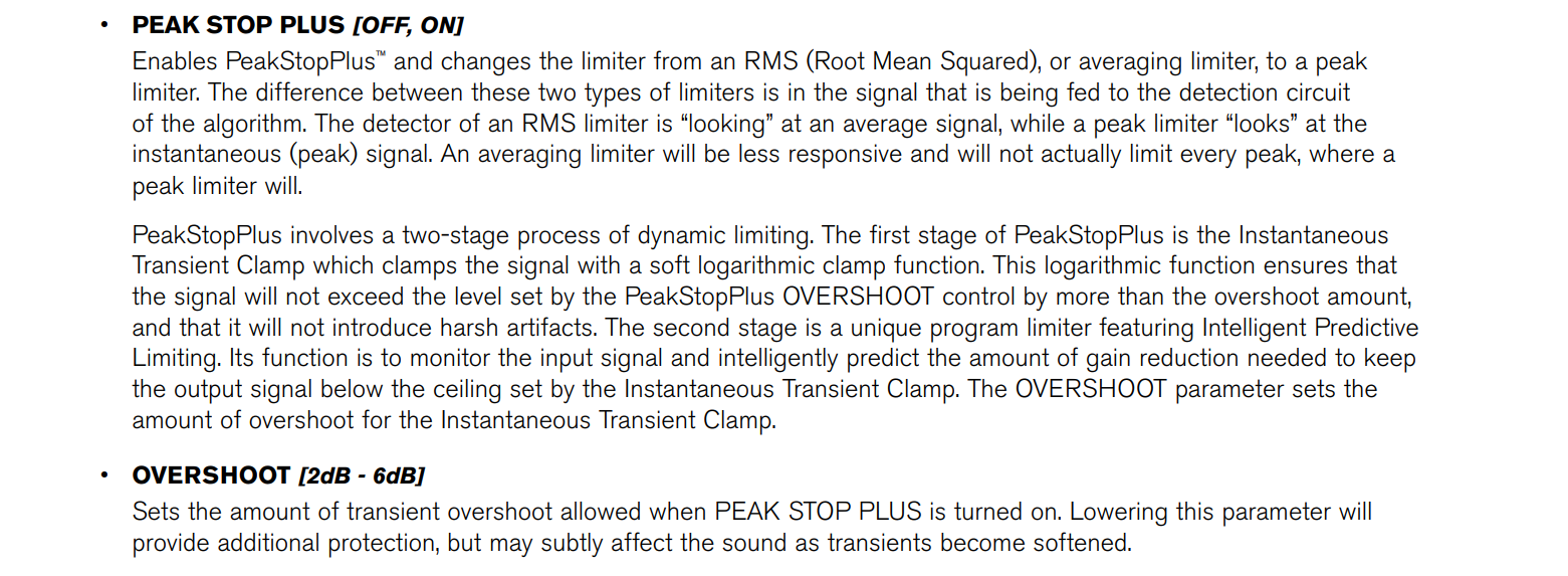

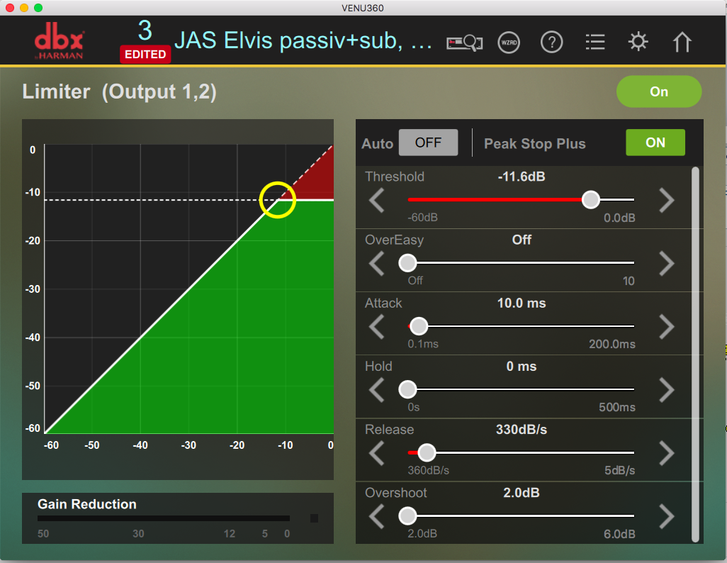

Just went and looked at the manual....more options with the 360. Turn the OverEasy and Auto OFF. Turn the Peak Stop Plus ON. Set the Overshoot as low as will go. Give that a try. That should be as tight as the unit can be on the limiter.Bruce Weldy wrote: ↑Sun May 15, 2022 9:04 am First.....are you sure you are in the limiter section and not the compressor section? I haven't used the 360, but on the other driveracks, you have to page past the compressor to get to the limiter.

I will try and post a picture of the editor window..

Honestly, I don't care about those parameters. It's not a mixing tool like compression, we just want it to stop the voltage when it hits the limit - it's about protecting the speakers. If you are hitting the limiters all the time and are worried about how fast or show the limiting starts or stops, then you need to build more subs and back off the volume.

A couple things... do not use the method of setting gain structure as outlined in their manual. Doing so, will not protect your subs. Also, we've discussed this a little in the past, I think. I'm still a little surprised they don't have a standard Brick Wall Limiter option. They seem to have "Peak Plus "off"" as an RMS limiter, and "Peak Plus "on"" as a peak limiter with an adjustable overshoot... 2dB minimum and no option to have 0dB overshoot. So, it sounds to me that if you set your limit at 60volts, the limiter would allow voltage peaks of 75.5 to occur. And that to have 60 be the absolute max brick wall limit, you'd have to set the limiter for 47.7 volts.

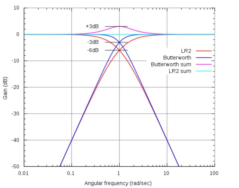

To set gains, with crossover filters enabled, I use a sinewave of the intended crossover frequency and a decibel meter. Run the subs alone, note the level, then run the tops alone and adjust to match the subs level. Then play them both together and the reading should be close to 6dB more than either on their own. I personally usually use Linkwitz-Riley filters between the lows and mids/highs. LR filters are -6dB at their designated frequency, so they sum to 0dB, no gain/attenuation at the crossover frequency. Some guys seem to like having a gap of 5-15Hz in their set frequencies. I assume this is a practice originating with the use of Butterworth filters, but that's just conjecture. There's certainly more than one way to get the job done.
