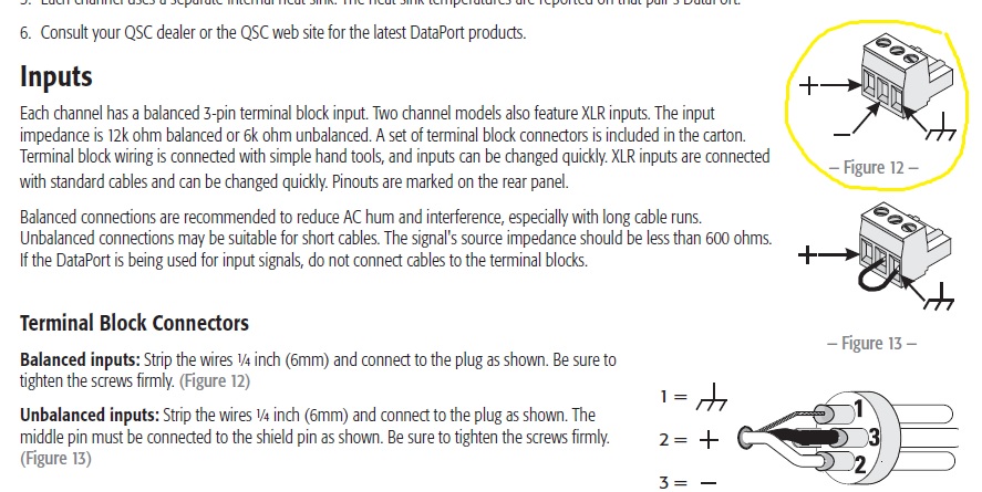

I have a QSC CX502 that i will be pairing in a rack with my Drive Rack. I noticed the QSC has the option for terminal blocks for the inputs.
The manual doesn't give a part number, but does later refer to them as Phoenix type.
I did measure the connector on the amp and I believe it would be a 5mm pitch.

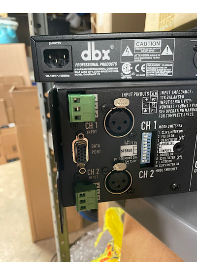

Only because it would be in a rack with the Driverack, always together. I’ll still have a stack of XLR cables should the need arise. Besides it’ll help keep my DIY case a few inches shorter.

Yup.
The 5mm should be correct.
I just ordered some last week for some crown amps.
