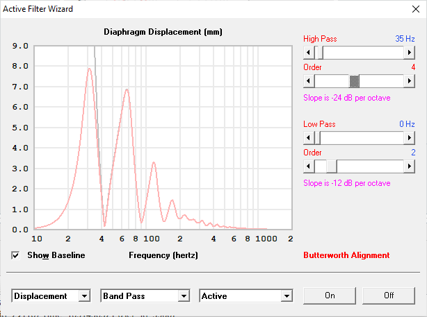

How many volts does it take to melt the voice coil?
How many volts does it take to make it as loud as possible without distortion (move the cone as far as possible while maintaining (mostly) linear response)?
Two different questions. Two different answers. The first is what the marketing team wants you to think matters and they make it very apparent. The second is what matters to your ears and it's not something they can advertise because a driver will behave differently in different enclosures. Each situation unique. That's where the T/S parameters come in.
howiez wrote: ↑Sun May 01, 2022 9:04 am
SO how does T/S factor in?
How? I'm not versed enough to speak to that with any real conviction. Here's a quick rundown on the different specs,
Eminence - Understanding Loudspeaker Data
Every driver requires different enclosure designs/dimensions to maximize their response and output potential.
In this case, we need to plug the T/S values into Hornresp Horn loudspeaker modeling software. One of the many functions in the software is calculated diaphragm displacement... how much the cone moves given voltage input, which varies with frequency.
Disclaimer for the following "information": I COULD BE WRONG
I've loosely backward engineered the dimensions of the T48 from the sketchup file. I believe the dimensions are not perfectly accurate, but close enough to ballpark some of Rornresp's functions.
If the data you posted is accurate (I used an Sd of 850), it looks like a 41 volt limit, on a 40Hz, 24dB Butterworth slope high pass filter is your sweet spot... keeping everything in check.

Re: Is there a limit to CABs per channel?
Posted: Wed May 04, 2022 7:27 pm
by howiez
Seth wrote: ↑Sun May 01, 2022 1:38 pm
Seth that is amazing, and i'm uber confused now! Here I thought this was a simple square root of watts x impedance. I've used Hornresp to try and design a horn, or check how a driver would perform. How do you get your 41v from that screenshot?
I had planned to high pass at 35Hz with my Driverack. I dont' suppose i'll notice with recorded music.
My plan was to limit at 49v. Yes my T48 is shoehorned. I built the first like 4 or 5 years ago, I can't even remember, should be a build thread. I just nudged the first panel a hair longer. I had built it around a RS woofer from the 80s just for fun. I was so impressed with how my THT turned out, I wanted to try something with freebies. I couldn't afford at the time to buy a pair of Eminence 15's but I had a pair of 18's laying around. I really didn't care if they blew, I knew the pressure would be rough on the old cones. But then last year I came across the Celestions meant for a horn, for a song, so I upgraded. 600w instead of 200w. Anyway even the RS had impressive bass in my garage.

I looked and I don't think there's a build thread on your T48's. Cool story though. I'd love to see some photos of them if you have any handy. Don't go out of your way, though.
That screenshot was of the "Filter Wizzard" screen. In Hornresp, Window 1 - input parameters... the second box (Eg) is voltage. Adjust it to a voltage you suspect should do (maybe start with a voltage equivalent to RMS Power), press calculate. "Tools" dropdown, select "filter wizzard". Open the dropdown at the bottom left of the filter wizzard screen and select "Displacement". Adjust the highpass freq and slope to values mentioned in the plans. If the indicated displacement exceeds or is below the drivers Xmax, go back to the input parameters screen and adjust the voltage and do it all again until the displacement doesn't exceed the drivers Xmax. I don't know how Bill or anyone else goes about it, but that's what I've done. It's just what made sense to me. It could be completely wrong or there may be a better way to do it.
With horn loaded subs, you typically wont hear the distortion you'd hear from a direct radiator sub that let's you know you're pushing it too far. That's why Hornresp is used to determine how many volts it will take to exceed the drivers maximum linear cone excursion. Yes, you can use Ohm's law calculations to determine how many volts equates to a wattage with a known impedance. But, just because a speaker is rated for a certain "power", that doesn't mean you need it all to get everything out of the driver. In one enclosure it may need it's full power or more and still not exceed it's Xmax and in a different enclosure it may reach it's Xmax with way less than the drivers rated power.
Exceeding Xmax isn't the end of the world. Marginally exceeding it is really not a big deal. But, pushed too far without proper filtering and limiting can quickly and easily exceed Xlim, the absolute limit to cone travel. Especially at frequencies lower than the horn is designed for, it's very easy to damage a driver. Even at less than it's rated power.
The Eminence page states it well...
Xlim is expressed by Eminence as the lowest of four potential failure condition measurements: spider crashing on top plate; Voice coil bottoming on back plate; Voice coil coming out of gap above core; or the physical limitation of cone. A transducer exceeding the Xlim is certain to fail from one of these conditions. High pass filters, limiters, and enclosure modeling software programs are valuable tools in protecting your woofers from mechanical failure
I re-ran the driver specs with a Sd of 1235cm2, a figure more akin to an 18" driver (instead of the 850 I used last time, thinking it was a 15). 24" wide cab. Here's what the diaphragm displacement looks like at 49 volts (the drivers RMS rating of 600w), highpassed at 35hz.
Actually pretty good. This looks to be the Goldilocks combination. 18dB Bessell, peaks right at Xmax.
24dB Linkwitz-Riley, slightly over
24dB Butterworth. Even at 48dB, it is still over.
Having run those simulations, it's worth noting that, per the plans, stacks of less than four T48 cabs should be high passed at 40Hz, 35Hz for stacks of four or more.
