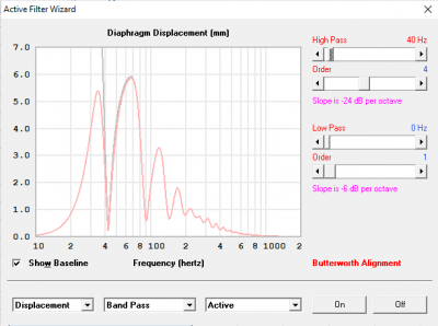

I've loosely backward engineered the dimensions of the T48 from the sketchup file. I believe the dimensions are not perfectly accurate, but close enough to ballpark some of Rornresp's functions.
If the data you posted is accurate (I used an Sd of 850), it looks like a 41 volt limit, on a 40Hz, 24dB Butterworth slope high pass filter is your sweet spot... keeping everything in check.

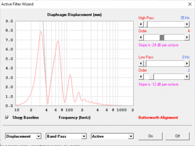

That screenshot was of the "Filter Wizzard" screen. In Hornresp, Window 1 - input parameters... the second box (Eg) is voltage. Adjust it to a voltage you suspect should do (maybe start with a voltage equivalent to RMS Power), press calculate. "Tools" dropdown, select "filter wizzard". Open the dropdown at the bottom left of the filter wizzard screen and select "Displacement". Adjust the highpass freq and slope to values mentioned in the plans. If the indicated displacement exceeds or is below the drivers Xmax, go back to the input parameters screen and adjust the voltage and do it all again until the displacement doesn't exceed the drivers Xmax. I don't know how Bill or anyone else goes about it, but that's what I've done. It's just what made sense to me. It could be completely wrong or there may be a better way to do it.
With horn loaded subs, you typically wont hear the distortion you'd hear from a direct radiator sub that let's you know you're pushing it too far. That's why Hornresp is used to determine how many volts it will take to exceed the drivers maximum linear cone excursion. Yes, you can use Ohm's law calculations to determine how many volts equates to a wattage with a known impedance. But, just because a speaker is rated for a certain "power", that doesn't mean you need it all to get everything out of the driver. In one enclosure it may need it's full power or more and still not exceed it's Xmax and in a different enclosure it may reach it's Xmax with way less than the drivers rated power.
Exceeding Xmax isn't the end of the world. Marginally exceeding it is really not a big deal. But, pushed too far without proper filtering and limiting can quickly and easily exceed Xlim, the absolute limit to cone travel. Especially at frequencies lower than the horn is designed for, it's very easy to damage a driver. Even at less than it's rated power.

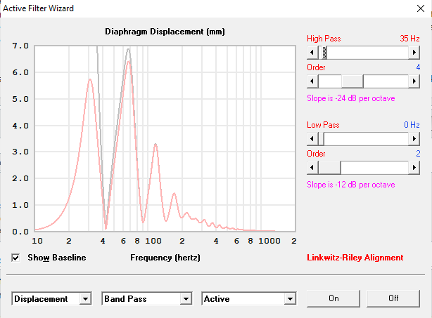

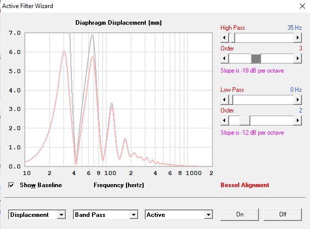

I re-ran the driver specs with a Sd of 1235cm2, a figure more akin to an 18" driver (instead of the 850 I used last time, thinking it was a 15). 24" wide cab. Here's what the diaphragm displacement looks like at 49 volts (the drivers RMS rating of 600w), highpassed at 35hz.Xlim is expressed by Eminence as the lowest of four potential failure condition measurements: spider crashing on top plate; Voice coil bottoming on back plate; Voice coil coming out of gap above core; or the physical limitation of cone. A transducer exceeding the Xlim is certain to fail from one of these conditions. High pass filters, limiters, and enclosure modeling software programs are valuable tools in protecting your woofers from mechanical failure
Actually pretty good. This looks to be the Goldilocks combination. 18dB Bessell, peaks right at Xmax.
24dB Linkwitz-Riley, slightly over
