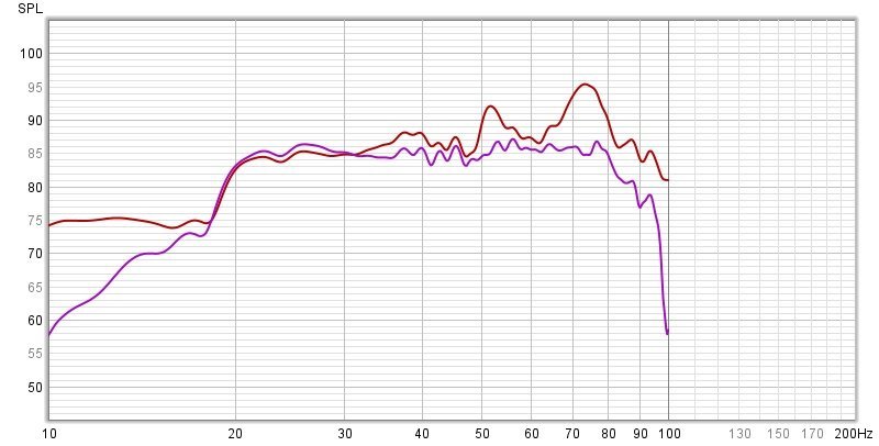

I have 15s in my 24x36x36 THTs in a huge open basement. Here's my before and after sweeps in REW:
Klipsch + dual THTs=
Re: Age old question: 15" or 12" for THT?
The reddish line was the initial sweep, the purplish line was after mild EQ and adding a steep 16Hz high pass filter. These things are absolutely nuts.
That purple line looks reeaaallll nice. The T39's I've been using are nearly flat down to 30hz, but they drop like a rock below that. I can get my Table Tuba down in the low 20's, but it's just not very loud when it gets that low.
24" wide is likely what I'll go with, but I need to measure my space and make sure it's a good fit. The Dayton Ultimax's are the same price as the RSS390 HF-4, so I'll probably just go with the Ultimax even though it's overkill. If only the price of plywood would come down.

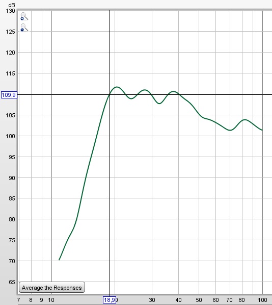

Shawn. I have 20 Hz extension on my 12" thtlp aswell. Minimum width.
With my tiny 50w board amp, I can sweep about 110 dB at 20 Hz.

Response is with audyssey dynamic EQ and minidsp correction, hence the falling response. (Dynamic EQ boost lows)
Oh nice, that looks great. I haven't purchased anything yet because I haven't had much free time (my kids play baseball and soccer). I was kind of set on going 15", but your graph is making me question that.JensToft91 wrote: ↑Mon May 09, 2022 3:15 am Shawn. I have 20 Hz extension on my 12" thtlp aswell. Minimum width.
On a side note, I noticed last night that the T39's I've been using caused a crack on a drywall seam right where they're positioned. So maybe the 12" THT is the better choice for the sake of my house
