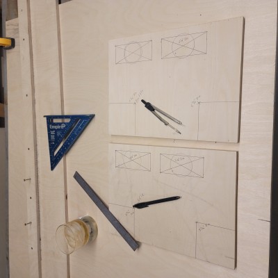

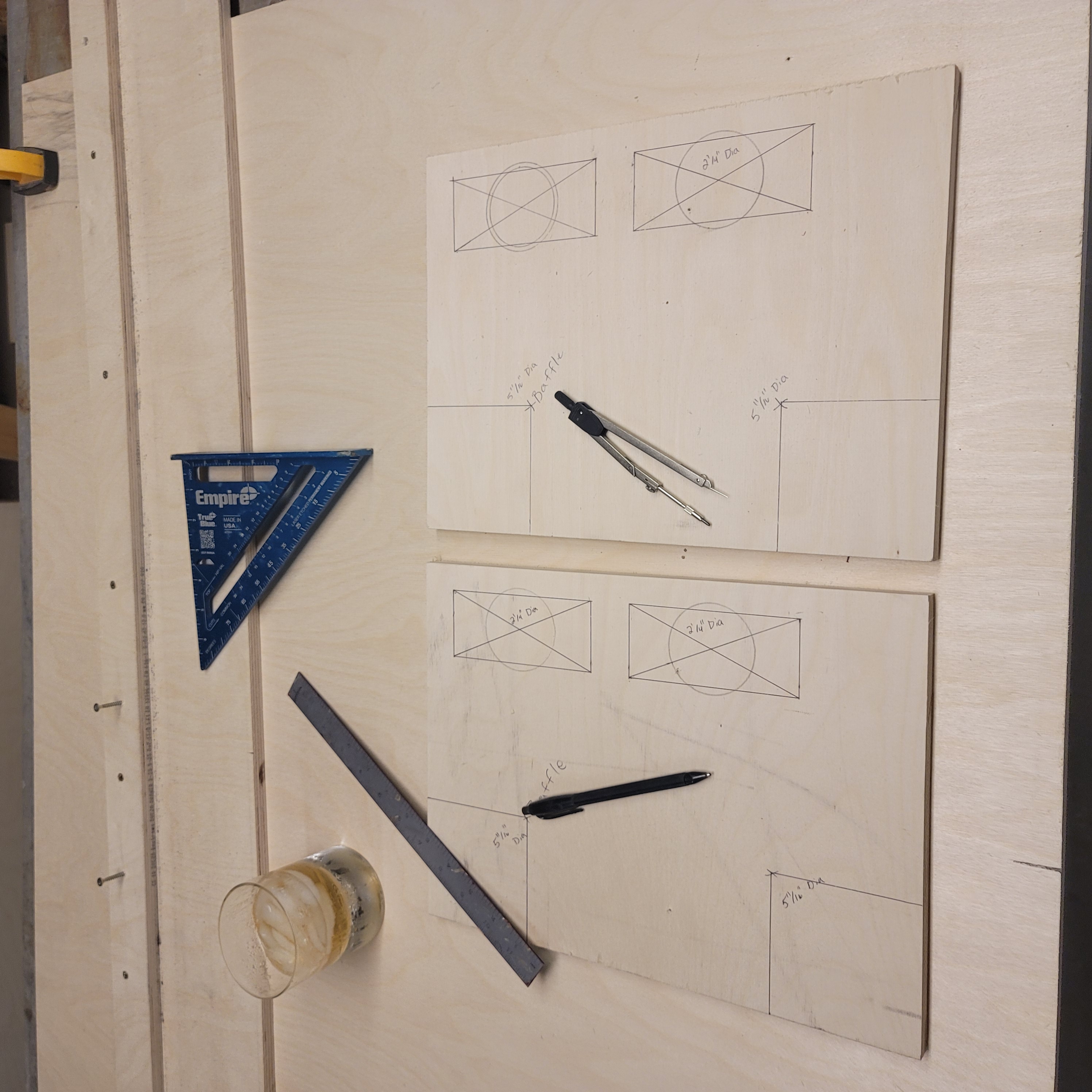

With that said, I began the 2x SLAP shorty's tonight. I only got about an hour to work, but I was able to cut the sides, baffles, and backs. I have to still do the baffle cutouts, but meh, I have tomorrow. I also had to make another circular saw jig. When I retired, the movers classified all my circular saw jigs as scrap wood and not tools. They will not move scrap. At any rate, I'm excited to be building again!
Key point tonight...the SLAP plans say there are half- moon cutouts for the tweeter barrels but provide no dimensions. If using the Goldwoods, the diameter for that hole is 2 1/4". I'll be cutting that out with a hole saw and finishing it with the jig saw.

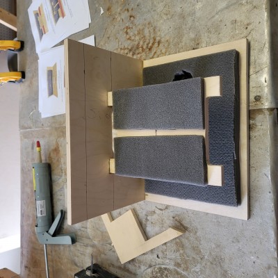

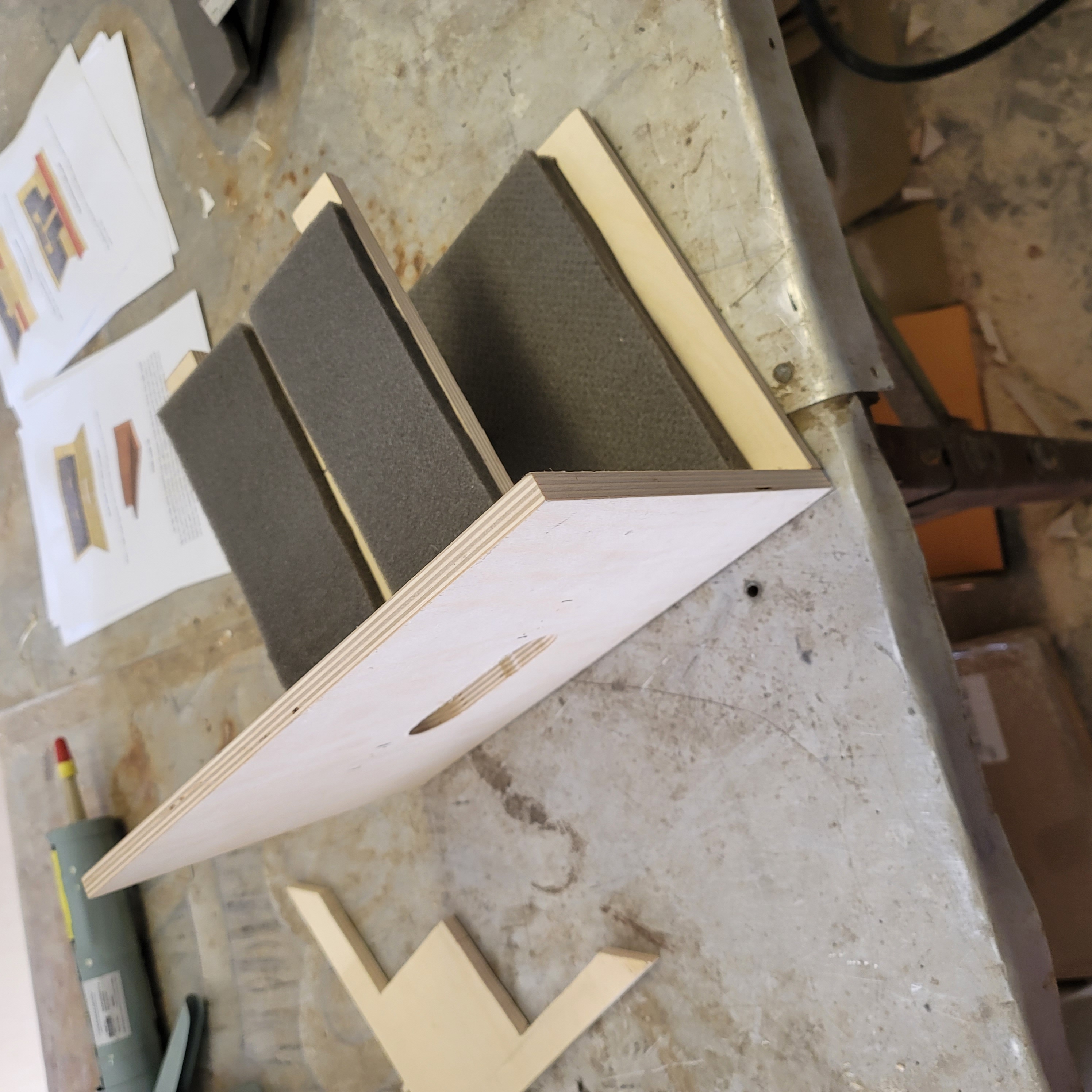

Not much to report for last night. Spent an hour in the shop. Made a hand hole jig and cut the hand holes in the sides. Then I cut and attached the braces. No pics though. I didn't have much time so I spent it working.

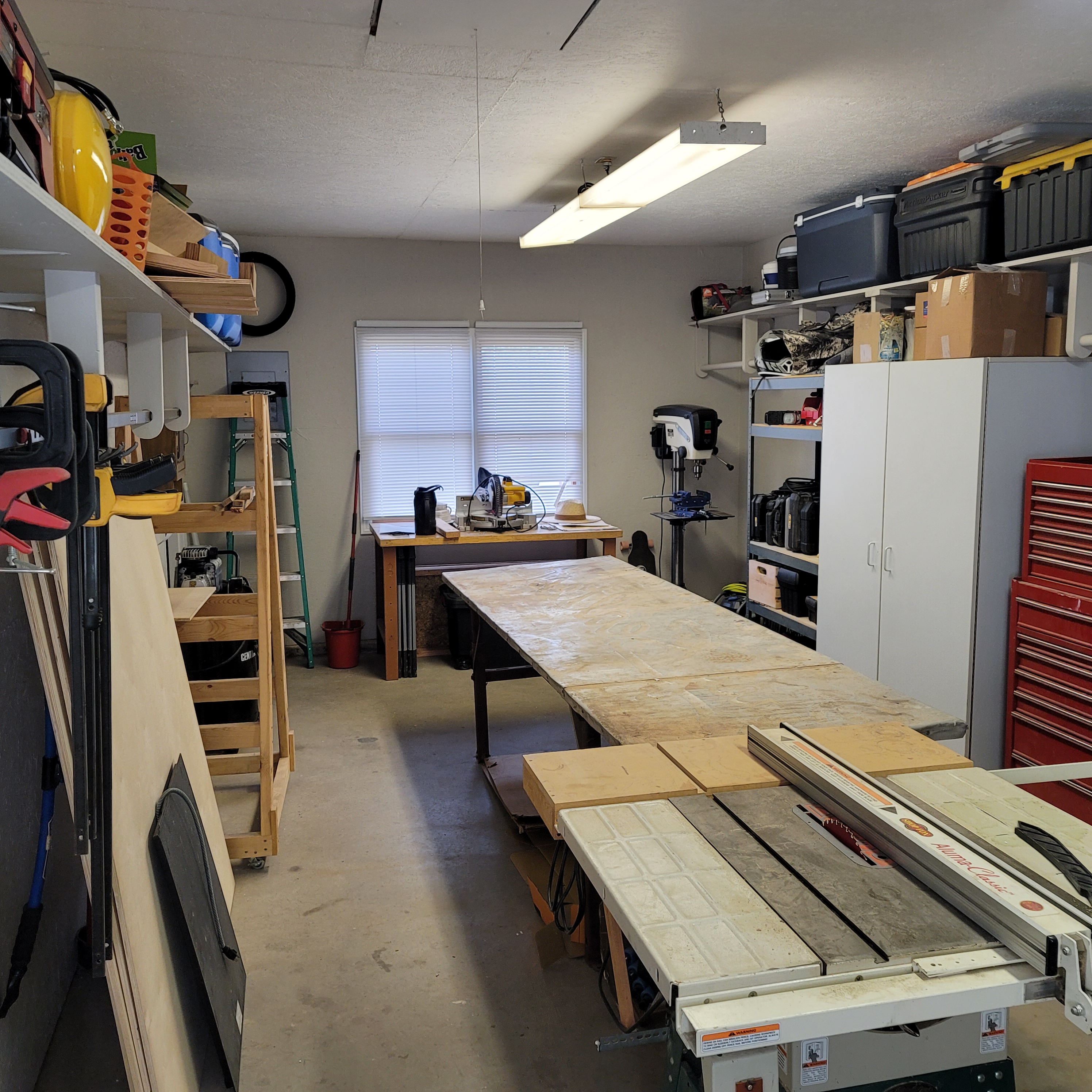

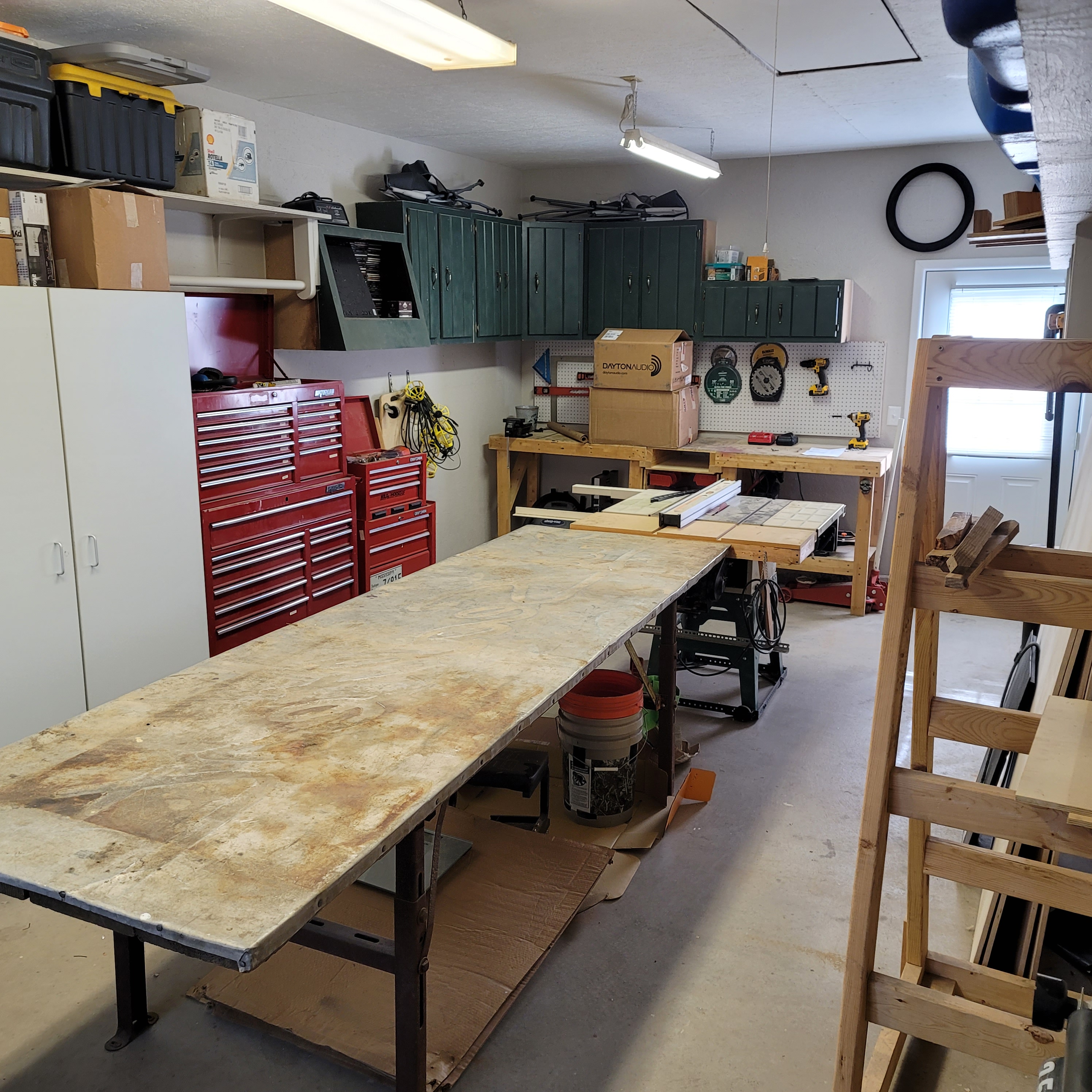

Bryan, that workspace looks fantastic. Perfect for these kinds of projects. It's a rare moment in time that my space looks that tidy, clean, and organized.

Thanks, Seth. I really like my workshop to be clean and organized. I find if it's cluttered then so is my brain when I'm trying to build. Weird? I don't know. It's just how I operate.

Haha! Very true. I'm working though the kinks of where I like things and how best to keep it tidy. Truthfully, I don't have a lot of organization options. All the cabinetry and shelving was there when I moved in. I've thought about taking some down but for now it's handy.

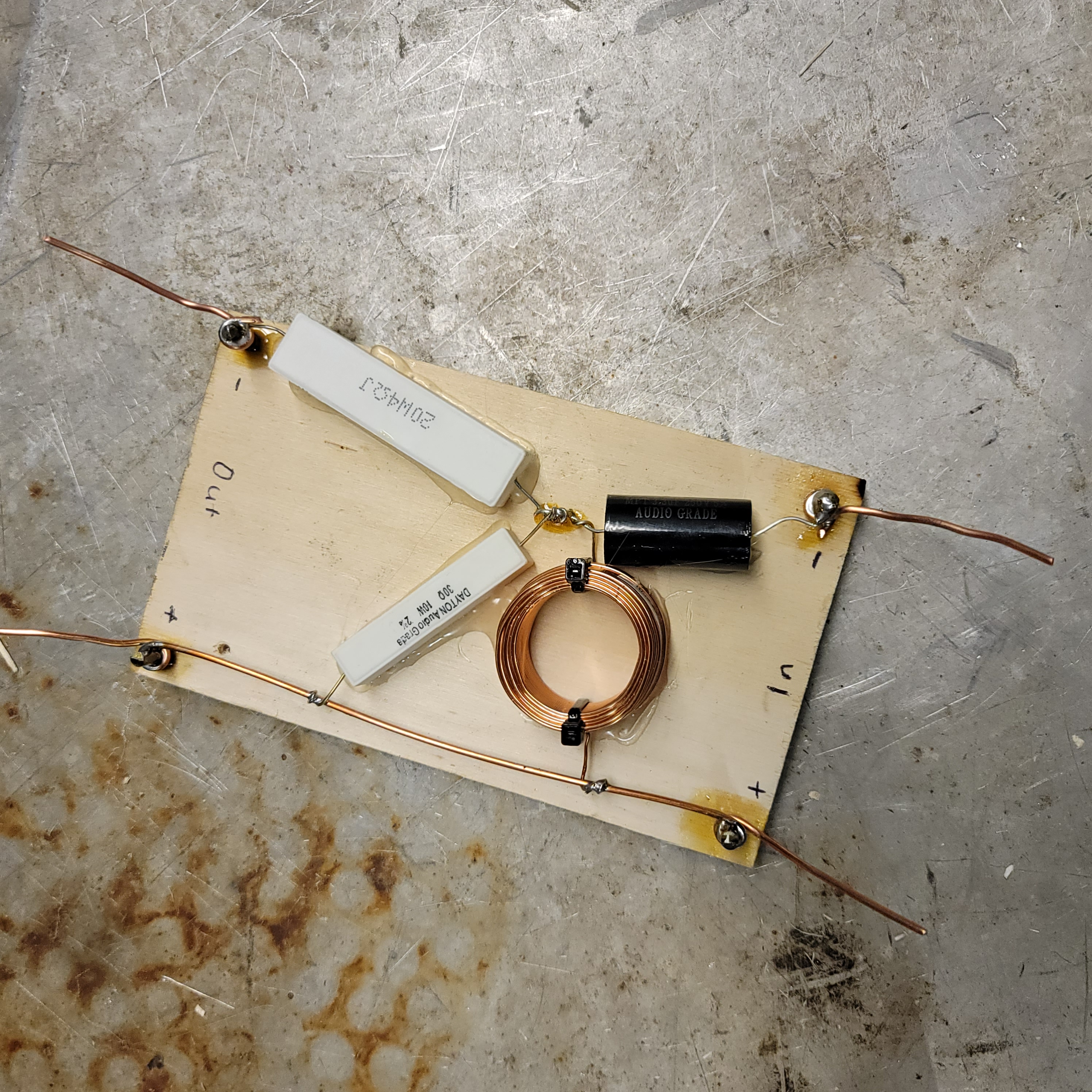

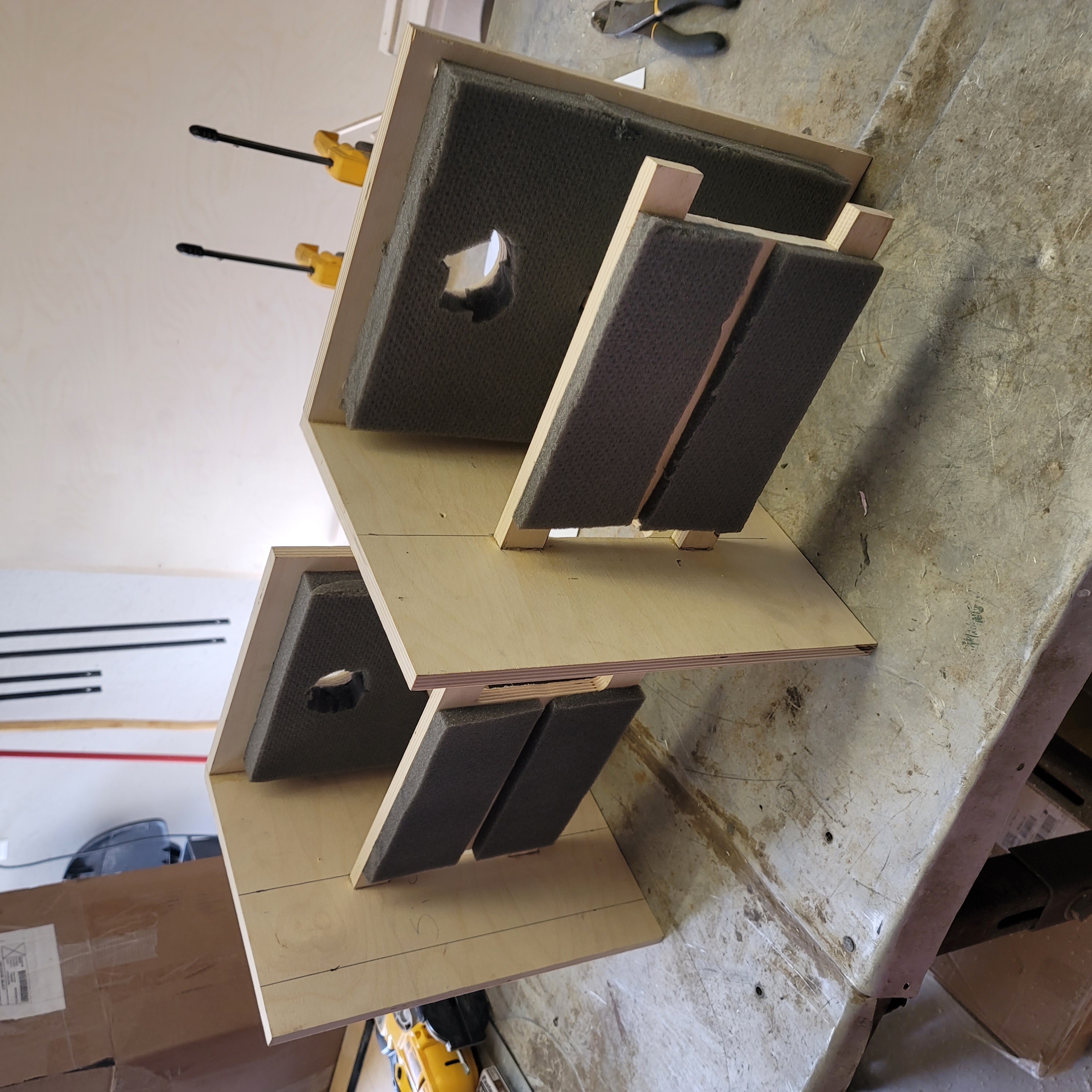

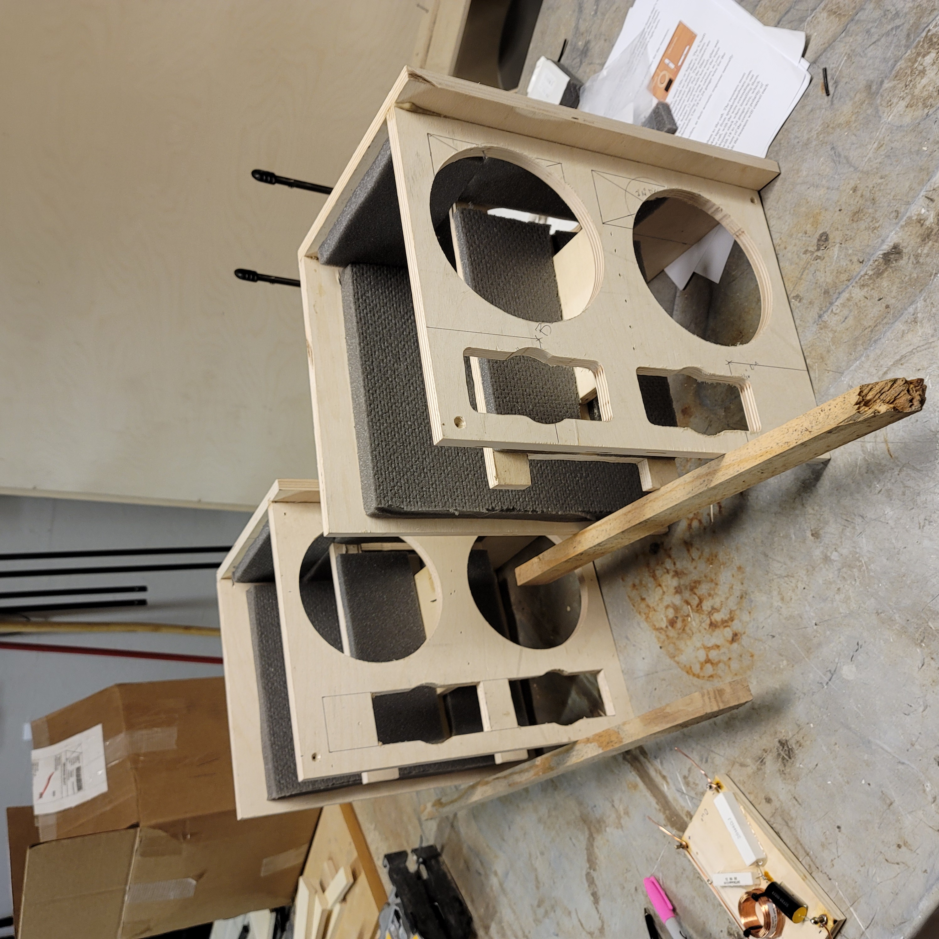

Spent a few hours in the workshop today and made decent progress. I'm not attempting to win any beauty contests here but they are square and correct, I believe. The customer doesn't want to spend any extra on bondo, sanding, duratex, etc.. He wants flat black and doesn't care in the least for cosmetics. In that spirit, I used ply, nails, and romex for the crossovers. Hopefully I'll get more time tomorrow.

I don' care what my crossovers look like either - as long as they work. Cabs are looking good.
