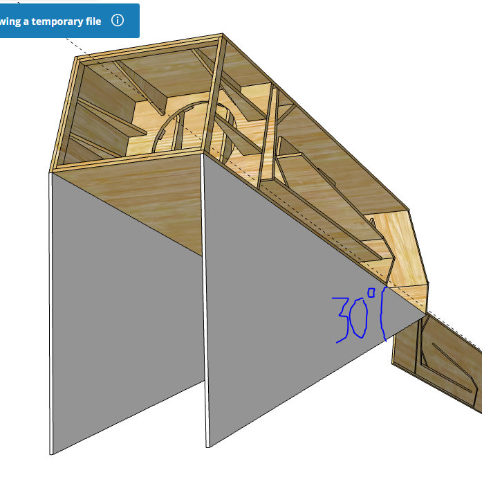

So i was reading that '' In this case create a virtual extension of the horn by facing it downward, the upper edge supported to place the mouth at about a 30 degree angle.'' and it gave me an idea wich is to make 30 degree removable side pannel to mount on a thtlp. Would there be any gain? i think it would be a good way to have deep bass outdoor event in a somewath easy to carry setup.

It wouldn't get you anything that corner placement doesn't. As for using a THT for outdoor events, it's the wrong tool for the job. T60 would be the right tool.

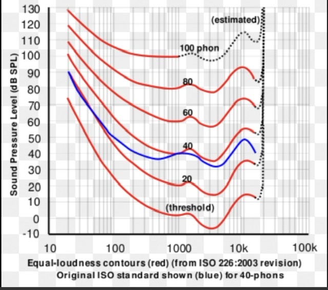

At war level, some 100-110dbspl it takes an additional 20db just to reach equal perceived loudness in the 15-20hz range.

ok thanks for all these enlightenment. For some reason i tought that the reinforcement wall would an elongation of the horn so the length of the wall would add up to the length of the tuba and therefor require a somewhat small area of a few
4x8 sheet with square iron support welded togeter. Seem like I was wrong again.
- Posts: 29088
Re: THTLP side plate?
Indoors the wall doesn't need to be a wavelength in dimension, since you've got a another wall at either end and a ceiling. Outdoors it's completely different. You can get good wall loading down to 50Hz off the side of a house, but it takes an apartment building to get down to 20Hz.
