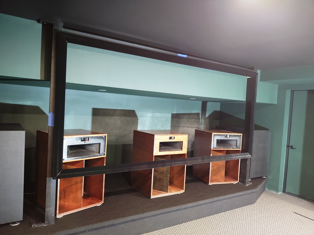

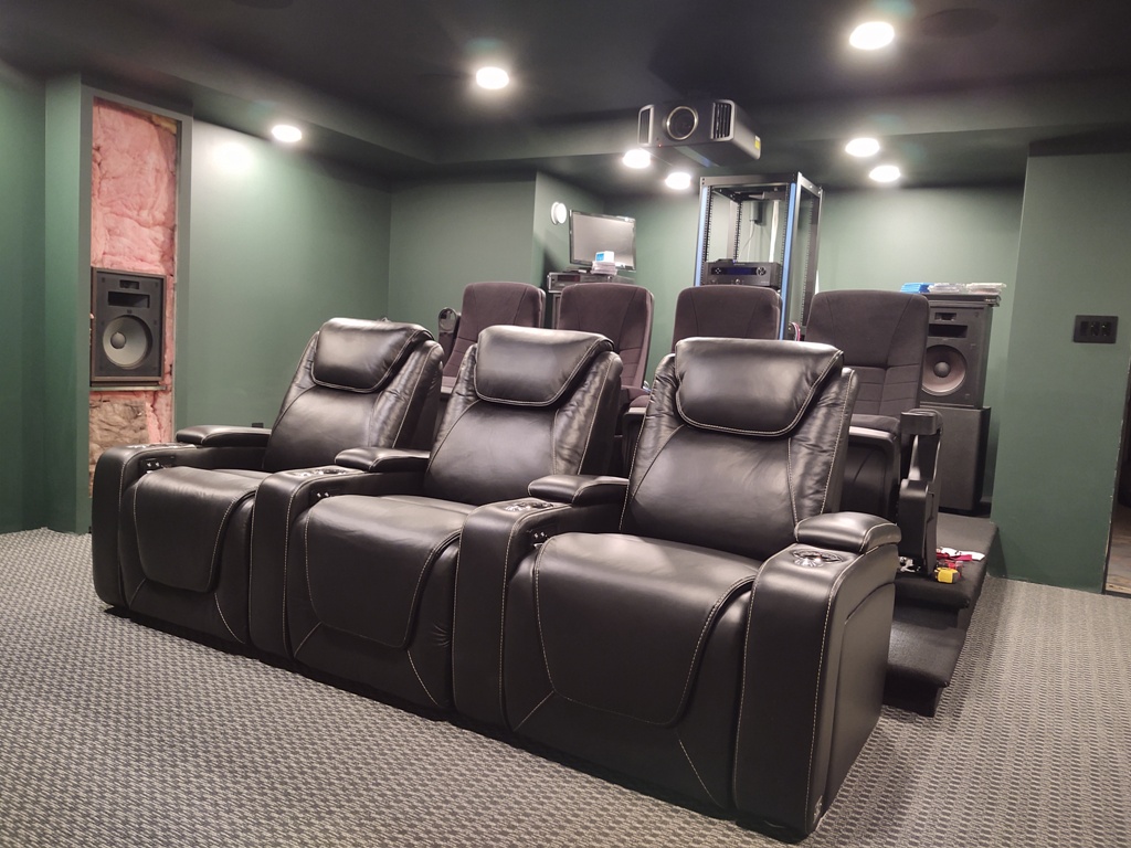

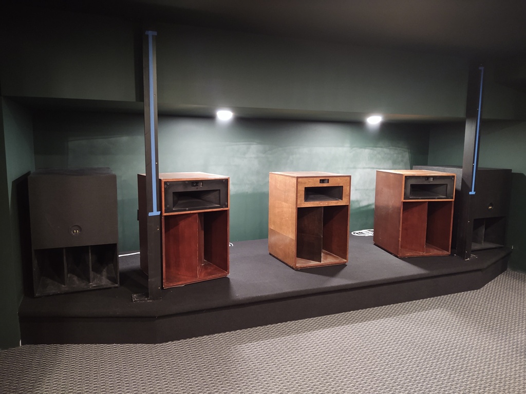

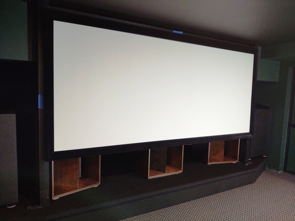

So yesterday my neighbor helped me lift the 50 lb. beast of a projector onto its ceiling mount. I got it hooked up and adjusted image location on the screen. Then I decided to check various Blurays with different aspect ratios to see how they appeared on the screen and made some minor tweaks. Then I discovered that I had no center channel audio and found that I hadn't connected the XLR cable from the XMC-2 to the amp. Whoa, did that make a difference?
My friends have asked me what would be the first movie I'd watch when the theater was done. Well, it wasn't a movie. The last aspect ratio I checked was 16x9 and happened to be with the Bluray of the Eagles Farewell Tour Live from Melbourne. And I thought it might be good to sample the audio since I had just added the center channel to the mix. Well, I sampled nearly the entire concert. The projector throws a spectacular image, but the audio was unbelievable. With DTS-HD Master Audio 5.1, I've never heard a more realistic concert audio track or one that is as percussion-forward as this. The 40+ year old Klipsch Heritage speakers performed beautifully and the capability of the Tuba HT DIY subwoofers was more than confirmed. Tight, punchy bass was fabulous. And all I've done in audio setup was to set speaker distances. I haven't gotten the dB meter out yet to set levels and haven't even thought about setting up Dirac. Or experienced a movie with a Dolby Atmos soundtrack. And none of the room treatments have been added. So this is going to be a really fun journey!
I still have lots of finishing to do in the theater and I'll look forward to very high quality work tunes along the way. Still haven't decided on a first movie yet.....

You may find the surrounds a bit too locatable. If that's the case placing diffusors in front of them would help. Something like this, which isn't difficult to DIY.

Thanks for the advice Bill. So far I haven't noticed that being a problem, but haven't dialed in the system yet.
