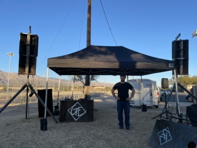

Thanks guys. I may try eBay. Event went well today. My meter read 94db 20ft in front of the speakers and was easily heard across the park.
Re: Splitting my rig?
Less than a quarter watt per OT12... if I'm mathing that out right. Of coarse, an spl meter doesn't tell us which freq peaked the meter. Maybe it was the subs... at less than 2 watts each.
