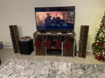

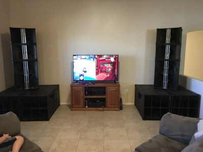

#13 Post by ACUA »
I have had both my pro audio rig and my new Tlah rig set up in my home. My personal opinion, the Tlah is the better solution. They fit the room better and appear to need less DSP than my otop12 cabs. Perhaps if the melded piezo array was used I would think otherwise. I do not for a second regret the rig just built. I need to build my table tuba to complete the system .
