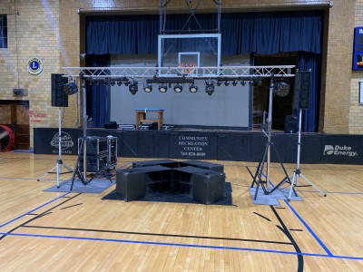

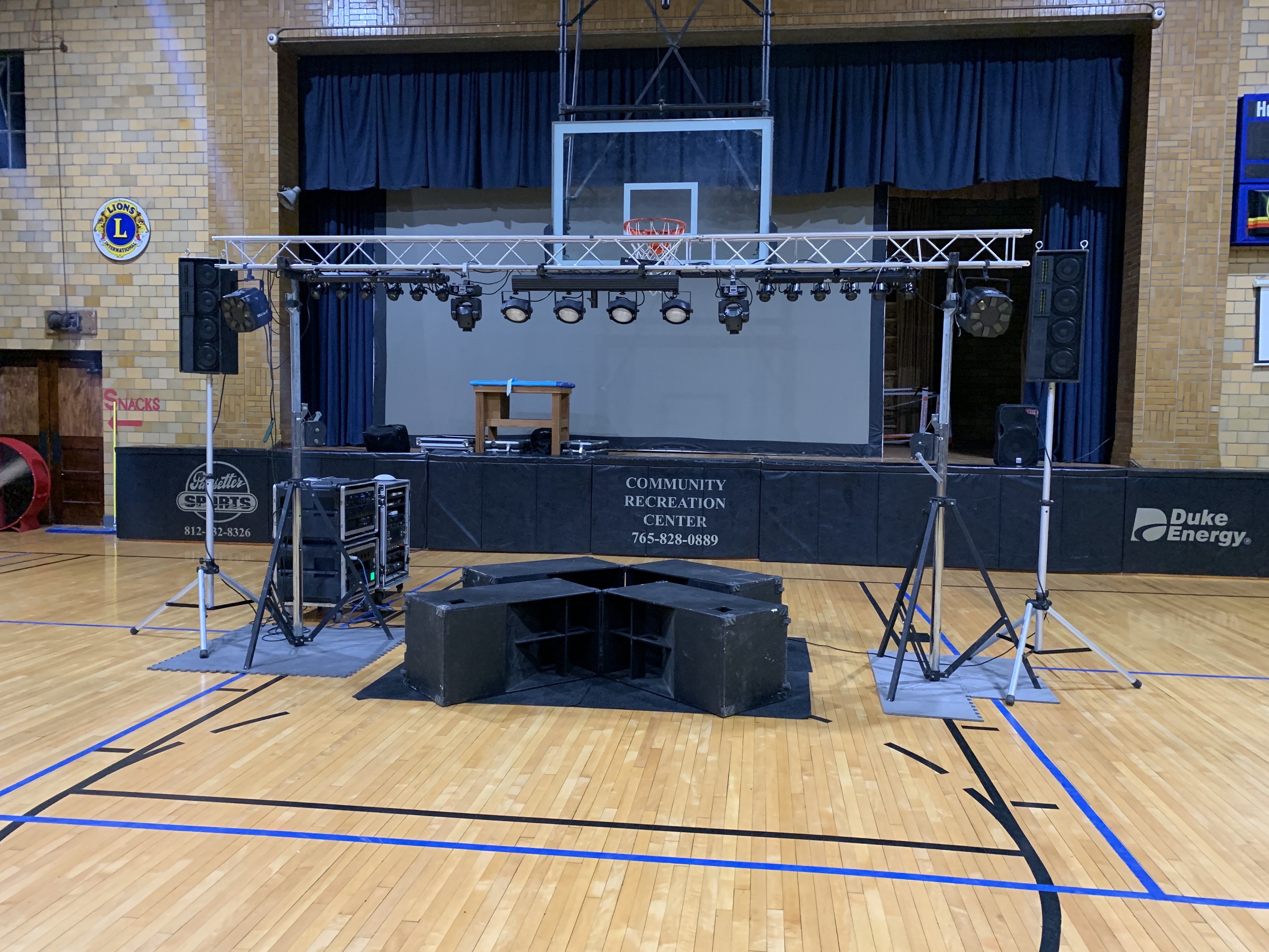

Had a chance to setup my rig in a big old gymnasium and experiment with an end-fire configuration.

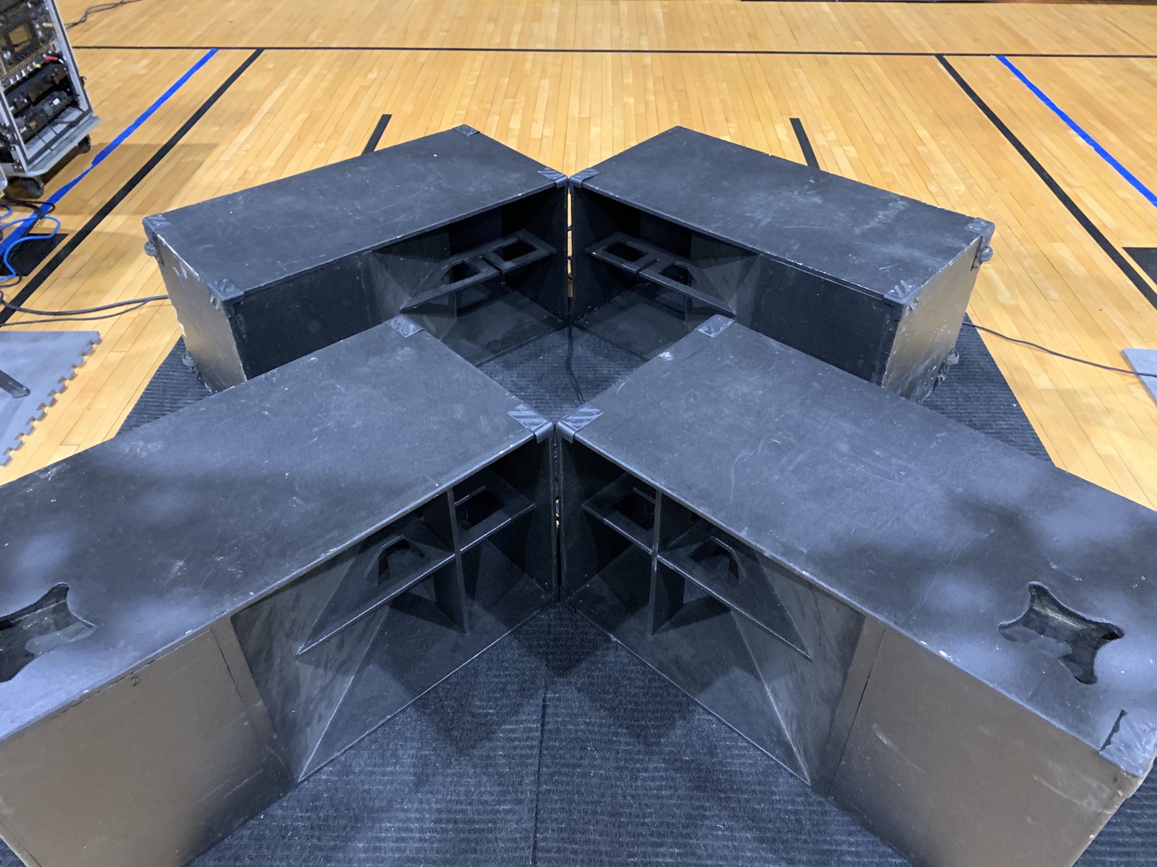

I used 2 pairs of T39s in a V layout and a DriveRack to delay the front pair.
I tried 3 different configurations:
FREQ, DELAY, DISTANCE
@75Hz, 3.24ms, 1.1m = 3’ 7”
@60Hz, 4.12ms, 1.4m = 4’ 7”
@50Hz, 4.85ms, 1.65m = 5’ 5”
There was a significant reduction in LF behind the cabs with all 3 configs.
I would absolutely use this at a show, as long as there was enough space in front of the stage. If the stage were high enough, adding another 4 atop these 4 should give similar results.

I don’t have a good meter, just an iPhone.
Levels in the front was normal, as expected for 4 cabs. I’m sure 4 V-plates would be louder, but my goal was to see if I could minimize stage volume.
We run e-drums, guitars direct with modelers, and IEMs, so it can be annoying to have lots of low end onstage.
