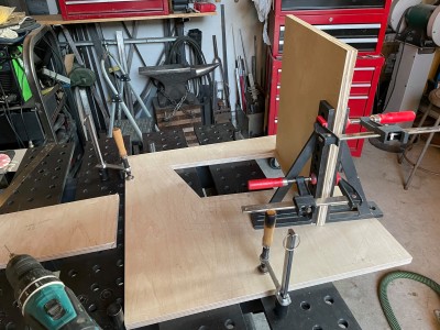

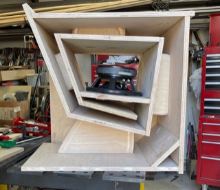

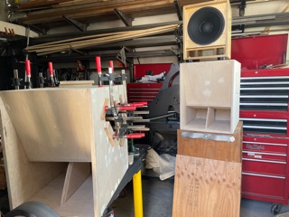

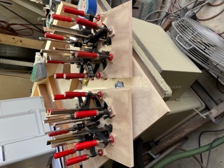

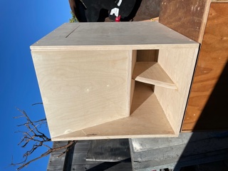

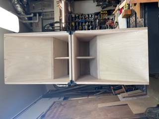

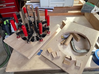

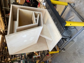

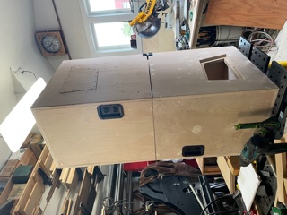

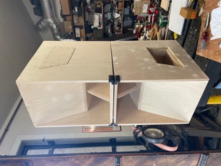

Well here is the rig so far, about a month in. These are 3/4 baltic birch. I had a few sheets of 3/4 ply left over from some furniture job. These are not perfect, this is my first time building something this boat like. They sounded (My bones felt) great.
Trying to start the DR250s. Trying also to source unavailable power amps. I have a QSC GX7, it works fine. And a B-Stock QSC GXD8 that arrived unusable. I'm really pissed about that. $150 service deposit vs returning it? I already took it to the authorized service center. The unresponsive sellers finally got back to me, offered to take it back, refund/find another option. Maybe I keep it, does anyone else like or need DSP units? I put together active crossover/eq/limit back up in the amp rig. So I can run a two or three way system if the GXD8 went down. It never got going.
You can see one of the two EV TL806 cabs I build in one of theses pics. Those are my guitar rig bins. Super sweet EVM 12Ls

Craig, those look great man! Nice 'n square, clean edges, spot on angles on all the joints... nice job!
Judging by your workspace, you're not new to woodworking, are you...
Aimed more toward the casual reader/future builder; the use of ¾" ply is generally avoided in all of Bills designs. In most of the plans, it specifies ½" as the building material but doesn't say not to use ¾". However, a couple plans do state "You may be tempted to use ¾” plywood, but this design is so well braced that all you’ll gain is XX odd pounds of unnecessary cabinet weight. " It's one of those things that's been echoed, parroted, and regurgitated here on the forum over the years. Some have claimed that the altered internal dimensions of the horn negatively effects performance, but I can't recall Bill ever saying that. Conversely, I have read him state something to the effect of his designs being so forgiving that slight variations have minimal effect on performance. Just a little note about that. And Craig, you had the spare ply, so why not, right? And you're happy with the end product, so no harm-no foul. (until it comes time to lift and load them LOL).
I look forward to hearing of your progress through your DR250 build. If you start a build thread, there are people here that have built them who have handy tips and can help avoid pitfalls. I have all the material and parts for 4 DR200's collecting dust. Haven't had the inspiration to follow through on them yet. Your build could be just what I need!
OH! A little side note, Craig... If you haven't yet read the Rules for Subwoofer placement and stacking thread yet, check it out. Good info there to get the most out of your new toys.
