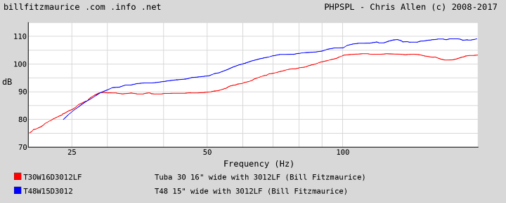

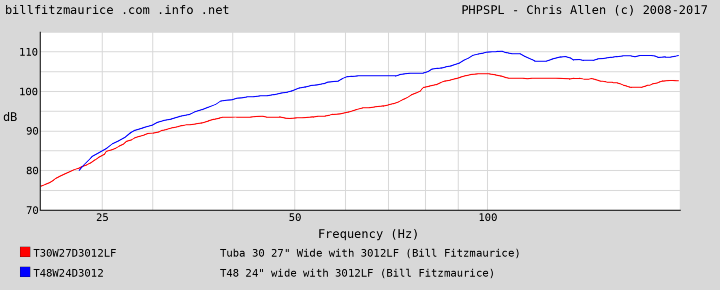

In a similar width comparison, T48 is superior, hands down. Throughout much/most of the usable frequency range the T48 would match the T30's output with ½ - ¼ or less amplifier power. Bottom chart, 60Hz... if the T30 were fed a 28volt signal (~100 watts), the T48 would match the output with only 9.15volts (~10.5Watts).
In the comparison above, the T30 is 8.3 ft³ and the T48 is 10 ft³
In the comparison above, the T30 is 14 ft³ and the T48 is 16 ft³

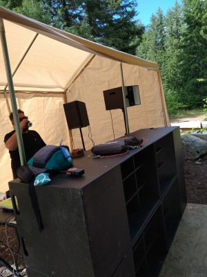

Here's some T48's set up outdoors, similar to how you're describing (not my setup, just found the pic in a google search) I suspect this photo belongs to Wylandright206 and/or Armchair Pirate, users here on this forum.
Here's what Wyland had to say about them
Wylandright206 wrote: ↑Tue Jul 21, 2020 3:39 am Myself and armchair pirate worked a renegade festival this weekend and we brought two of our t48s out, and I'll say, that was nothing short of a treat. I cant imagine why a majority of society would ever have a need for more than 2. These things make f1s f221 sound like small dice.We had people dancing 2 miles up the river follow the sound, and eventually find us to join the party. I never felt like i was anywhere near topping out at any point. But the ground in front of the horns was basically hovering at the kick. I dont know what you did bill but you did the shit out of it and I'm happy to rep your brand here in seattle. I wish leland still had those BFM name badges I would buy 8. Basically every attendee and musician was consistently absolutely floored by the sound being produced by your designs. I'm convinced anyone who doesnt enjoy the sound of these is either a paid shill or completely deaf.
