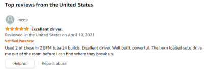

Cool little KL3010LF review on Amazon...
