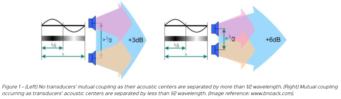

Clarification on this for the casual reader...
Adding a second subwoofer(or doubling a stack of subs), yet placing it more than ½ wavelength of a produced frequency from the initial subwoofer will not mutually couple and the system output will typically see a 3dB average increase. However, if the second sub (or stack of subs) is moved closer to the initial sub/stack (between ¼-½ wavelength), the cabs output couple and act as one single cab and the output increases another 3dB for free, just for having them close enough to couple... ultimately a 6dB gain over not having the second sub (stack) to begin with.
There are plenty of reference sources available. A quick googling brings up a decent article on the QSC website; What does Subwoofers Mutual Coupling Mean

Bill Fitzmaurice wrote: Tue Jun 07, 2022 6:37 am
Seth wrote: Mon Jun 21, 2021 6:00 pm Adding a second subwoofer(or doubling a stack of subs), yet placing it more than ½ wavelength of a produced frequency from the initial subwoofer will not mutually couple and the system output will typically see a 3dB average increase. However, if the second sub (or stack of subs) is moved closer to the initial sub/stack (between ¼-½ wavelength), the cabs output couple and act as one single cab and the output increases another 3dB for free, just for having them close enough to couple... ultimately a 6dB gain over not having the second sub (stack) to begin with.
I didn't notice this when originally posted, but now that the thread has been resurrected...the difference between when sources are mutually coupled or not isn't 3dB. When mutually coupled you get a 6dB sensitivity increase across the full bandwidth. When not mutually coupled you still get 6dB at most frequencies, but not at all frequencies, depending on the relative positions of the sources and the listener. There can even be cancellation notches at some frequencies. Preventing that is why you should either place subs less than 1/2 wavelength or more than 2 wavelengths apart.
Is the information in the link I posted incorrect or incomplete? Have I misinterpreted it, maybe?
