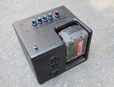

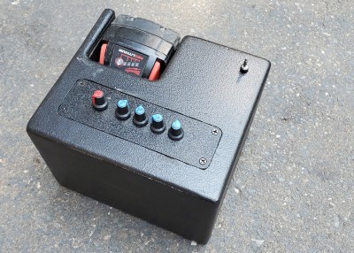

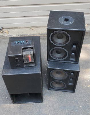

Yes, these little amps are great!
I use mine with a Milwaukee 18 volt battery and it will run a 2.1 system all weekend on a battery as long as I'm not cranking it. I currently use it with T18-6 and a pair of SLA pro speakers in half sizes (two drivers per cabinet) and I've found it will also run a small house party. I can bluetooth my iPad to the unit and walk around and mingle with guests.
amp paired with SLA's and T18
back view of amp module
Front view of amp module
