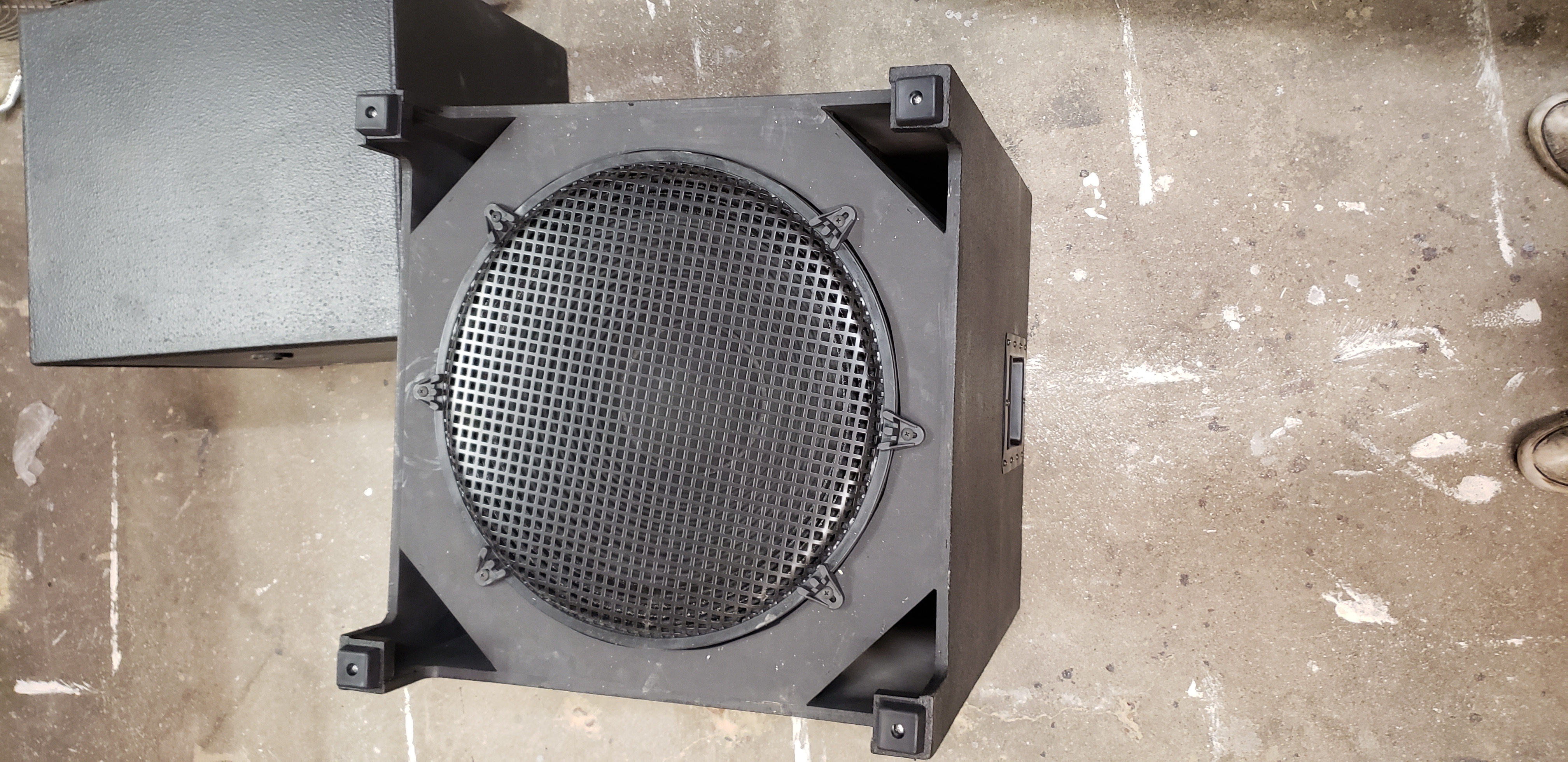

I stumbled upon this place after doing hours of research into how I could duplicate a now defunct Carvin cabinet model trx2218b. I heard this sub and it is unbelievable how much low end it puts out compared to a proline JBL for example. what I like about them besides the obvious loud bass volume is that you can lay them down and stack them for coupling of multiple cabinets for even better bass. I haven't seen pics of the simplexx 18 but I was hoping that they were close to the same design . does anyone have a particular 18" speaker that they would recommend without breaking the bank? I can get ahold of the same speakers from Carvin but my fear is that if I ever blow them I won't be able to find a suitable replacement. I'm leaning towards Eminence.

Actually, they are nothing like the Simplexx 18 sub design. The Simplexx 180 sub is a down-firing cabinet that can be placed side-by-side, but not stacked.

The S18 is similar in the fact that its a bass reflex 18" with 4 corner ports. Beyond that, I Haven't studied the specs well enough to say more..
The S18 is a great cab, but depending on your use case, the horns can preform even better.

i was looking at the simplex 12 and saw two of them in a front firing cabinet and i thought they made a 2-18" version of that.

apparently I had the model number of the Carvin cabinet wrong, it was a TRX3218 loaded with Faital Pro 18"s. my friend tells me that it's the one I heard. same cabinet design for the most part. I like the compactness of the cabinet for how low it gets and how hard it throws. but I'm open to make better cabinets with horn loaded designs if that's the consensus.
