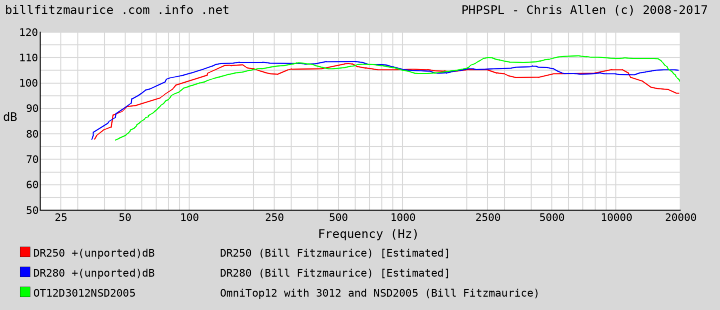

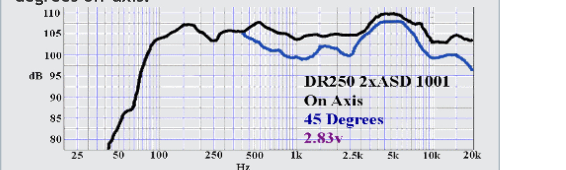

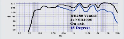

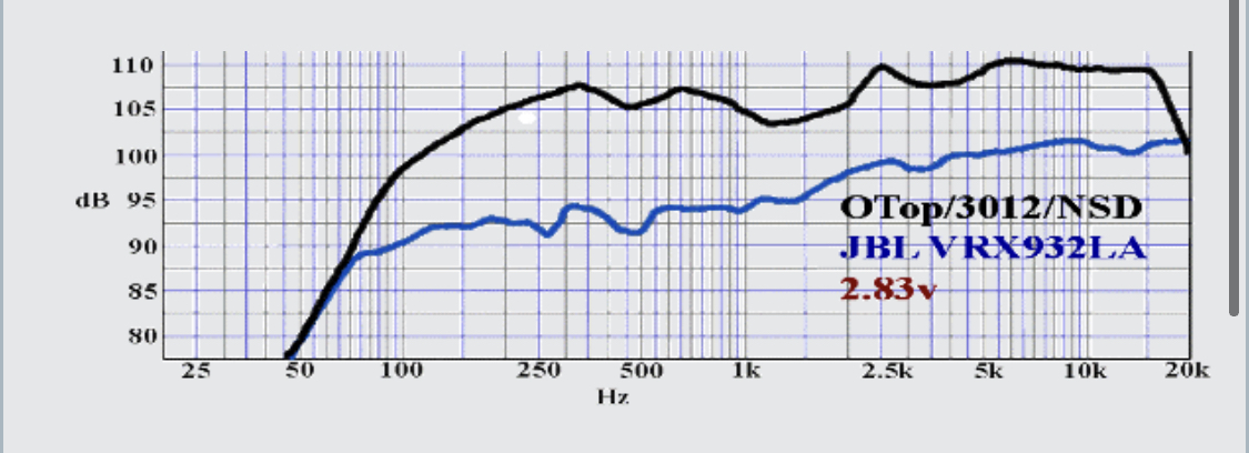

I wanted to share these SPL curves. My comparison is the OT12 (premium load) the DR280 and the 250. Look closely at the response from 150~200hz and up of all three. The OT12 is right there with the DRs. That dip at 1.2k may normalize with multiple cabs or can be improved with XO phasing or delay tweaking. From 180hz and up the OT has an average output of 105-108 +/-3db all the way to 18kish (with some attenuation/flattening of the peaks) and still leaves some in the tank with the HF driver, which will most likely normalize with multiple cabs coupled. The 250 is darn close (a little more) and the 280 has alot of HF headroom and maybe a db or db and a half more sensitive overall. My point to this, is if you can use a slow rolloff LP high end of a T48 and a higher xover point (and higher order) of the OT around 115-120hz I’ve seen enough best practices of similar XO designs where it makes for a nice flat transition, or keeps it at least within +/- 3db through the 100-150hz spectrum. The T48 has plenty to give up to 100-120Hz. Id want the 80-100Hz kick drum spectrum mostly in the T48 for maximum impact while the upper end snap is in the Tops.
Point is, I really have alot of faith in the OT. The 280 with a narrower horizontal pattern and deisgn will throw further, which is a plus. So I’m really still between the 280 and OT and leaning toward the OT with multiples and a tall array for the full rig. I still do want to have an estimate of 280 weight though, if skmeone has a ballpark.
Hope this helps folks like me in the future. Or confuses them more like me. haha.

Drivers are not specified in the DR range, nor the tweets. Max output is not shown either.

burnsze15 wrote: Fri Feb 12, 2021 10:20 pm The 280 with a narrower horizontal pattern and deisgn will throw further
Throw isn't a product of the pattern width. SPL drops by 6dB per doubling of distance no matter what the pattern, unless the source is at least three wavelengths high, in which case it drops by 3dB per doubling of distance for a given distance before it reverts to 6dB. The 280 has a narrower pattern because the radiating plane is wider. The advantage to that is it goes lower.
