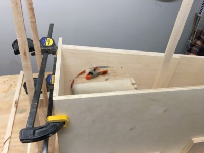

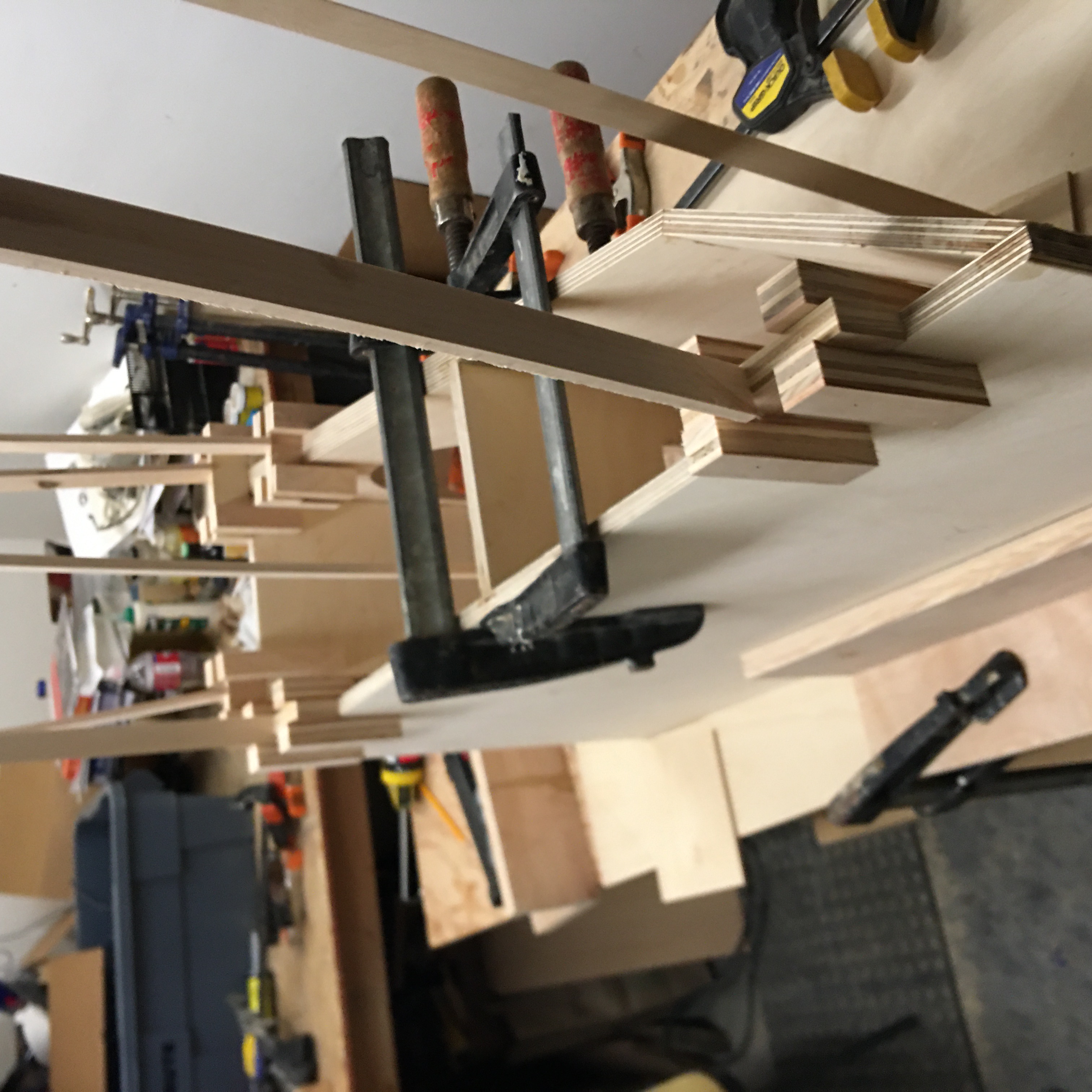

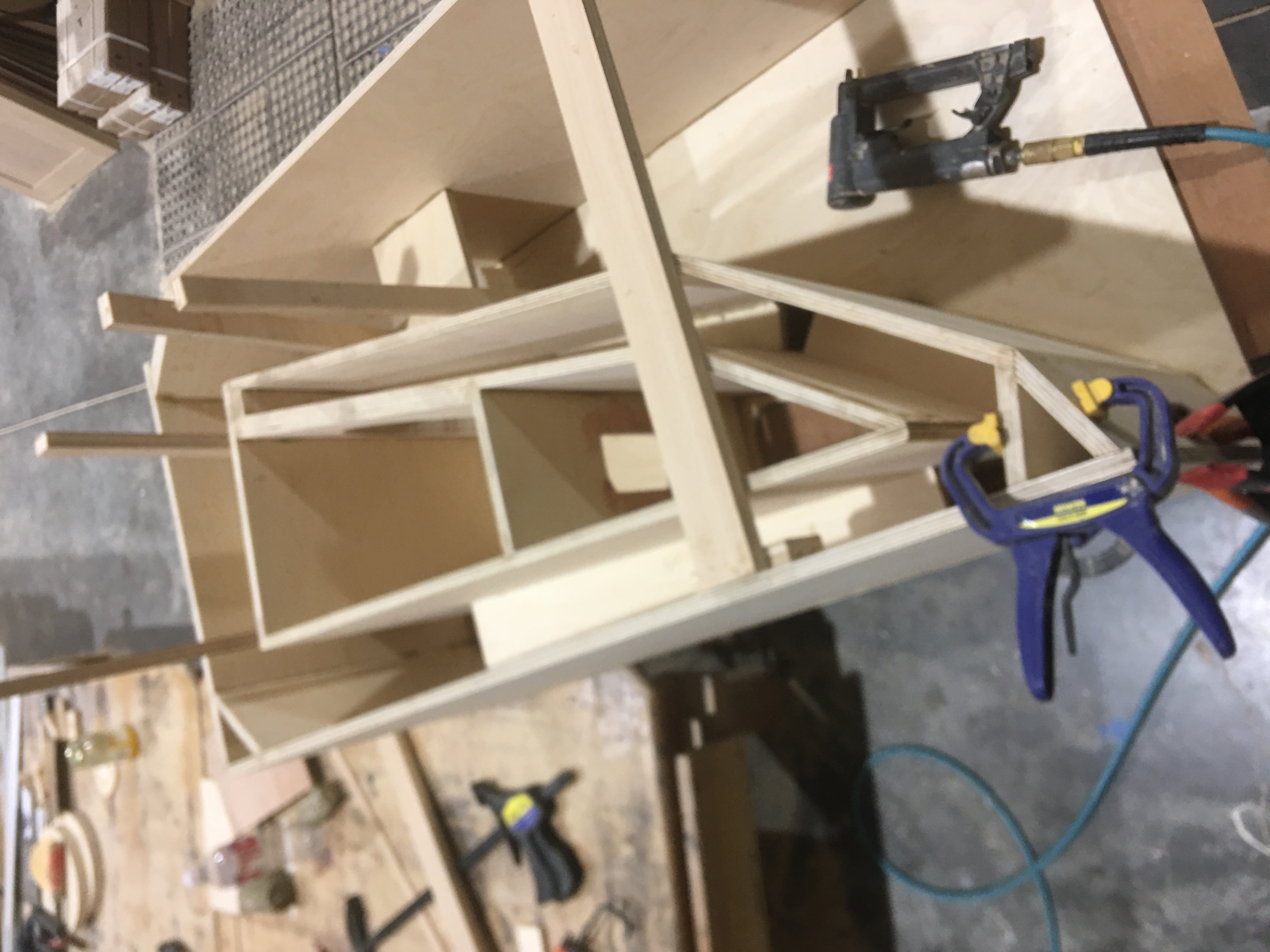

Hey Everyone,
We are building a couple of Tuba 45's! Check out the photos of our build:

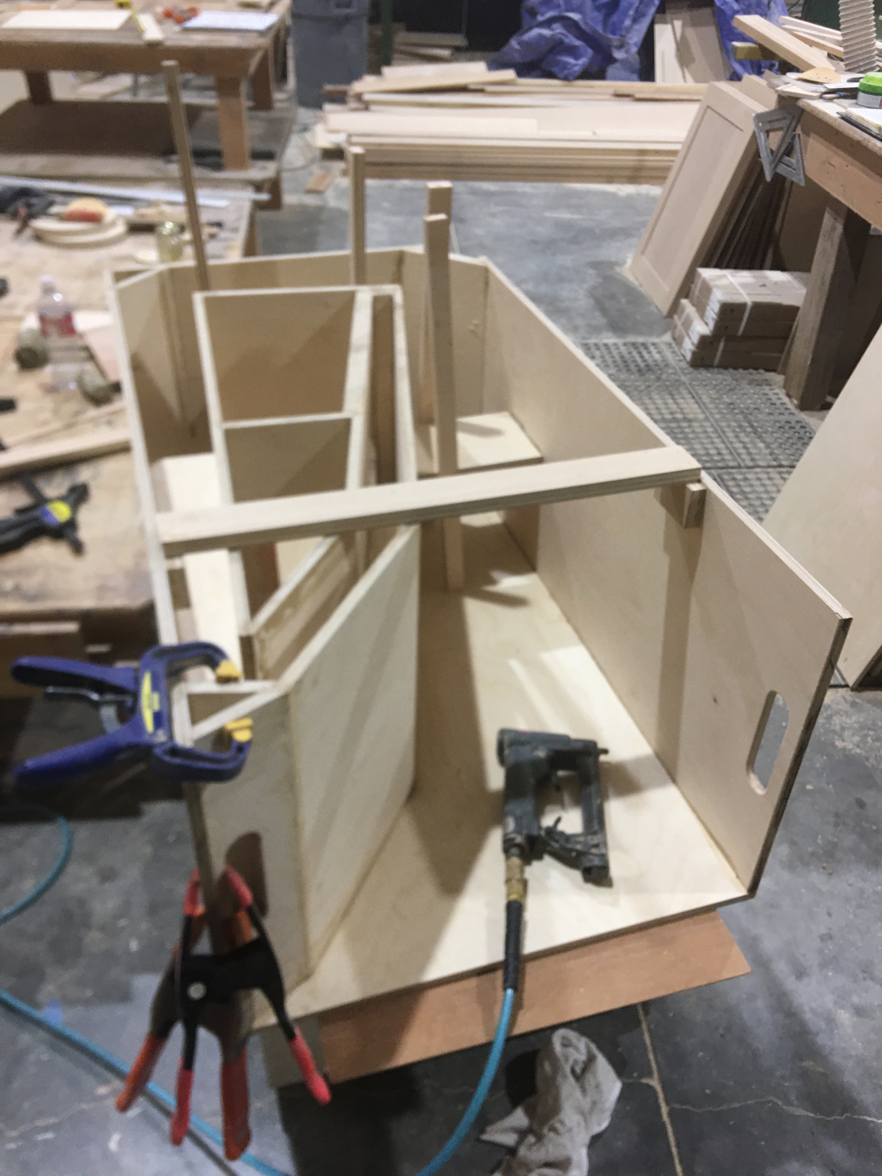

#2 Post by Pabloaguas »

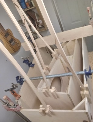

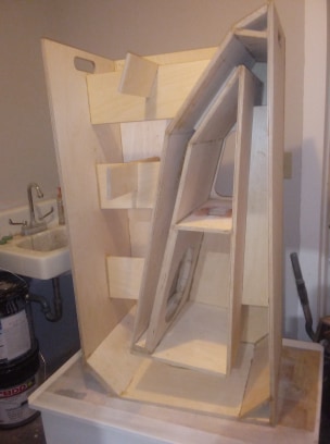

More pics

#4 Post by Seth »
Looks like you made a little custom modification. Did you shrink the 45" dimension down an inch or two? Are you just making room for an inset grill frame?

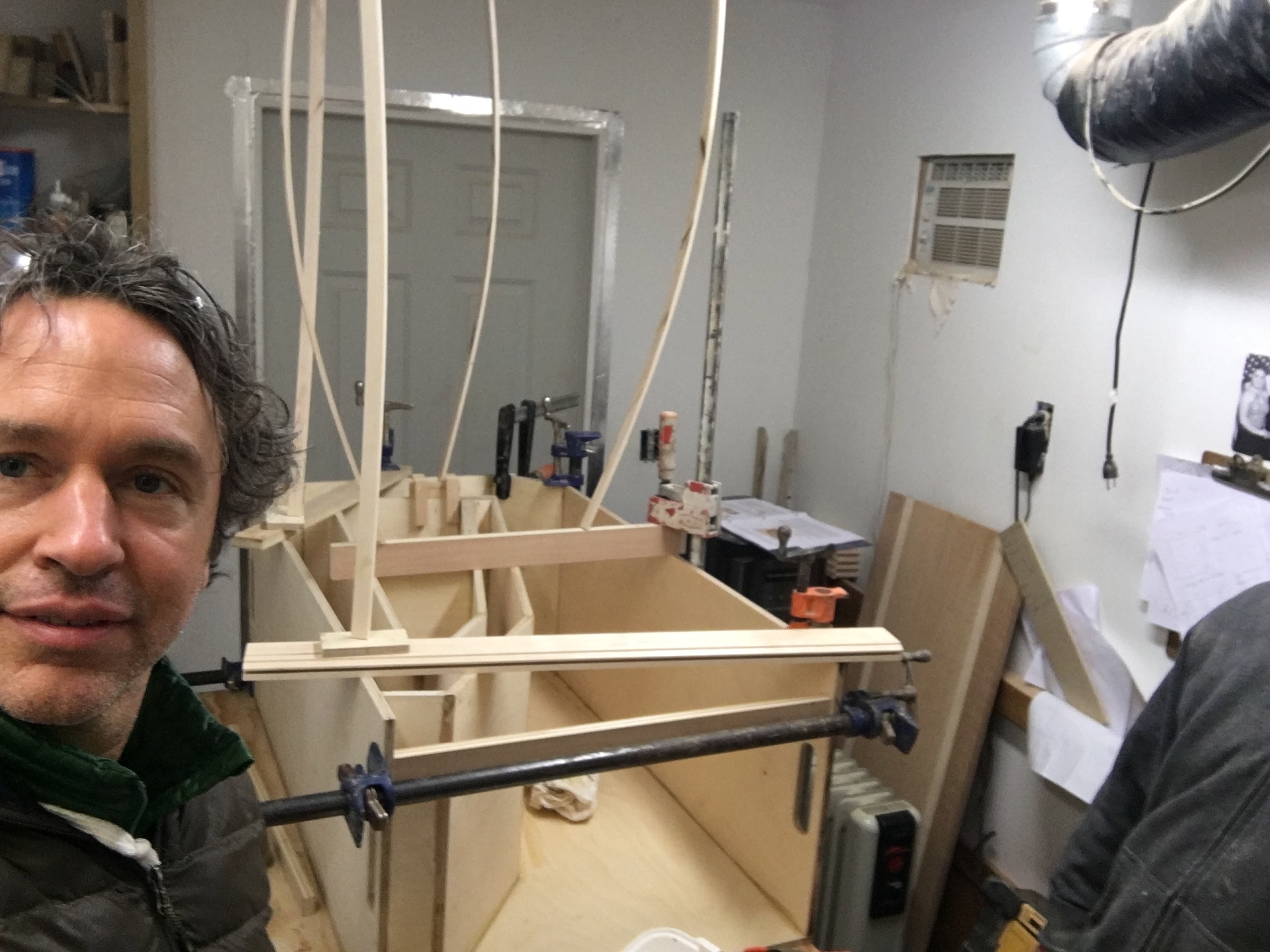

Really awesome to work with Robert Renick on this (photo left). He is a master cabinet builder with decades of experience. From his guitar building experience, he came up with the idea of using go-bars to press the panels down for glue-up, which meant we could do a full glue up in a couple of hours rather than several days.
The pics don't show it very well, but the tolerances and workmanship on these Tubas are really A+
More pics to come!

#6 Post by Pabloaguas »
Seth wrote: Mon Jan 25, 2021 12:51 am Looks like you made a little custom modification. Did you shrink the 45" dimension down an inch or two? Are you just making room for an inset grill frame?
Good eye Seth!
Yes, the back of my compact suv is just 43.5 inches wide, so we did slim them down to 43". We did the modification at the mouth to accommodate.

Pabloaguas wrote: Mon Jan 25, 2021 1:48 am
Good eye Seth!
Smart solution. I like it. I highly doubt it will effect performance any noticeable amount. Clean mod. Well done :thumbsup:

Had to look up go-bars. Never heard of them. Pretty cool, looks like you used giant ones all the way to the ceiling. Found this link with some good info for the unfamiliar:
http://www.pegasusguitars.com/making-go-bars.html
I just use a mad assortment of 10-15 pound dumbells and bar plates... :D

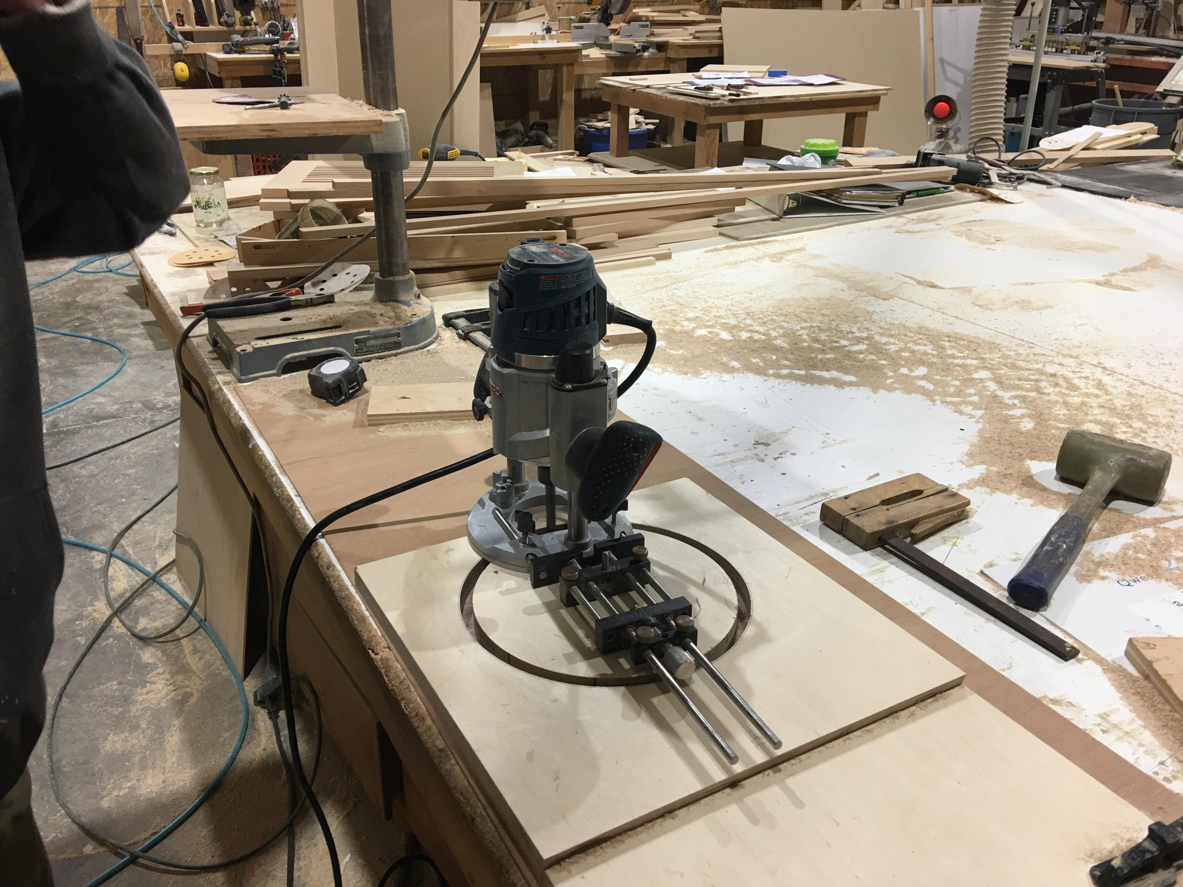

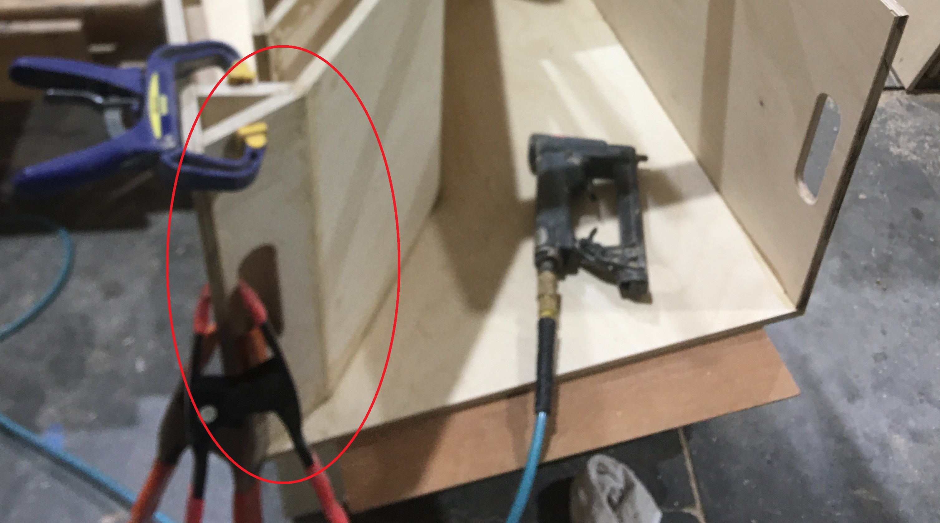

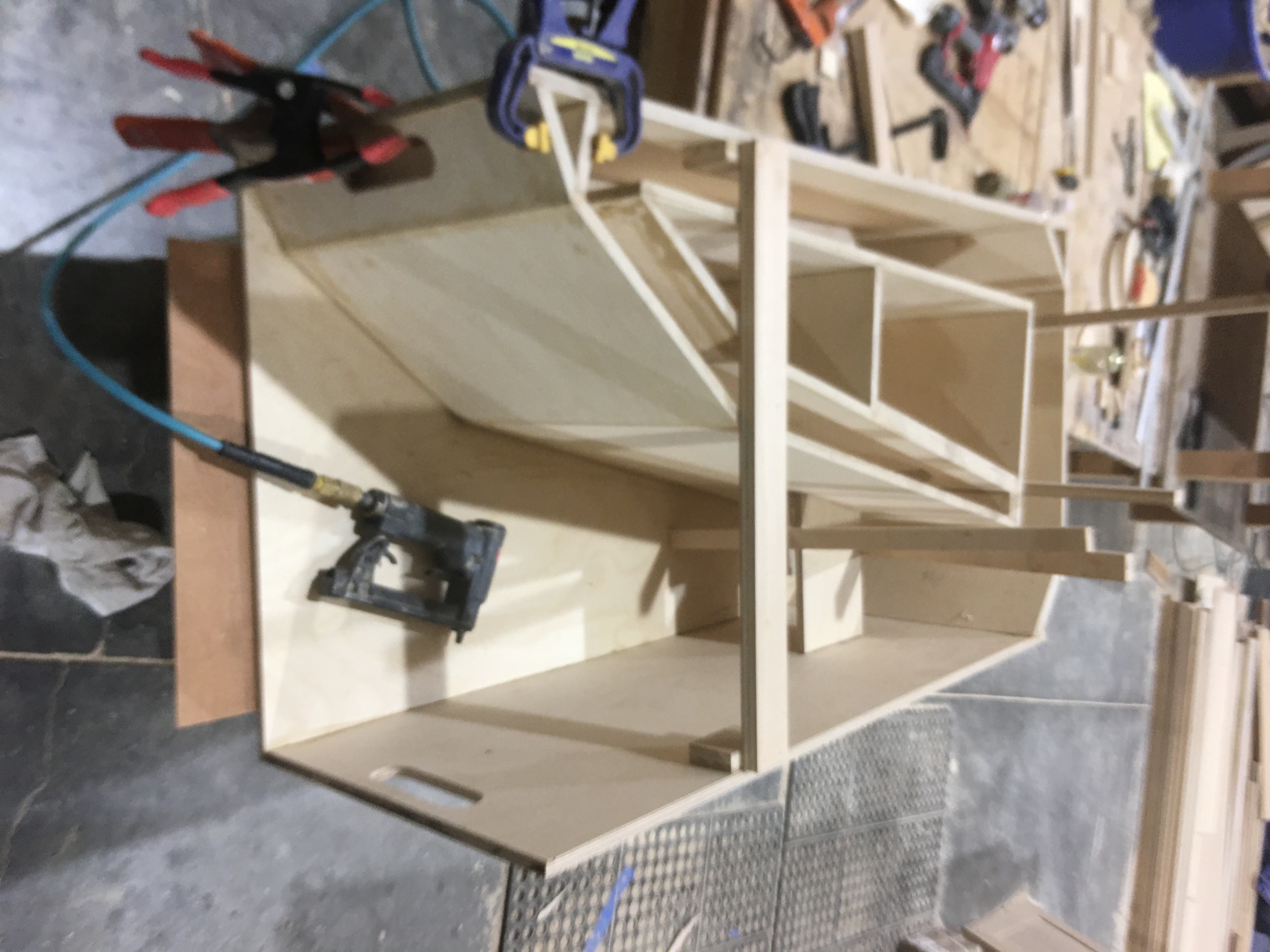

More Pics:

himhimself wrote: Mon Jan 25, 2021 8:37 am http://www.pegasusguitars.com/making-go-bars.html
That's pretty cool. You'd need a really big cube to fit a max sized T48 in, though. :shock:
Gym weight are a hot commodity right now. You could sell them, build some "go bars", then used all the leftover money for new drivers! :lol:
