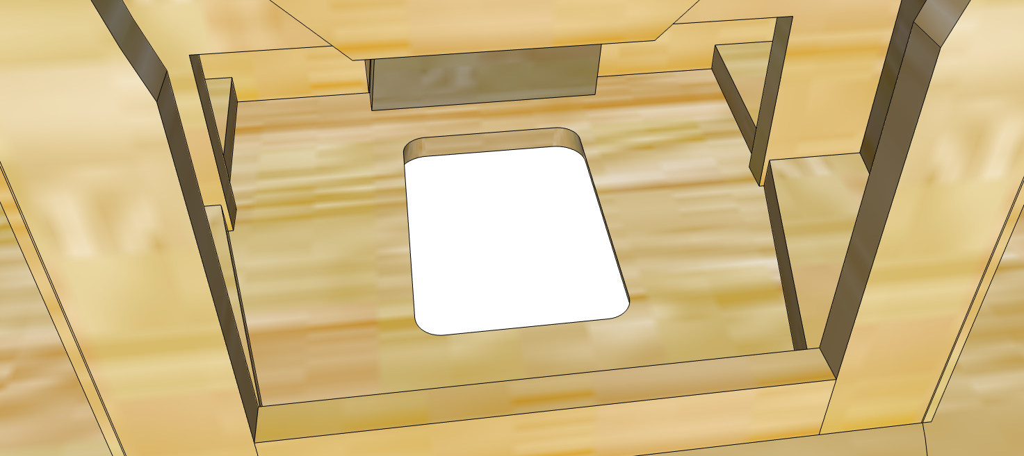

Seth wrote: Tue Jan 05, 2021 12:46 amFortunately, looking at the SketchUp, there's a bit of structure in that area to potentially contribute to the rigidity and stability of the pole mount, so maybe a backer will be enough, perhaps.(?)
Perhaps a plate as big as that floor is inside the woofer compartment may be enough. Hopefully it won't affect the tuning significantly or the port tuning, but, I don't know the answer to that.

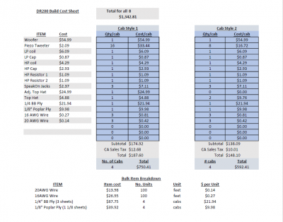

Looks like my estimate was a little shy. Probably closer to $200/cab for this build. Without the adjustable top hats and melded array, the cost comes down closer to $150/cab.
