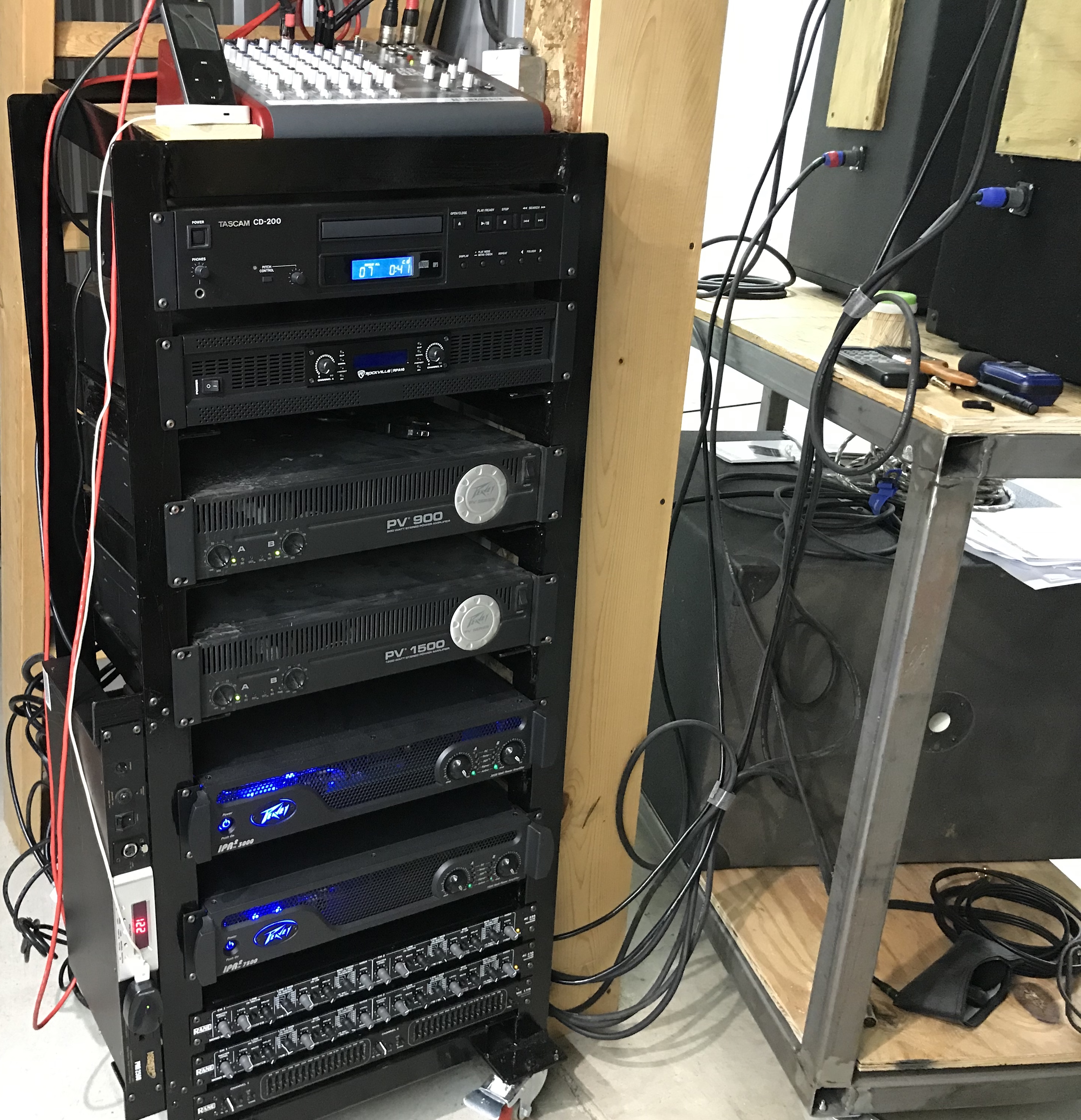

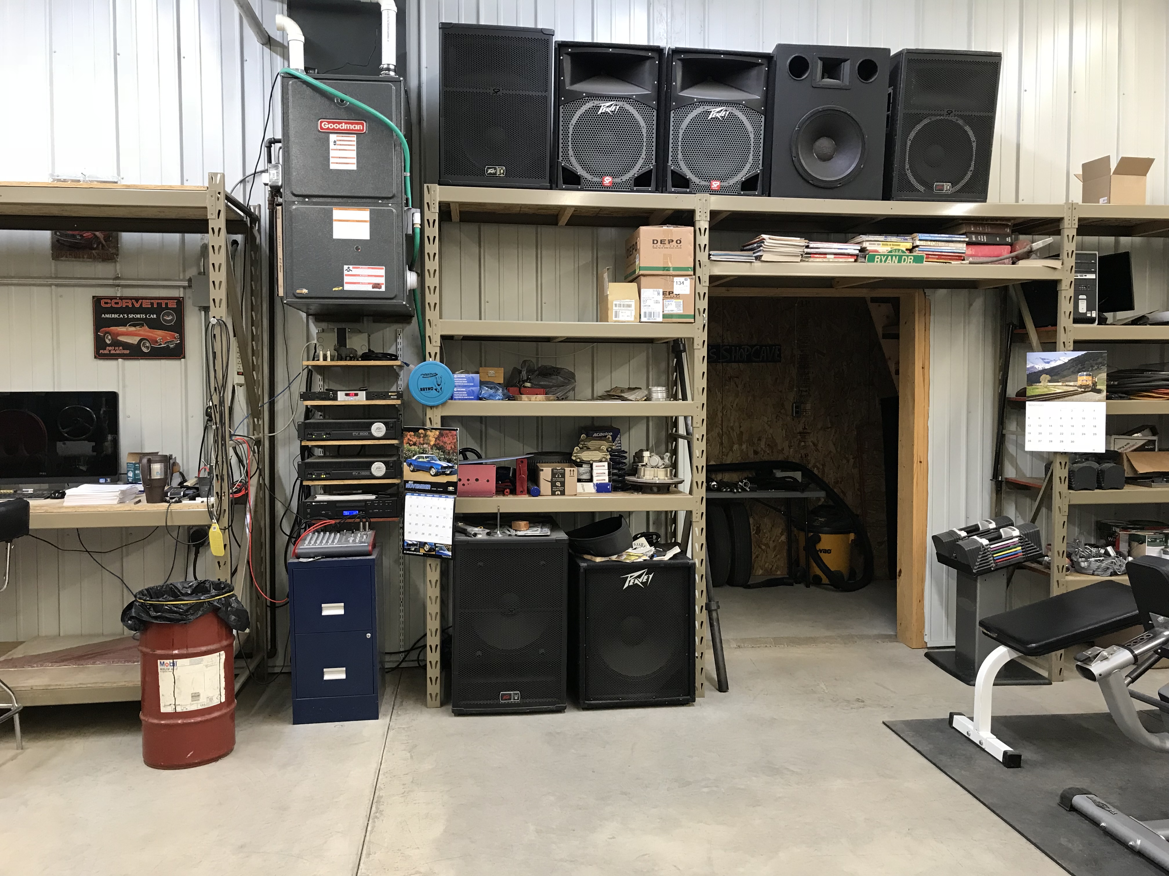

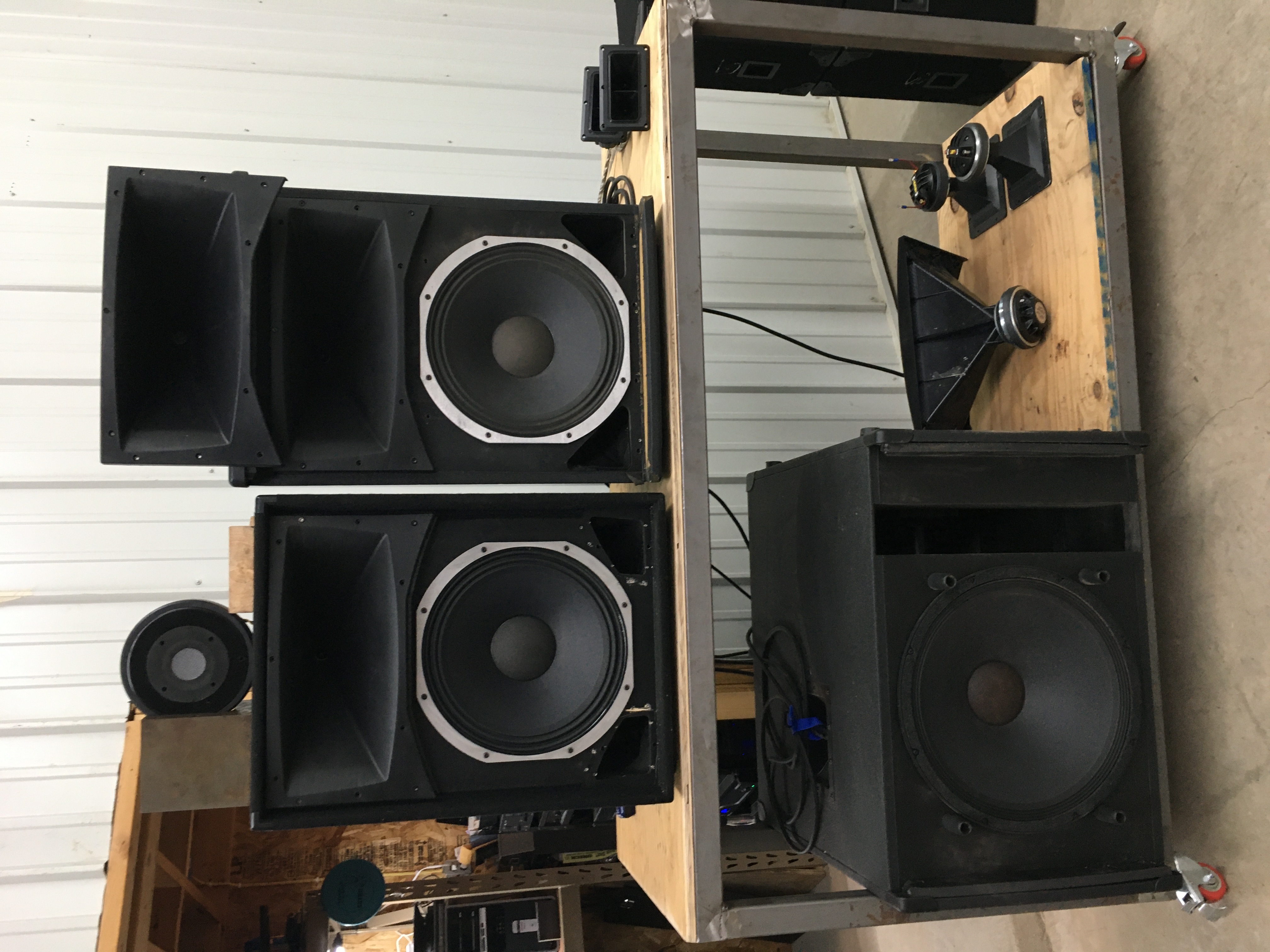

My shop is 40x48x13 tall ceilings and I’m running peavey 900, 1500, (AB)style and newer peavey (D) 7500 and 3000 amps to power my peavey SP5 tops and SP118 sub and my upper voice horns and tweeters all divided by Rane 23s active 4 way split.

You'll have a rockin' shop with some BFM subs in there! You are going to need something to brickwall limit the voltage going to the subs, though. Not an option you can skip. I think someone already mentioned a dbx driverack.
