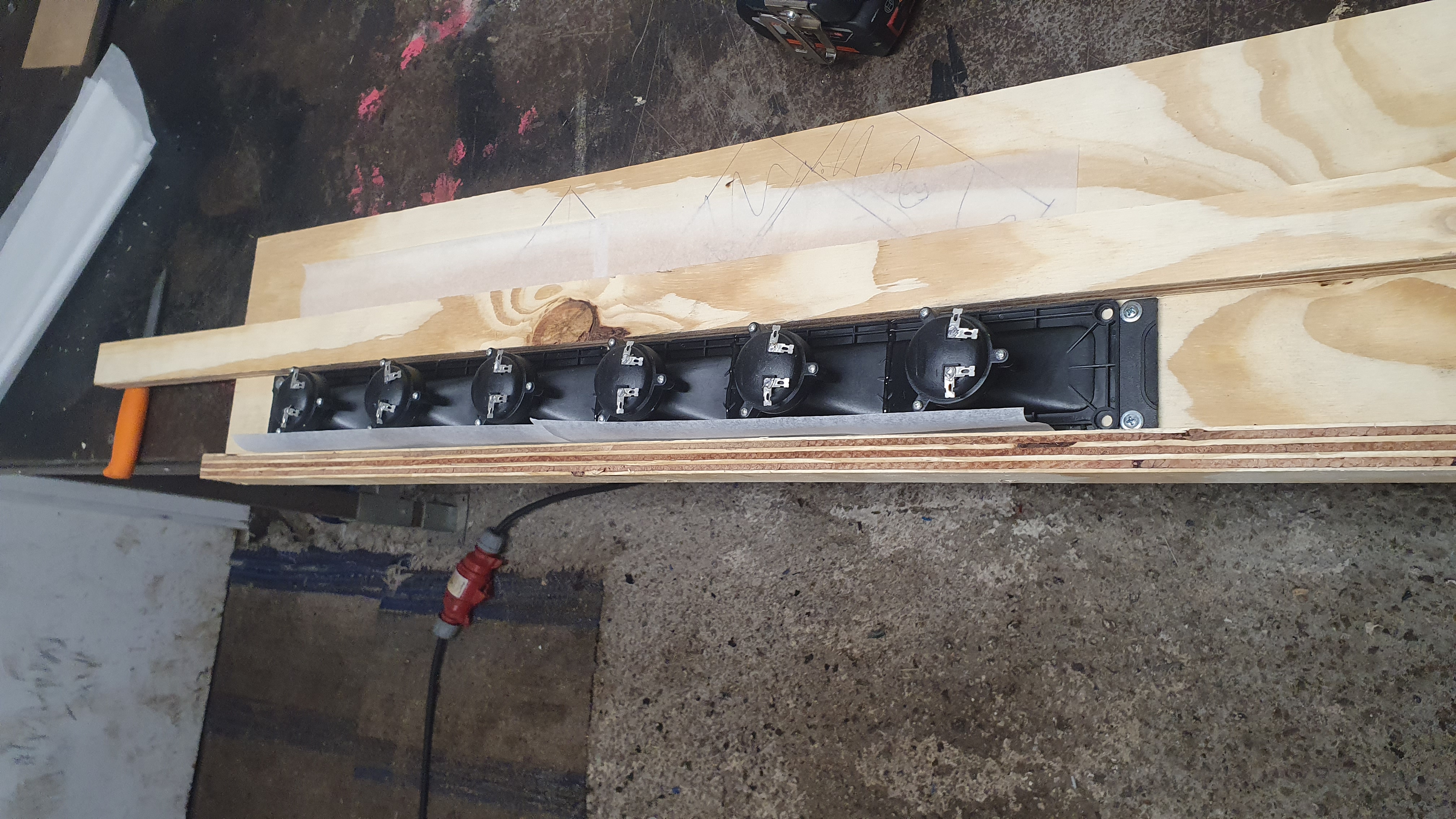

I have finally decided to build a pair of SLA PRO 4x6 with 6 tweeter option after reading and going through build threads here for more than a year :lol:
I intend to use these instead of my 12" tops. Mostly for fun/learn to build, and be able to expand later on in a better way, with small easy cabs that isnt so heavy.
I use this for some private partys now and then, and also scare people that want to hear them in my 40m² garage :D

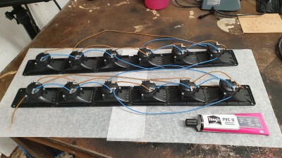

The piezos i ordered is Rila. Just another very cheap copy from the original. 12pc of Monacors would cost me over 150$ if everyone works, so i will try these at first, if they dont sound as i please i will order the Monacors.
I tested the piezos with a 4ohm resistor series with positive signal to the piezo, i only used the ones that was loud, clear and bright, some were weak and tonally darker, didnt use those.
Is that the correct easy way to test them?

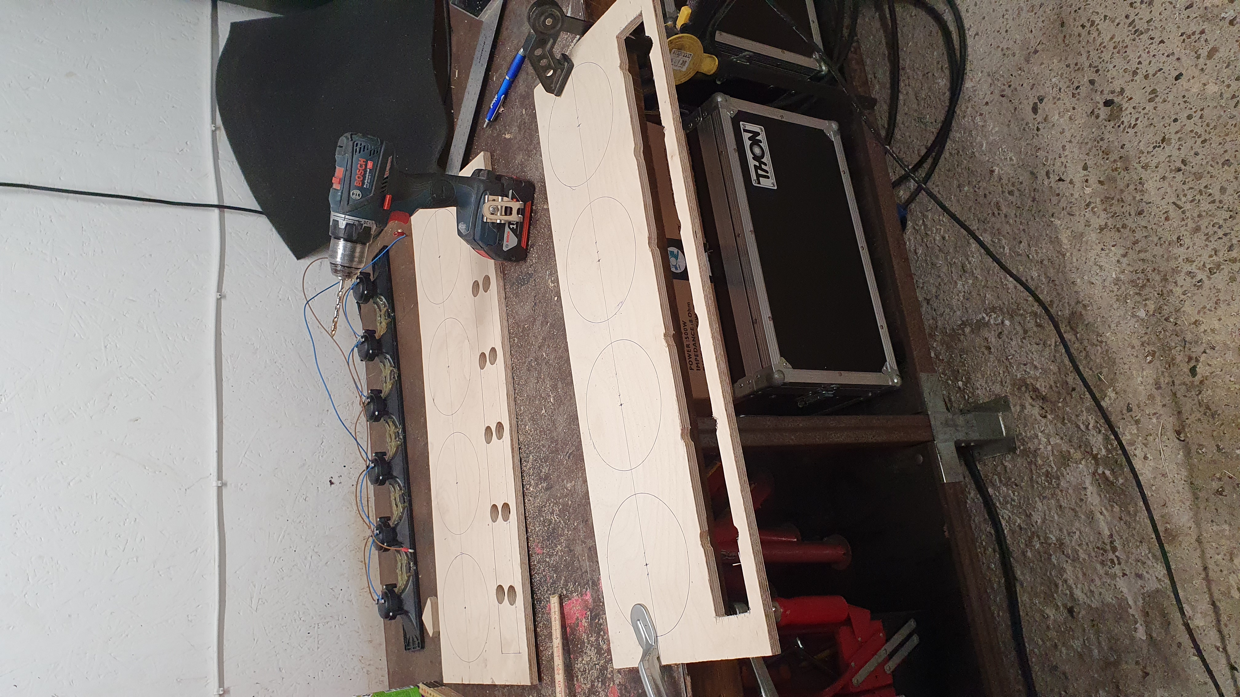

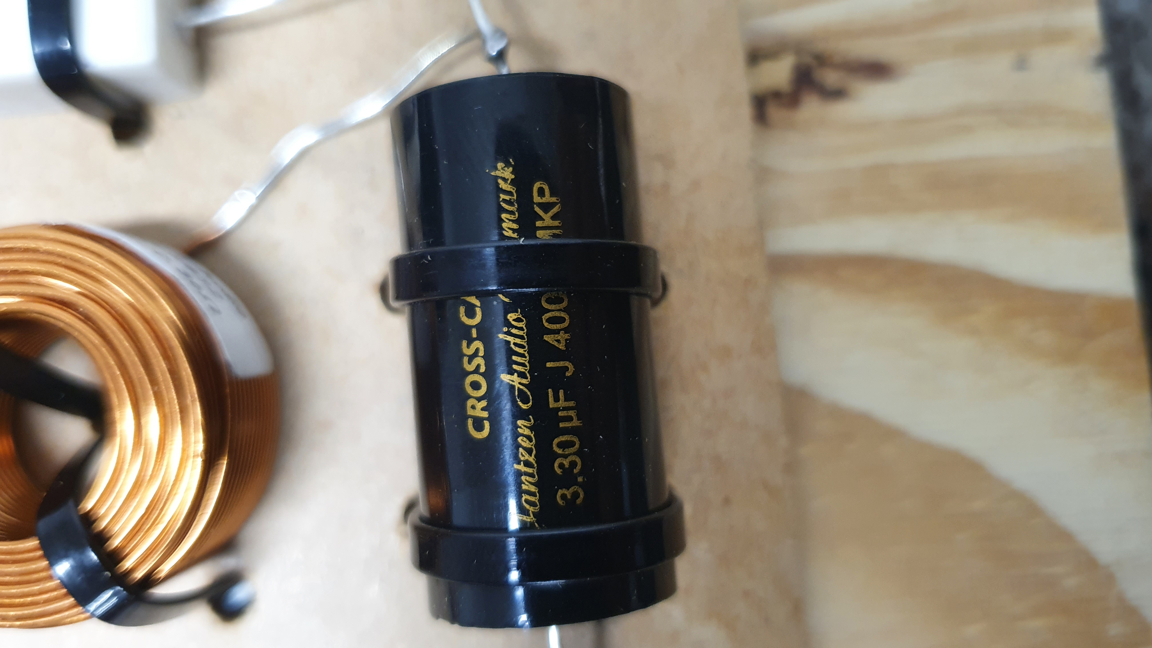

First i made the tweeter array, came out in total like 1/4 inch shorter than it should be according to the plans, but i think that will be ok? I will adjust the baffle cuts to my arrays.

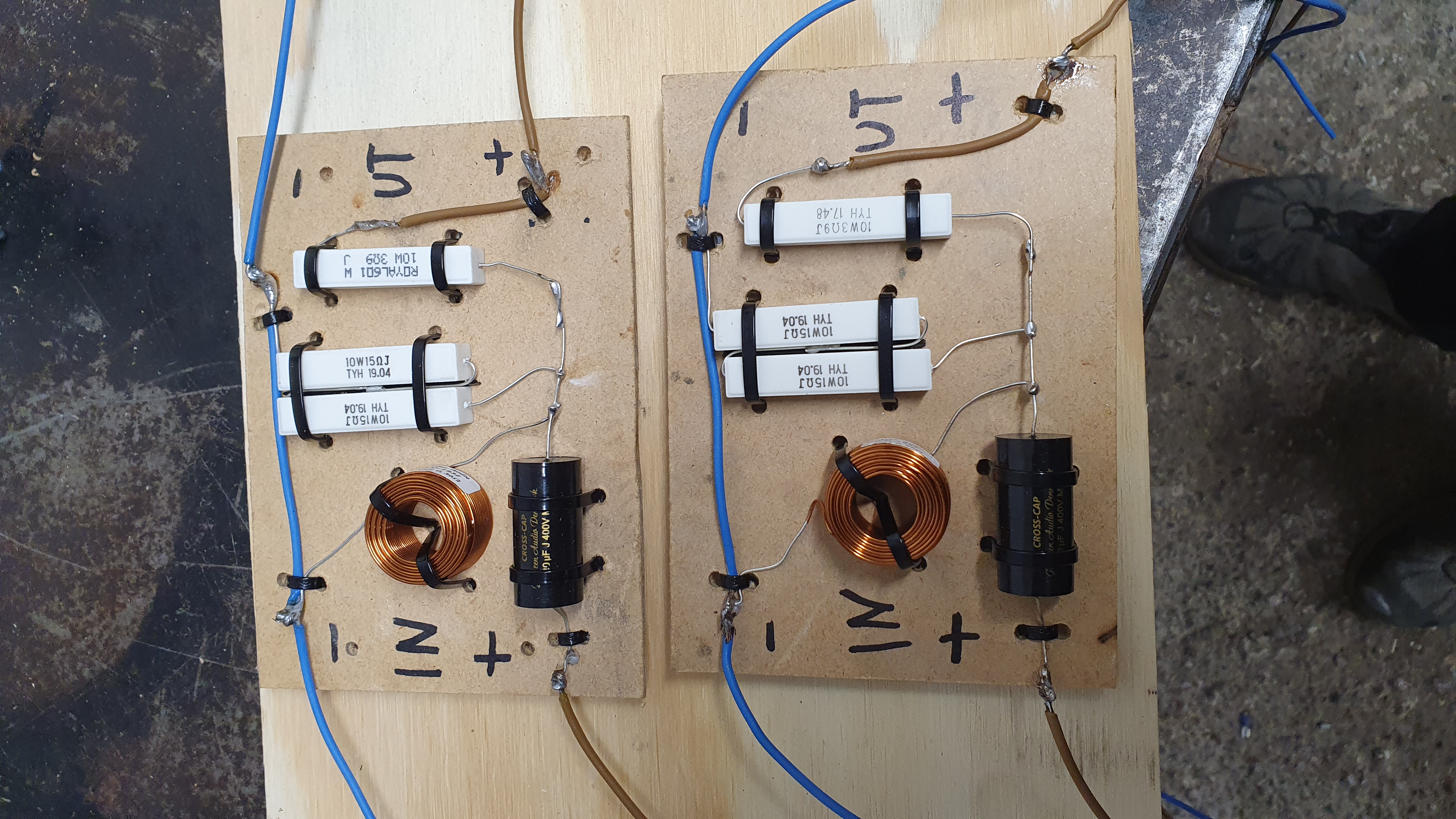

Then i built the crossovers, first time doing that and i am very happy with the result, they also seem to work properly.
Just realized that this post is becoming very long, i actually started the build two weeks ago but got the plywood today!
I will attach some pictures and continue later :D

Looking good so far. Noticed the series resistors to get your 30ohms... clever. Is that a 3ohm or 3.9 in series with the tweeters? I know the plans call far a 4 ohm resistor there. When I was shopping for crossover parts for the 2x6 SLA Pro's I built, the 4 ohm resistors were sold out/out of stock. If I recall correctly, Bill said to get the next size up, which was a 4.1 (I think). I have very little idea what the effect of changing that value would be, but I think it's just there to give the amplifier some resistive load.

Yes, i couldnt get any 30ohm resistors so i went with two 15ohm in series. That is a 3.9ohm resistor, next step up i could find was 4.7ohm, i just guessed that the closest would be best, pretty easy to change later on if i would need a higher resistance, i will screw the crossover inside the cab so i should be able to get it out later.

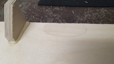

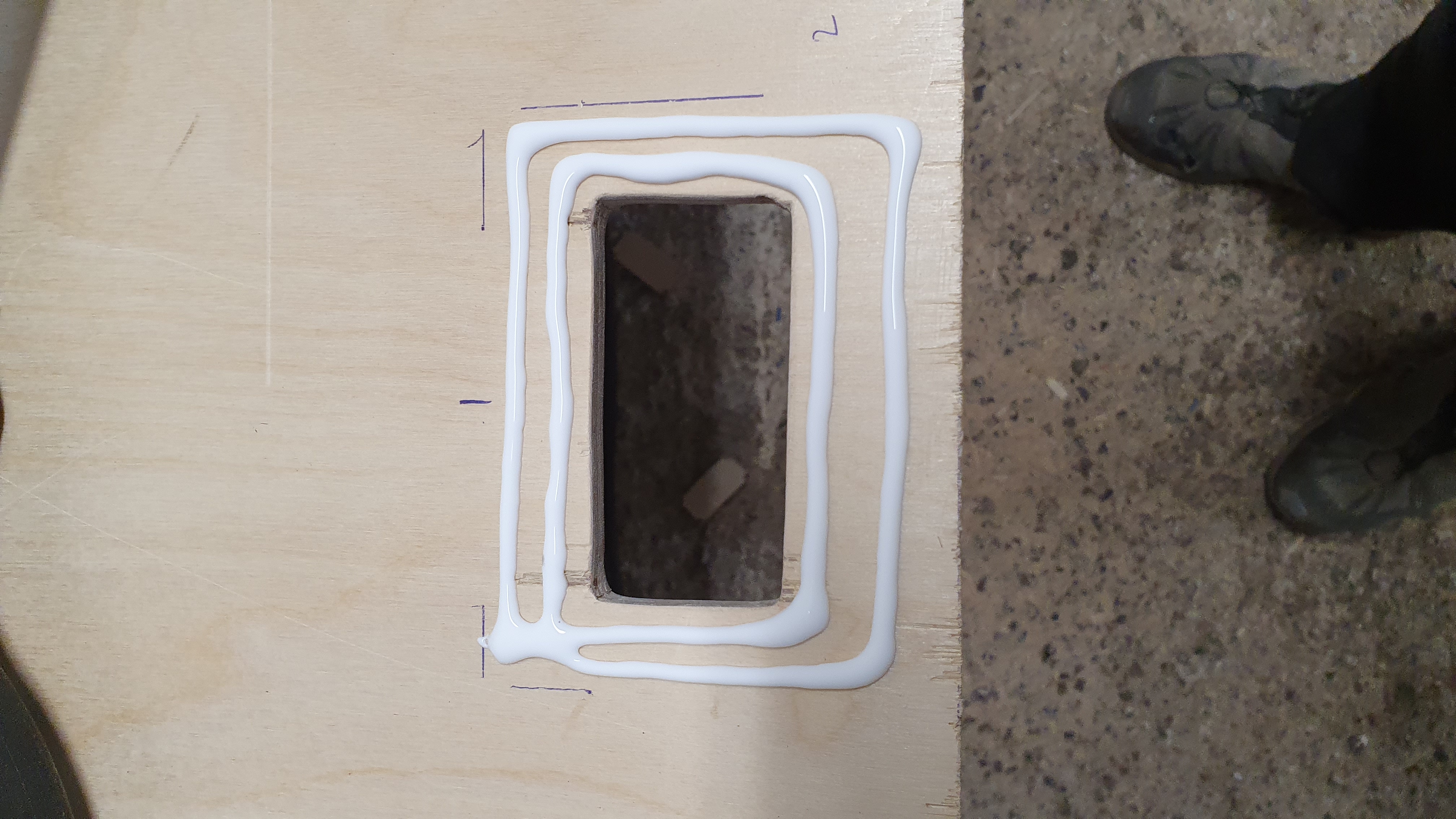

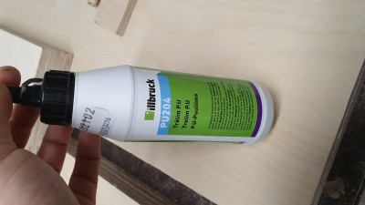

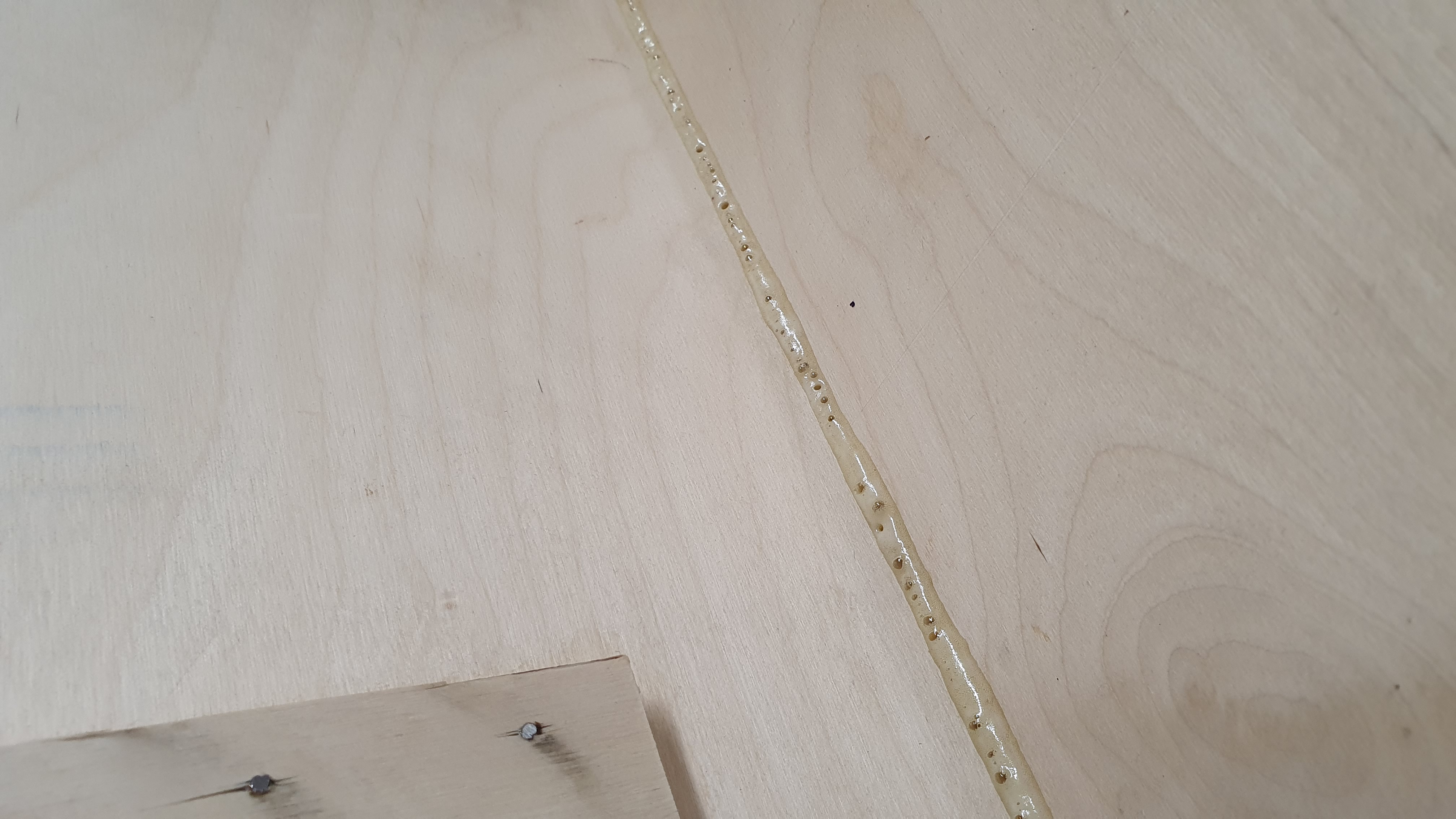

I used standard wood glue only on the jack plate, just to make sure it will look good from the outside, guaranteed airtight! :wink:
For the rest of the cab i use Polyurethane Wood glue, it expands really well and is water/air tight and super strong.
Should that glue/adhesive be OK for a horn loaded cab like DRs or Titans aswell?

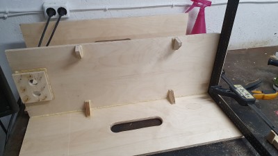

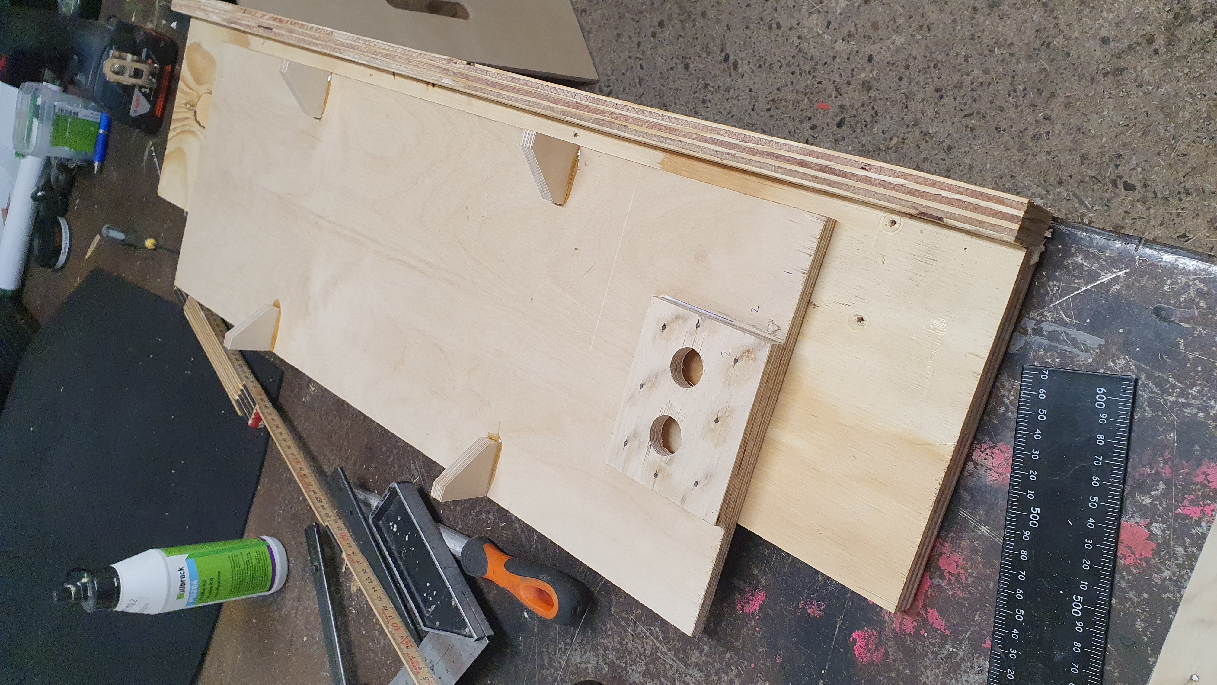

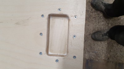

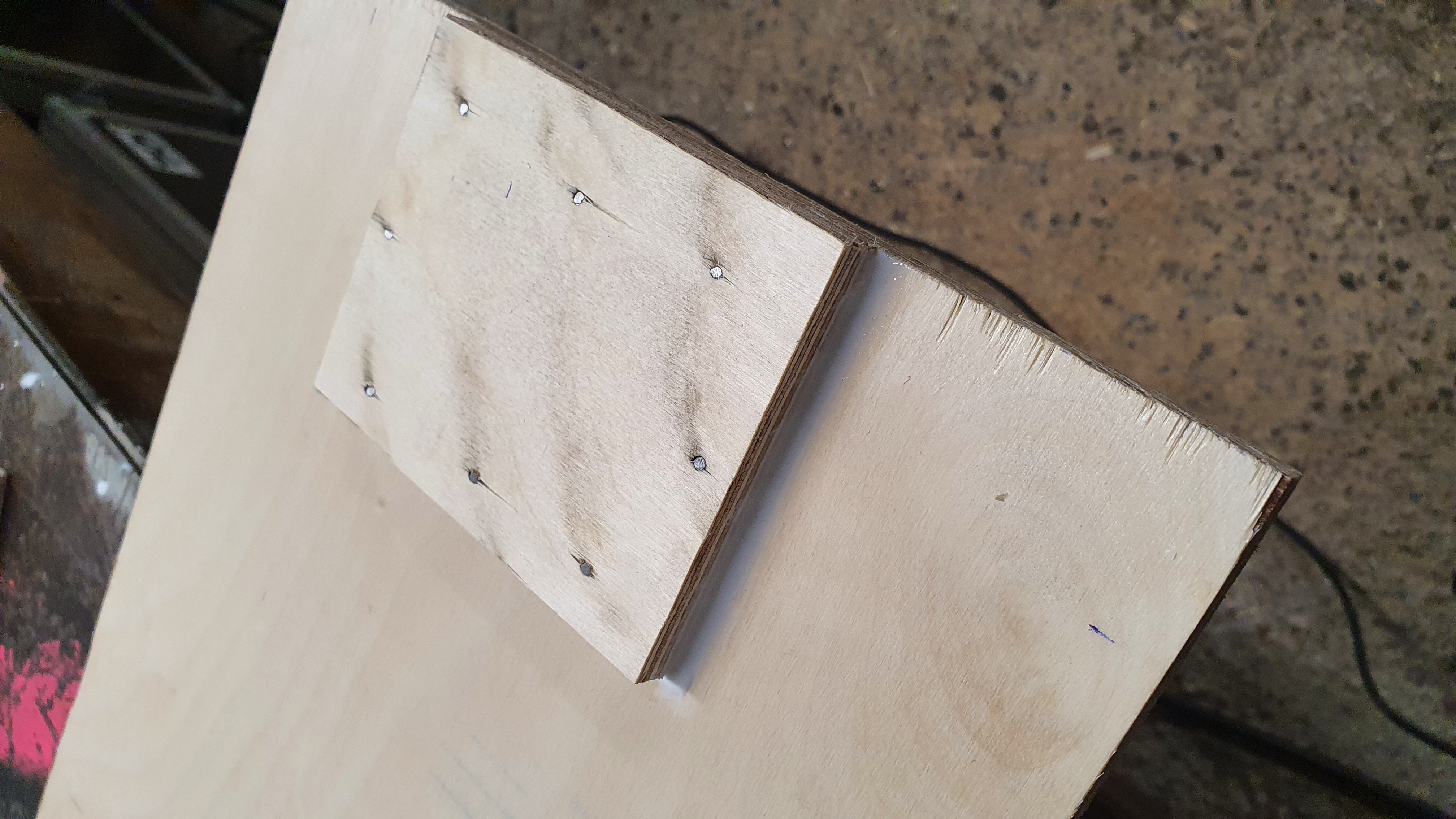

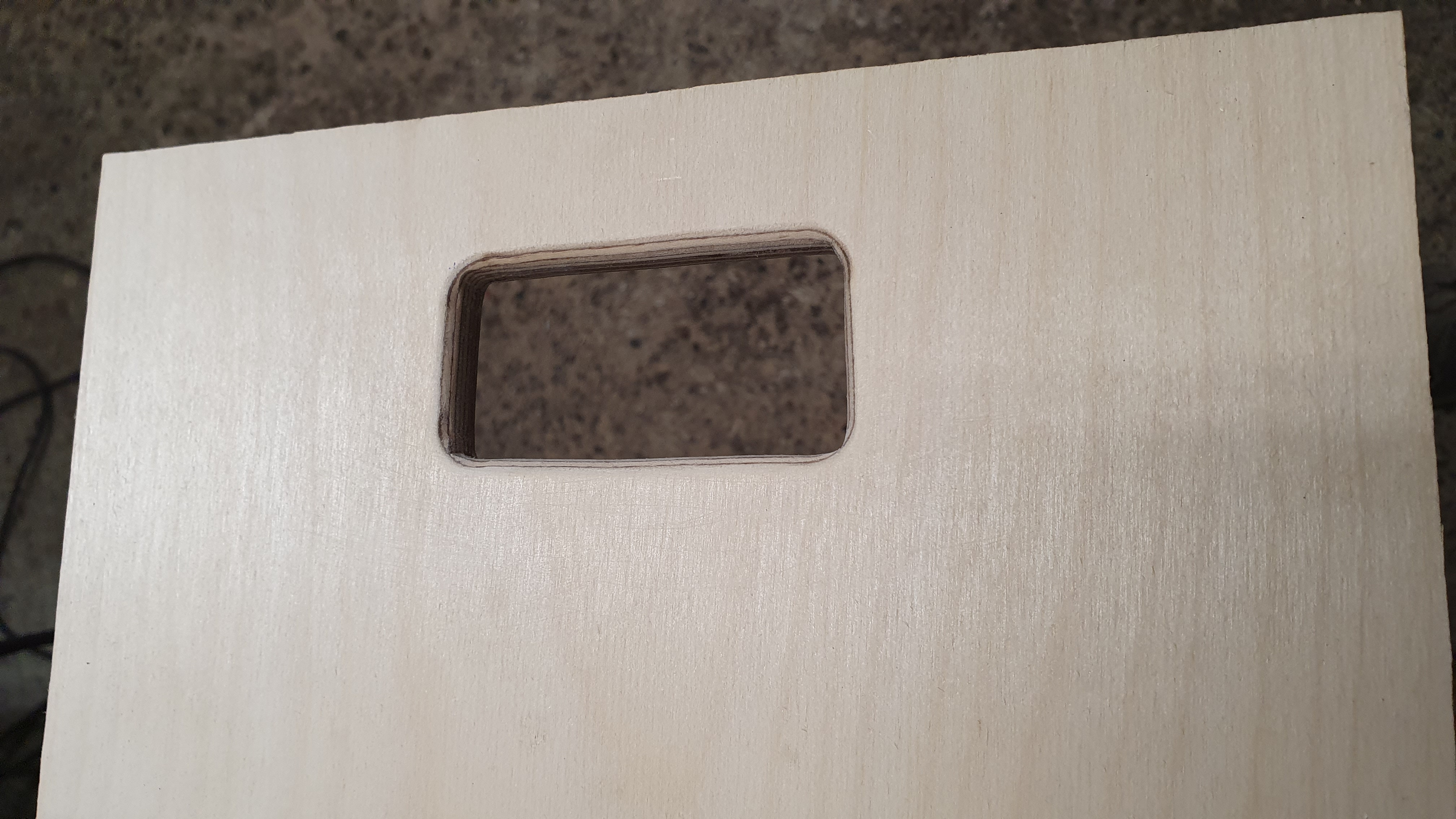

I did a couple of small braces with a perfect 90° angle mounted to align the edge of the back piece only to help me screw the side to the back easier. Any input of these? Are they going to be a problem in any way?
I dont get pics over 3mb attached, please excuse me, i will try to change resolution on my camera :)
SLA PRO 4X6
T60 2x20"
Labgruppen fP6400. fP2400Q. DBX Driverack PA2
TLAH
AT 20"
TRT
Line92
Posts: 48
Joined: Wed Apr 15, 2020 12:54 am
Location: Sweden
Re: First BFM build: SLA PRO 4x6
#4 Post by Line92 »
This is the small braces, and the glue

The glue looks like this when it is cured

The 4 ohm resistor value isn't critical. It's only there to provide a minimum impedance load to the amp at ultra-sonic frequencies, where the piezo impedance goes very low.

Sorry i did a edit before, asking again if Bill or anyone can make a "go or no" on the Polyurethane wood glue for DR horns / Titans / Tubas.
Polyurethane construction adhesive like the PL Premium is not allowed here in Sweden that i could find. Maybe order from elsewere in EU?

#8 Post by Bill Fitzmaurice »
The ooze of your adhesive looks good, so it should be fine. Most urethane glues, like Gorilla, are too thin.

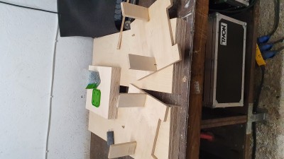

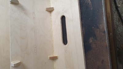

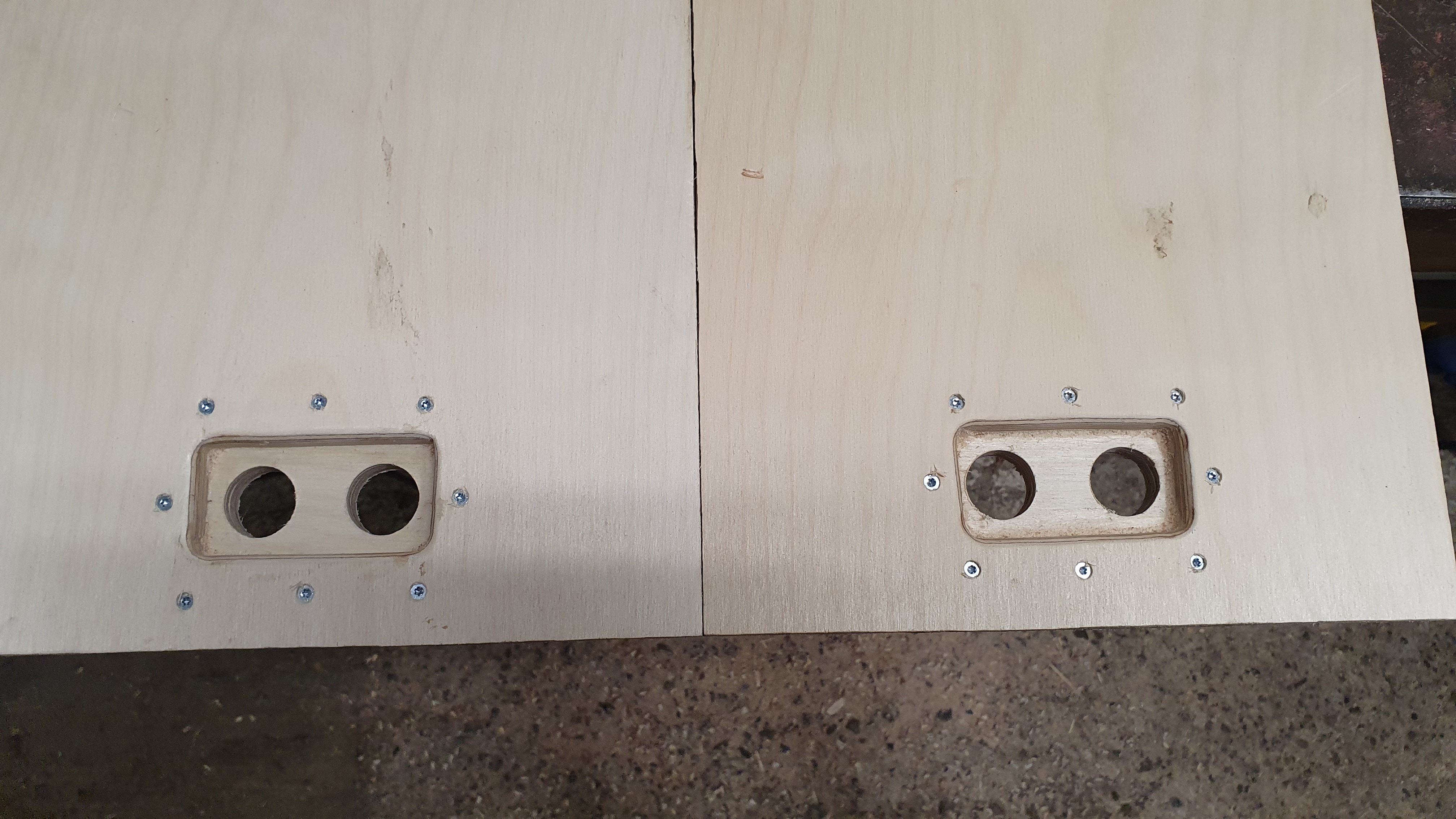

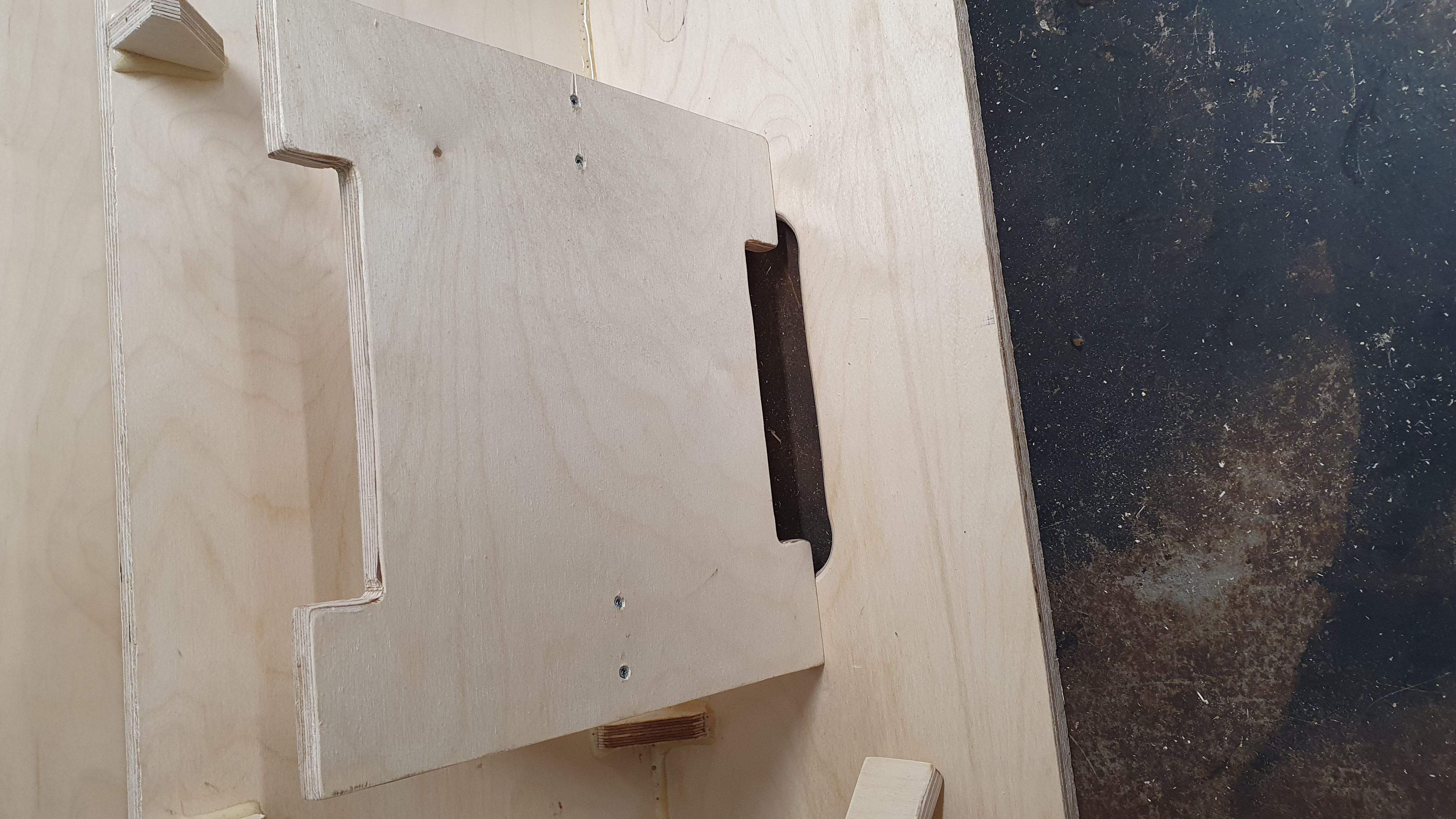

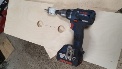

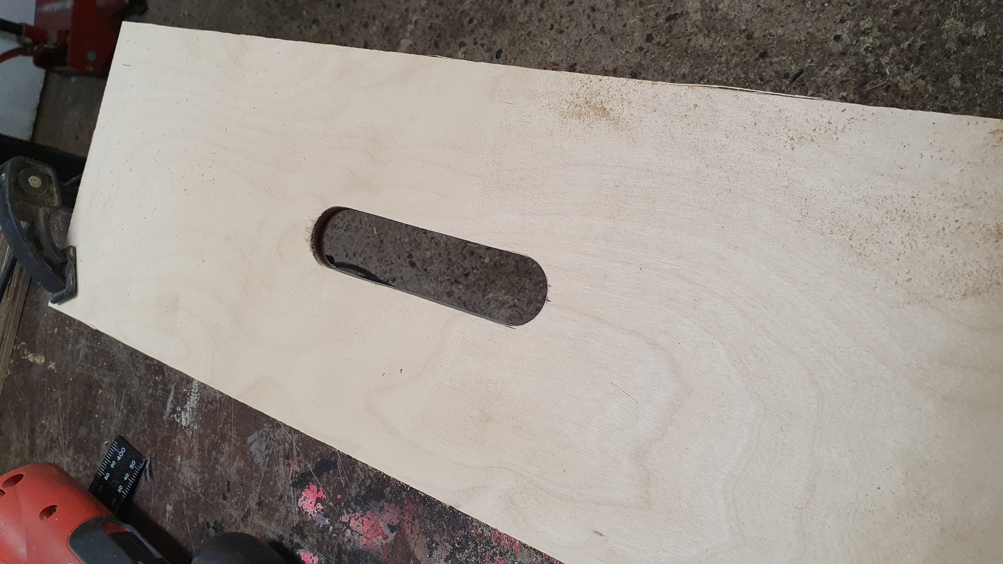

This morning i glued the side to the back on the other cab.

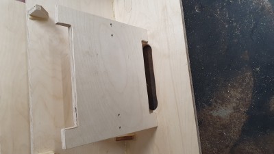

And also found out a mistake, that i have centered the handle/ports on the sides so my main brace covered parts of the handle :(
Quick fix tho, i hope the brace is still enough, should be? :fingers:

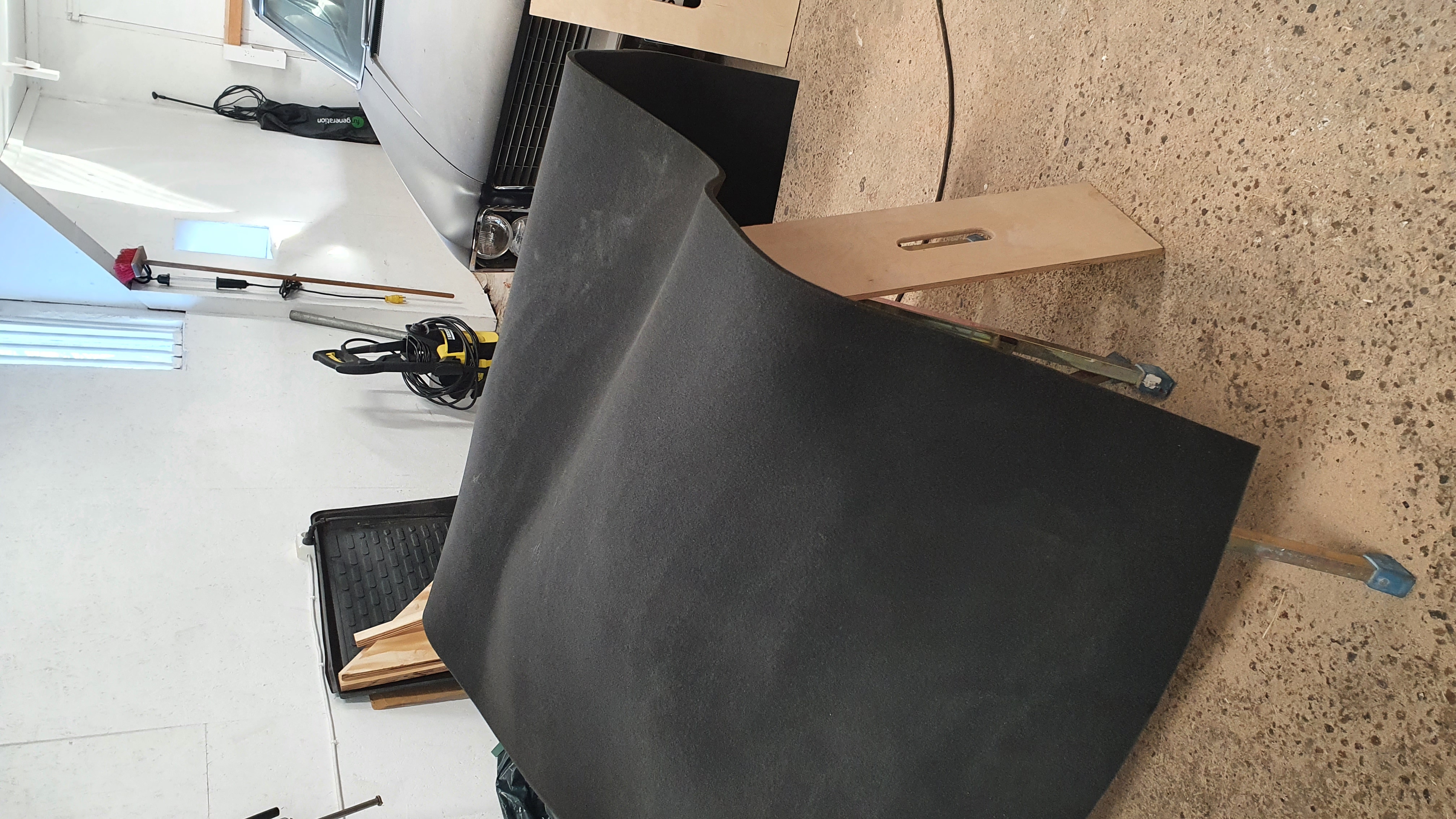

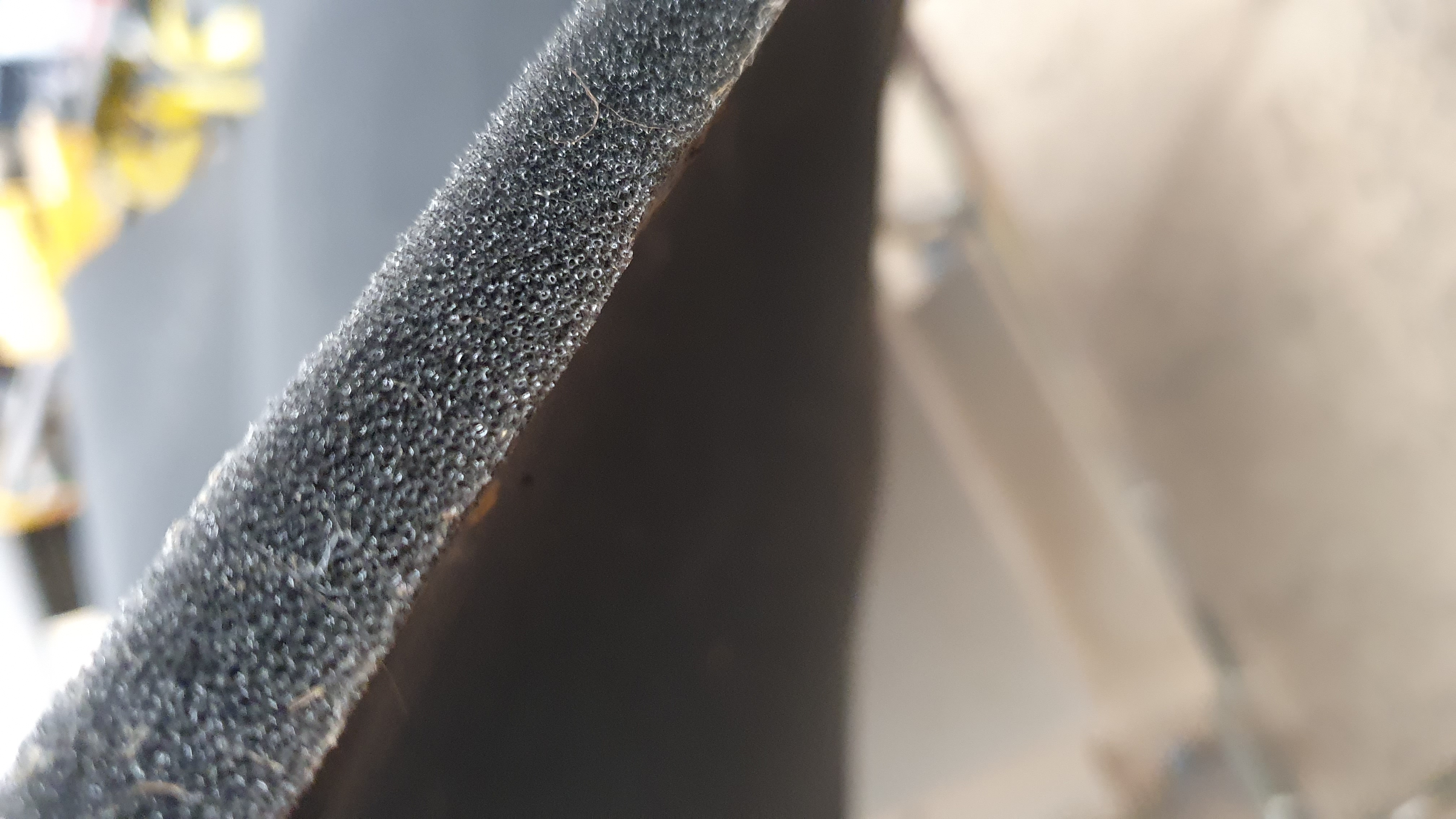

AHA! :hyper: I found out that i had alot of this 1/2 inch foam stuff for speaker grille or something. Will this do a good job as damping material? :fingers:

That foam is good.
Posts: 8597
#12 Post by Bruce Weldy »
Line92 wrote: Sun Nov 22, 2020 3:29 am
I almost did the same thing.....already had it marked and ready to cut when I realized that my actual measurements weren't the same as the plans - I thought the plans had a typo until I started figuring where the brace goes.
It's easy to assume the hole would be centered....

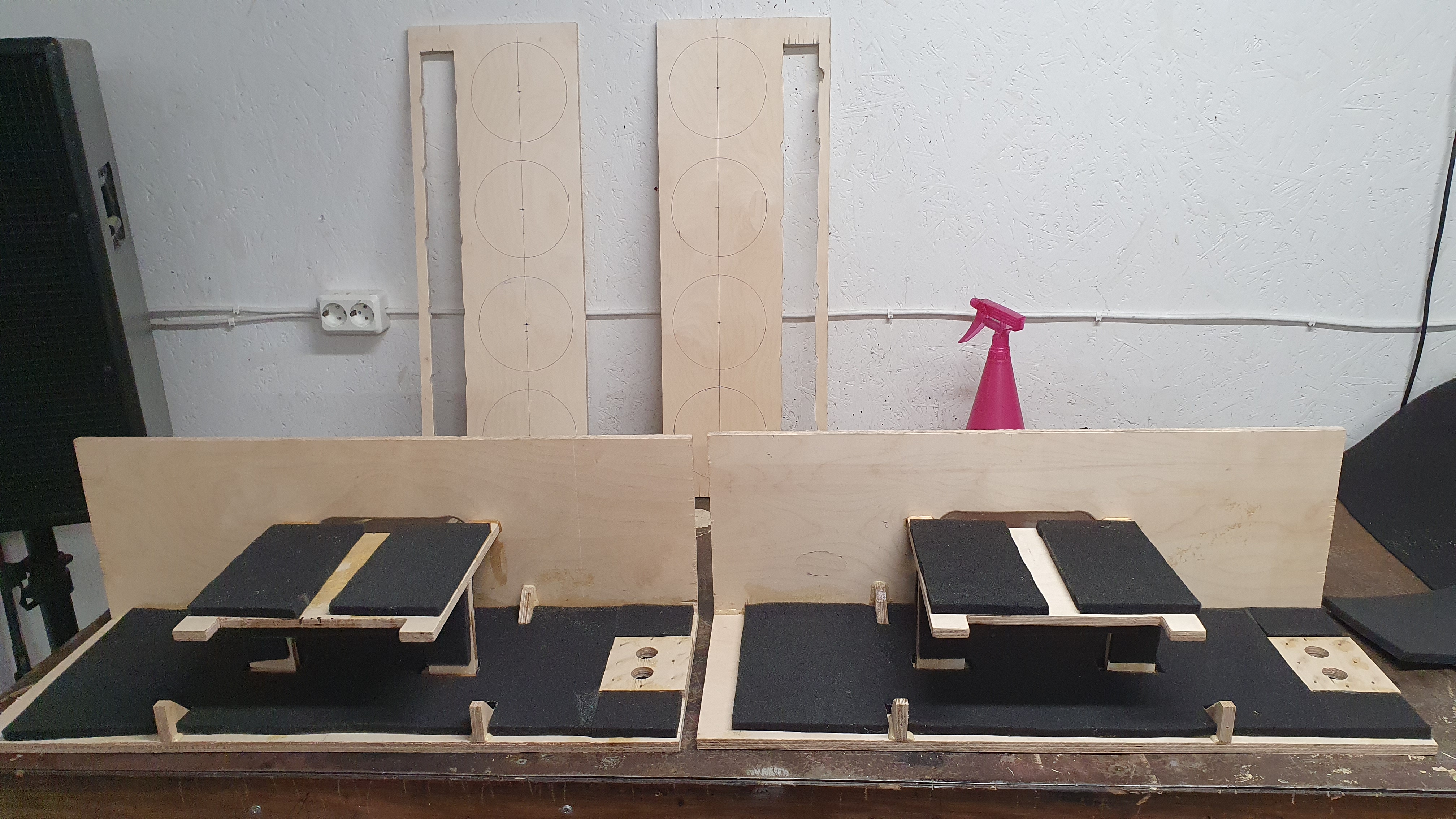

Some progress made during the day
