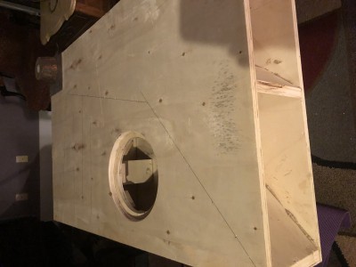

Thanks Seth. And a pic for you Bruce, oh ye of little faith... :D

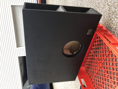

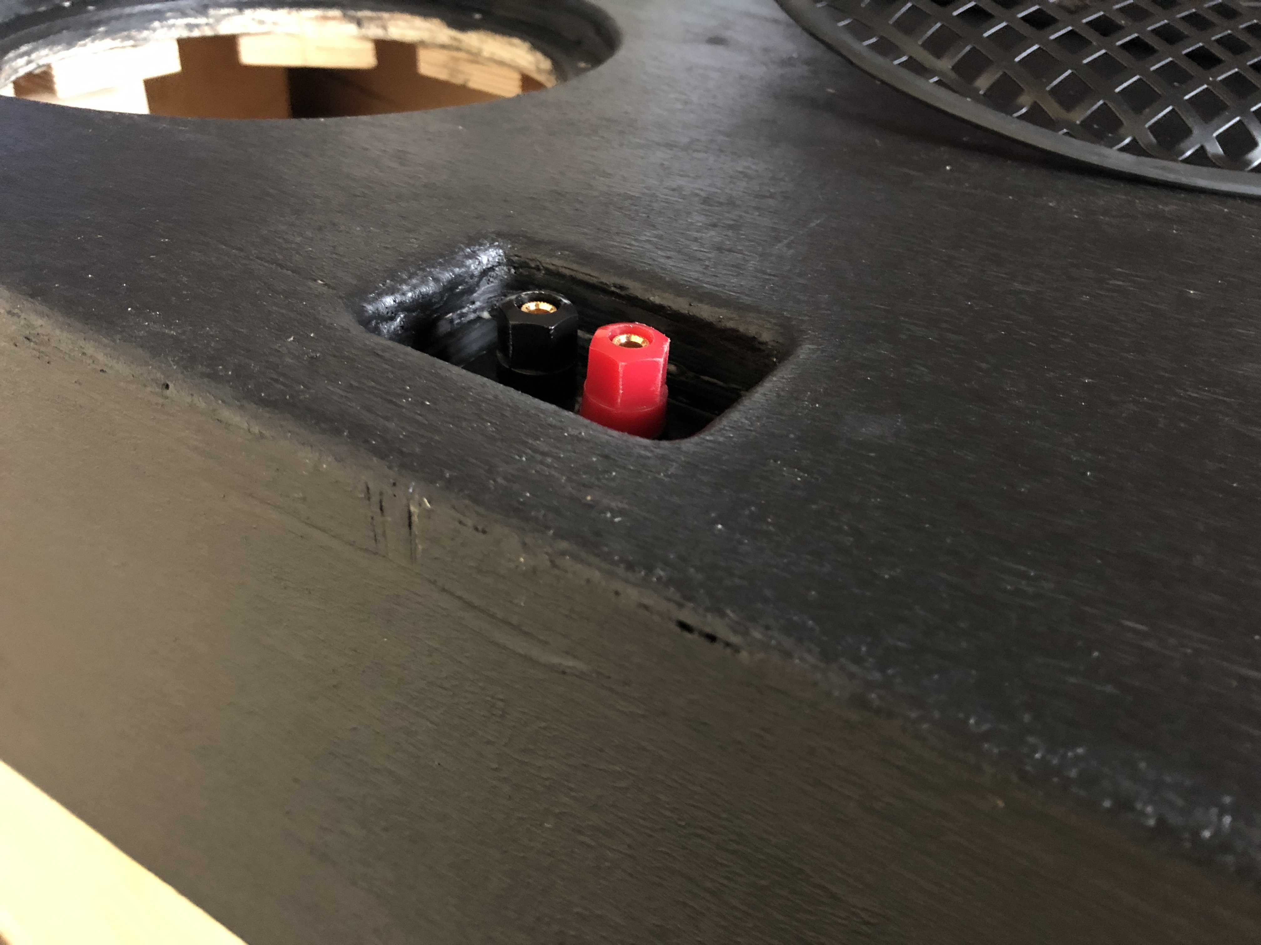

#8 Post by himhimself »
Rounded over the edges, cut a jack recess, quick sand, latex black, and applied duratex. Don’t think I’ll do much more finishing since it will ultimately be buried in the back of the excursion...which is still in the shop. Oh well, still need to pick out a head unit and sub amp anyway and get some binding posts. Maybe next weekend...

#9 Post by Tom Smit »
himhimself wrote: Sat Oct 03, 2020 12:53 pm Rounded over the edges, cut a jack recess, quick sand, latex black, and applied duratex. Don’t think I’ll do much more finishing since it will ultimately be buried in the back of the excursion...which is still in the shop. Oh well, still need to pick out a head unit and sub amp anyway and get some binding posts. Maybe next weekend...
Isn't that weird?! The photo is sideways here (for me), and yet, if I right-click and "open in new tab" the photo is in the correct orientation.
Looking good, that cab!

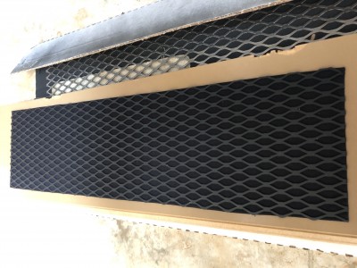

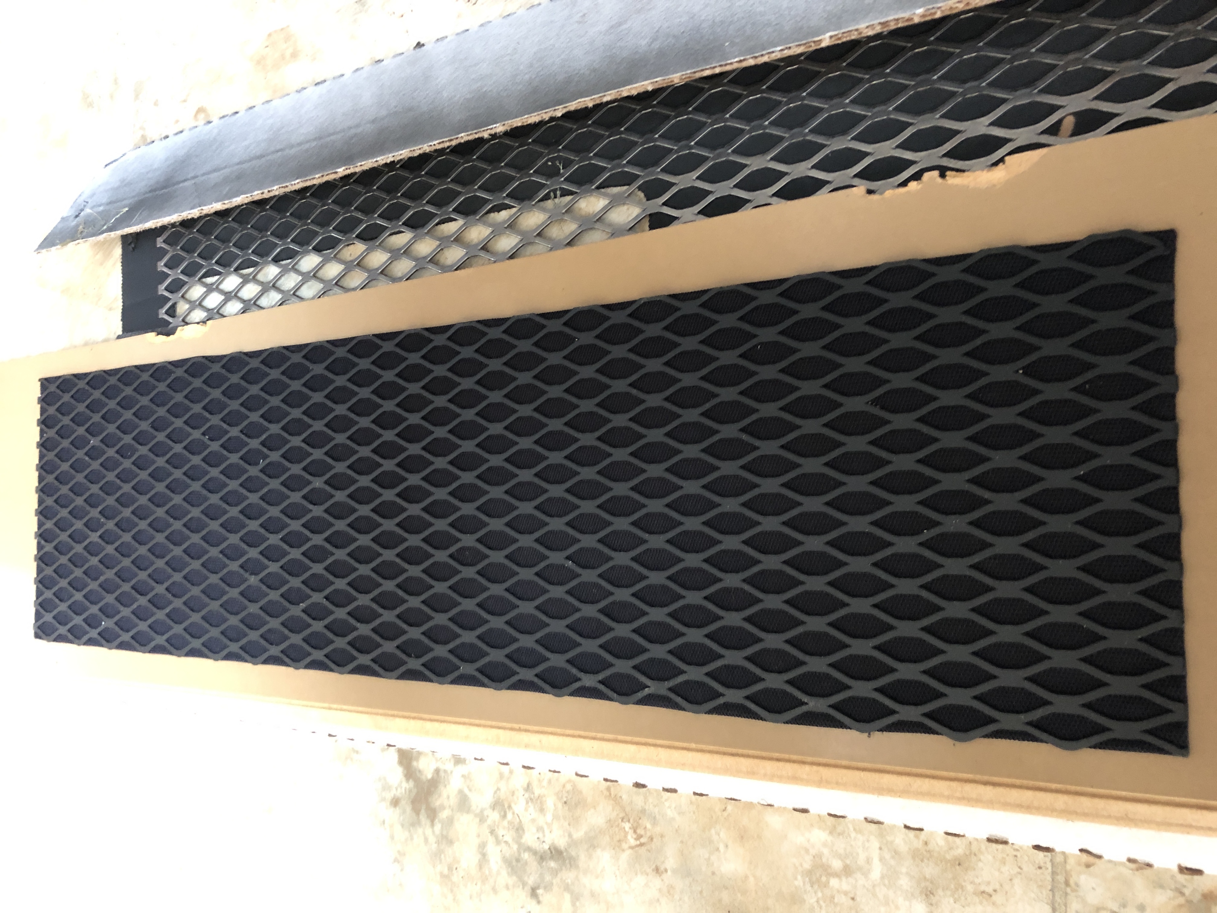

Baby steps. Got the recessed plate with banana jack glued in and made a grill for the mouth with some expanded metal and grill cloth glued to the back side. Still not ready with the stereo for the truck so may give to a friend to try out and get his feedback comparing it to his direct radiator sub...

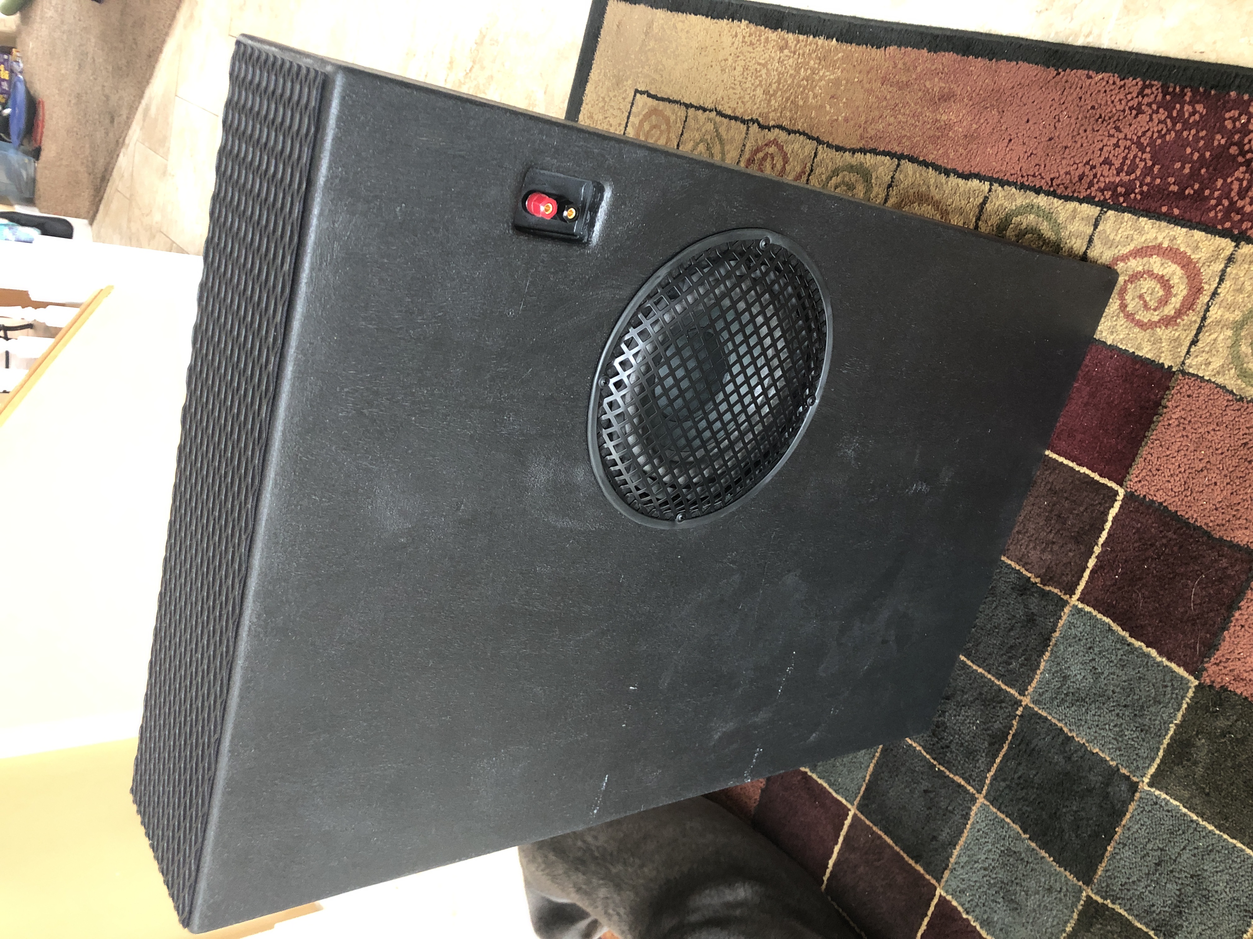

Almost there...

It's looking really good :thumbsup: Absolutely stick it in your buddies vehicle for a test!
What adhesive did you use to glue the cloth to the grill? Yours came out way nicer than the results I achieved.

#13 Post by himhimself »
Thanks, Seth. I just used some Loctite general purpose spray adhesive that was leftover from one of the kid's school projects, I think. I cut the cloth a bit bigger than the grill and pinned it with just a little tension to a piece of cardboard. Then I sprayed the grill and placed it on the cloth. After it dried, I used some long strips of cardboard to mask off the cloth so I could spray about a 1.5" line directly on the back side along the edges, let it get tacky, and then folded it over on itself to give it a finished edge and hopefully a little more thickness to prevent rattles. Also, before put screws through it, I soaked the cloth at the attachment spots with cheap superglue to keep the fabric from doing stupid stuff when the screws went in. Worked pretty well.

himhimself wrote: Sat Oct 10, 2020 2:50 pm Thanks, Seth. I just used some Loctite general purpose spray adhesive that was leftover from one of the kid's school projects, I think. I cut the cloth a bit bigger than the grill and pinned it with just a little tension to a piece of cardboard. Then I sprayed the grill and placed it on the cloth. After it dried, I used some long strips of cardboard to mask off the cloth so I could spray about a 1.5" line directly on the back side along the edges, let it get tacky, and then folded it over on itself to give it a finished edge and hopefully a little more thickness to prevent rattles. Also, before put screws through it, I soaked the cloth at the attachment spots with cheap superglue to keep the fabric from doing stupid stuff when the screws went in. Worked pretty well.
Hmm... maybe I should try a different grade spray glue. Not sure what I have, but it comes out more like a spiderweb than an aerosol spray. When I sprayed the metal I wanted to stick the foam (in my case) to, it was ugly. Ended up having to put the foam in front of the metal grill to hide the mess.

#15 Post by himhimself »
Maybe it's the nozzle. Try pulling it off and soaking in paint thinner or mineral spirits and see if that helps. Any of the spray adhesives should spray fairly light and even.
