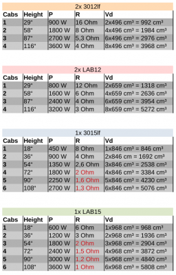

I'm sorry Bill, I think that my first post could give the impression that I want the most bang per buck because I wrote the prices for the Faitals here in europe.Bill Fitzmaurice wrote: ↑Tue Sep 22, 2020 3:41 pm [...]It's more practical with neo 12s, but if size isn't a problem you get more bang per buck with fifteens.
But that isn't the case.
I'm looking for the most efficient solution for getting most output (displacement) per volts (or watts). And all your charts show that a double 12" cab always outperform a single 15" with the 2,83 V.
For the most displacement per stacked cab height with the narrow width for 2x12 and 1x15 I get the following chart: From this point of view you're right Bill that we will get more output with a fifteen and the ranking will be
1.) 1x Lab15
2.) 2x Lab12
3.) 1x 3015lf
4.) 2x 3012lf
I hope you can help me with my decision.
I think for a double twelve Lab the narrow width need one reducer so the narrow panel width would be 28,5" and the external width would be 29,5" because we need a reducer every 14" for one Lab12.SethRocksYou wrote: ↑Tue Sep 22, 2020 5:30 pm The minimum width for twelves is 15 inches external, using 14 inch wide panels. So, 28" panel width, 29" external cab shouldn't need reducers. That's the narrow option. The next size up would be a 30.5" external, 29.5" panel cab. That width and above should require 4 reducers.
For the next size up you descriped you will need only 3 reducers because with 4 reducers and the panel width of 29.5" you wrote, the driver wouldn't see 14".
If we will build a double Lab12 even wider (so we will need 4 reducers) we have to build a cab with a panel width 30" and wider.
Maybe I am wrong and it's to early for math

Ok, I think you need to tidy up a few things in your calculations.
For example the 2 x Faital pro 12 @ 4 ohms in series that "takes" 1000W/driver.
If it really could do that, you would need an amp capable of 4050W just to get there. Is that realistic? Not really.
You can also chop out all the loads that are less than 2 ohms overall on cab count because:
You don't want to run amps at their lowest rated value for any length of time.
Even with a 2 ohm load capable amp, there will be a portion of the band pass that is less than 2 ohms with regards to the cabs.
You would manipulate series and parallel wiring to end up with higher overall loads per channel to maximise cab counts per amp instead.
I can tell you this. If you're looking for the most output per cab possible, you're probably not looking to build as many cabs as you will ultimately need.
If you're hitting the limiter with the cabs you have, you need to build more.
And when you go down that route, you need to double cab count to add +6dB...

I know that the 4 Ohm version in series in one cab will need a lot of amp power. But this isn't unrealistic if you will have a look to the new Powersoft X4L which should deliver over 4 kW @ 8 Ohm.
But you are right with the question "is it worth all the background to power up this version of driver wiring reasonable."
I know that we shouldn't push an amp with 2 ohm loads. This should be plain I would say.
But I read an answer of Bill to the question "how to calculate the max voltage for a Ciare SW12.00SW":
And if the voltage limit for the Faitals are lower than the 1000 W @ 4 Ohm or 16 Ohm than the amp power shouldn't be a problem I would say.
If I understand how to calculate the voltage limits in relationship to the Xmax than there are so many interesting drivers (especially 15 inches drivers) which have a very high power rating on paper but also a high Vd.
