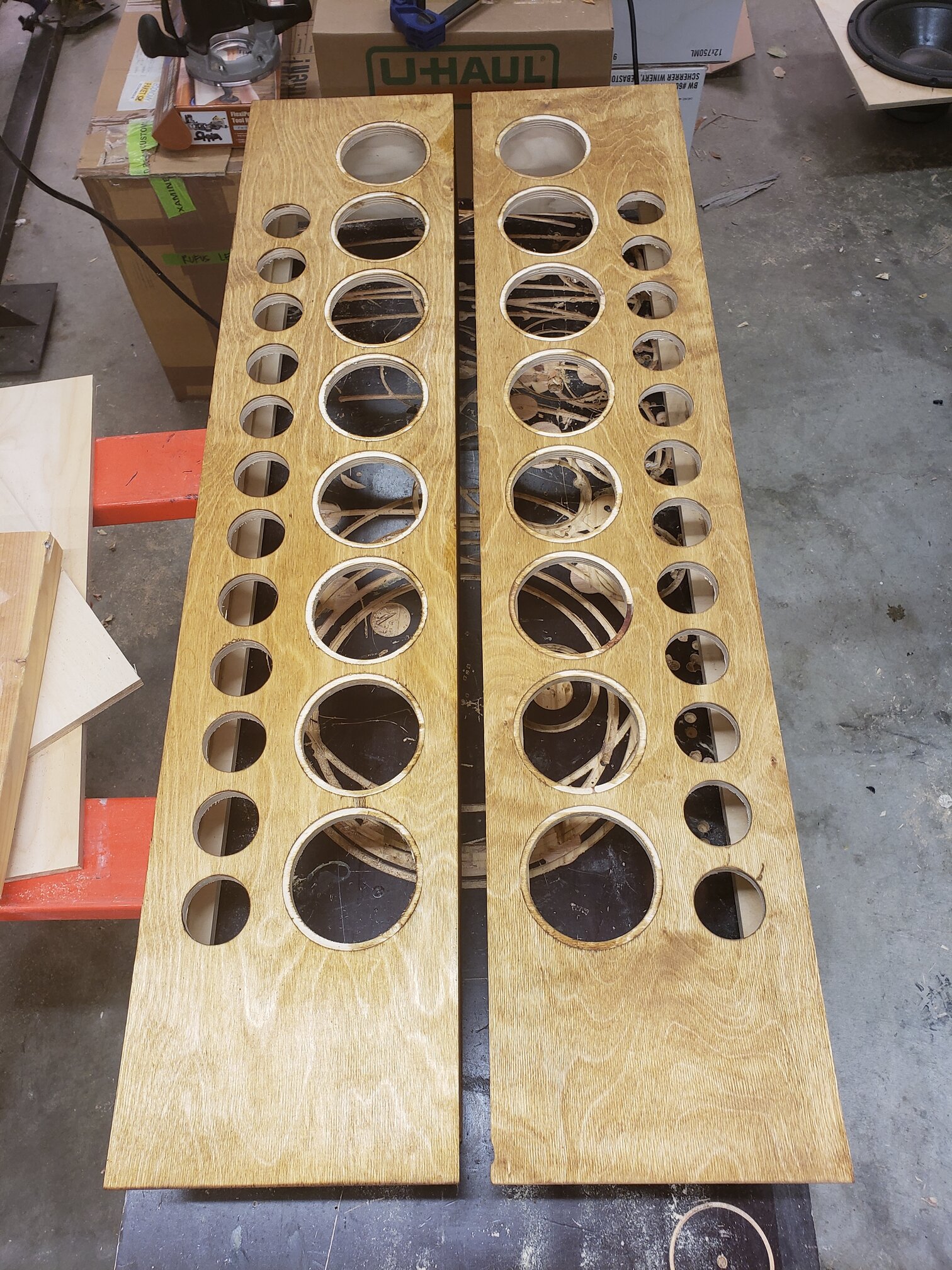

I'm building rectangular TLAHs with 8 mid-basses, and plan to hang them on the wall. Do I omit the bottom (open end) or top (sealed end) driver?

Omit the one at the open end.
Re: TLAH - 8 driver - double check
Thank you - a couple days of routing and drilling, and: Leland shipped me the crossover parts today, a cout of polyurethane tomorrow, and I'll be ready to start mounting drivers.
