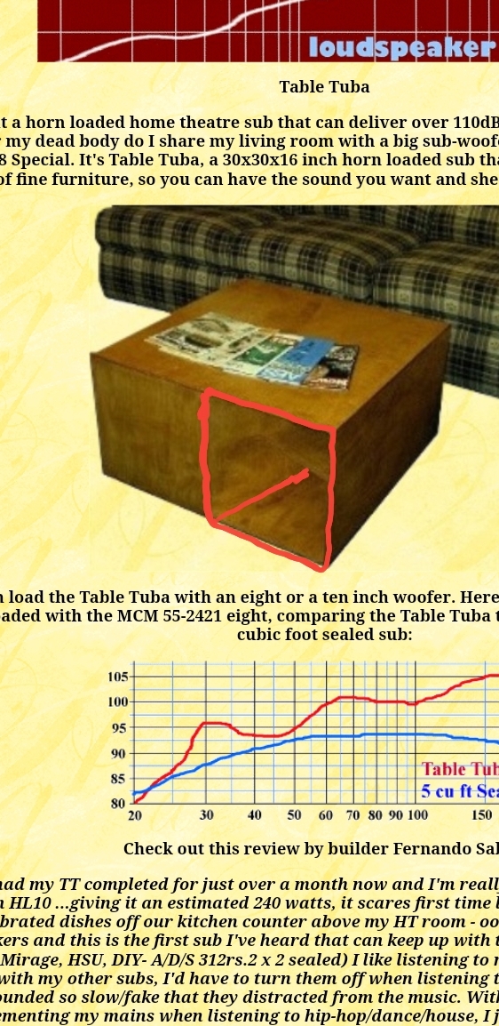

Trdat wrote: Wed Aug 26, 2020 10:43 amOkay I am deciding between the Table Tuba and the table Tuba longstyle but I can't see where the opening is for the table Tuba?
It is on one of the sides (if you are looking at the picture on the sales page). The idea is so that it will be incognito.

Yes, that is totally permissible. It should be pointed out that, in the sales page photo, the driver opening is on the bottom for sound reinforcement. If the cab is placed on the short panel, then the driver opening must be at the wall (the cab can be made mirror-image if needs be to turn the cab around and still have the opening on the wall).

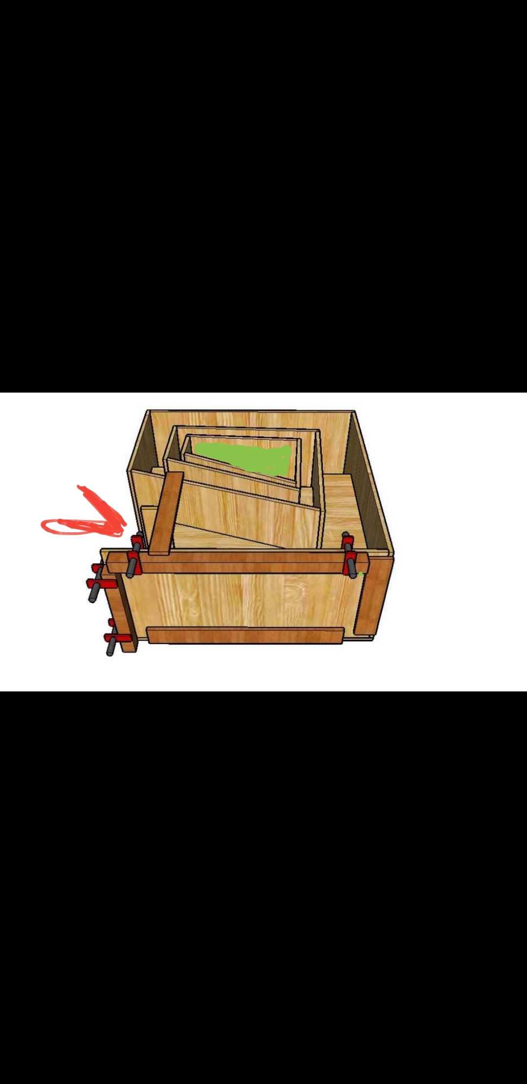

The Table Tuba is a little different from most of the other designs as it has two openings. 1 the obvious mouth of the horn and the second is the driver acess witch is usually covered up on the other plans. You can see the driver acess openings at the bottom of my long style one pictured previously. (Speaker cable coming out of the hole)
Here is the main opening on the TT listed on the sales page. It is a little hard to see but makes sense once you see the plans.
The driver acess is in the middle, here i have highlighted it in green. It is only open on one side. So on the sales page, the sub is flat on "top" with the driver acess opening facing down.
I Hope this helps clear things up..

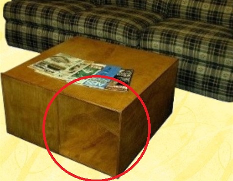

On the TableTuba the driver chamber is not sealed. One side is left open. I'm not sure if the TT plans mention sealing the chamber as an option, but I seem to recall the TTLS plans mentioning an option to seal the chamber. I'm not feeling 100% confident about that and I don't want to check the plans at the moment, so take it for whatever it's worth... a possibility I suppose.
On the TT sales page, I didn't see it for years, but if you look closely you can see the mouth of the horn...
