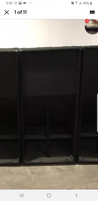

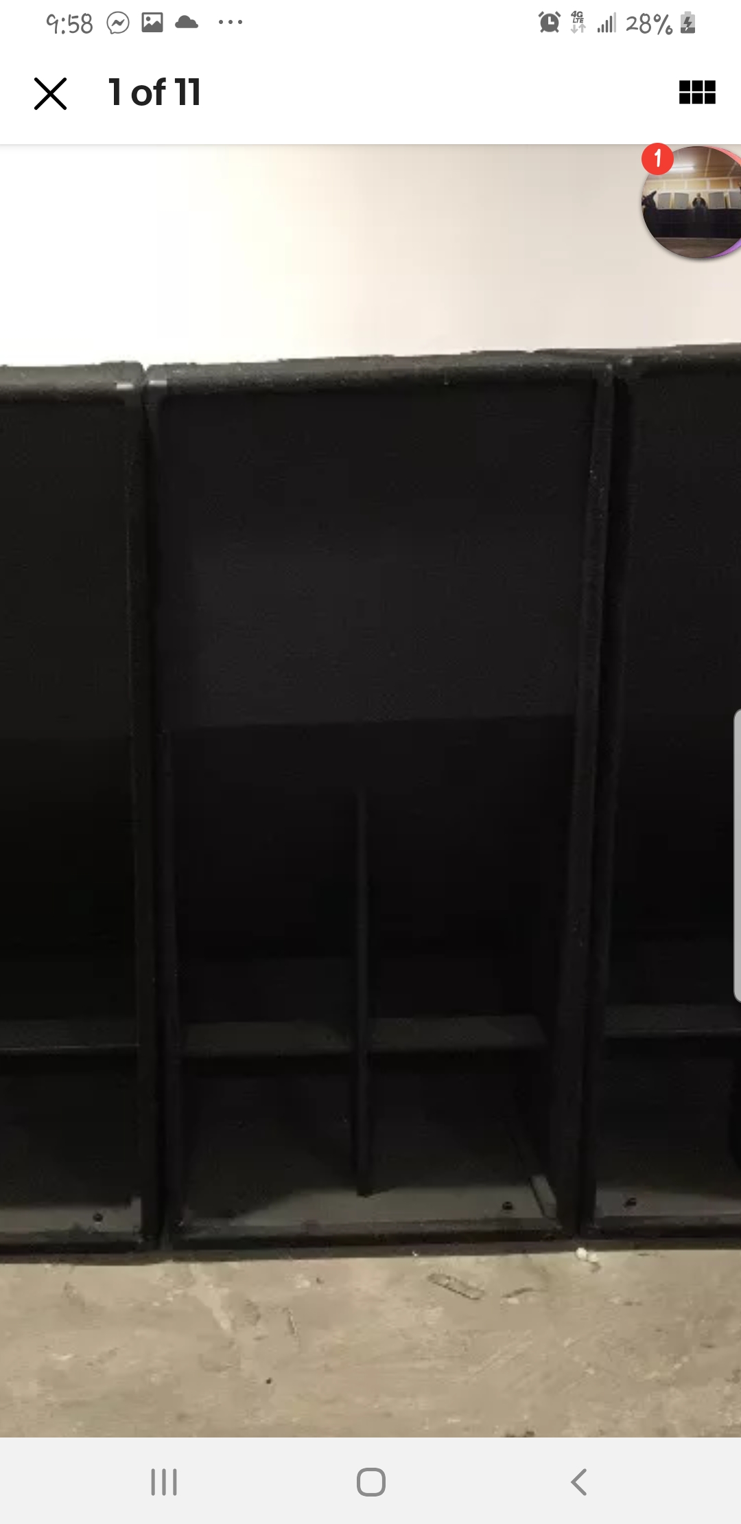

I found a listing on ebay for a set of horns that look almost identical to the t48 but the bracing and size are slightly off. Not finding a whole lot of other cabinets it could be. If they're t48s I might just swoop them up. Can anyone verify before I go trying to contact the seller? Dimensions are slightly off 25 inch deep, 23.5 inch wide 50 inch tall.

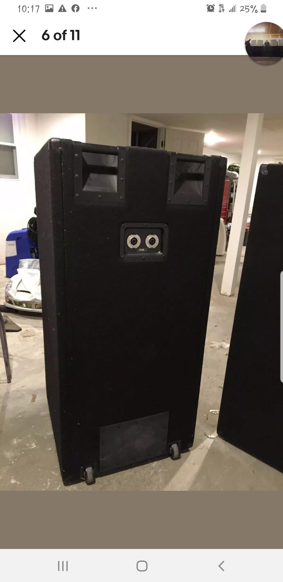

As far as the dimensions, it's 2 inches taller. I don't think the castors would add that much, the width is plausible, and the depth is one inch over... but they appear to have an inch lip around the perimeter of the front of the cabinet, presumably to add a grill... maybe.
Do they say what drivers they're loaded with?

Nope just an incredibly vague description. Although it mentions a 15 inch driver. It would make sense if maybe they were modified to fit a grille. Those have been up for sale for months for a stupid good deal.

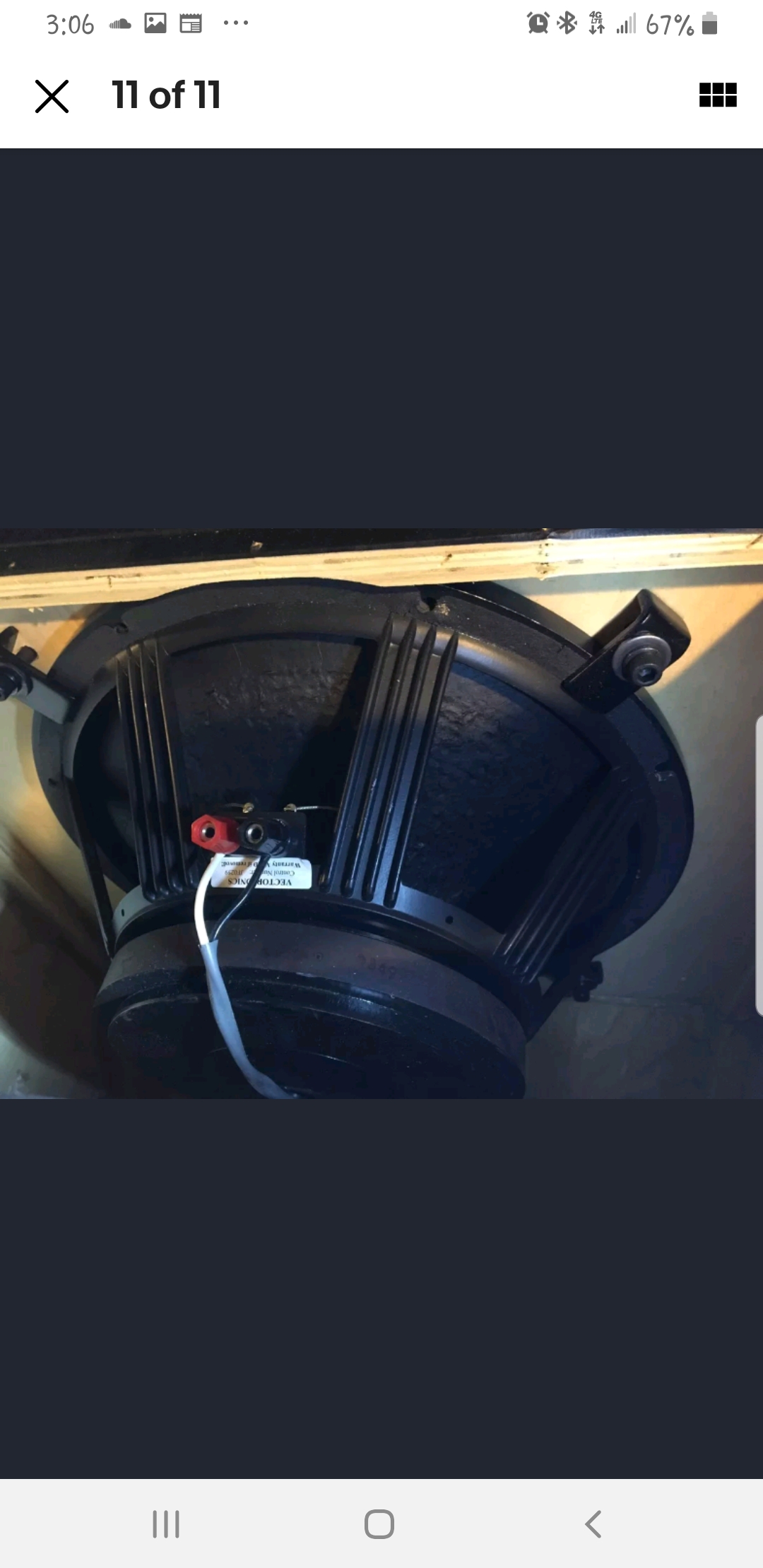

Anyone farmiliar with a fabricator called vectorsonics? I'm not sure if these are proprietary drivers or if they just have the fabricators branding on them. But all I can find on vectorsonics is their location in Maine. Thicker paneling was used on these which i believe would explain the dimension differences and the change to the bracing. The seller didnt really have to much information about them to share other than that they could fill a stadium and that they had bought them already fabricated.

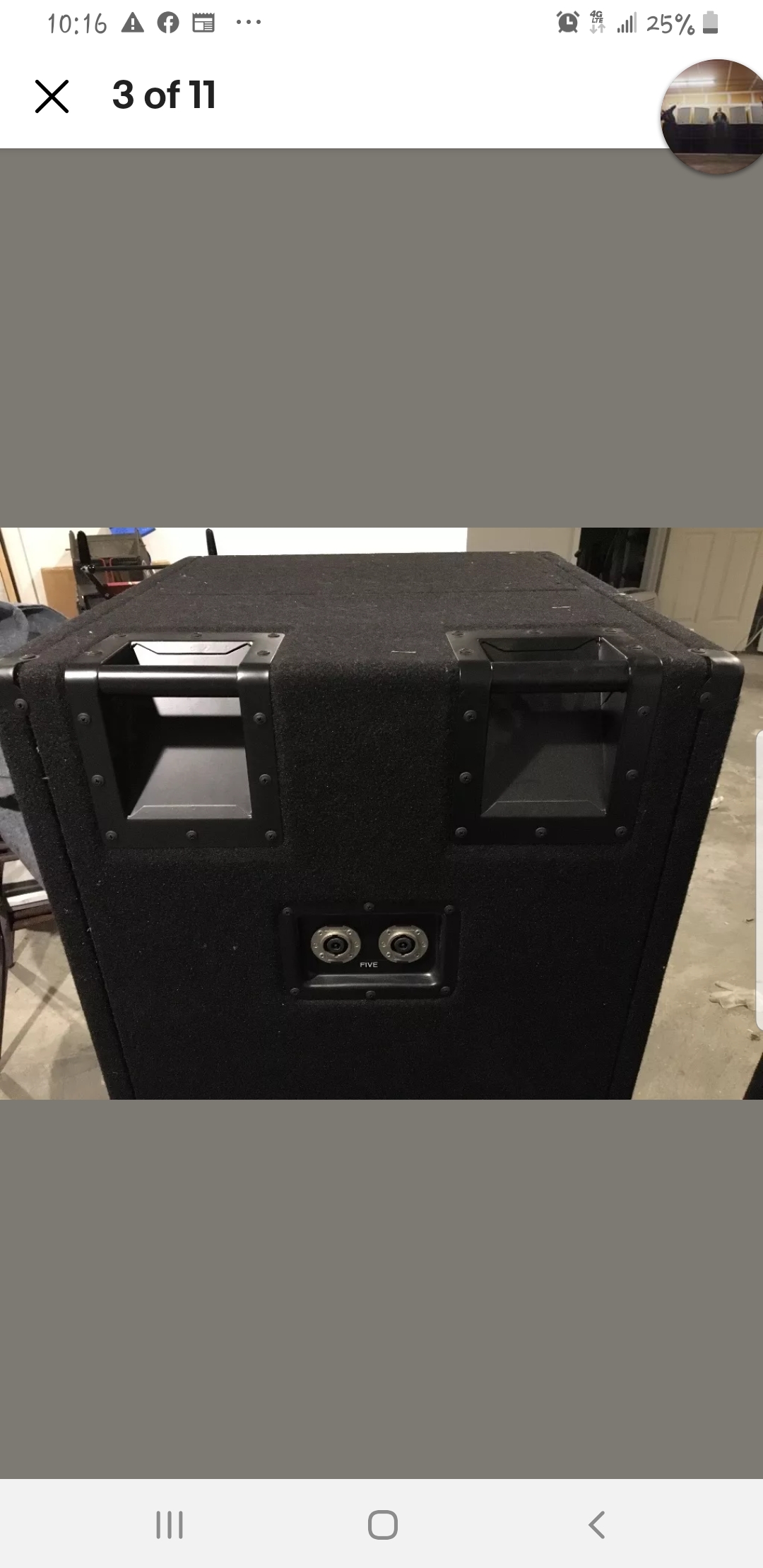

Those are not proper hold-downs for a sub speaker. Air leakage around those bolts on the clamps. Pass on these. They are not built properly.

Out of curiosity, if these are also mounted using the predrilled holes, but supplemented by these braces would they be viable options? Or are the braces just a recipe for leakage? I have contacted vectorsonics and he told me they are custom drivers ordered from eminence.
