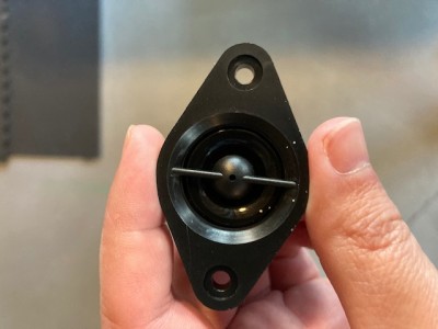

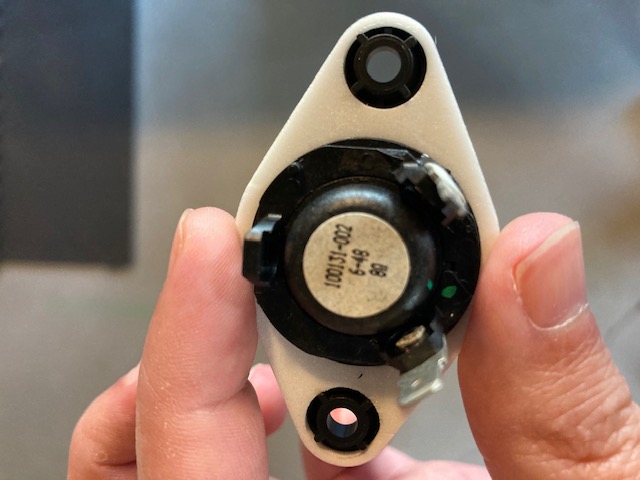

Finally getting around to hopefully maybe building my speakers. I purchased a bunch of Sony closeout drivers back in 2011 (dang, where did the past 9 years go?) along with a bunch of tweeters to build some TLAH's. Fortunately, the specs are still available for the Sony's (https://www.parts-express.com/sony-5-1- ... r--299-012). If I remember correctly, there weren't data sheets for the tweeters, but they were generic enough to make them work (again, I'm remembering back 9 years). I believe there were a bunch of people that got in on that deal, so can someone comment on what crossovers I'd need for the TLAH's? I apologize for my delayed question, and appreciate any feedback. I've attached pictures of the tweeters, if that helps.

Looks like they were tweeters from Apex Jr from DIY audio (had to do some digging). Looks like the link to the frequency graph is no longer around.....is it possible to still figure out how to use this combination?

Plans recommend Goldwood GT-302, so I'd try to match those within 10% like we do with all other drivers (8 ohm, 3/8-1/2" dome, 2.5" diameter max frame). I don't think the tweet specs are as critical as mids and lows since the crossover will tame them. So if it fits that criteria I'd say you're good.
