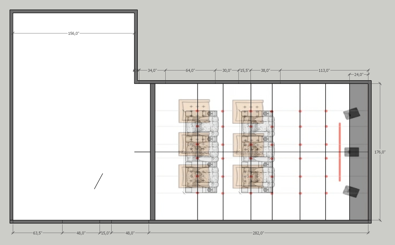

I've just started the designs for my dedicated HT. Plan is to do 3 TLAH's for the LCR and SLA's for the surrounds. I have the speakers already, purchased years ago on a closeout deal and never used them. Is it probably going to be best to do the triangle version for the LR mains and the rectangle for the center? Or do all 3 rectangle?

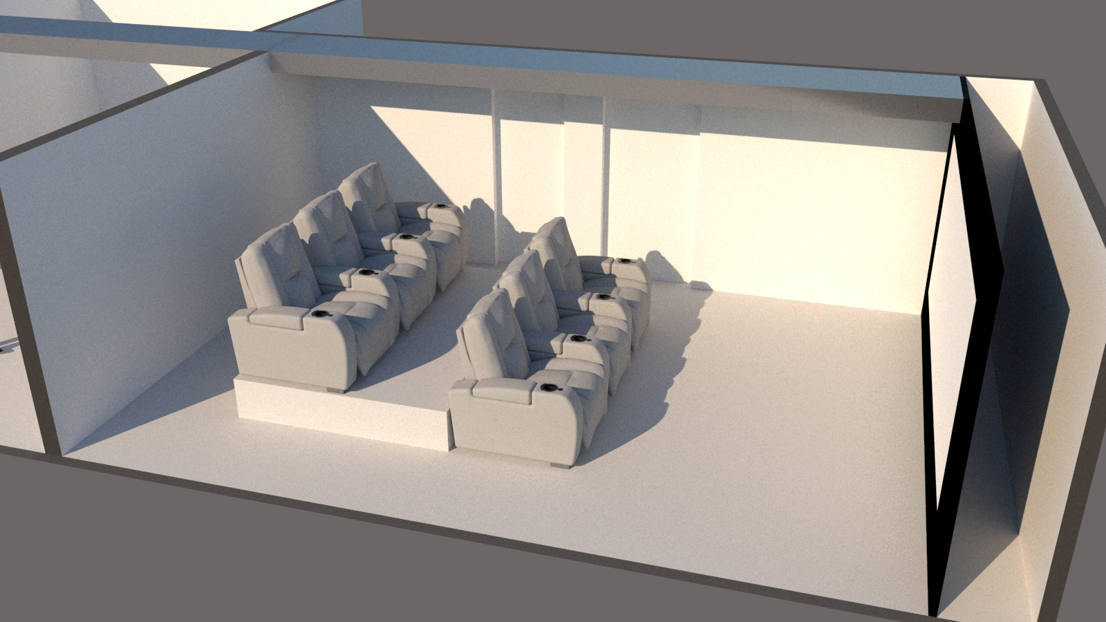

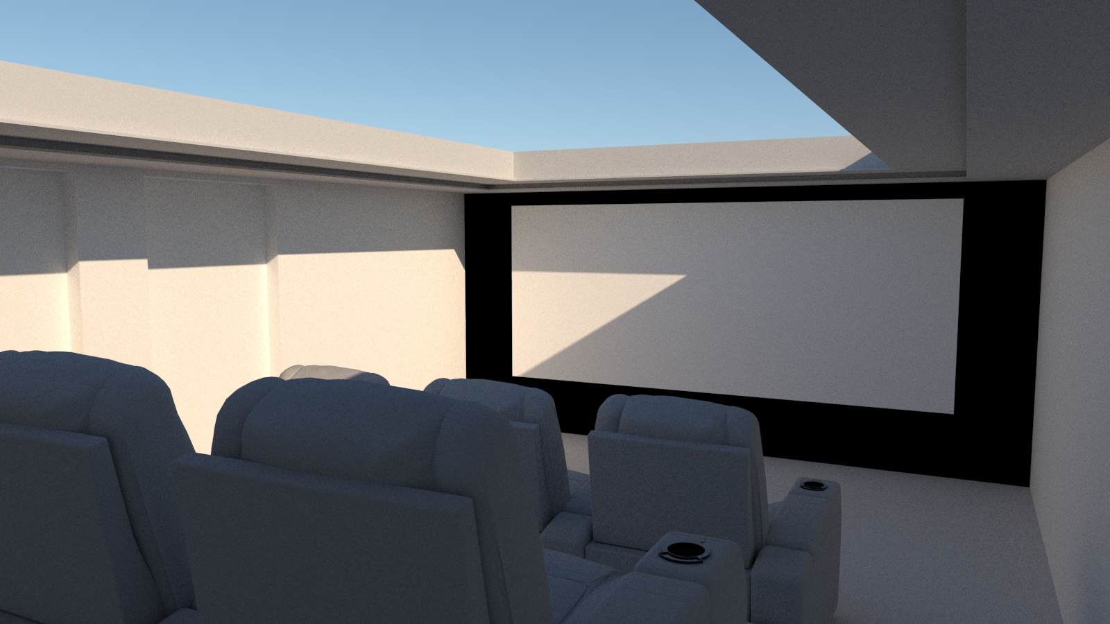

For the subs, I'd like to do 2 THTLP's, preferably @ 36".....but space constraints may cause me to do smaller. I'm planning to do a 150' AT screen with 2 feet behind for the speakers (the overhead shows 2 and 3 feet). The room dimensions are 22.8'x14'8"x7'8". Here are some of the plans thus far. I'm still figuring out how to best plan for sub placement, since they have such a large footprint....it makes it hard to just put them anywhere. Is it generally best to do the port facing up, down, towards the listening position? From what I understand, while it may be the most "convenient" to place both subs behind the screen, 2 subs on the same wall will likely result in acoustic issues?

Sub placement shouldn't be determined by aesthetics (though it often is).
For best sound and addressing of room nodes, the "subwoofer crawl" determines best placement.
Here's hoping the subwoofer crawl will determine two good positions, 1 corner loaded behind the screen, and 1 corner loaded behind the seats.
So, if you can be more flexible at the design stage, and build the cabs first, it will sound better in the long run.
The curved SLA is designed as a centre. A full TLAH may be too much as a centre, as there is very little content in the centre channel anyway, which is more about sound imaging.
Hope this helps...

For a center I'd do a vertical SLA, as you have the room to do so. You can do TLAH as well, but there's not as much power content in the center as the L/R. The L/R don't get as constant a feed as L/R, but it's louder than the center when they do kick in.

Cool. Thank you for the feedback. I might do a TLAH for all 3, just for consistency, if there’s no downside. Any thoughts on triangle vs rectangle for the mains? Any advantage? The rectangle is certainly easier to build, but the triangle has the natural angle towards the listening position.
- Posts: 29008
Re: Building a dedicated HT room
Triangle L/R and rectangle for the center would work well.

@CGRemakes, will the screen be DIY as well? Oh, and, are you locked in with the 2 foot measurement from the wall. I'm asking this just in case a sub needs to fit in there.
Yes, I will be DIYing the screen as well. I am not 100 percent locked in at 24, it just has to be a somewhat reasonable distance from the seats. I know there needs to be a decent amount of space from the walls for the sub to breathe, and I don’t want the port to be directly behind the screen and create waves. I was thinking maybe with the THTLP, I could do the port firing down or out the front with the mouth out the bottom? Figured that way, the port isn’t firing directly into the screen. Does my logic make sense? And if so, what distance from the back wall and screen would be sufficient? I am open to suggestions. I am not set on a 36” sub, so I have some flexibility.
