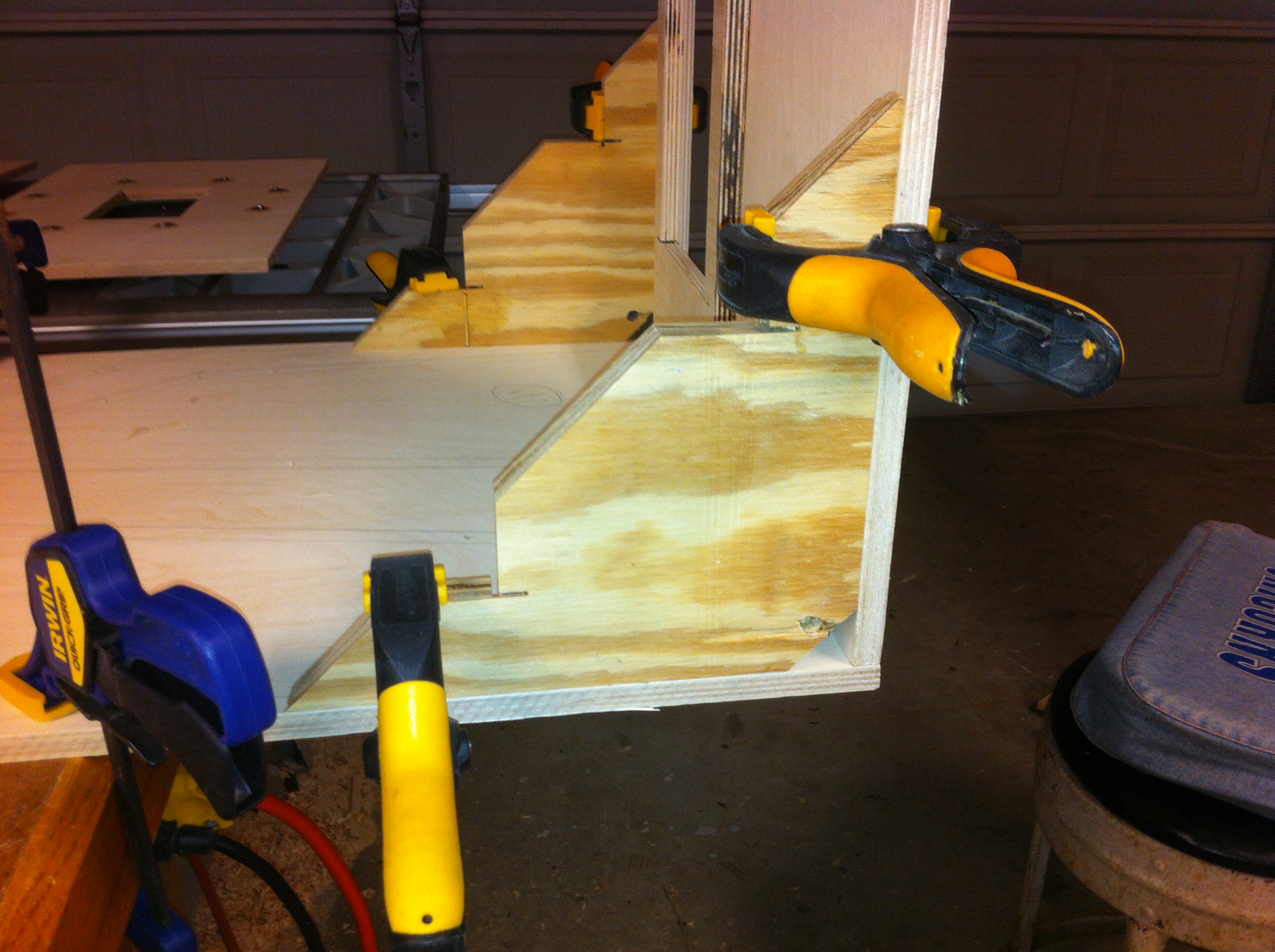

Another handy jig to make is the right angle jig (looks like B-2 bomber) for gluing joints but not getting it on the jig. Also, a box of screws to hold the joint while the glue dries. If you build it right with PL glue you don't need screws.
Like this....
