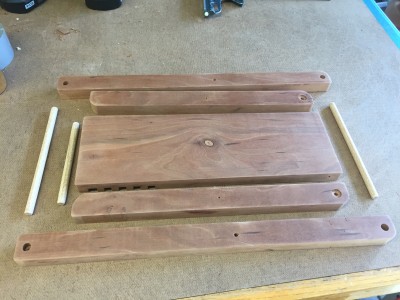

I was going to go grab some Red Oak from HD to build this, then remembered that my late Brother-in-law had given me a few Cherry boards many years ago.....at least I think they are Cherry, that's what he said, and they look like Cherry. So, I drug one out and started measuring out the parts and cutting.
Here's the cut pieces.....

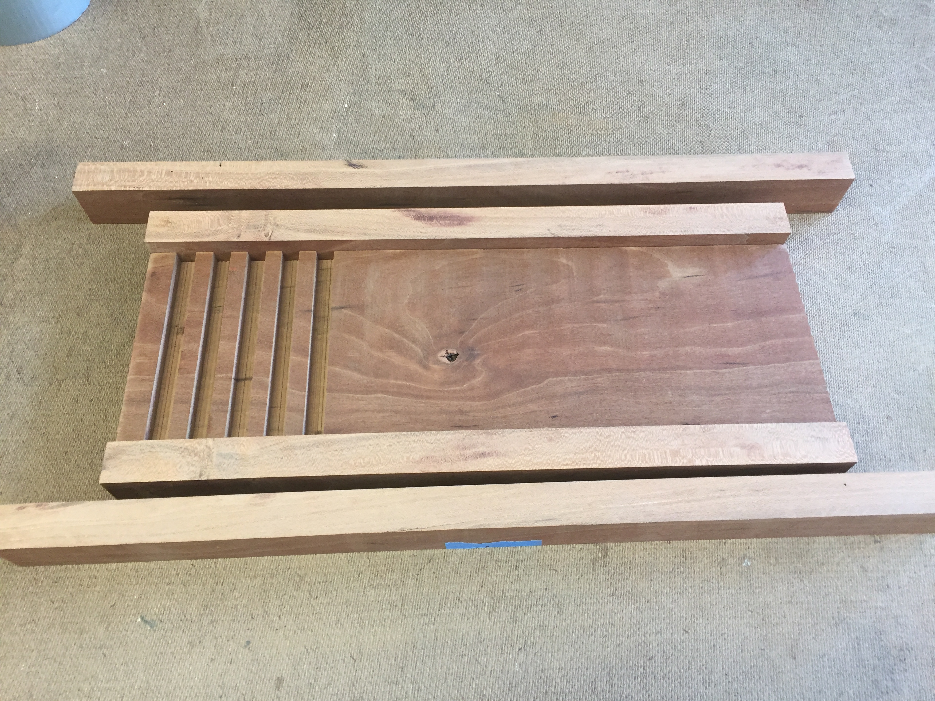

That was the easy part.....a whole bunch of time and head-scratching went on between the first picture and this one where the holes are drilled, the pivot points are set, edges are rounded over, and the sanding it done.

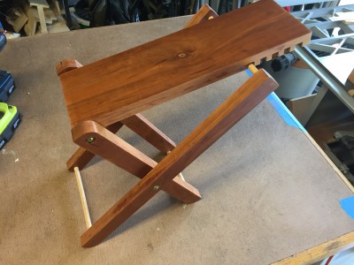

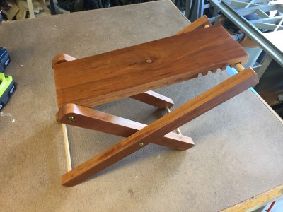

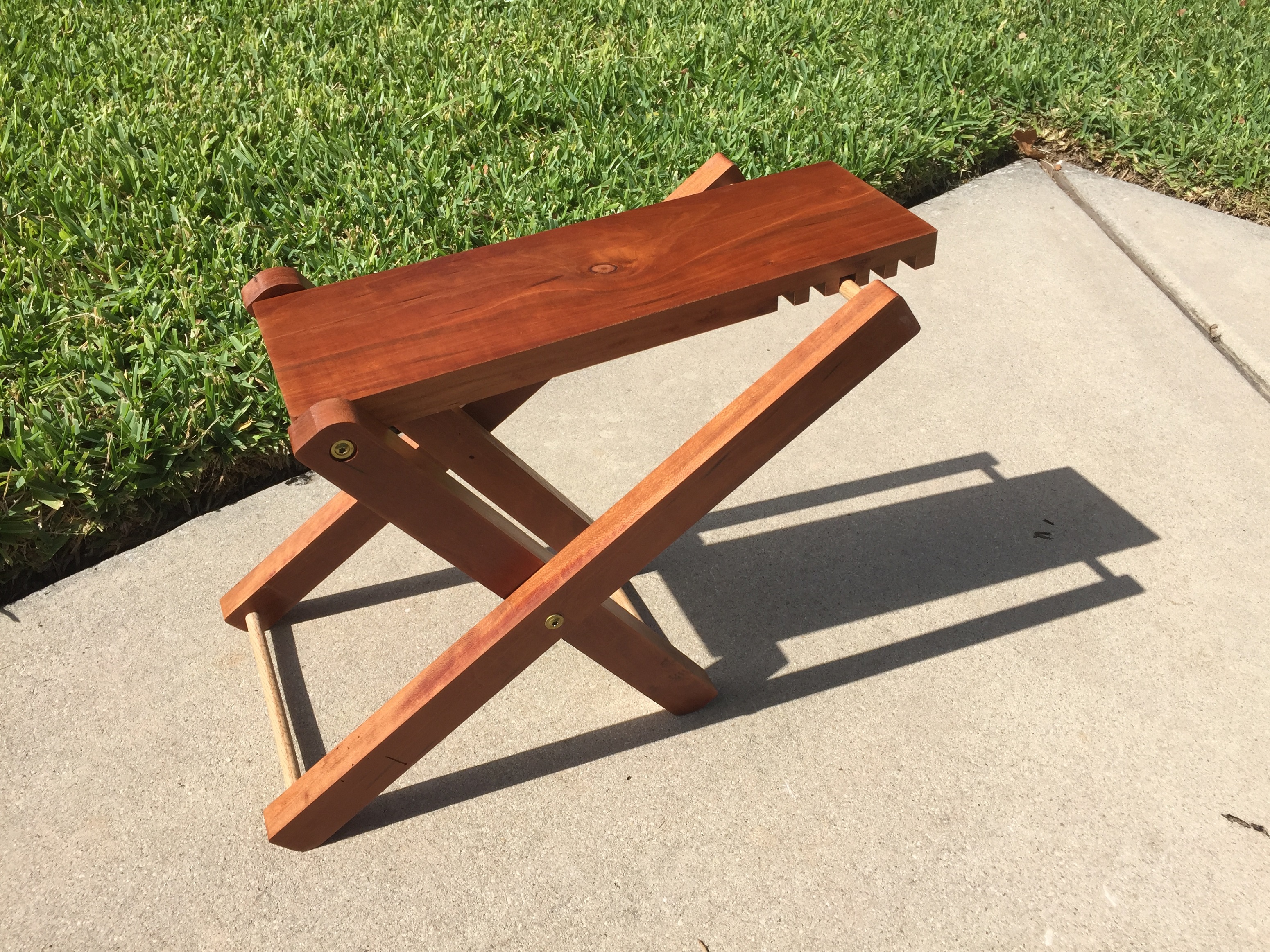

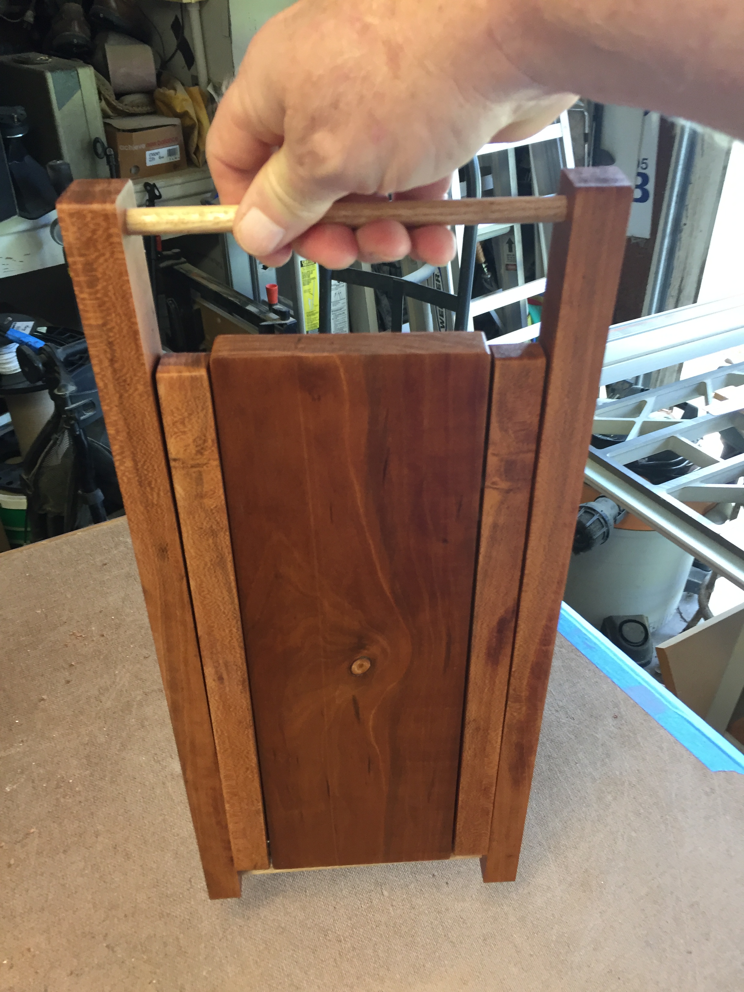

Slapped a bunch of Poly on it yesterday and went out to finish it up this morning... Four screws and three dowels makes for an easy assembly. I didn't even put any glue on the dowels. They are a really tight compression fit, so I just left it......much easier to take apart should I need to. Wasn't too sure about just using screws, but it shouldn't have much weight on it. There are washers between the wood joints where the screws are to keep the legs from rubbing.
Haven't put it to use yet, but I think it's going to be much better than store-bought as it is wider and is taller.
At the tallest..... At the shortest..... All folded up.....and ready to travel..... Glamour shot for the tabloids.....
