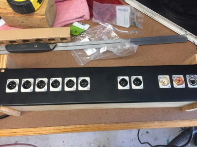

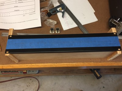

Gotta' lay it all out.... 6 auxes, Main L/R, RCAs for iPod, and the router connection for mixer control.
Oh, and that's a jig I built some time back for holding panels......well worth the time.. After drilling 3/8" holes, I used this amazing tool......after using a step drill for years, I finally invested in a Greenlee punch a few years ago. Makes life much easier and less messy. And after using a crescent wrench to turn the bolt to cut the holes.....I finally got smart and bought a cheap socket to use with my impact wrench....takes about two seconds...
.....and voila! A punched panel....

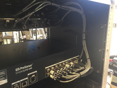

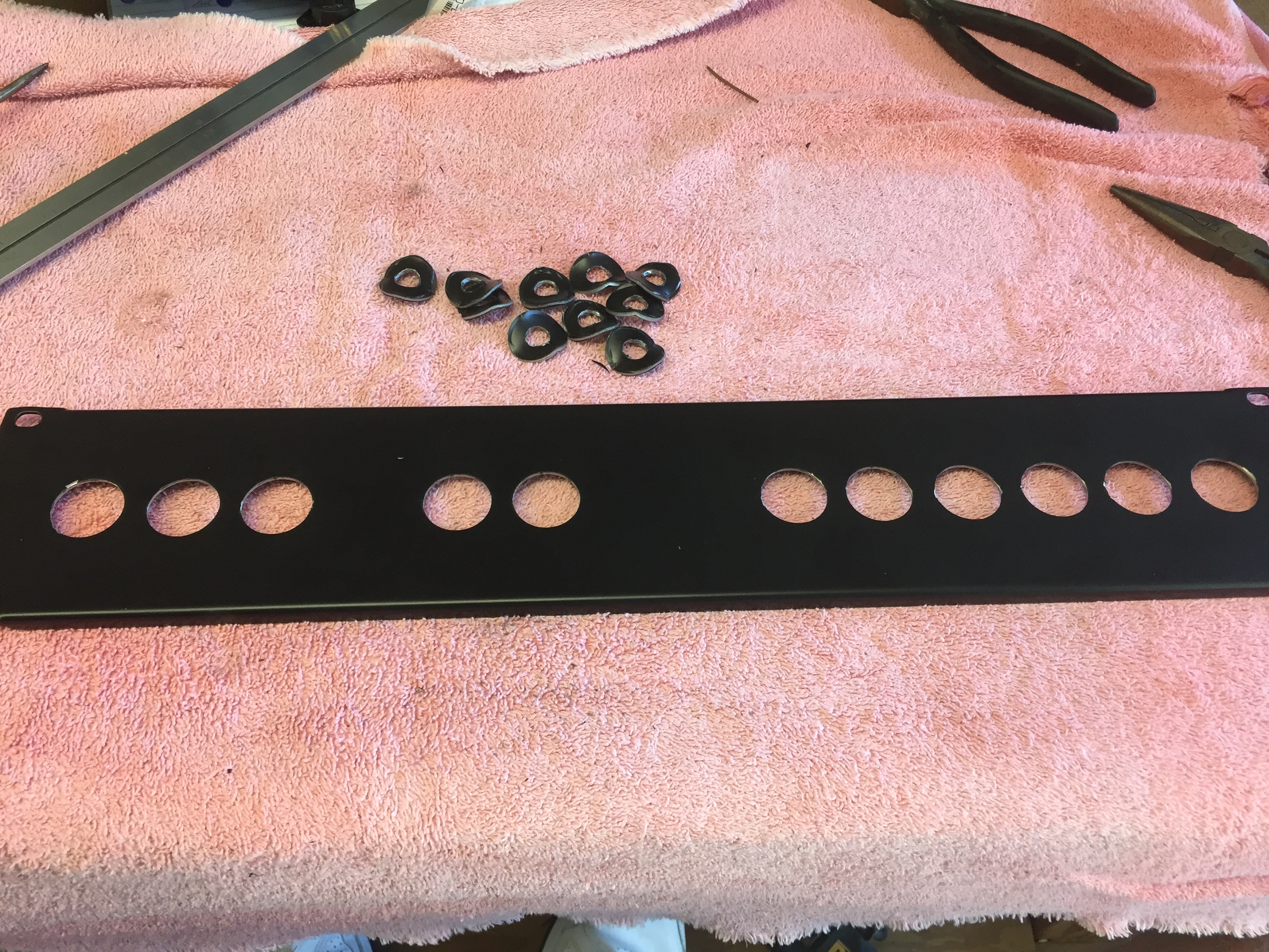

Next up is to layout all of the connectors and drill one hole in the panel for each one. All the while using a steel rule as a straightedge up against them to keep 'em straight. This is the best way I found to keep 'em from looking all crooked. After getting one bolt and nut on each connector, I go back and drill and add the second one.

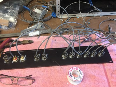

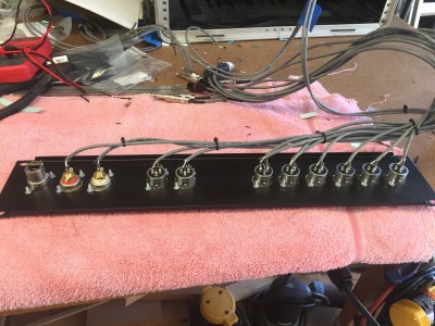

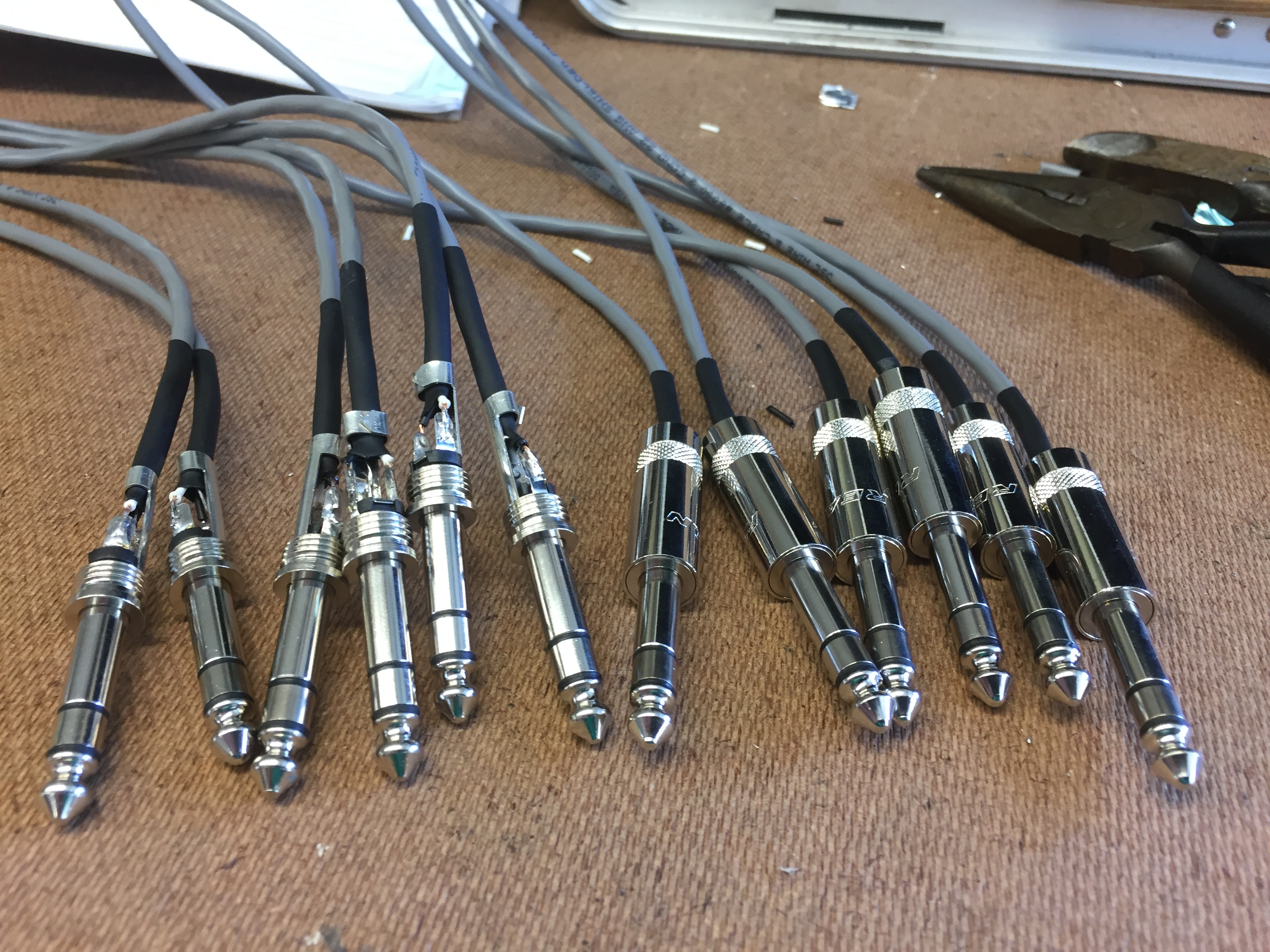

Measured out the cable lengths and started building the cables. I used a short barreled TRS to keep 'em from sticking out as much as I could. Heat shrink on the ends for stability and better to grip with the end crimp. I chose these particular TRS (Rean by Neutrik) instead of the usual Neutriks that I use. The good ones are way more expensive and way too long for this application. Plus, these won't get abuse living in the back of the rack.
After getting all the connectors locked in, it's time to solder.
Then dress 'em up and get the panel installed.
I used a lot of cable ties and hold downs to keep everything in place as the drawer had to go it the open space.

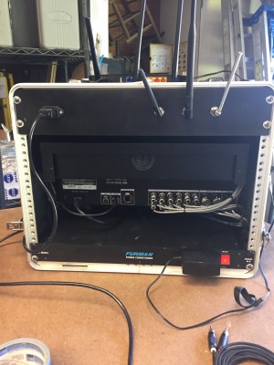

So, one panel is in and it's time to work on the back panel...

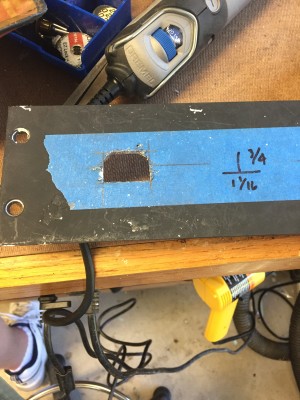

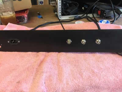

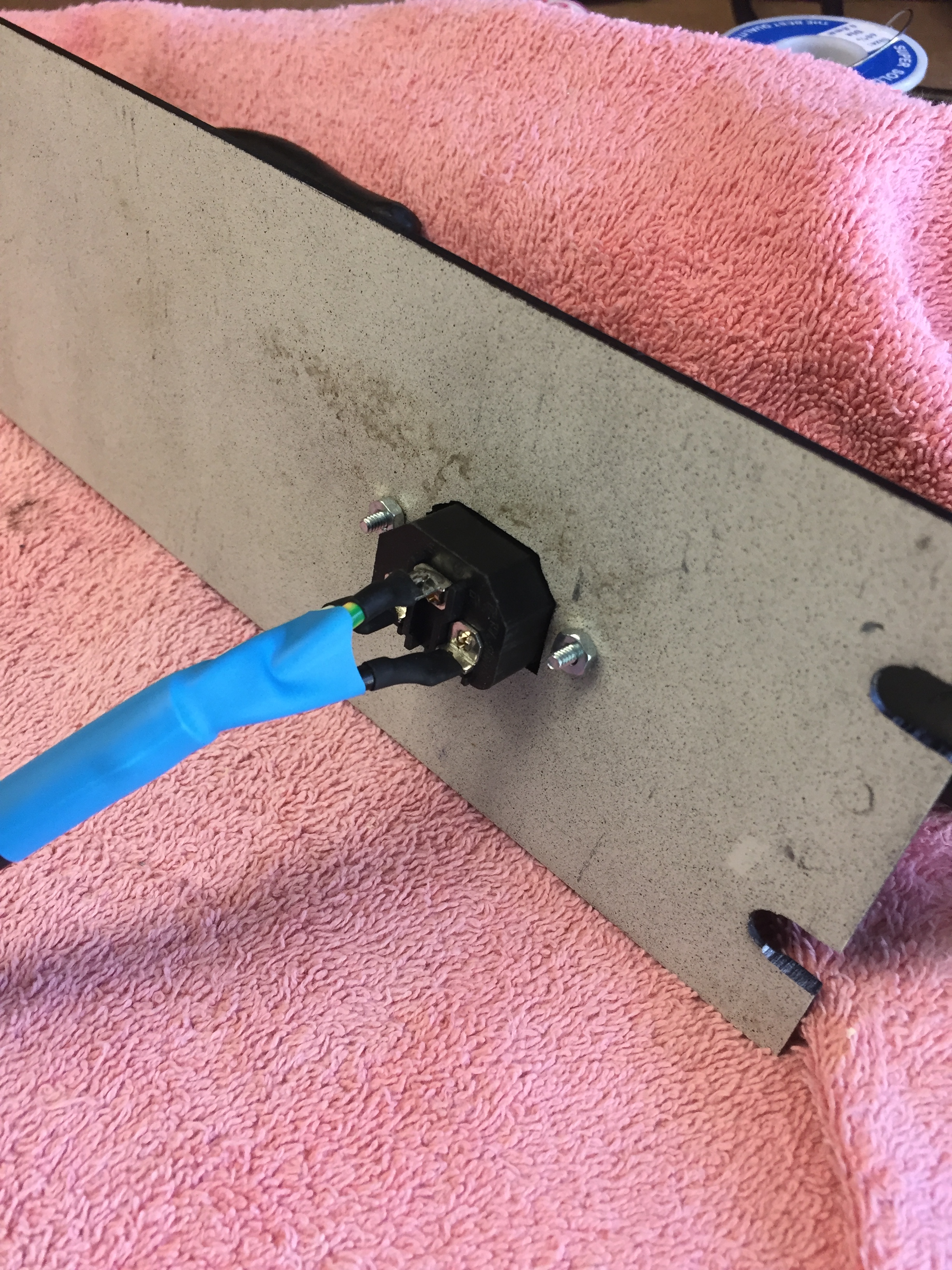

As I said, I wanted to keep hands out of the back, so I cut the hole for the IEC socket....these are a PITA, but with a drill, then a metal blade in the jigsaw, a little dremel work, and then some filing, it fit pretty snug.

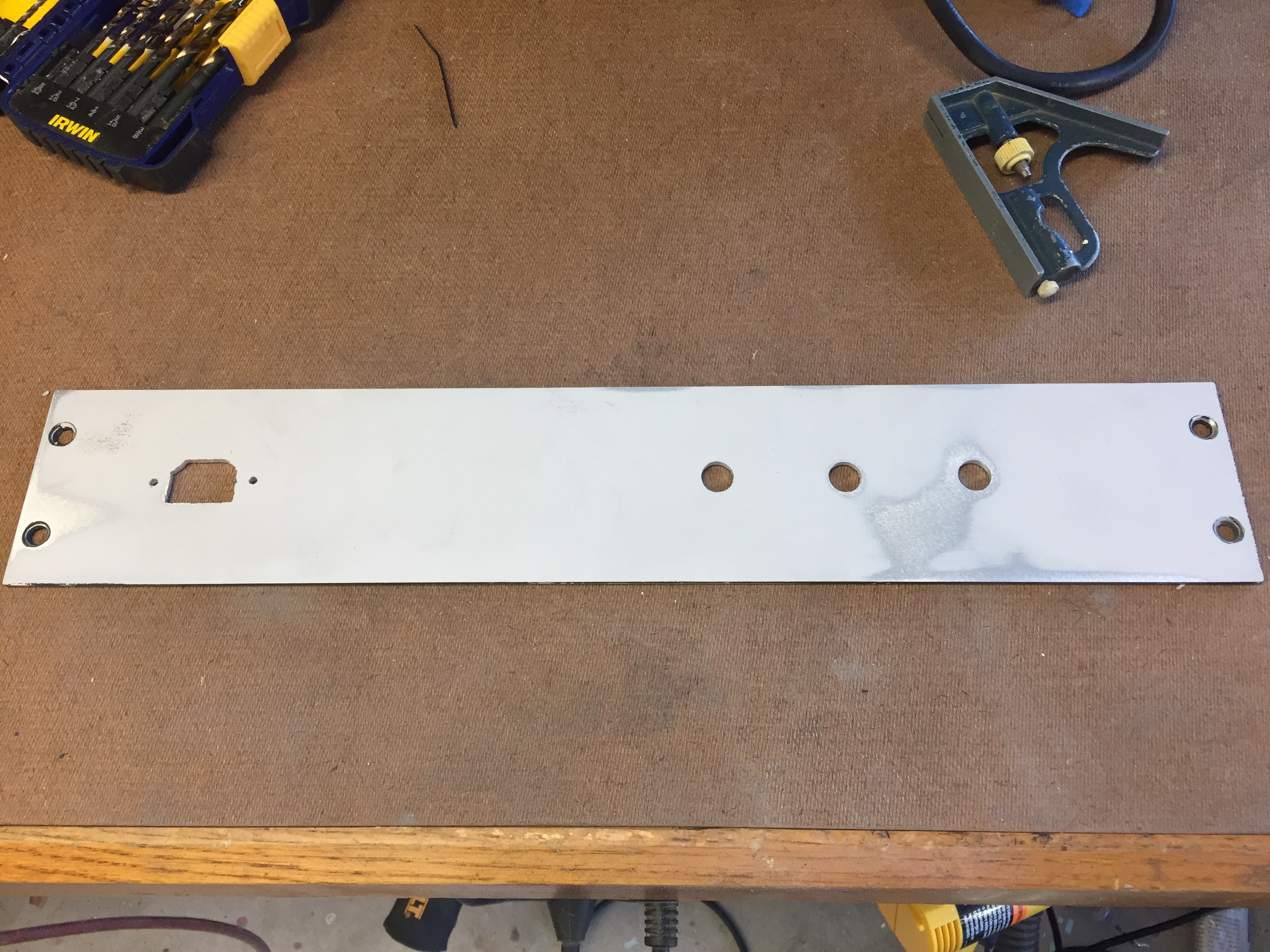

This old panel had been painted and it was looking pretty poor, so after I drilled the antenna holes, I sanded it and shot it with some fresh paint... Installed the IEC socket with some heat shrink to cover it all and then a wrap of electrical tape around the connector.
Back panel finished....
- Posts: 8678
Re: Another Rack Panel build
Back finished with the power conditioner in the bottom, the panel on the top and no reason for anyone to put their hands in there ever again.

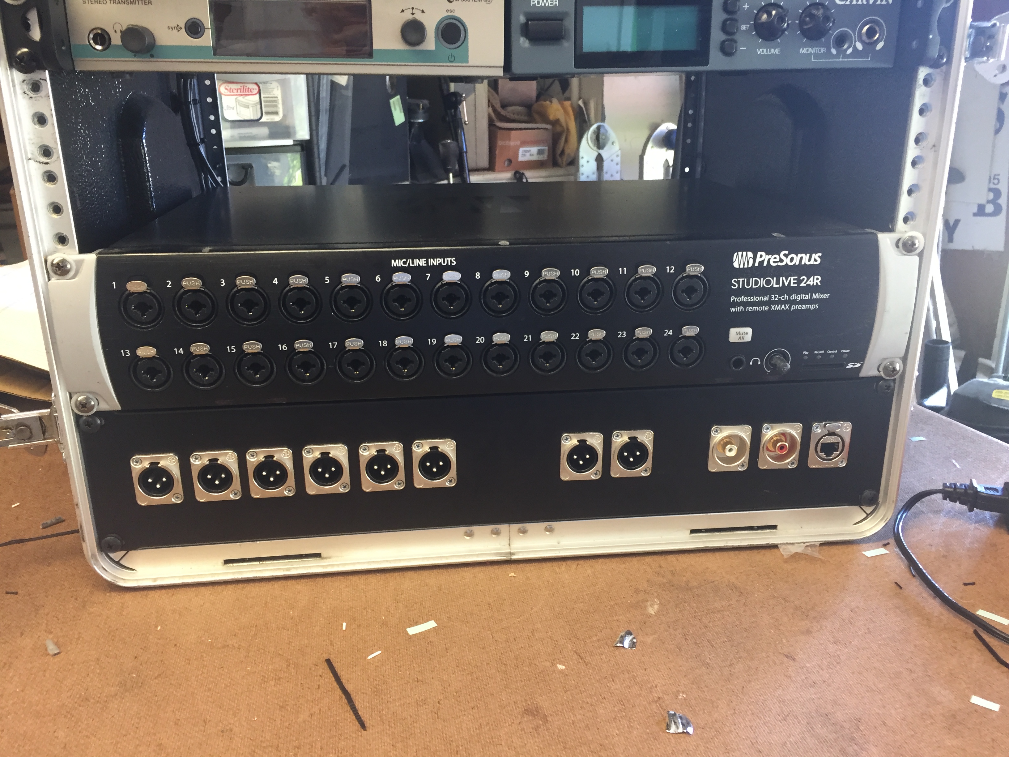

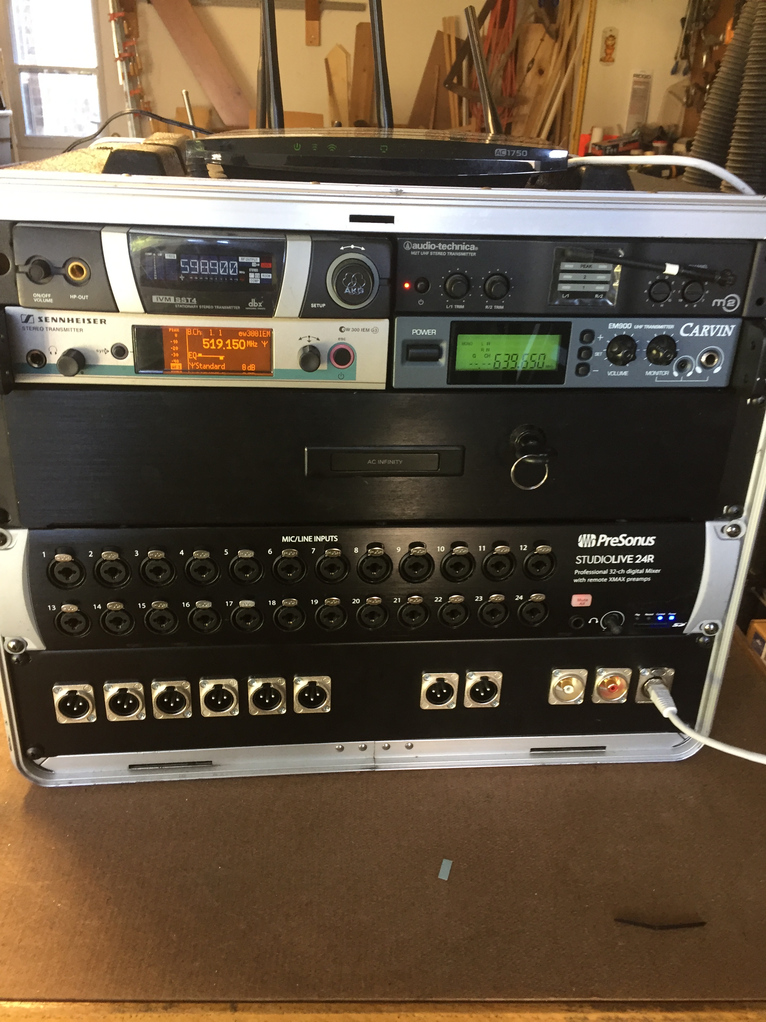

Front view with the transmitters, drawer, mixer, and panel. BTW, drawer should always be above an panels so that the wires draping down won't get in the way of the drawer opening.
Finished it up on Friday afternoon and took it to a morning setup for a benefit they were doing the next day. Everything worked fine. the router lives in the drawer and it's power comes from the power outlet in the front of the Furman on the back with the RJ45 connection in the front panel. The iPod stays in the drawer with the cable to connect to the front RCA jacks.
Everything worked great and they were really pleased with it. Next up is to get them all together, set everything up and dial in some really good stereo in-ear mixes so that they will actually use them.

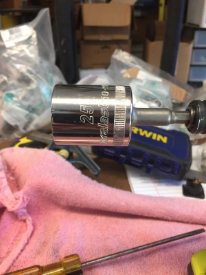

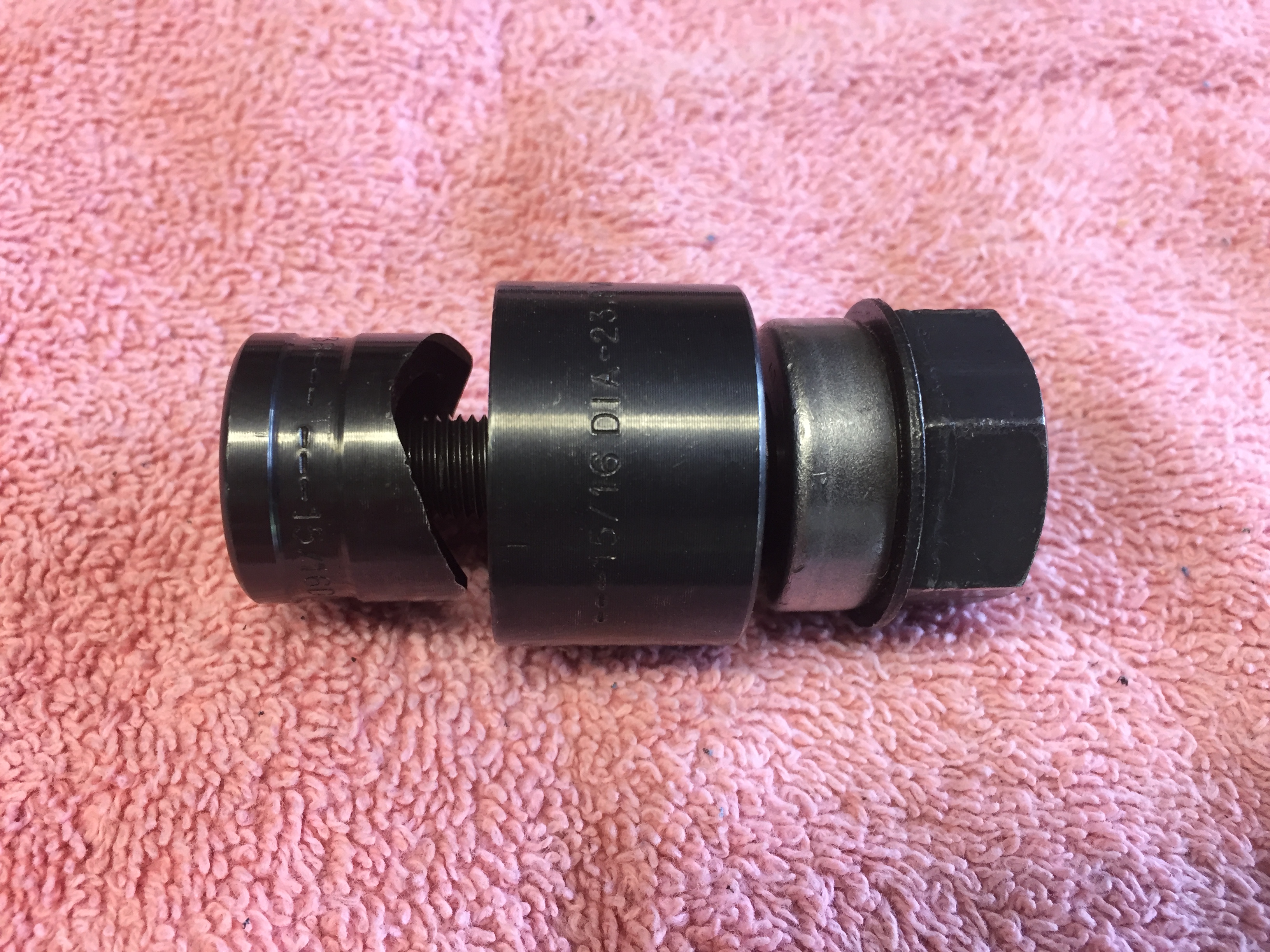

Oh, and thanks for reminding me to get a punch tool. Is yours 15/16”?
- Posts: 8678
Yep - 15/16" is perfect for the D series connectors....xlr, speakon, you name it - Neutrik makes a connector to stick in there!Grant Bunter wrote: ↑Tue Jun 23, 2020 1:54 pm Nice work as always Bruce!
Those punches aren't cheap, but I wish I'd have bought one years ago. And getting a socket for it is worth it too. I went to Auto Zone to get a cheap socket. It's supposed to be 1", but these are cheap sockets (8 bucks) so it was a little sloppy. So, I went to the metric ones and tested until I found a good fit. 25mm did it. With that in my impact driver, it was one more of those "AHA!" moments. Because it takes just a little over 6 turns with a big crescent wrench......and that gets tiring when you do a bunch of punches.
